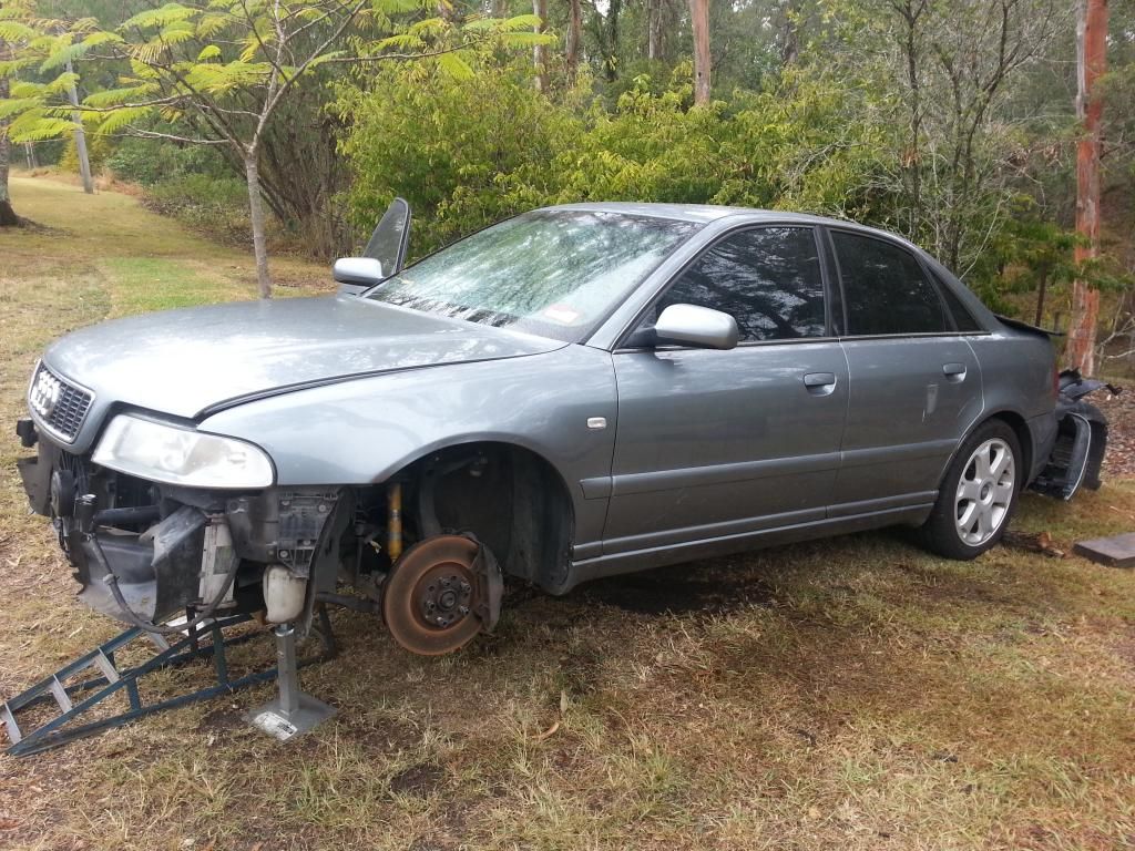

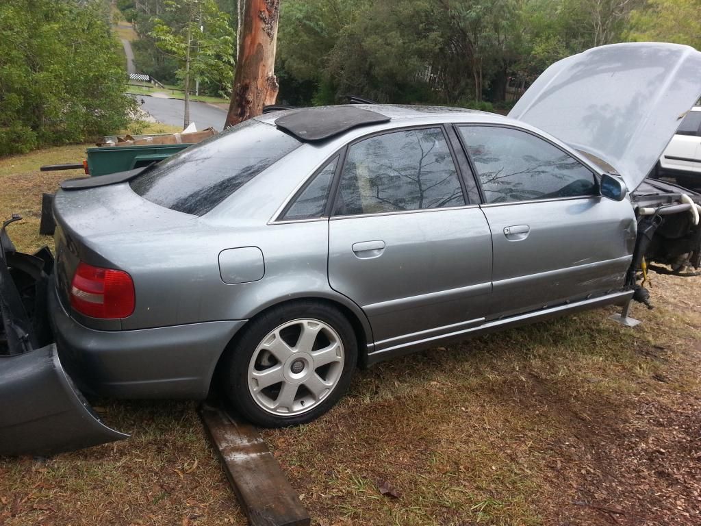

The car is actually quite a rare colour, Achat Grey :

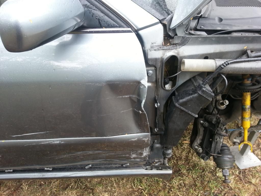

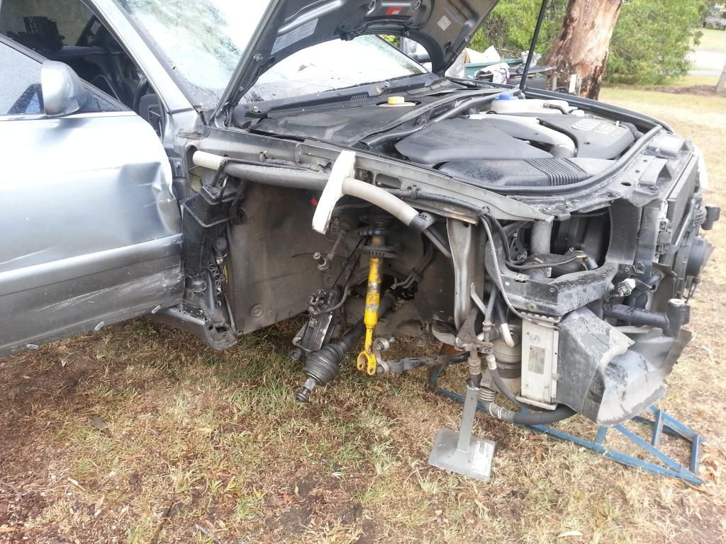

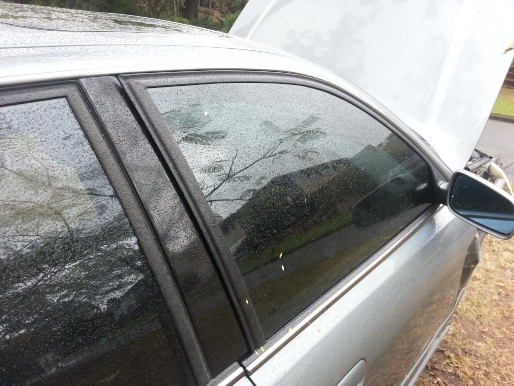

The car got hit at about 15mph. The damage is nearly nothing except for the tow truck driver that skull dragged the car over a median strip, i'll get to that later.

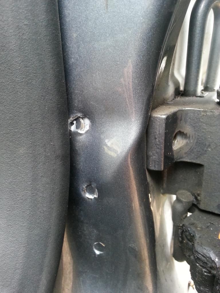

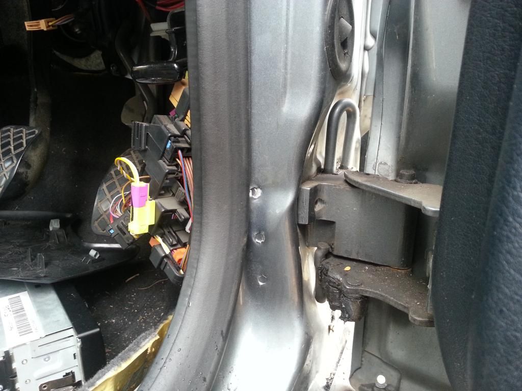

So the front right wheel had some toe out, something was obviously bent. I removed the lower control arms to which there was no change in the toe. I did some basic measuring of the distance between the tire and the upright and it seemed to be equal on both sides. I've bought a new front control arm kit and tie rods, if it turns out to be the upright, then i only have to swap the front lca to make the b6 alloy uprights work. I got some new front axles for a killer price. The lower door hinge was pushed in ever so slightly too, I will need to pull that out and hang the door again.

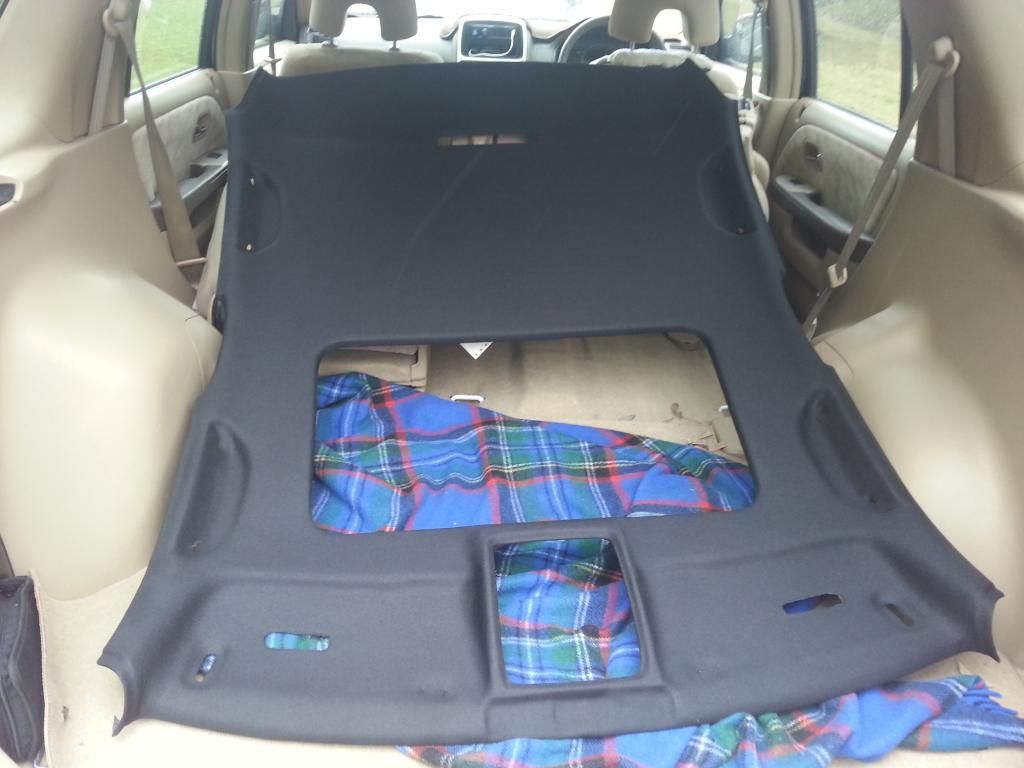

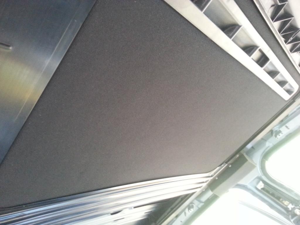

Retrimmed the headliner since it was sagging.

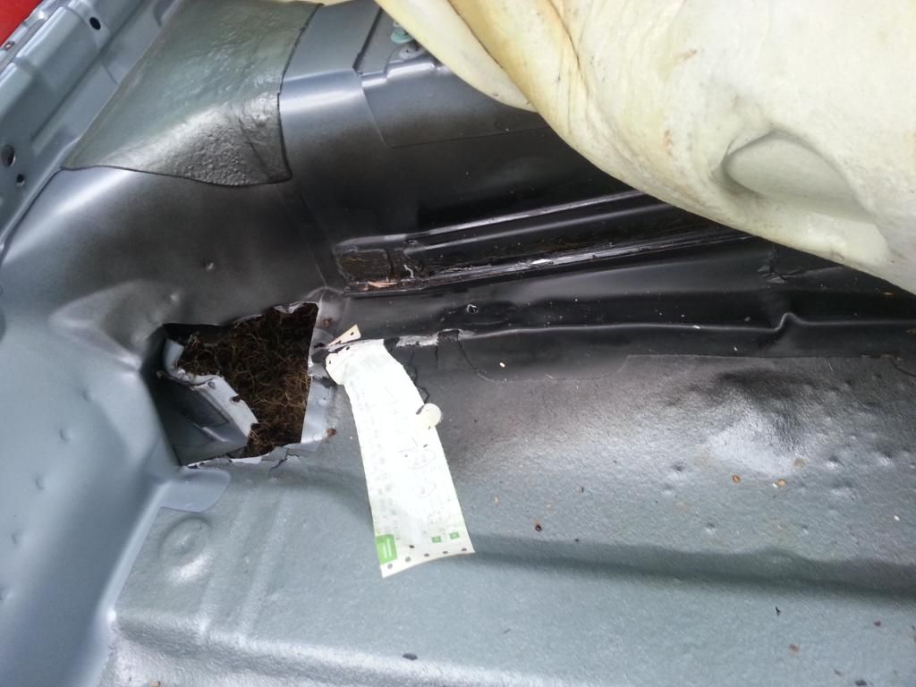

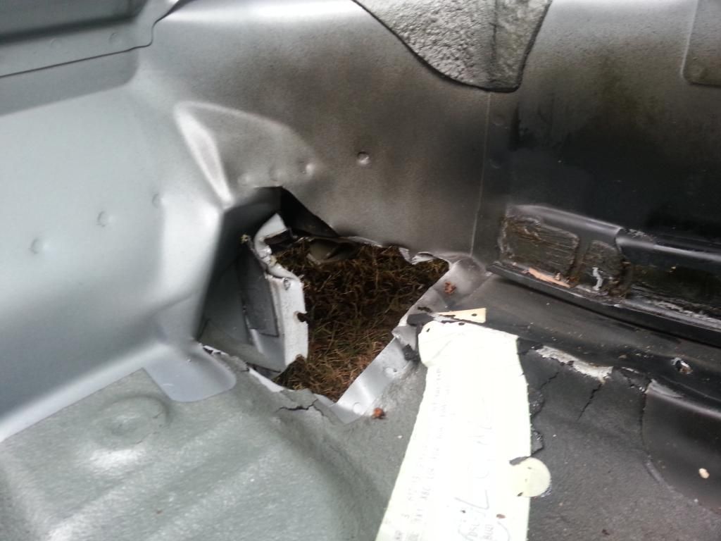

Now, the skulldragging part. I knew there was some damage.. I pulled back the carpet after taking the seats out... Definitely need some guidance with this part. I am thinking ill just cut a section from an a4 at the wreckers and weld it in on this one.

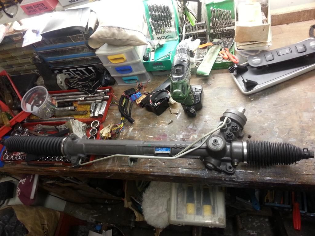

Also David gave me a BRAND NEW rack that he just happened to have sitting around.. Came brand new in the box from Audi.

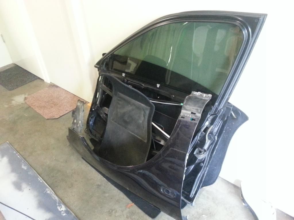

New door and guard.

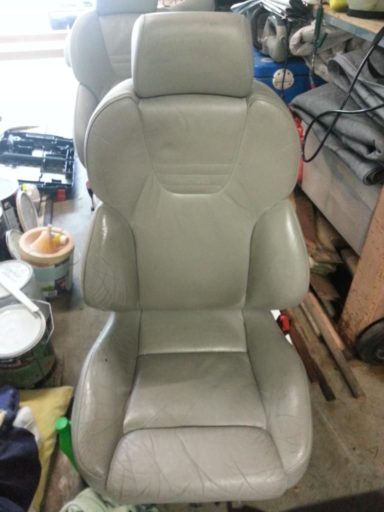

The old heavy Recaros that will make way for the ADR Approved Velo Seats, not sure how im going to get them on the stock sliders but ill figure that out later:
So tomorrow, I need to put the headliner back in, get the rest of the carpet out of the car and take some measurements to see how bad the floorpan is then cut that, weld that, bash that, buy that, built that, plumb that etc..

AWESOME! Can't wait to see this thing come together. What are your plans for the RS seats? I may know someone interested.

Where are you located? B5's didn't get those seats here, they came in b6 s4's

scubagli wrote:Where are you located? B5's didn't get those seats here, they came in b6 s4's
Old and grumpy.
Those look like B5 Rs4 seats no?
And now that Hank mentioned his location I'll prob pass on the seats, lol. US didn't get that sweet color paint either.

Yeah guys, they are the same as B5 RS4 seats. My friend who lives one street over has one, RS4 just have Alcantara inserts in the middle of the seats.
Haha, yeah Nick, I am down under. I actually sold the seats and am dropping them off this morning.
Have we got any panel beaters in here? Any ideas on the best way to go about that gaping hole in my floor pan?

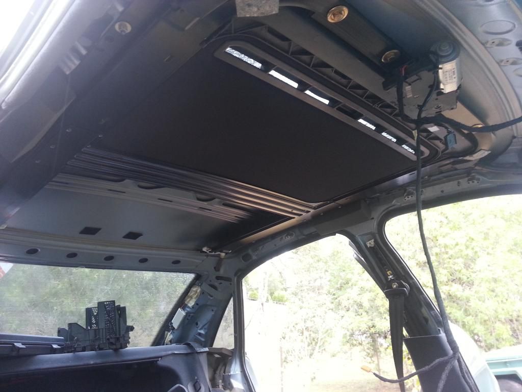

Got some more done today. Re-fitted the headliner, took the carpet out (shit job) and really got to see what needs to be done. I'll be getting my floor pan tomorrow, then will need to trim it up and mark the floor and get some cutting done.
