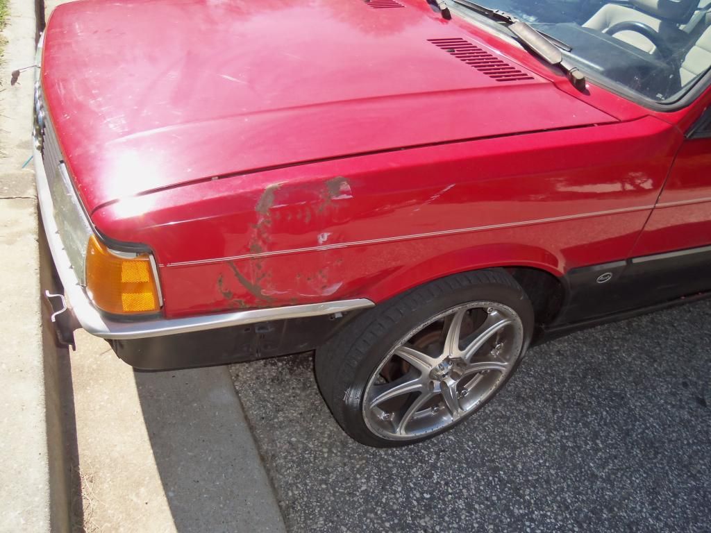

1.Lack of bumper, I clipped a chevy malibu in such a way that my bumper hooked onto the malibu's rear fender and got torn right off. As a result the 2 stanchions that the bumper attached to from the front are bent, and the plastic clips on side of the bumper and fender are ripped to bits also. I'm trying to figure out what to do with it. I have the actually plastic from the bumper in my back yard but the metal frame was completely mangled. My Idea was to make another frame for the bumper and to get the small plastics 3d printed as the ones on the other side are still intact and are just a mirror of the broken ones. Anyone have any ideas or experience with that sort of thing?
2.Dented/a little rusty front left fender. It was hit prior to me buying it. The only thing I did was take it off and punched out the dent to make it a little less bad looking. Now this sort of ties into the prior issue in the fact that the bumper attaches to the fender, but I want to get new fenders for it too. I guess the ideal way that I would want to do it is by replacing both the fenders (the other side is totally fine but I like to be symmetrical while repairing things,) and figure out the bumper attachment. Thoughts?
3.Front right strut is shot. A lot of potholes opened up in the spring and summer on the roads I drive on and they happen to all be on the right. This one is easy, just something I want to do soon rather than later.

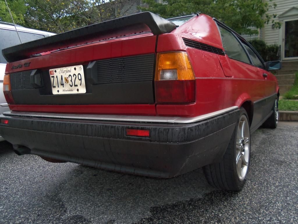

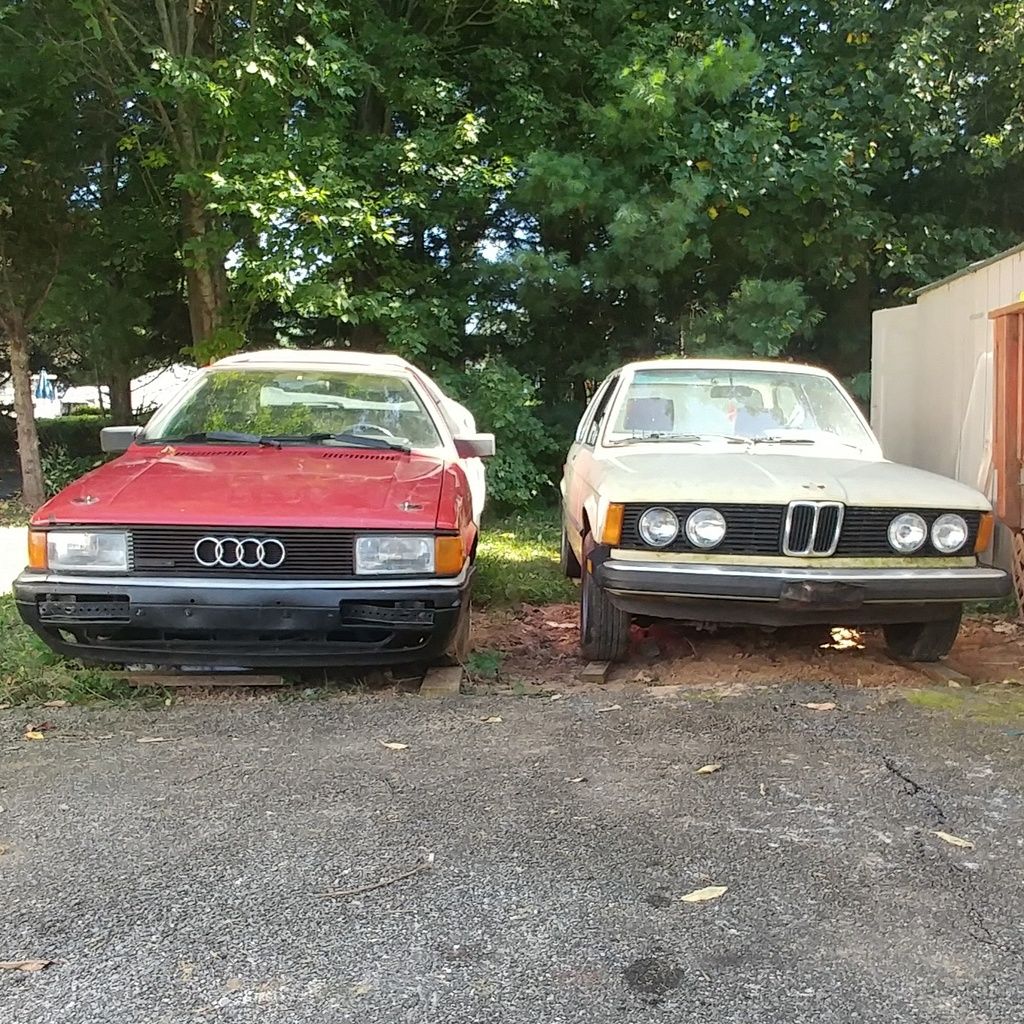

Sorry I haven't been able to follow up on the first post till now. I've just been incredibly busy the last few weeks but anyway, here are the pictures I was talking about.

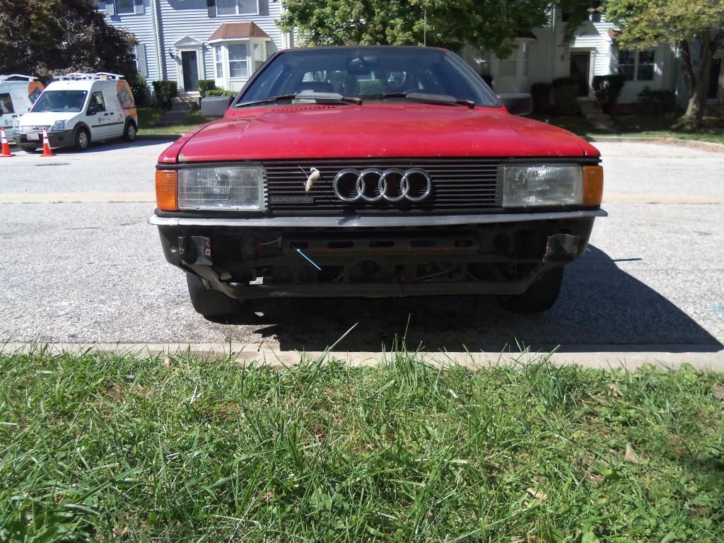

My sister thought the quattro badge would be hilarious, I agree.
2.2 5cyl NA

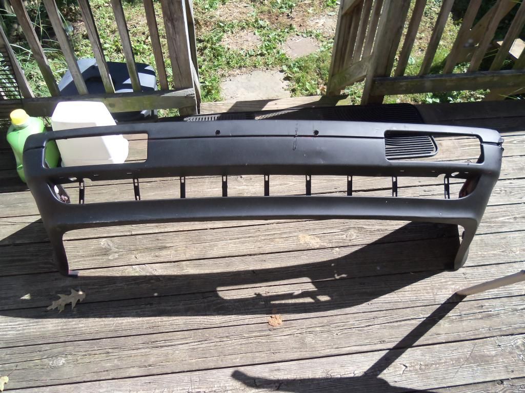

The Bumper

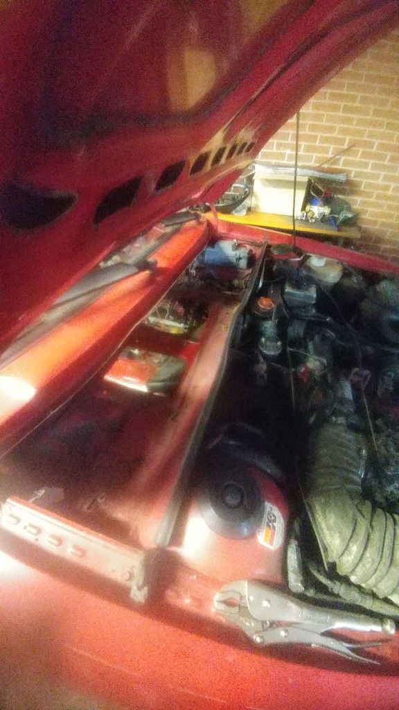

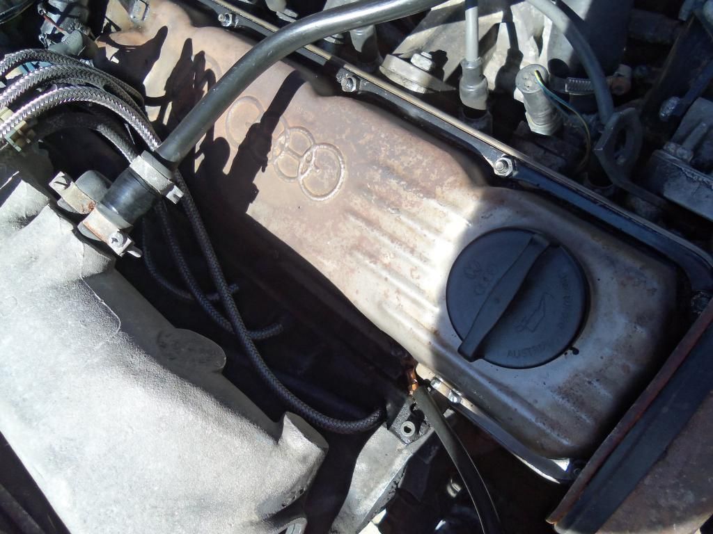

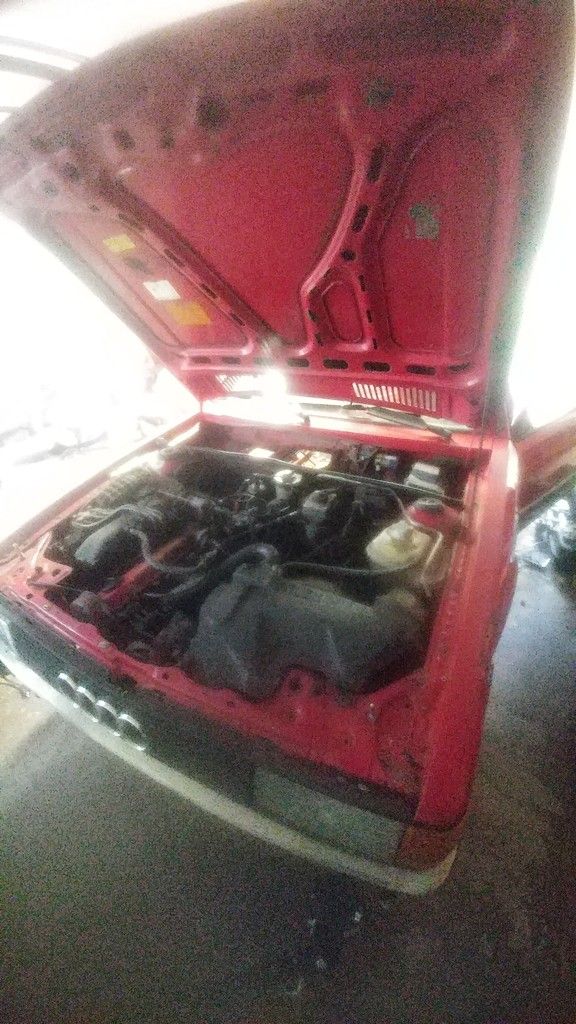

Small sheen of rust has been forming on the head, I need to replace the valve cover gasket soon so I was thinking about taking it off, cleaning it, and painting it before I put it back on. The discolouration bothers me.

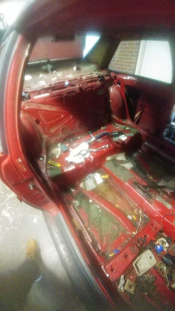

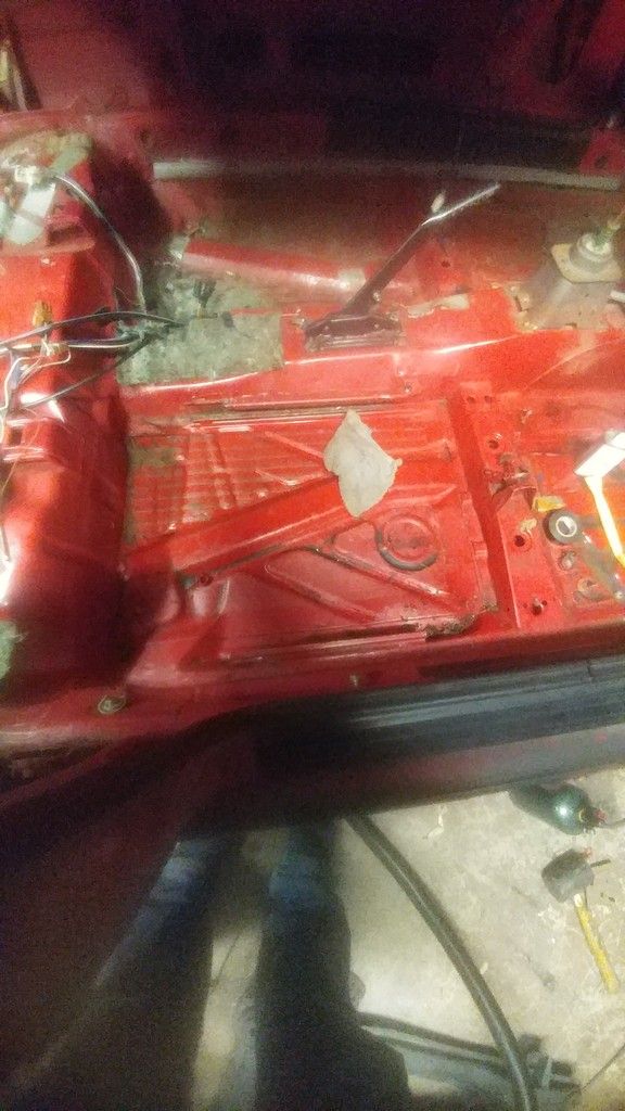

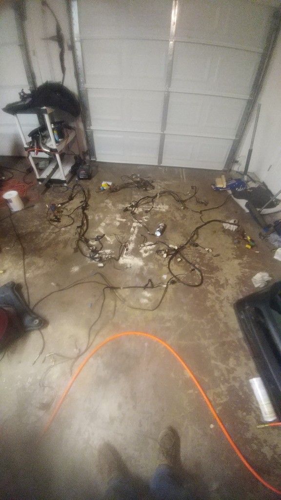

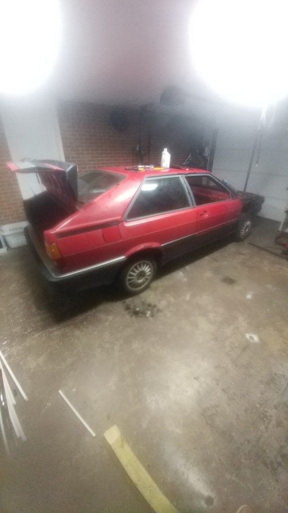

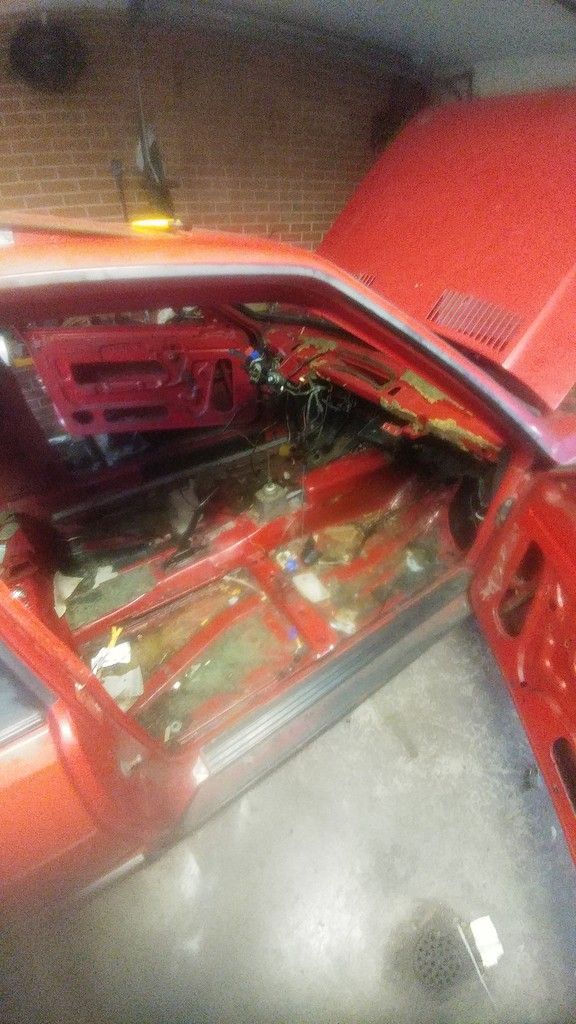

When I got her back to my house I got right to work pulling apart the interior and cataloging all the parts I'm going to keep, and what I'm going to sell (for dirt cheap, I'd rather see the parts going to people who need and will use them rather then throwing them out or trying to rip anyone off. Post of that coming later to the swap meet section!)
Next was all the ancillary stuff and sorting and labeling wires!

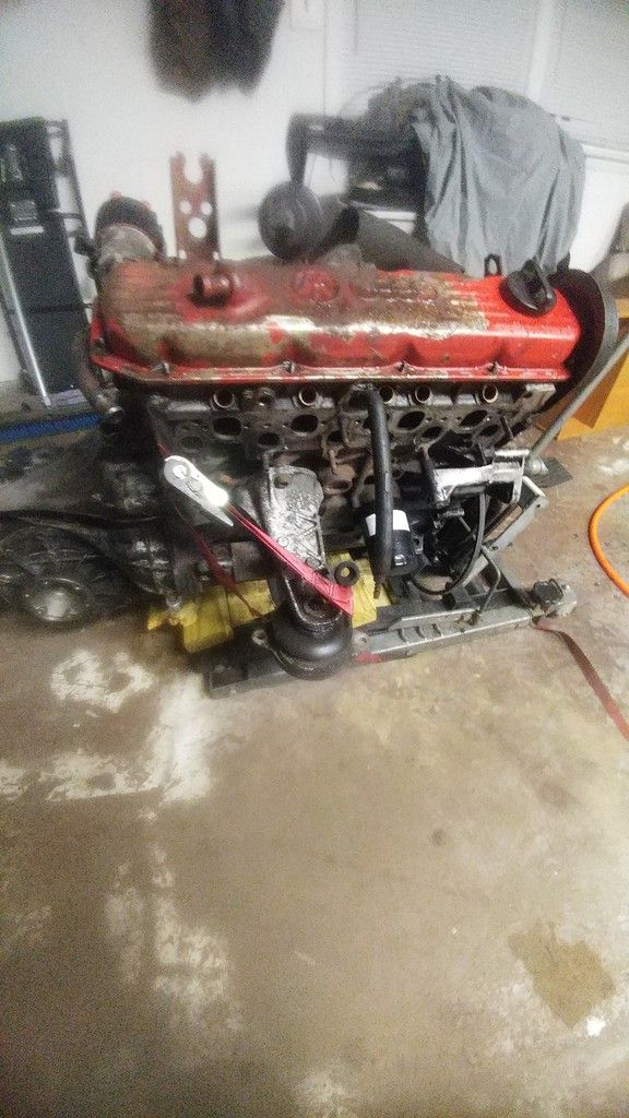

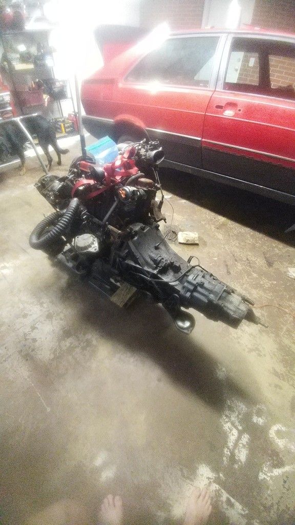

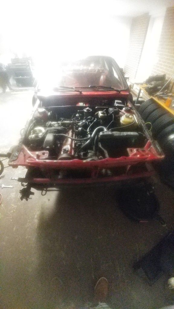

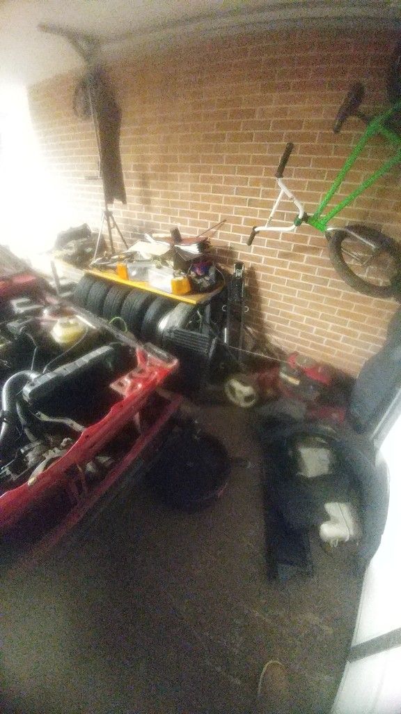

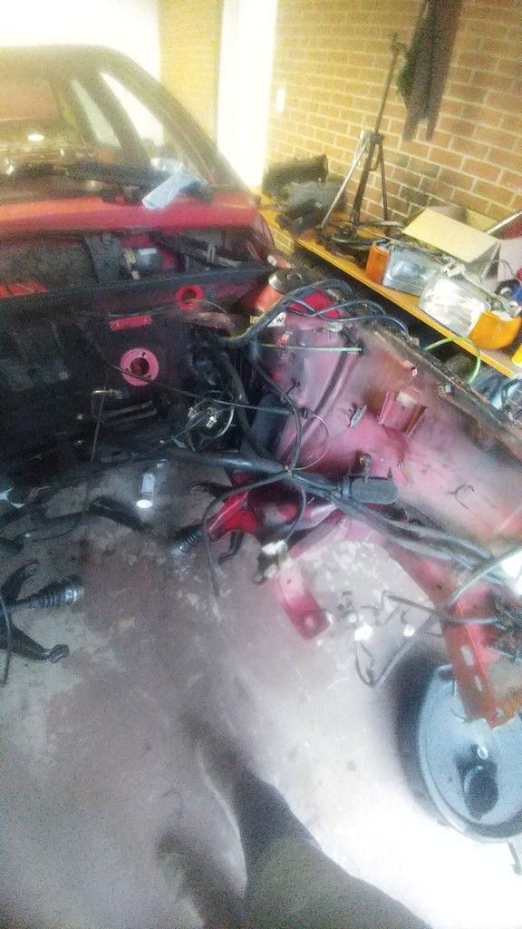

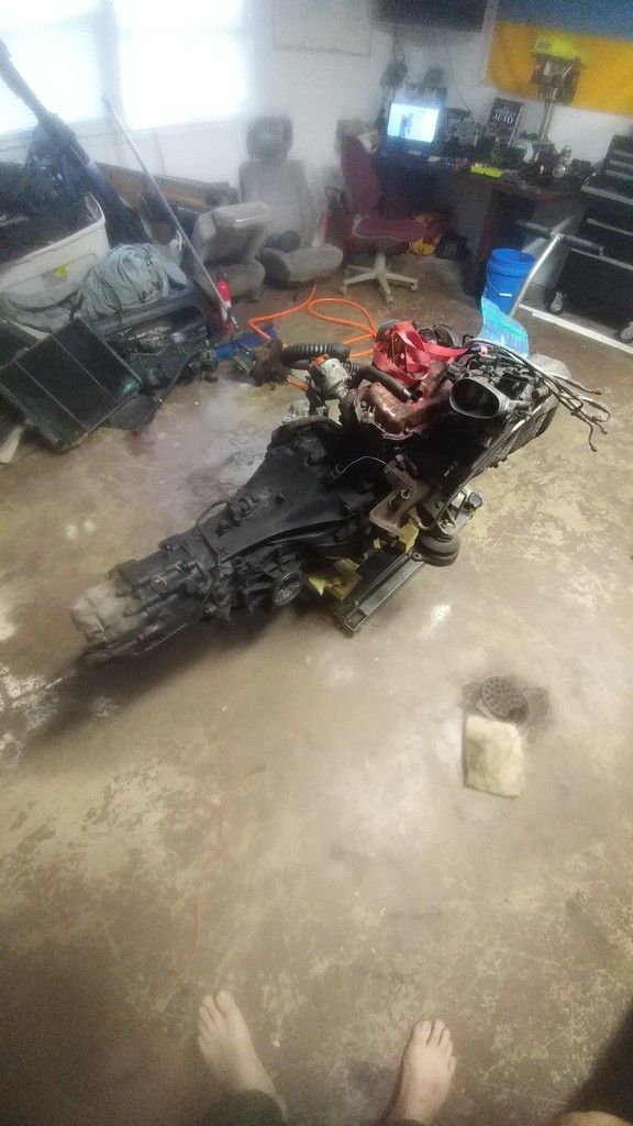

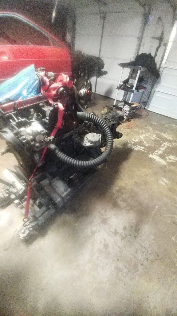

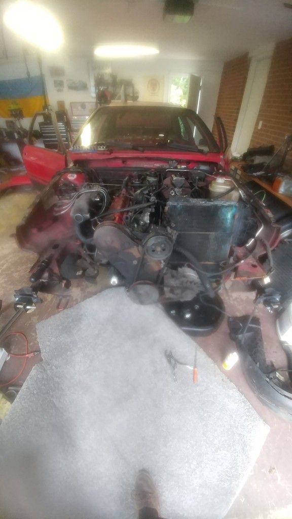

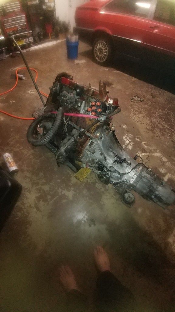

After that I yanked the drivetrain as one unit.
The bag has the bolts to the subframe and engine and trans mounts. Important stuff!

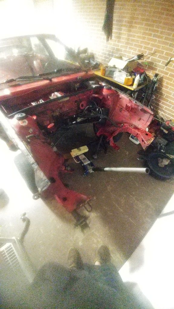

Next I'm going to be pulling off the accessories and manifolds from the engine and running my boroscope through and see if I can see anything is damaged from that perspective. As you can tell the valve cover needs to come off so I'll get to see if anything is busted up there. I already have another one prepped for painting. There was no metal or water in the oil so I would expect it to be salvageable. All the accessories will be cleaned, disassembled and painted. Everything is getting new gaskets and seals. The fuel injectors will all be cleaned and tested. I will then run a compression test again and hopefully I don't have to get it fully rebuilt! Not a lot of extra money lying around so I'm trying to save where I can and I would love to keep my KX going. There's a lot left to do for chassis prep and wiring, mostly cleaning, labeling and tidying up. I'll be posting updates as often as I can. But I'm happy to be back on the forums and back in the car! I'll find my camera so I can get better quality pictures up as I go throught the paces and I'll actually write up the current list of stuff to do in the next post. Cheers!

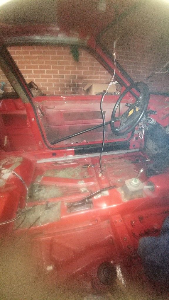

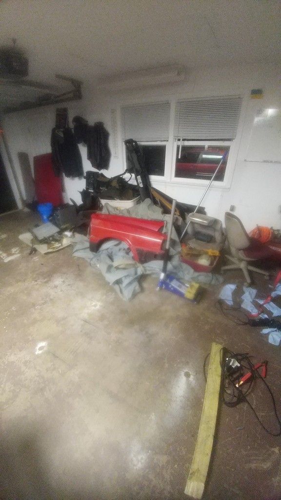

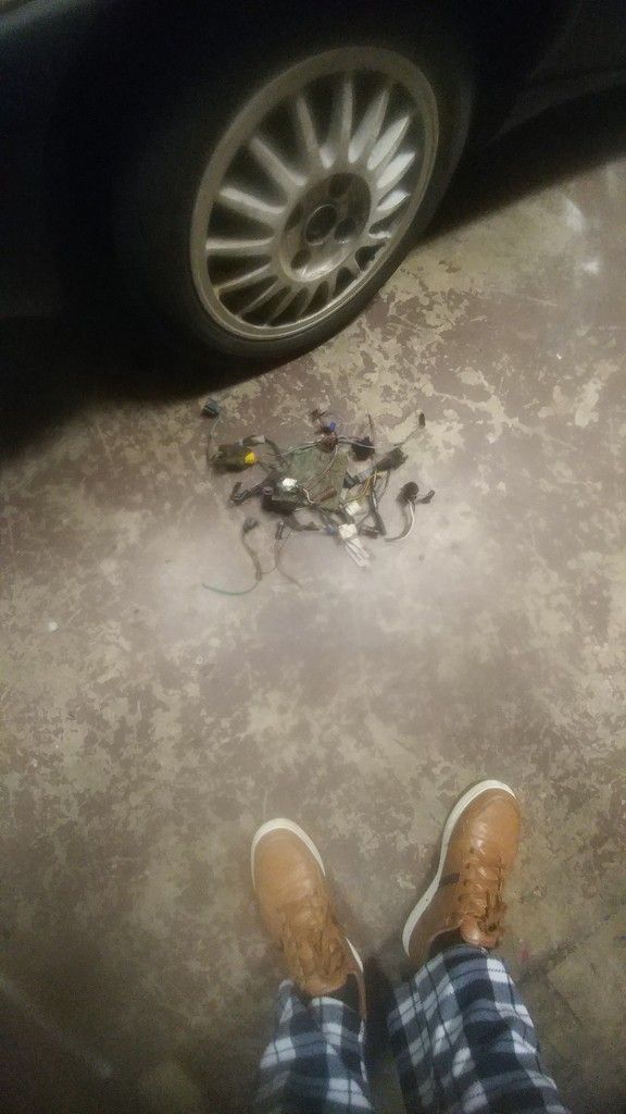

I've gotten a bit more done to the car, mostly prep stuff. I started a new job recently so I haven't had a lot of time to work on her when I get home. But I got the engine partially torn down. I ran my boroscope through and didn't see anything out of the ordinary, no bent valves, no scoring that I could see, just a lot of carbon deposits in the exhaust ports. Partially from being 30 years old, partially from running rich for a good bit when she was still my daily. I cleaned everything off but It will need a few more powerwashes and a bit more disassembly in order to wire wheel it and paint it. (The valve cover is unbolted, I just put it back on to wash everything.)
I also got all of the wiring out except a few things at the rear which I don't need to touch for the time being. More than likely I'm going to reuse most of the harness (definitely all of the CIS harness, I don't wanna mess with that,) deleting the unnecessaries and repairing a few spots. I could do a new harness ground up but it would take an incredibly long time and I don't think its needed.

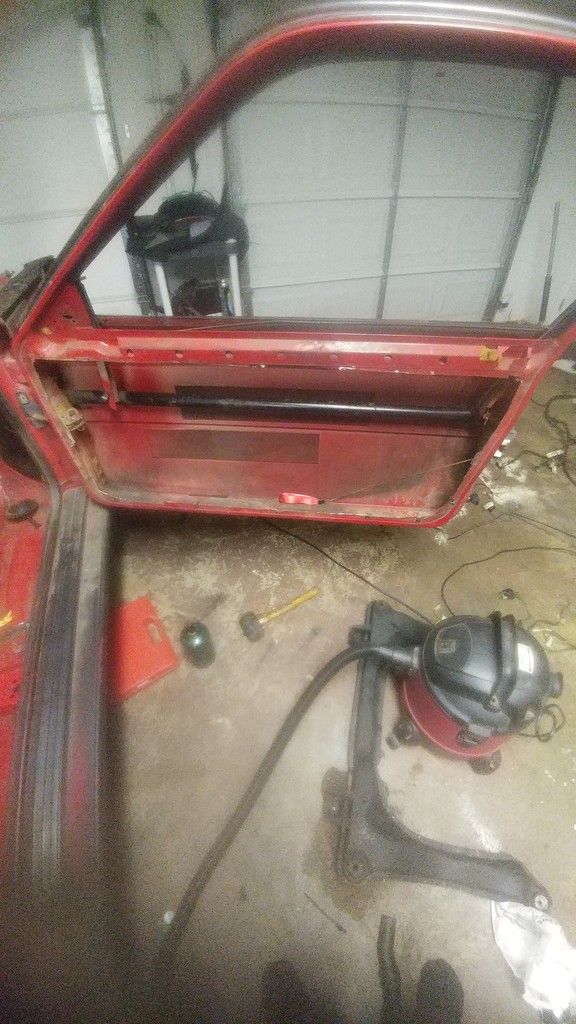

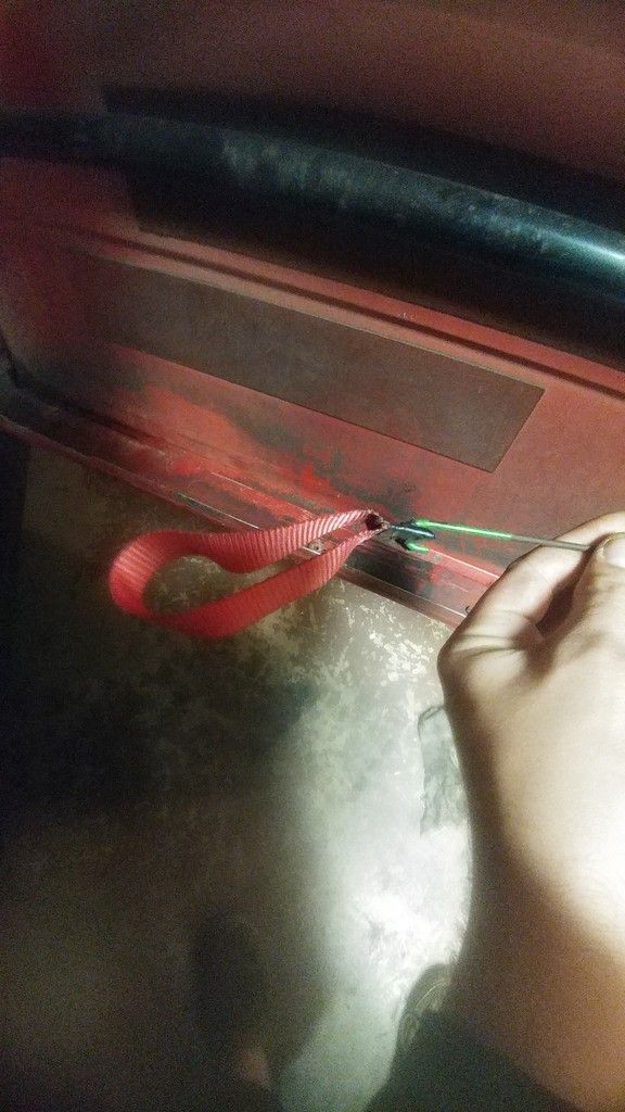

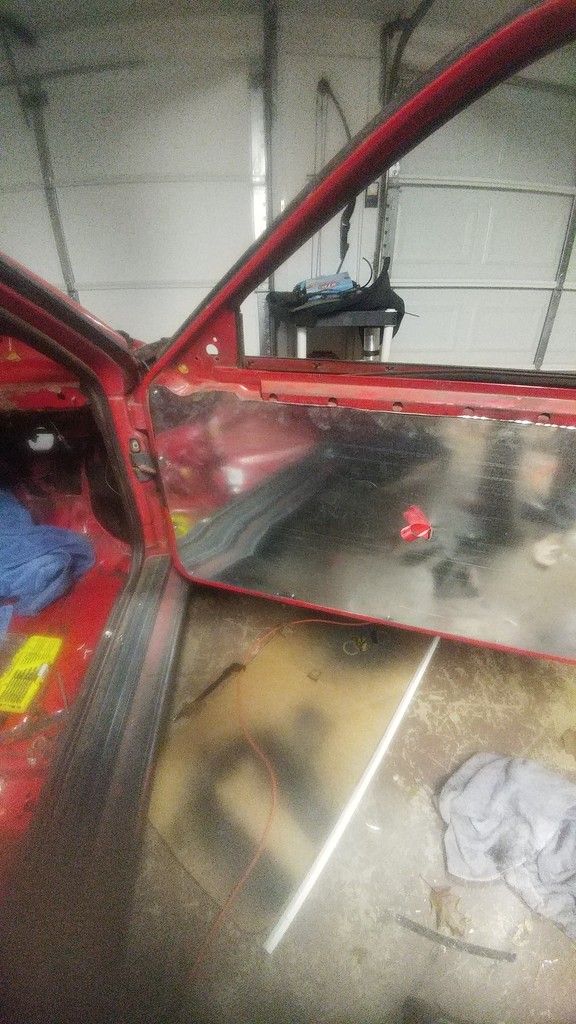

I cut out the inner door panels and got them ready for their new covers. I'll be using ducting steel because It's thin and cheap and the weight difference between that and aluminum is negligible. I already installed door straps, a la Porsche, which will poke out roughly in the center of the new panel. They will be cleaned and degreased before the new panels get installed with self threading screws so I can remove them for the Lexan window and new exterior door handle installation. The original exterior door handles are long gone and none of the aftermarket ones lasted longer than 6 months so I designed a different "handle" (it's more of a button latch) about 2 years ago that I never got around to building. Once I adjust the CAD files, make a few prototypes, then make some more adjustments, I'll make the CAD files available to anyone who wants them. I version I'm making for this car will not have a locking mechanism but my design also allows the possibility of a locking mechanism. I plan on making mine out of ABS plastic but It would probably look better in aluminum.
I started cleaning up a bit more of the adhesive and gunk inside the car but it's going to take a long time and a lot of scrubbing before I see any real progress.

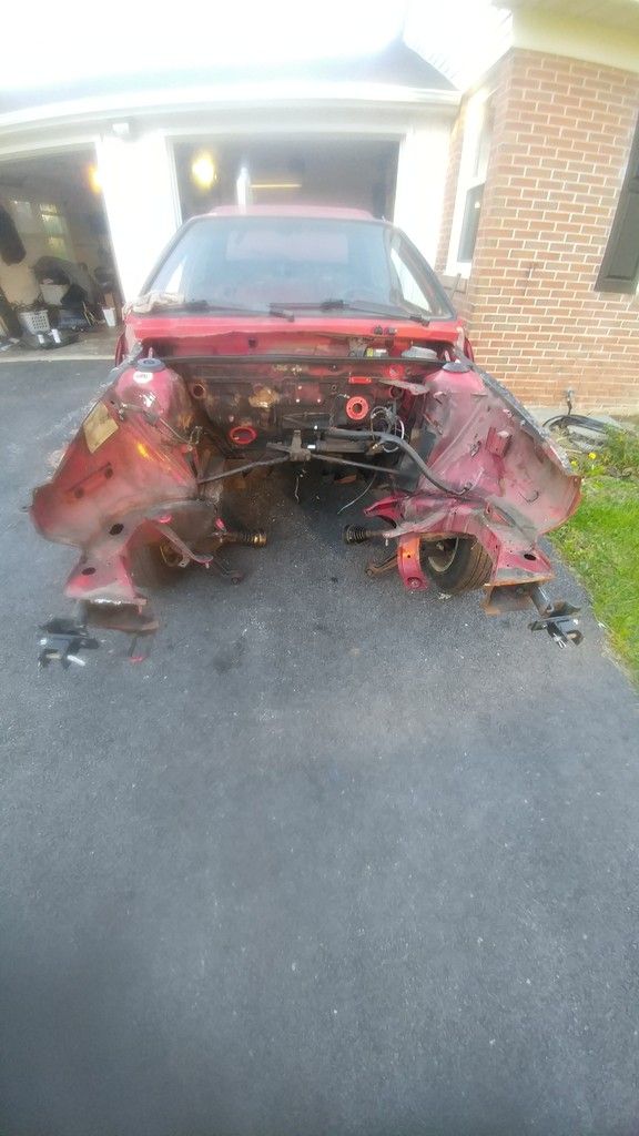

The last important thing that I did was to roll her outside and power wash the front end/ engine bay. I got most of the grease/dirt/road grime off but it's going to take a few more washes to get out the really old stuff. But I found out that the hose from the brake fluid reservior to the clutch master cylinder was originally blue and white! Useless info but still cool considering that I thought it was black, just like everything else in my engine bay. Exhaust leaks are great when they're coming right from the manifold.
Oh yea! I also cleaned and painted the subframe but that is outside drying and it's quite dark so I'll a shot of that for the next post!

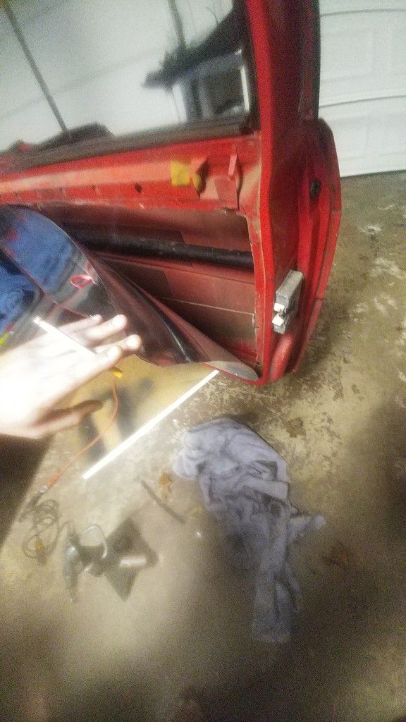

Haven't been able to do much more with her in the last few weeks due to a very hectic schedule but I did get a chance to make the door panel for the passenger side, which will just be mirror for the other side, but I have to come up with place to put a guide for the bar that attaches to the door strap before I close everything off. After that the last thing that will be done to the doors is Lexan windows and custom door handles! Image
