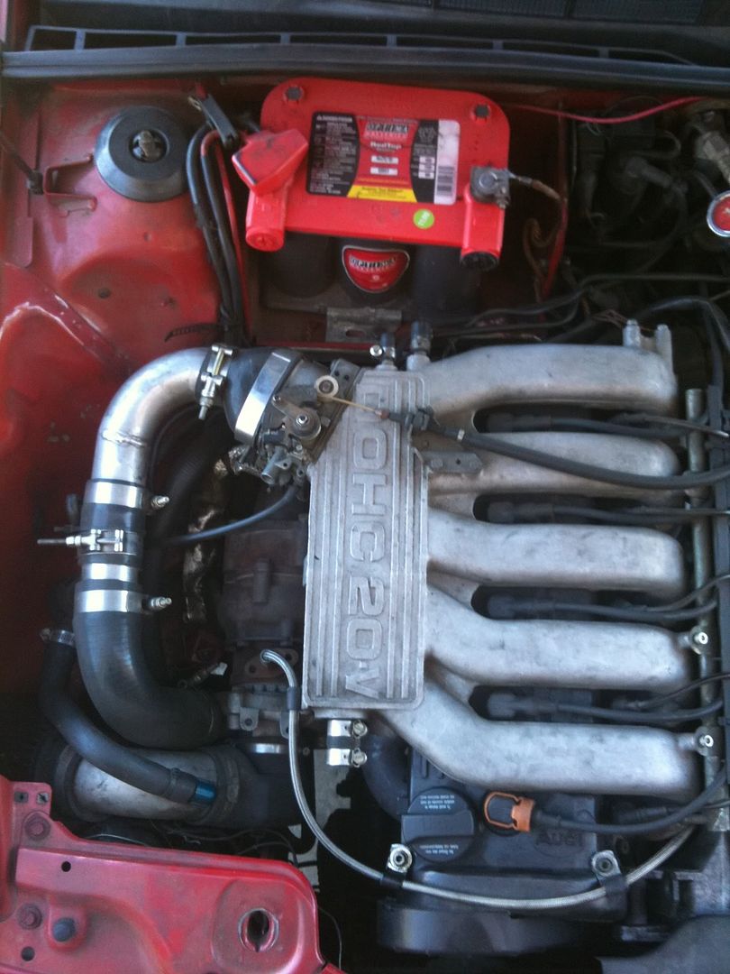

yes:
battery in hatch now
crank case venting now taken from the oil cap thanks to a special oil cap I made.
catch can is no longer needed so venting runs to the back of the car where it goes above this funny little bend that my rear sway bar has. Oh, and I used a DSM sway bar at the back and made some spherical links that attach to the rear struts that did not come from the factory with link provisions.
carbon fiber trim has been added to spiffy up (i am bringing that back) interior. (i had to make the CF climate control piece since they do not have that in Europe.)
i will be driving it a bit more and painting it to at least some degree probably next year.

Postby 3bAudios » Sat Oct 09, 2010 11:44 am
pkw wrote:crank case venting now taken from the oil cap thanks to a special oil cap I made.
any chance we could see some pics of this oil cap/ venting? i have a catch can on my NA stock 20v, also any photos of the swabar? i have a 4k in the rear of mine...

Postby pkw » Sun Oct 10, 2010 7:45 am
i will try to get some pics

Postby Mcstiff » Mon May 30, 2011 12:42 pm
How much hood clearance do you think you have with that oil cap?

Postby pkw » Mon May 30, 2011 3:29 pm
Mcstiff wrote:How much hood clearance do you think you have with that oil cap?
it is only as proud as the number one intake runner so a safe ways away from denting hood on launch :wink:
