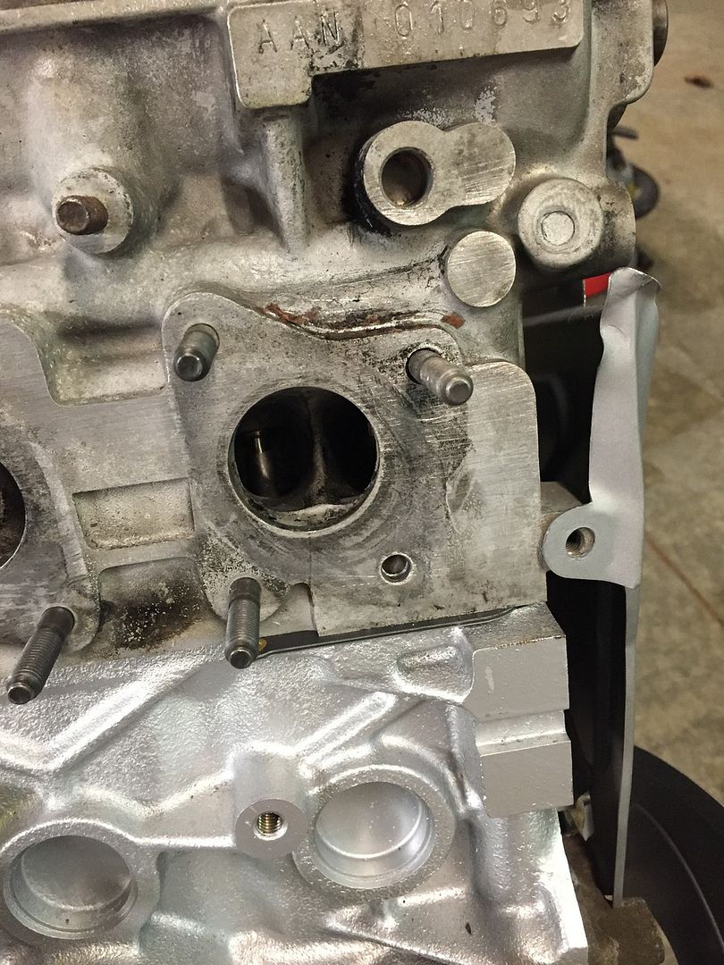

looks like you are using an AAN oilpan... why not the 3b? I thought even the URQ had interference problems with the AAN oilpan(to the radiator)...
Dave
Posts: 406
Joined: Feb 27, 2013
Re: Pat's 1983 URQ Alpine white #603 , 20V in progress
Postby Afterthought » Thu Oct 22, 2015 2:48 pm
Dave wrote:looks like you are using an AAN oilpan... why not the 3b? I thought even the URQ had interference problems with the AAN oilpan(to the radiator)...
Dave, I'll look and see if there is a P/N on the pan I'm running.
I thought it was a 3b? I don't know what car this engine came out of, it came with my project.
This pan has baffles but does not have that plastic tray below the crank and does not have a windage tray, which led me to believe it was a 3B. It "should" be fine with the radiator (if you're referring to the pan extension? ) it doesn't have that.

3b and 7a have the pan extention, to allow the same oil capacity but also clearing the radiator.

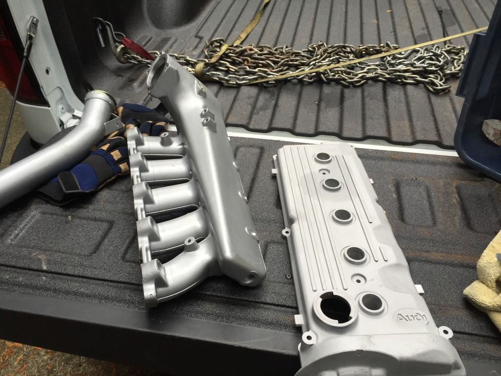

This is what happens when you think "I'll find a can or aerosol paint to touch up the engine bay a bit."
The result is a complete respray of the engine bay in factory color.
Engine bay was completely sanded and prepped, then wiped down with dirt and grease remover, wiped dry, blown dry.
Then wiped down with a tack rag. Then sprayed in sealer.
Then coated in factory paint.
Dave wrote:3b and 7a have the pan extention, to allow the same oil capacity but also clearing the radiator.
Well I'm all crossed up now. It has no number on it. So if it is an AAN pan, it id not have the windage tray. And also didn't have the plastic thingy that bolts to the pan. I have a pan I can use with the extension but its not all purty. damnit. Ill take a look at the general dimensions of the pans later.

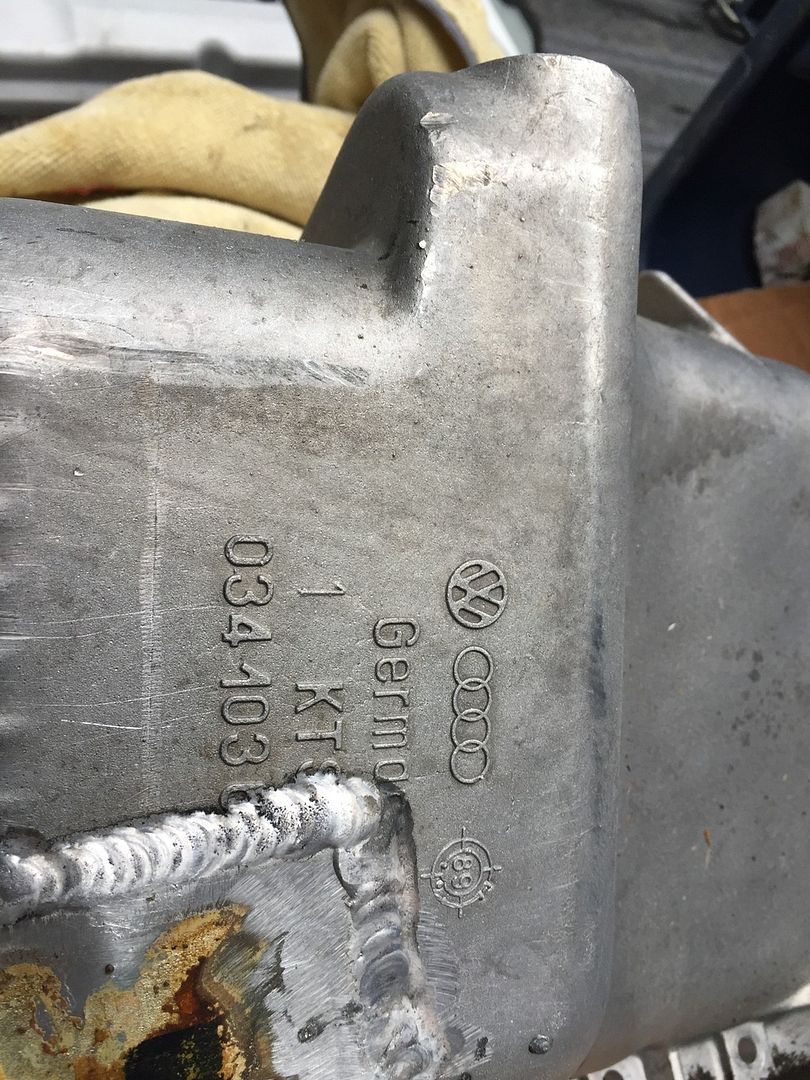

the pan you have should have a part number on the outside of it... My understanding has always been that all small chassis cars need the 3b/7a style oil pan to clear the side mount radiator. Hell even the larger chassis c3 needed it with its side mount radiator.

Dave wrote:the pan you have should have a part number on the outside of it... My understanding has always been that all small chassis cars need the 3b/7a style oil pan to clear the side mount radiator. Hell even the larger chassis c3 needed it with its side mount radiator.
I'll look again for he PN but after looking at it you're right. The pan is just a little bit wider , not much but enough to cause issues with the radiator.
I am going to see if I can get my spare 7A pan cleaned and flushed out. There is one broken bolt in it that I need to see if I can get out first. One of the 4 that holds down that plastic tray.

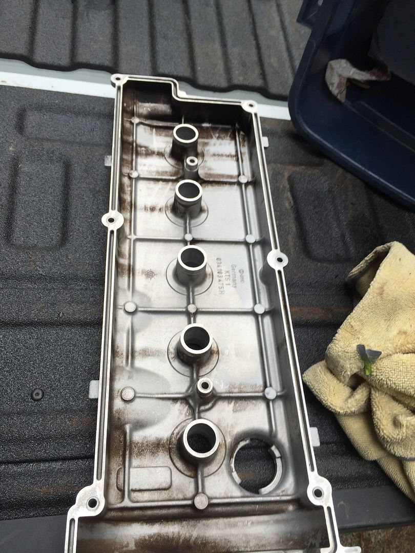

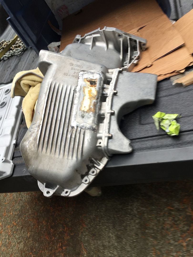

Postby Afterthought » Sat Oct 24, 2015 11:03 pm
Cleaned up some parts. Had to get my pan cleaned, the nice shiny one I had IS the wrong one. Thanks dave, glad i realized that now.
Still working to locate the proper pickup tube to go with the 7/a 3B pan. I dont know which it is because I can't see the part number.
The reason why I was hoping to fit the AAN pan.

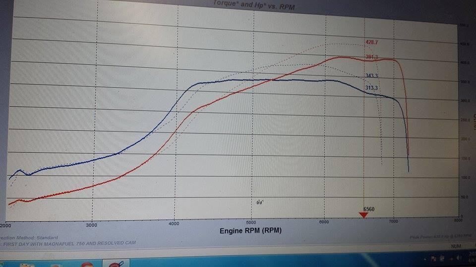

Afterthought wrote:Wondering if anyone has any ideas, looking at something like a Borg Warner 6758 or 7163 range, Garrett GTX3076? For some reason I am specifically drawn to the EFR 7163.
Previously ran a GT3071R (0.63 A/R) on my old coupe and was very happy with the characteristics of that. I wonder how that compares to these two turbos. I have a goal of around the 400 WHP mark, pump gas, but I wouldn't mind leaving some room for more someday. Looks like from the graphs I've seen the larger EFR turbo still builds faster than ever the GTX wheel garrett 3076. I don't really know how to study these things. Any thoughts?
When I did my research for turbos there was nothing for info on the EFR series save for a few posts on Subaru (Perrin Performance and FullRace) and Evo forums (Erne @ APR). Little if any hard data on the 7163 since it was brand new.
Rolling the dice, I bought one from Mike @ Ringer Racing and lent my turbo (7163) to Hank for testing. From there they've exploded in popularity. :D
Following are some quotes from Hank during the development phase, I'm sure they've refined the numbers since then.
Hank wrote:Yeah, the EFR is looking fun. I can't wait. My test car has a stock URQ intercooler in it which is proving to be a lag inducer, but putting it against a HTA3076r it is almost identical in spool. I anticipate a real intercooler will add 400-500 rpm of spool and make a ton more power. My guess is around 3800 on a 2.2L and around 3500 on a 2.5 like you are building. 07k I am hoping for around 3350
Hank wrote:Solid is HTA3076r on .82, dotted is EFR7163. Both done at 240kpa, or approximately 22psi. I can grab It will keep making power, I just need more e85
Hank wrote:All done on e85, but the boost is still at only 24psi, which should be well within the realm of what gas could do. The timing is aggressive, but I still think this is a 450whp on pump turbo. I just got back from a test drive with it, and it is a really neat one. Much more responsive than the HTA3076r on a .82 but you can feel the extra power, especially from 7000-8500. I have it turned down to 21psi currently so I can rev to 8500 instead of being limited to 7000 with 24psi( needs more fuel pump), but the power feels great. Especially pleasing the shift recovery of the turbo. Looks great! You will love this on a 2.5L

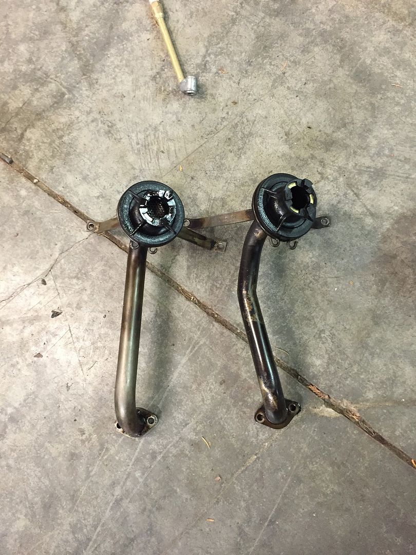

I found my other pickup tube. Digging through my shop to find a part is worse than it sounds. Alex has seen it, it makes me just want to throw away 90% of whats in there.
Anyways, conveniently, this one has no part number on it. Not sure how to ID but the one on the left may be what I want.

Also had to ditch the oil pan I had. It was a real piece of shit because the previous owner had bottomed it out. And in order to replace, he had used epoxy to seal on an aluminum patch then had it welded. Well, on the inside what I have is epoxy that's in a bonded state but Im worried it will heat up and break off and end up somewhere I don't want it. Could toast my engine in a matter of seconds, So its not worth the risk to me. I want to take my time with this engine and make sure everything goes together 110%
Was able to get another 7A pan with pickup tube so hopefully it ships in a reasonable amount of time.
old pan:
New "thingy" thanks Marc!

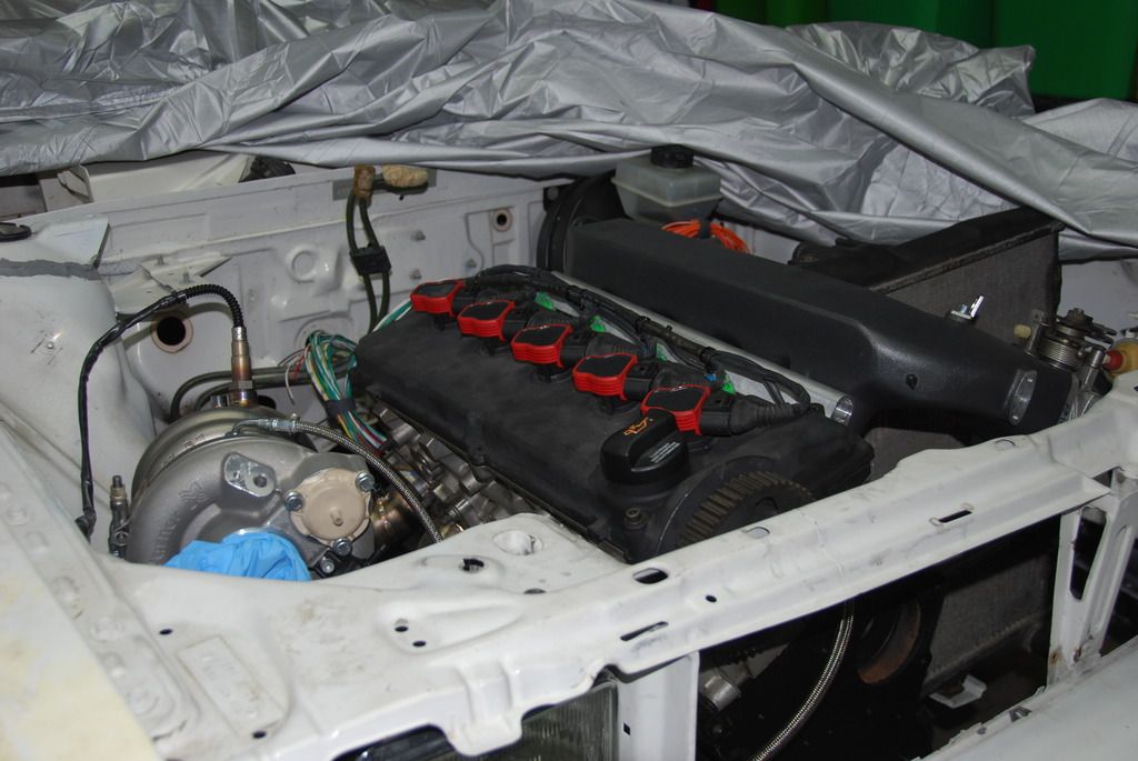

There is something that sounds good about alpine white, a efr7163 twin scroll iwg, a qsv, and an ur quattro. I like the way you think...
http://brydon-eng.com
Wheeljack
Posts: 314
Location: Ute Territory
Postby varia » Thu Oct 29, 2015 9:55 pm
Wheeljack wrote:There is something that sounds good about alpine white, a efr7163 twin scroll iwg, a qsv, and an ur quattro. I like the way you think...
omg! that monster

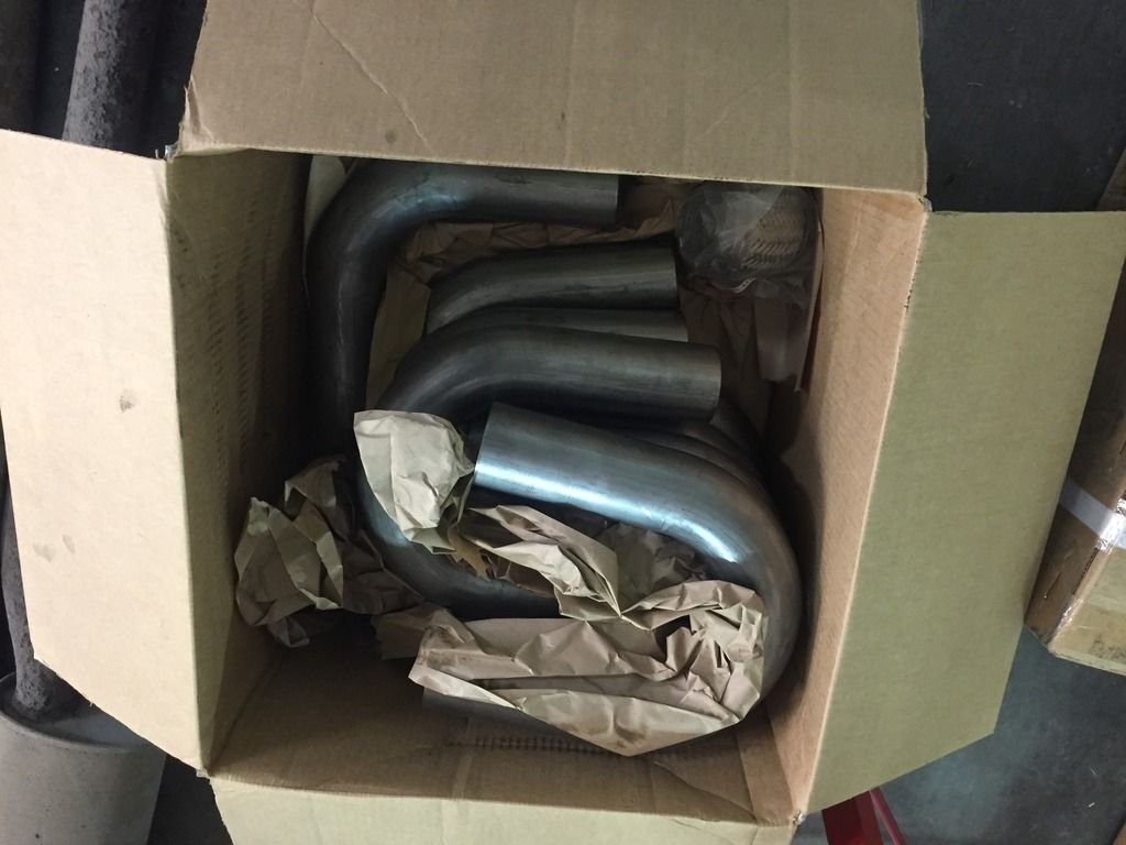

Postby Afterthought » Sun Nov 15, 2015 5:11 pm

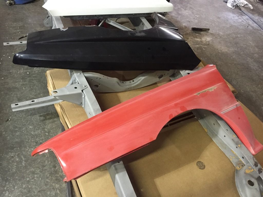

Well haven't had much progress due to a project at work but been sourcing parts here and there. I have almost everything I need now to go back together proper except:
-Brake Prop valve
-Coil pack set-up (will probably get LS2's from Marc)
-Turbo (Still thinking ERF7163, V-band inlet-outlet, only downside I see to that is I can't do the twin scroll with V-band)
-Koni Struts (on the way from marc)
-AFR gauge
Got my fenders mostly finished prepping.
I have two spares that I paid an arm and a leg for, sent a message to Hank to see if he might need them in trade for a discount on some parts but no reply.. So if anyone is in need I have a set of two fronts, one helios and one red. Other option is to just keep them, you never know when a 4000 or something will come along :)
Lots of good stuff has arrived:
Tommis billet cam gear, Stock AAN CPS, Clutch Slave cylinder and line, Clutch Master cylinder, tie rod ends ,
FPR. Dont know if I'm going to make my own fuel rail or what.
Really swesome manifold I got from Lucidmatt. I liked this manifold alot because it has no provision for a wastegate so it's perfect for the EFR set-up.
Only issue is I can't do the 7163 on the T-3 housing so I may have this converted to v-band
Lots of 3" stainless bends, 4' straight, 2x 02 bungs, 2x flex joints, 2x V-band clamp kits
