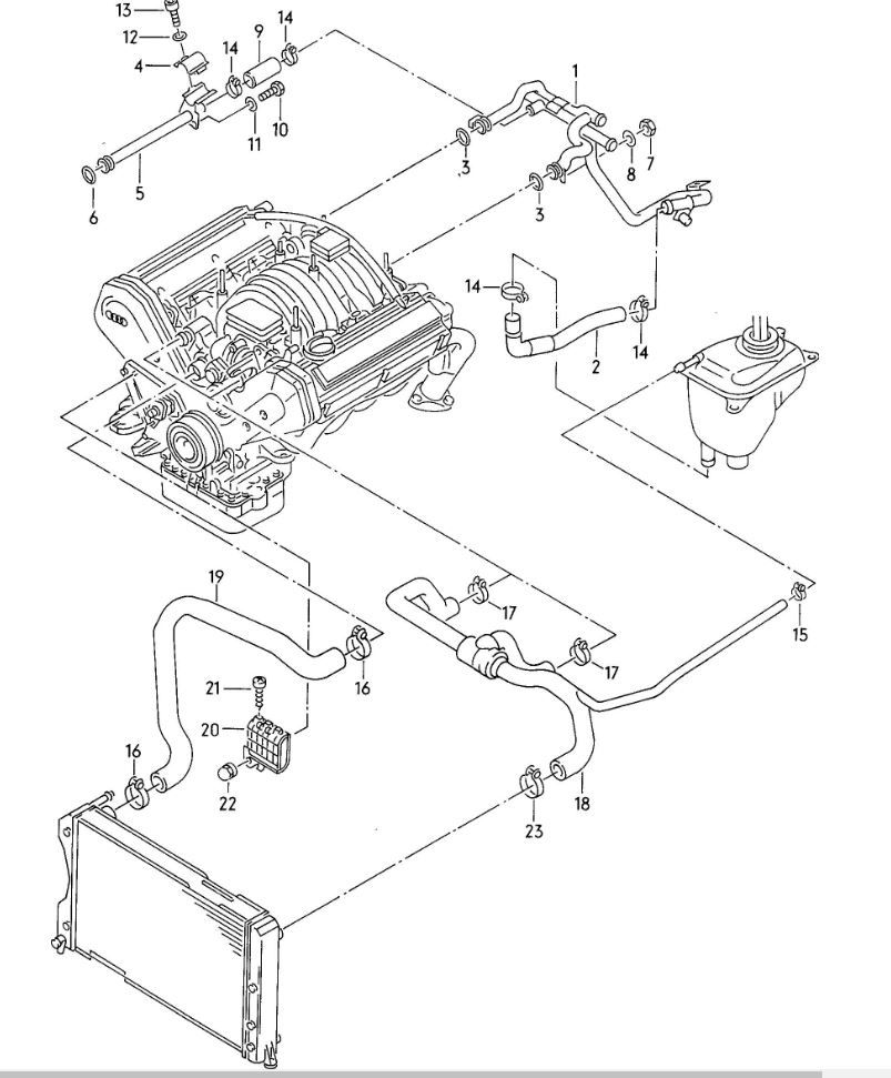

As for the cooling system... referencing this diagram:
All of it is very self explanatory, execept the line that goes to the oil cooler. I no longer have the factory oil cooler and juduging by what I see there is only one line going to it. Is there a passage in the block that Im not seeing that makes this a full coolant 'loop' and not just a dead ended line? I want to cap the nipple on the back left side of the motor, but I'm stumped on how there is only one line there.
EDIT: I found my answer, there is a port on the block towards the front I missed! Might try to use that and the feed line for what was the oil cooler for an external rad, since I want to stick with the stock V6 rad if I can for now.

Postby 90quattrocoupe » Thu Apr 27, 2017 8:57 am
This picture shows the water line on piece the back of your motor.
The passenger side lower inlet, runs to the holes in front of your external oil lines you are putting in. These lines were used to preheat and cool the oil, when you had the oil cooler and filter located there. Just put a short hose and plug that line.
The upper line on the hard line water line goes to the passenger side heater inlet. The other line point up is for the outlet side of the heater. The line going off to the driver's side goes to the bottom of the overflow bottle.

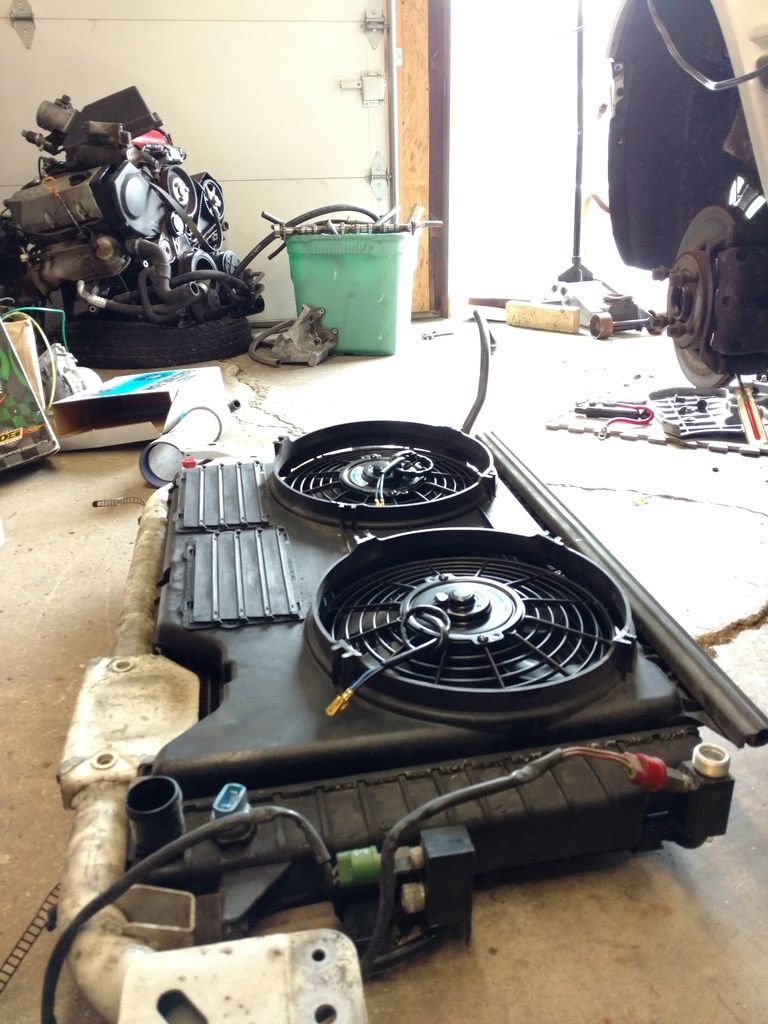

I didn't take any good pictures, but I managed to fit a few fans in the stock location, but mounting them on the radiator and keeping the fan shroud in place, but trimmed.
In that pic the fans are just set in, but later I did some trimming of the fans so the shroud would fit like factory, then proceeded to cut the circular part that sticks out towards motor. On the lower section of the radiator I think I gained at least 2 inches of clearance, so I was very happy about that.
After fitting the radiator with the alternator, I noticed that I made a big mistake! The pulley hits the nipple on the radiator. So... after a few hours I'm just about done with a new alternator mount, that uses a smaller A4 alternator. I hacked up the original anyway when I cut the oil heat exchanger out of it, so its probably a good thing.

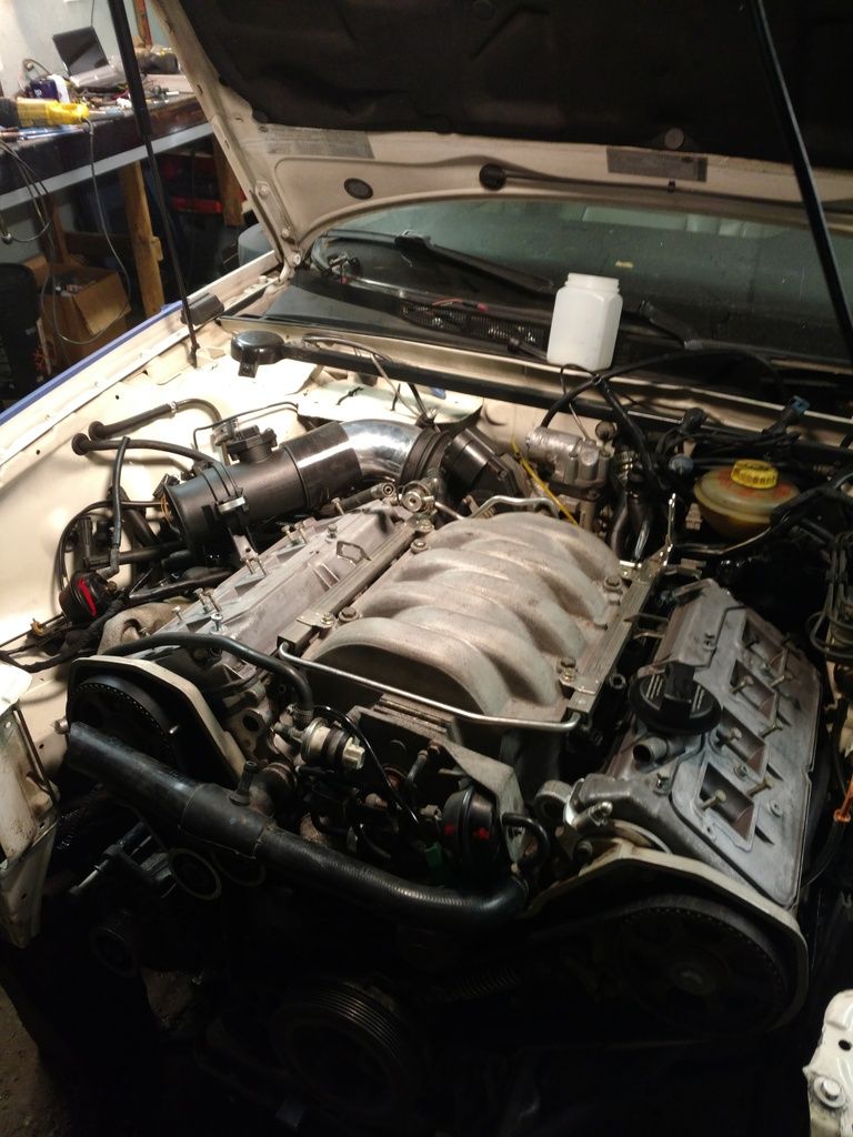

Postby lorge1989 » Tue May 02, 2017 7:31 am
Worked out my alternator mount last night just to realize the smaller one I had laying around won't actually work. The pulley uses a smaller belt than the ABZ, and I figured I could just swap the factory one on, but I didn't check the backspacing before swapping/making the mount. :shame:
Good news is, the mount was still usable and it only took a bit of tweaking to make work.
Cooling system is well on the way, finally a pic of the modified fan assembly. I also got the coolant port on the side of the block tapped for 1/2" NPT and intalled a fitting.

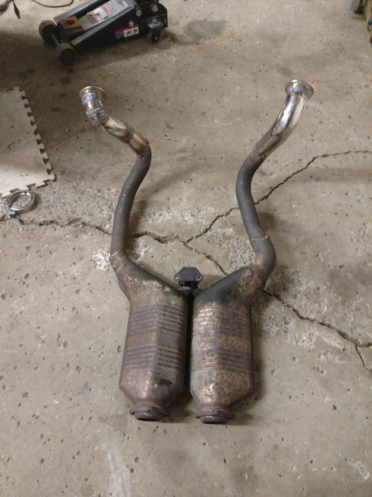

I struggled last night to get some sort of exhaust in the car before I start it again. My neighbor from across the street came over a few days ago wondering what I was doing because he said it sounded like I was building a street outlaw... My garage is already 150ft back from the road...
I decided to use the factory V6 exhaust as much as I can. I cut off the first 8 or so inches of the down pipes and mated some 2.25" pipes from the vbands I welded to the V8 exhaust manifolds. Took some pie cuts and a lot of tweaking, but it fits well and should flow well. I will fully weld all that stuff up tonight, and add O2 sensor ports.

I'm trying to keep the cats. They flow pretty well from what I can see, and I don't like a super stinky car. On the B4s the back part of the exhaust is much easier. Making the pipes over the rear axle on my B3 was not fun!

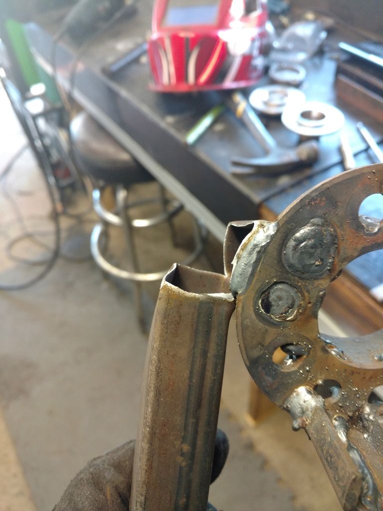

I decided to to tig it, even though it was going to take more time. I'm learning that without a backpurge setup there really is no point. Dissapointed with how it came out appearance wise. It should flow well, and fit perfect.

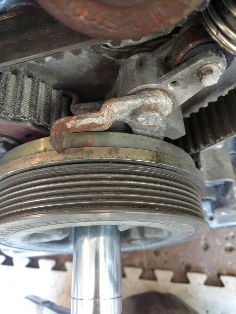

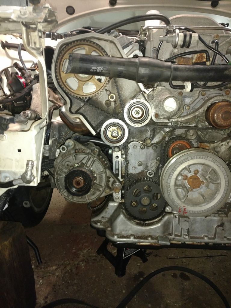

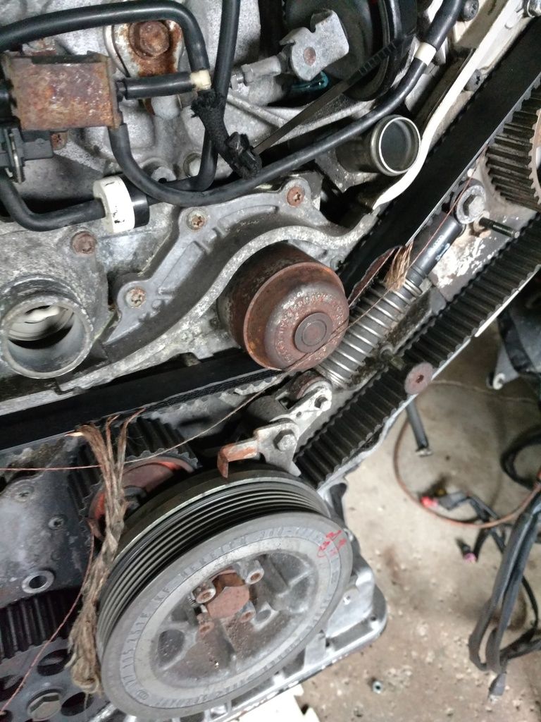

Got everything together besides the front of the car, in hopes of getting the engine running well before I started on the radiator. I ran the car for only a few minutes and this happened:
Luckily I had a friend there and avoided catastrophe.. I'm thinking the belt was damaged before and I didn't see it/didn't care. I ordered new everything and will tackle the tbelt this week.
DOES ANYONE HAVE THE CAM LOCATING FIXTURES FOR RENT/BORROW? I think I can get away without the other stuff, but I'd really like to have those.

Got the tools last night and got to work. First thing, the engine was way out of time. Glad I bought the tools.
Had a hell of a time getting that crank bolt out. My impact wouldn't do it. Made a fork looking thing that grabbed the internals of the balancer. First 'tool' I made:
Ended up welding a 2x3x.25" piece of rectangular tubing in its place to hit the ground and hold the balancer, while using about a 7 foot breaker bar. Finally it broke loose. Not before taking one of my breaker bars with it though. What a pain.
A timing belt cover fastener had fallen behind the balancer which is what caused my failure in the first place. :shame:
But the belt went pretty smoothly after that and the car started up, and ran ok. Thinking I have some vacuum leaks still. Somehow I'm going to get this thing to Carlisle... well hopefully.

After some help from a friend, we found out the motor probably was not out of time at all. The harmonic balancer has some rubber on the inside of it, used as a damper I assume, which over time dries out and shinks. This means the TDC mark on it, is not always right. Manually last night I found TDC which was pretty far away from where the crank said it was. More than likely the engine was in time before taking the timing belt off. After that was fixed, a few other issues were sorted and....
Coils 7 and 8 were switched in these vids so it wasn't running that great. :D
Still have a few things to tidy up before I really want to drive it anywhere, but I might just might make it to Carlisle with this thing.
