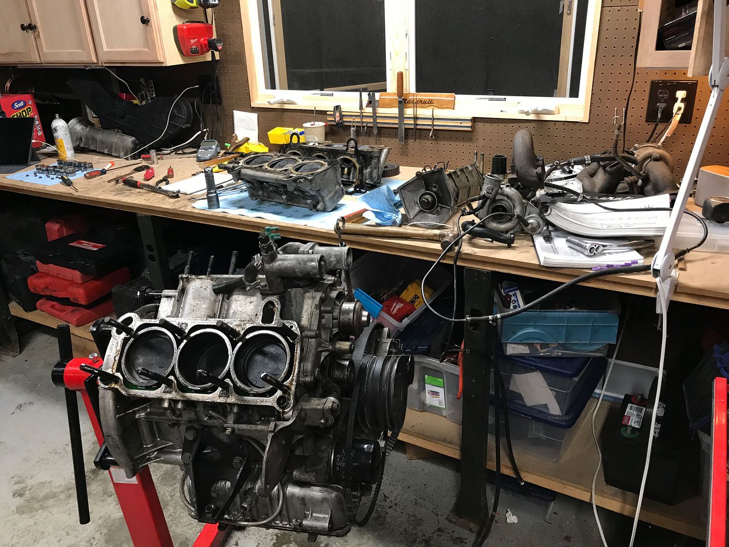

the scene in my basement:

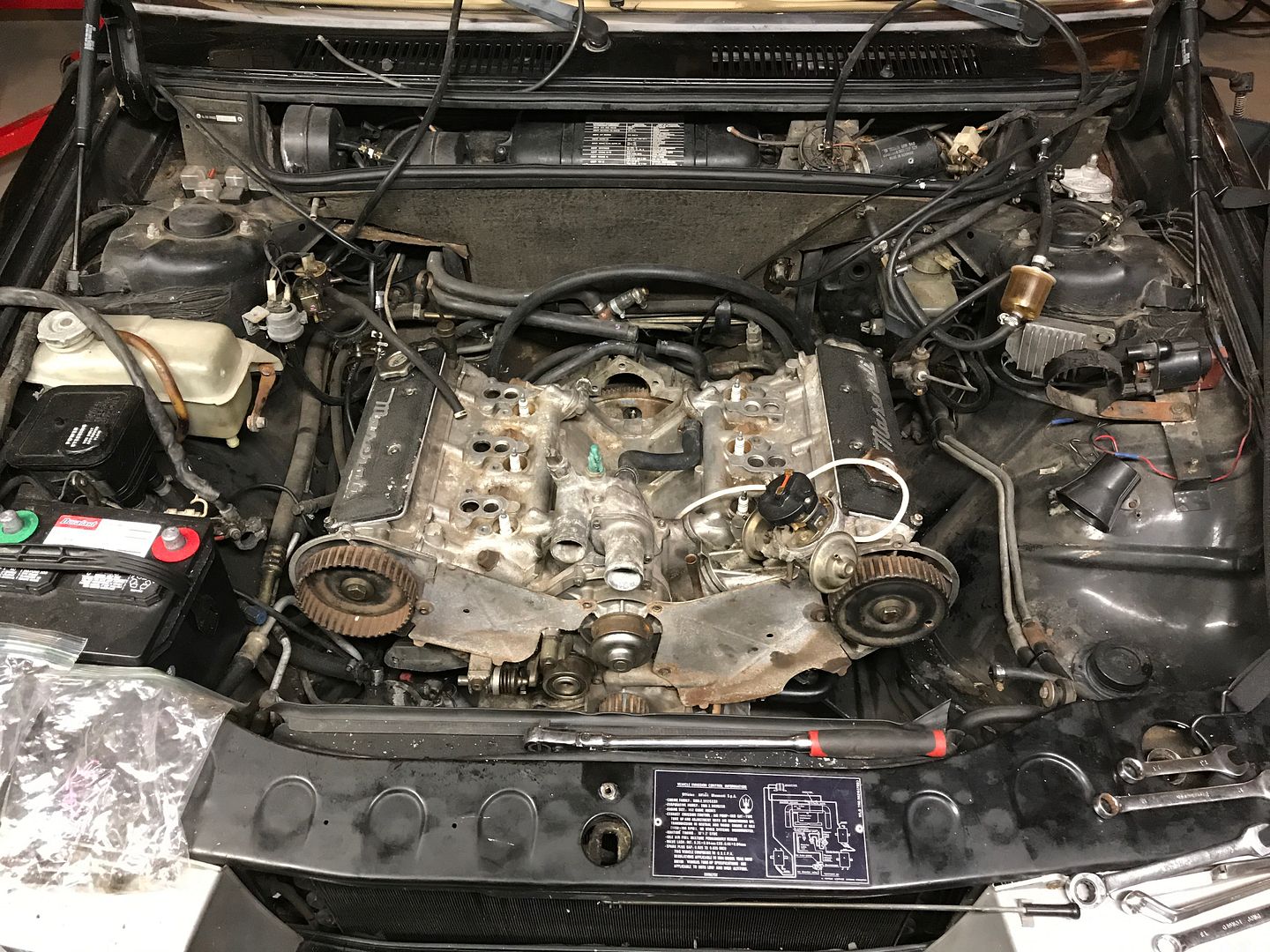

Had the chance to make a little progress yesterday.

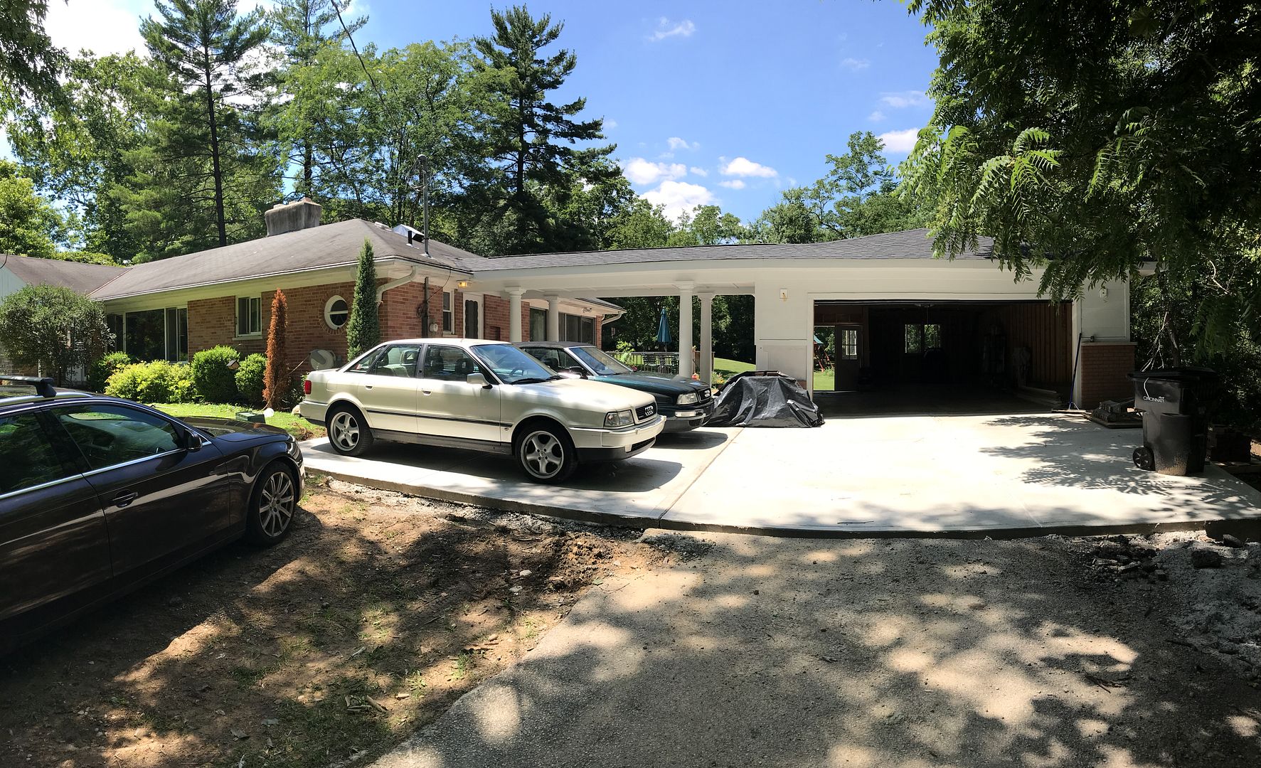

My yard is a construction zone right now with a garage being built
Anyway, I am moving forward with building up the spare engine I bought to put it in the car (once I have level hard ground again)
So I was able to Drill out the oil provisions that had been blocked off by the prior single turbo configuration
Another thing that wasn't obvious to me before is that I needed to figure out a place for the power steering pump. The '85s didn't come with Power steering at all but my '86 did. Happily this was pretty simple. The TB tensioner bracket doubles as the mount for that pump
Only thing was I had to drill into and tap the block for that rear bolt in the above picture. Thankfully, the block had the same aluminum cast flange (or whatever you'd call it) as the '86 did:
Voila!
Now to get all this stuff installed
These gaskets are literally just paper - the '86 engine had been put together with just RTV or silicone. no paper gakets. I might go that route to some degree

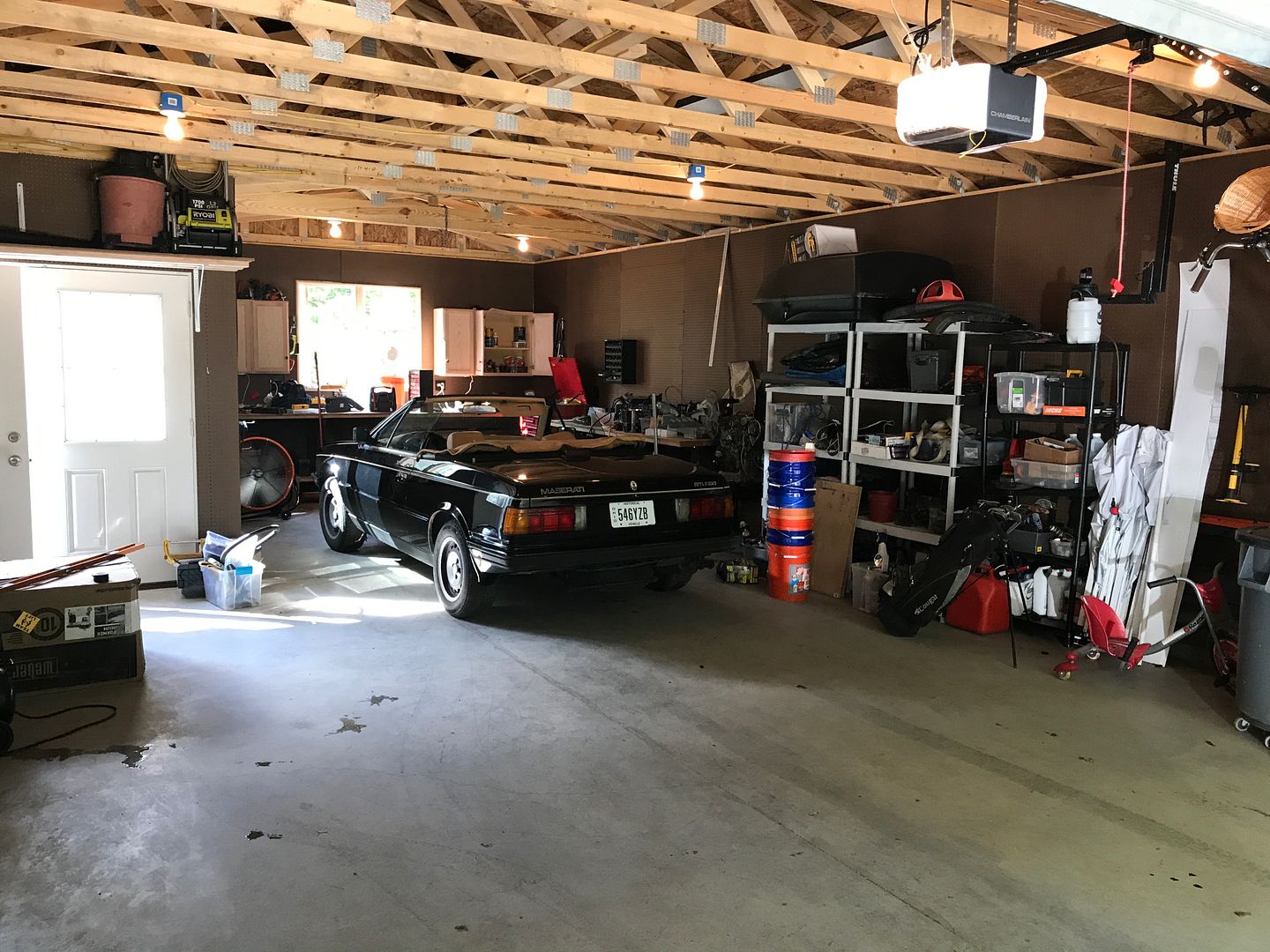

Finally able to make some progress on this now that the garage is done

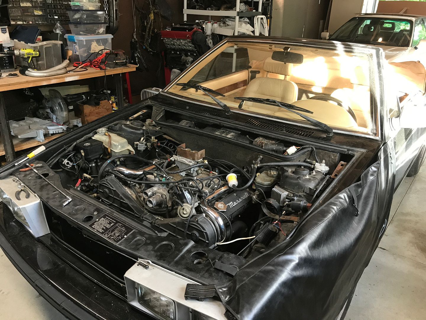

Here is the Maserati in its new bay:
anyway, I got the 85 engine put mostly together and back in the car tuesday.

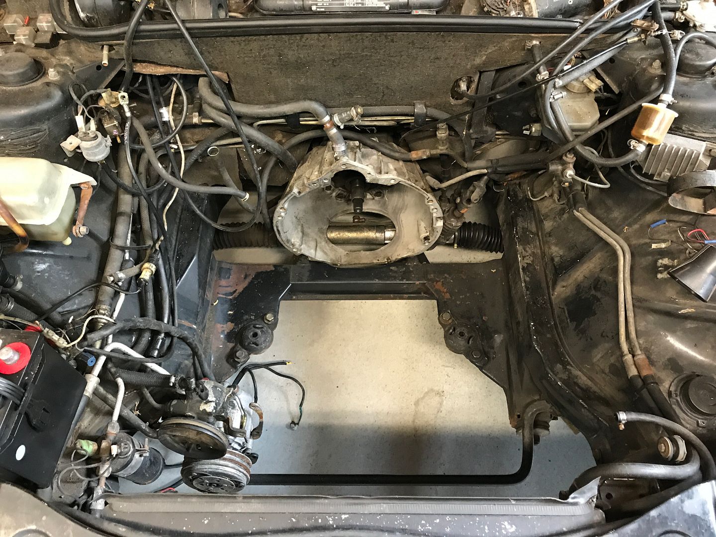

I cleaned the bay pretty well beforehand:
then installed:

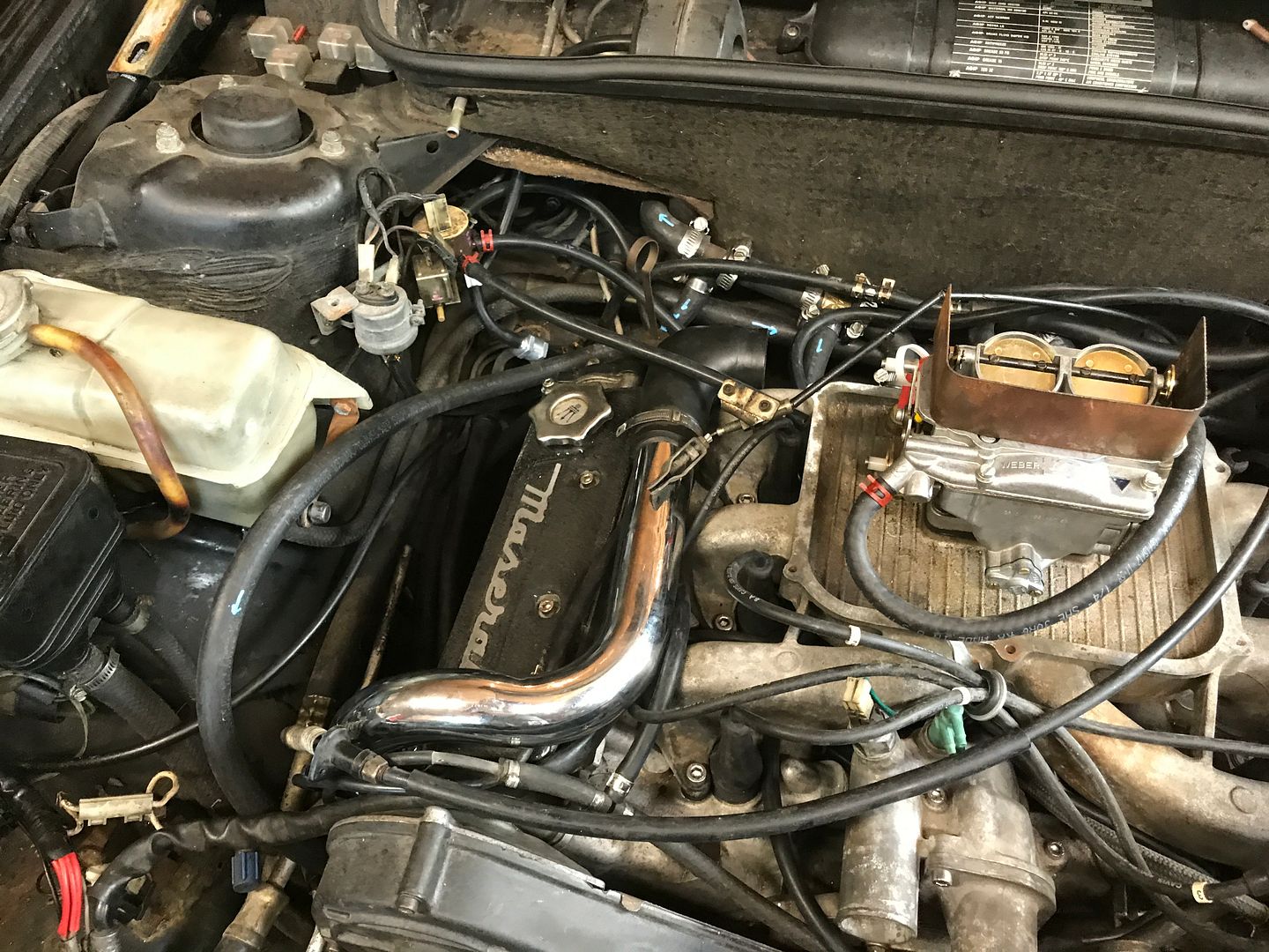

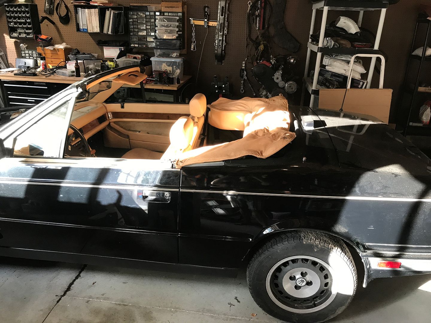

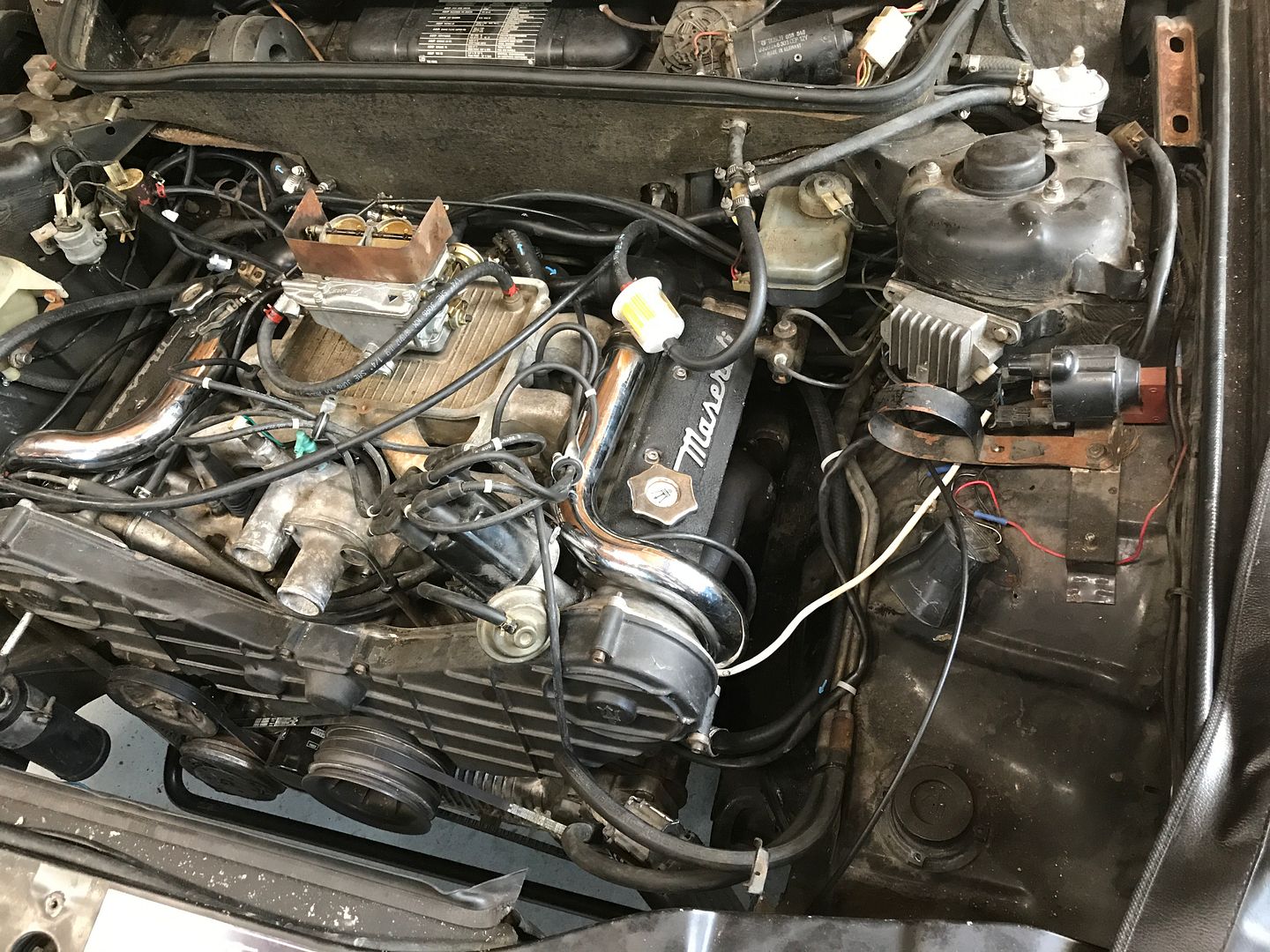

I've made a lot of progress now. I am waiting on a new set of radiator hoses (the '85 and '86 have different sized thermostat housing of course) and then I'll be ready to run the car, figure out the idle, flush transmission fluid and DRIVE it.
Some pics of the almost completed engine:
The car in my new garage:

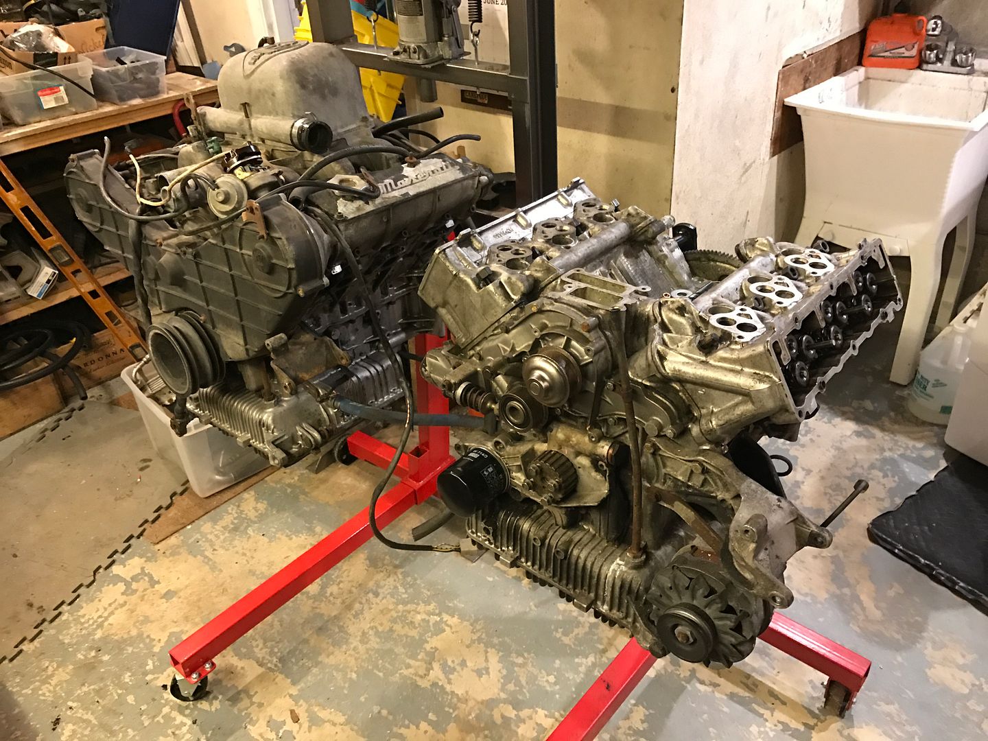

PostPosted: Sat Aug 26, 2017 12:10 pm
by Grillage
Pulled the engine this morning to assess the issue and I see that there is oil leaking into the exhaust manifold ahead of the turbo.
Since I have good compression does this mean valve stem seals?
Re: Ben's Maserati Biturbo Spyder
PostPosted: Sun Aug 27, 2017 8:02 pm
by Grillage
Well that escalated quickly:
