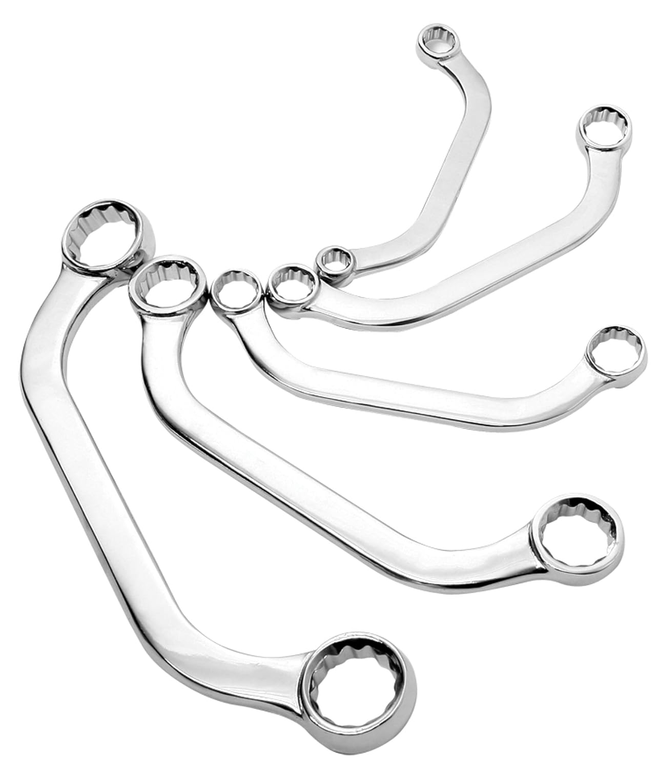

Postby IslandRinger » Wed Feb 27, 2019 7:31 am
morris400 wrote:This needs updates lol.
HAHA! Dude I know. I've been terrible at trying to keep a log of what I've been doing as well as taking pictures.
Life does not make things easy I tell ya! Even me getting back to your post has taken me a month :lol:
Here is where the car lies with some updates as to what's been going on.
As per norm, progress has been agonizingly slow. Between life at home, my work schedule taking me away from home (Month on-Month off), and crappy weather, I've only gotten a little farther than where I last posted.
I had previously done a timing belt job which mostly went well. All the usuals got replaced. I only had one hiccup that I'll have to revisit. I started up the car to bleed the coolant. Timing was quadruple checked before turning the key. Car ran well after being out of service for a while. After about 15 minutes of run time, the coolant was bled but I did hear a slight ticking noise. Fearful, I shut the car off immediately. I dug around and found that the new belt had shredded itself! :bangshead: If I had run the car for another few minutes, things might have been slightly different on this post. From what I can see without taking everything off again, I have a suspicion that the belt was rubbing against the cover. I'm hoping it'll be obvious when I pull jewelry off... again. FML!
I soldiered on with the other work that was on my list, not wanting to deal with the timing belt issue again for a bit. I was at a point where I knew I would have to replace the clutch and I was looking at the Southbend Clutch kits from Marc at EFI. I wanted to potentially "upgrade" to a SMFW as well but EFI did not have a kit for this. I searched around and found that the "other guys" (aka 034) had a Southbend kit with a lightened aluminum SMFW. This seemed like the perfect one kit solution to what I was striving for. Ordered the Stage 3 Daily kit which should be ample for my goals. On top of this, I ordered a few more parts and seals and such for the upcoming work.
This last month after getting home from my month away at work, I decided to finally get some forward momentum going. First up, I started to prep myself for pulling the trans for the clutch and flywheel replacement. The exhaust was pulled in its entirety from the downpipe back. This was on the list anyways as I have a Gen V Stromung ready to go in. I purchased new hangars as well in anticipation of that job. Yet to be installed. I then got my trigger finger flexed on my can of penetrant, working on all the fasteners on the downpipe, turbo, wastegate, and exhaust manifold. After letting them soak for a day or two, I started attempting to pull those off. To make things easier, I removed the airbox top to allow for easier working space for the work to come. Good decision. All the remaining exhaust pieces came off with a bit of patience and the right tools. Mostly. The Sunex Half Moon Wrench Set from Amazon was clutch at reaching some of those fasteners. If anyone is curious as to what I'm talking about, I'll post a link at the end of this post. I also used a stud remover for pulling the exhaust manifold studs. This step made me nervous as I'd heard nightmare stories of studs snapping in the head. Luckily, spraying them with penetrant and once again, using the right tool made this a breeze. Only issue I ran into here was a striped wastegate-to-turbo fastener. I pulled them together but I'll have to figure out how to separate them. This is as far as I've gotten with the exhaust stuff. I'll need to chase out the threads and install the new studs for the RS2 mainfold going in. The Volvo K24 also has a stud hole that needs to be chased out or re-tapped as it's in rough shape from previous stud removal I believe.
I then focused on getting the transmission prepped for pulling. I disconnected the axles and pulled them out of the way. Starter was pulled out of the way. Clutch slave was pulled out of the way. Driveshaft was disconnected and dropped from the aft end of the trans. Shift linkage was separated (marked before for easy reinstallation). Electrical connections were disconnected. I think I'm ready to pull save for the trans mounts and the bell housing bolts. This is where the update ends as I had to battle with the Polar Vortex and I've now gone back to sea for the month. I'm looking to pull the trans and get the clutch stuff done when I get back at the end of March. Hopefully, all that work is relatively straight-forward.
Hope to keep ticking things off on the list but I've got a ways yet to go before the car is on her own feet again. Don't have any pics of the process as I'm terrible at remembering to take them as I work but I'll try and get something posted. Goal is to get the car running again for the summer. The car will most likely need to be dialed in as I only have a few baseline tunes for the VEMS standalone I'll be running. Don't have the most adequate roads for doing logging pulls but I do have a dyno in town so that may be the route I got. A little progress is still forward motion. Well, that's what I keep telling myself.
Links below to the tools I used for future searches:
https://www.amazon.ca/Sunex-9935M-Metric-Wrench-5-Piece/dp/B000XW0XY8/ref=sr_1_2?crid=2S5DIGAR60RD8&keywords=half+moon+wrench+set&qid=1551269247&s=gateway&sprefix=half+moon+wrench%2Caps%2C219&sr=8-2
https://www.amazon.ca/Performance-Tool-W83203-Extractor-Remover/dp/B01GGV1UWI/ref=sr_1_10?crid=2HTRHNYYIY4BZ&keywords=stud+remover&qid=1551269415&s=gateway&sprefix=stud+remo%2Caps%2C222&sr=8-10
