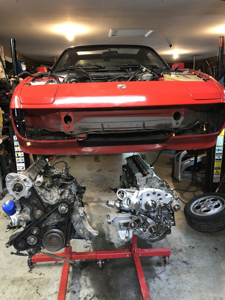

So I took the leap and tore down the old motor:

Got the motor out of the car. I had no real problem pulling the motor out of the junkyard car from the top but this one I couldn’t get that way. Had to drop it out from the bottom and drop subframe, steering rack etc.
I think because of the manual trans on this car has a much different connection to the torque tube than the auto did.
Anyway, here’s the clutch I pulled out. It uses a rubber center to keep shifts smooth - which is great except when they break. This explains the Herky jerky feel when on or off throttle:
The new clutch I bought is sprung rather than the rubber

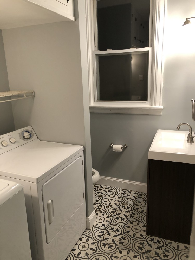

A major diversion from this project happened.
I went over to my rental house after the tenants moved out to figure out what I need to do to sell it finally and found the first floor bathroom floor to be very squishy.
Culprit turned out to be a cracked main plumbing stack:
I found and fixed that and had to basically reframe that whole corner of the house:
And now all fixed up:

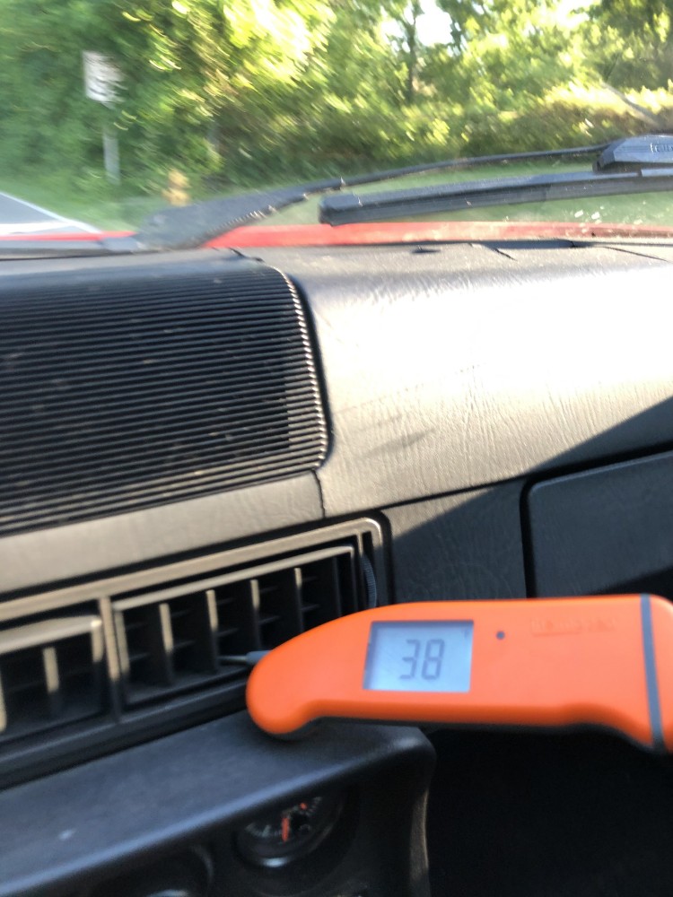

Also, this morning I got the AC working - so winning!

Postby Grillage » Mon Jun 08, 2020 8:16 pm
Had to go back to the yard because the compressor in my car was super loud. This may explain why there was no fuse in the AC compressor spot when I got the car.
anyway, got that compressor and got everything changed over to R134A
now:
