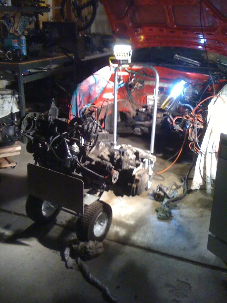

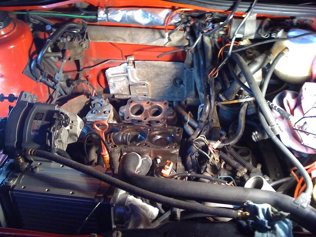

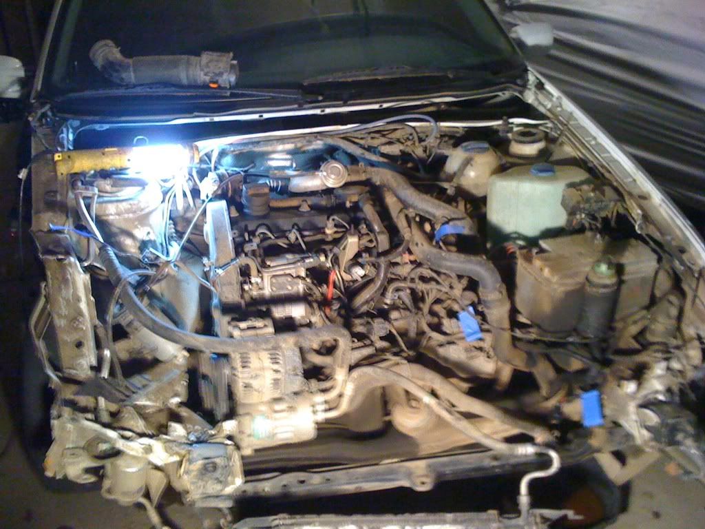

Just a little:
Not big enough

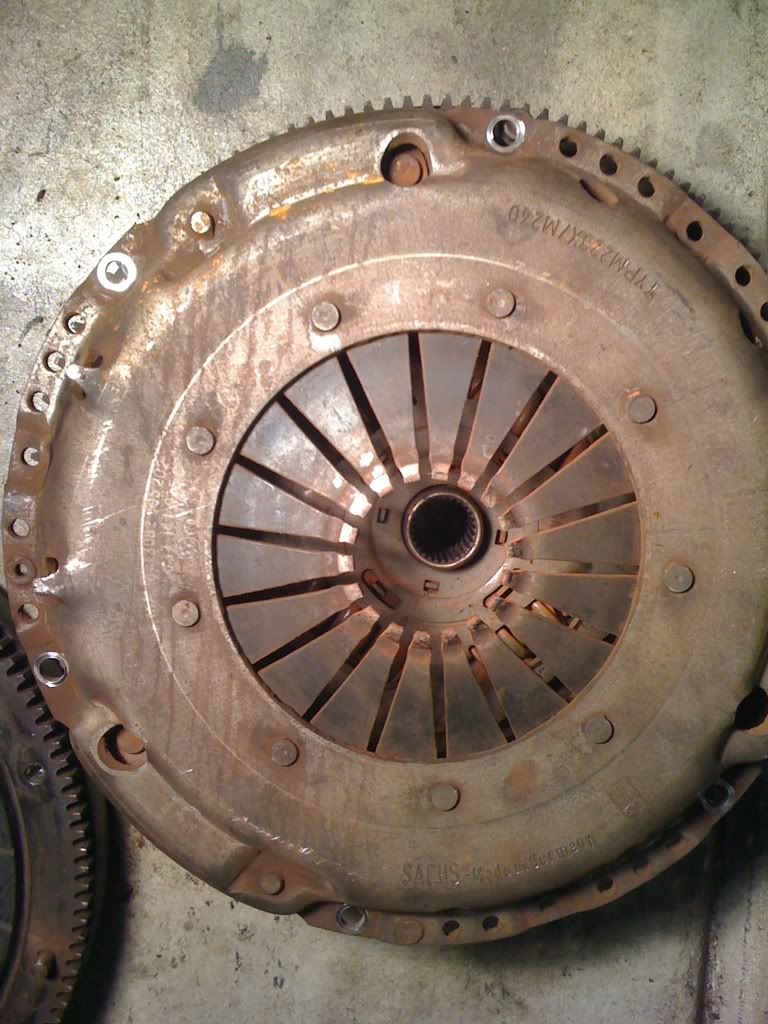

VR6 clutch to go with single mass flywheel
Little portingImage

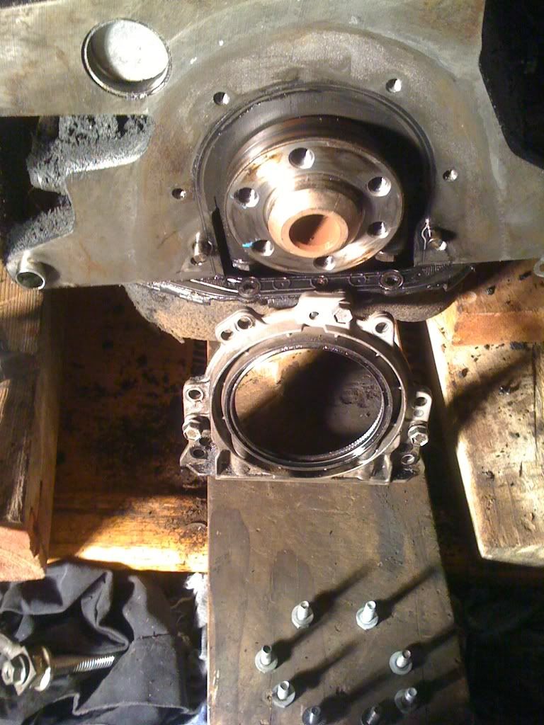

New seal while in there
AFN EM

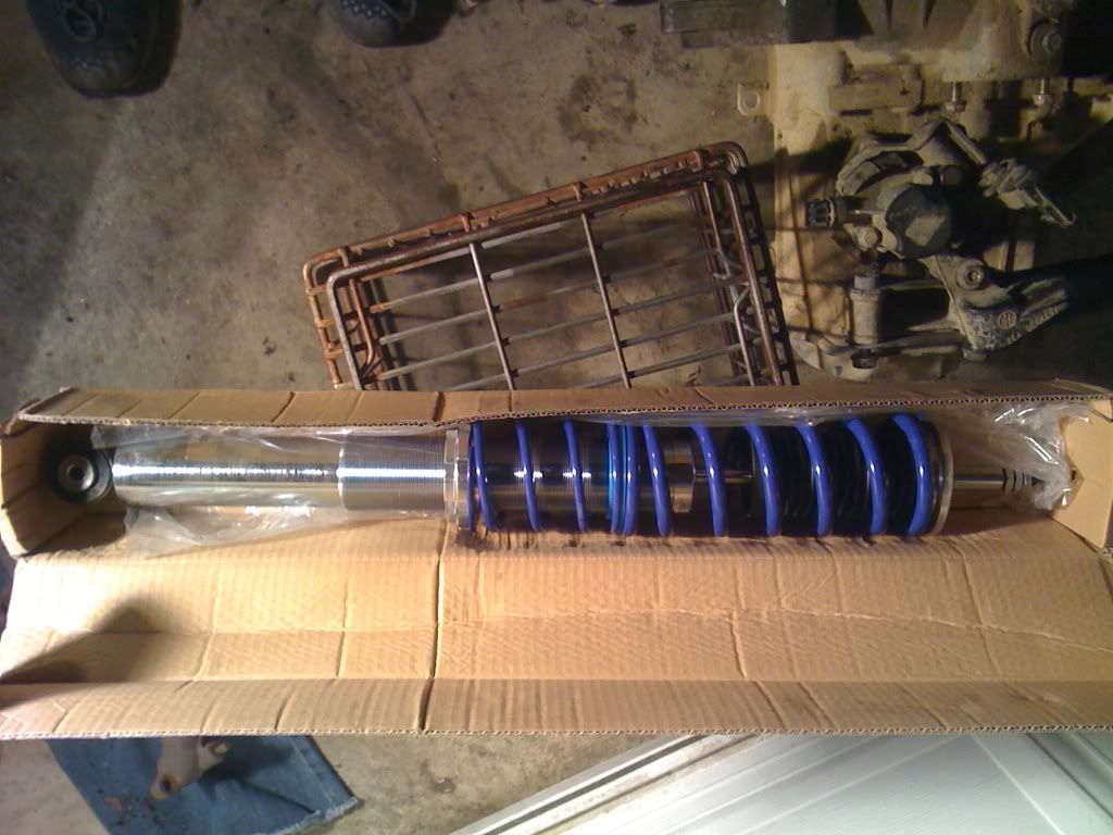

Cheap coil overs

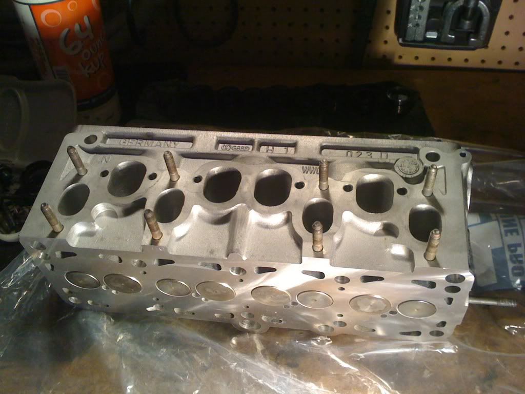

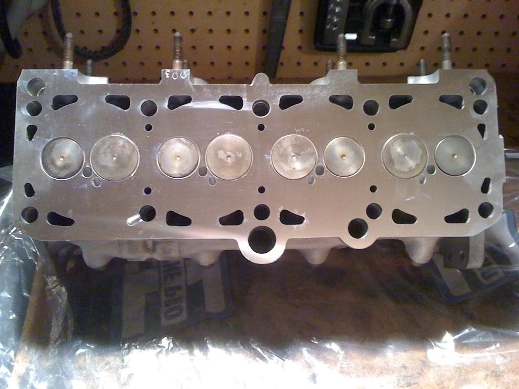

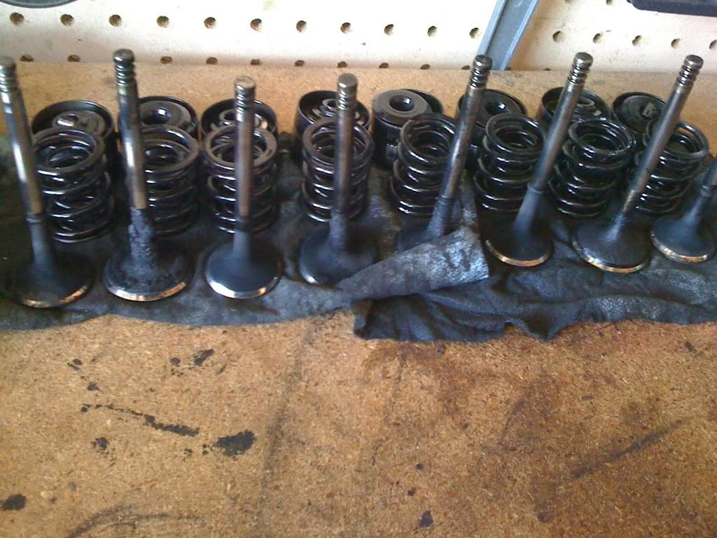

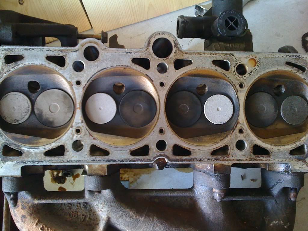

Head after decking and valve job

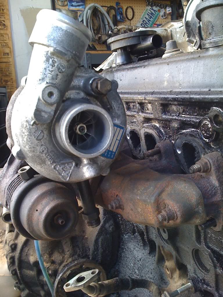

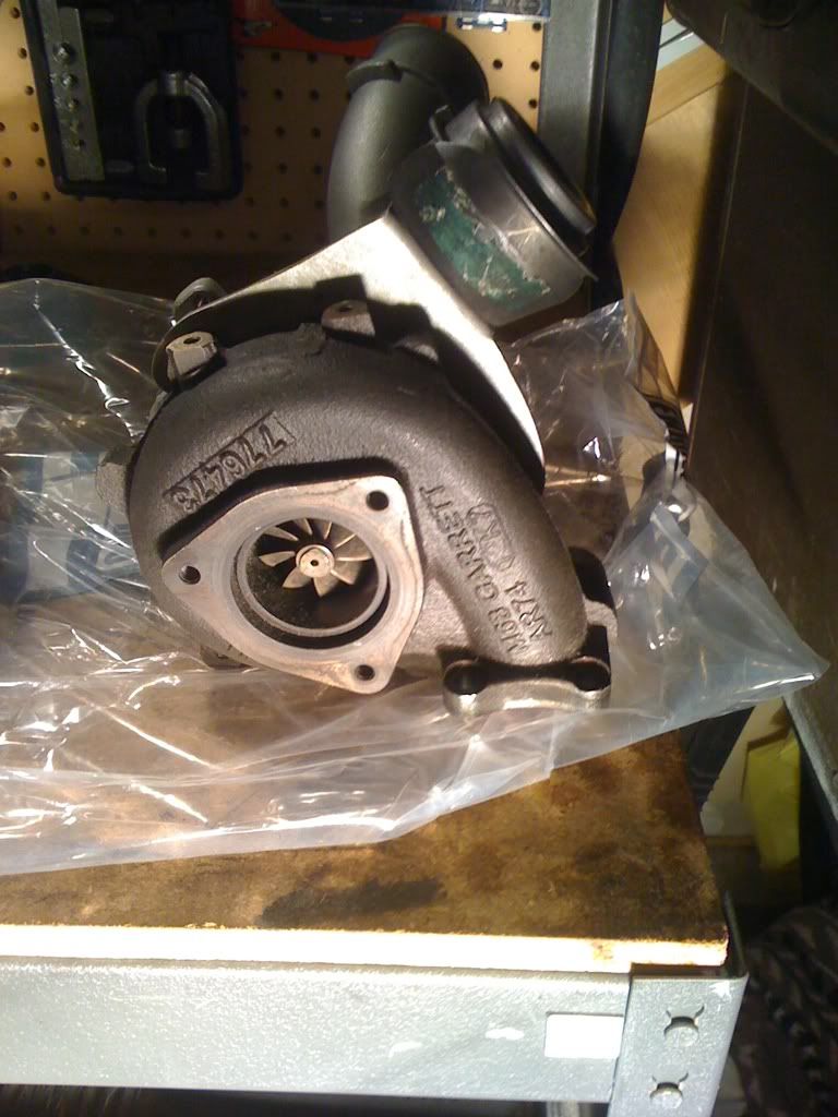

GT2260VK

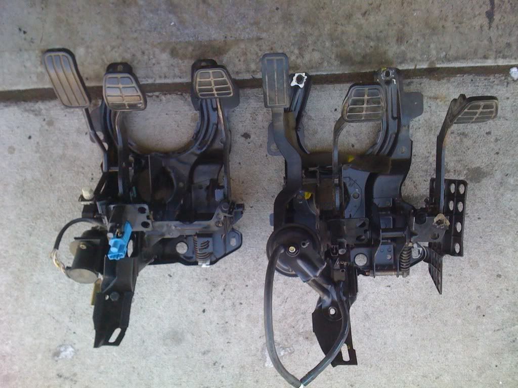

Pedal clusters

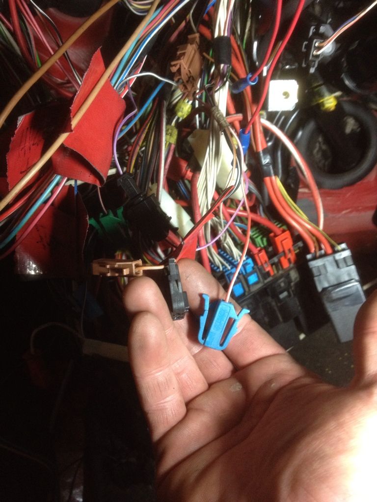

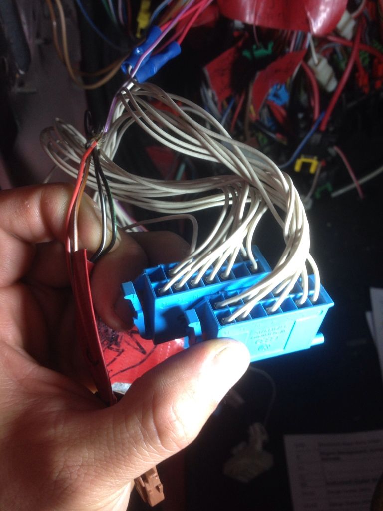

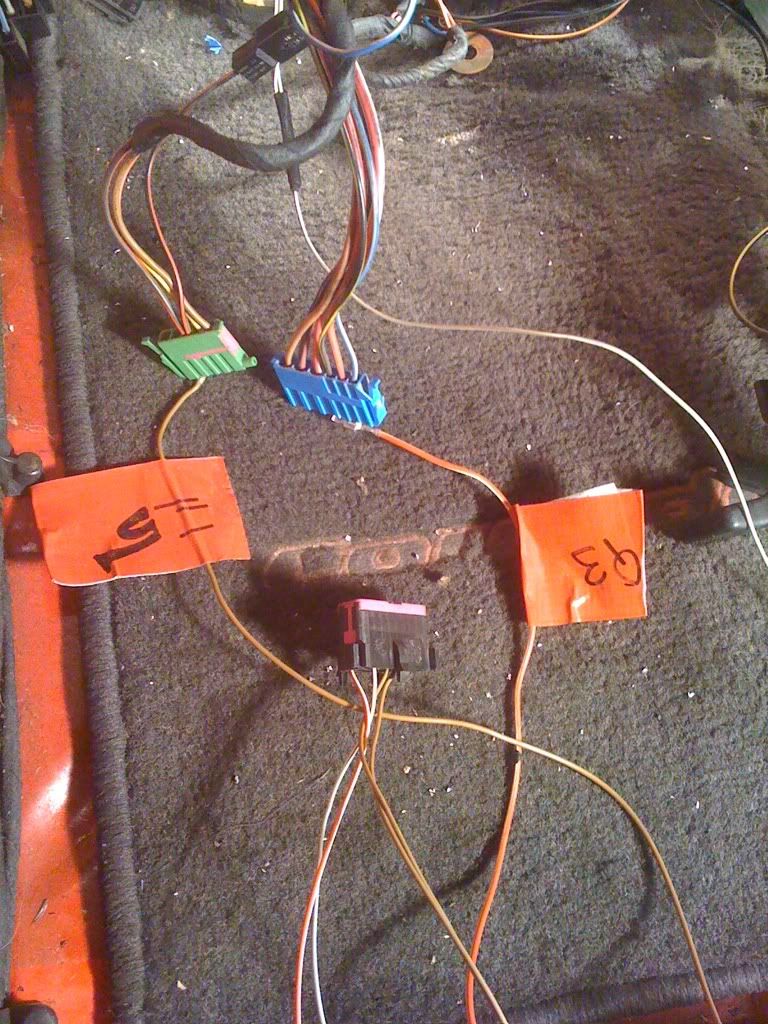

Sorting wiring

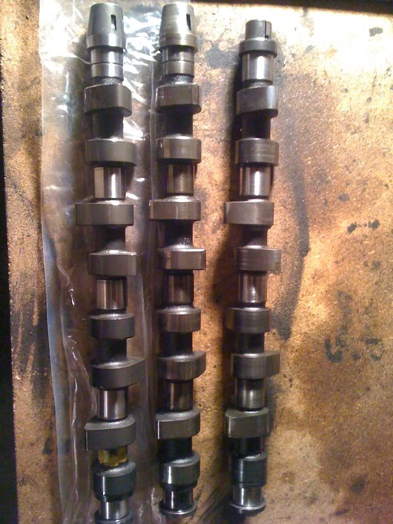

Cam comparison, 276 TT G60, stock 1Z, and Stage 3 Kerma
Hold it together

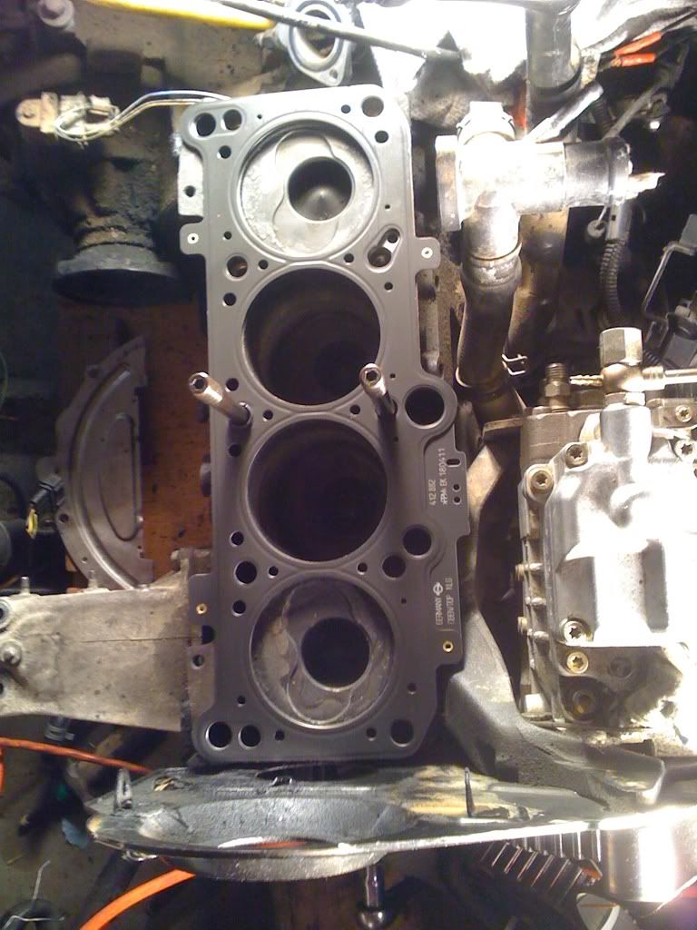

New HG
Wiring
more wiring
more wiring

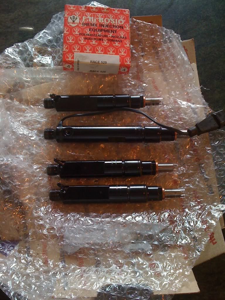

Bosio Race 520's

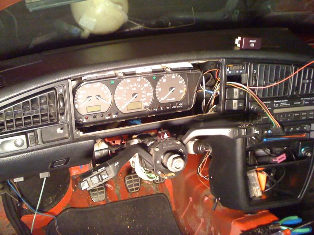

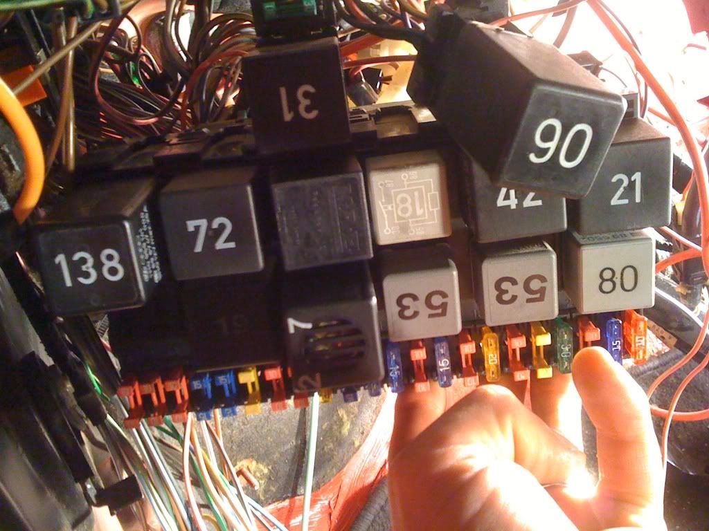

New cluster in place (although the final with MFA and boost, egt, etc, yet to come)

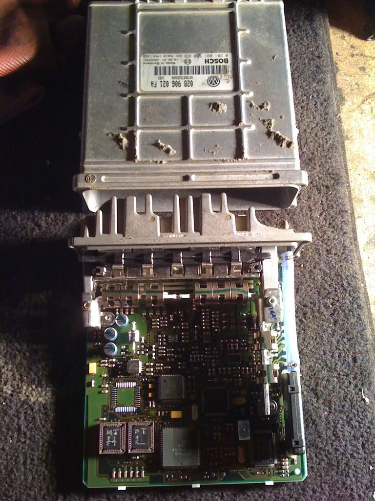

Malone handling the software (egr delete, VNT conversion, R520's, etc)

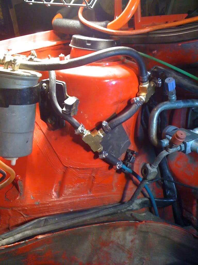

Lift pump fuel pressure reduction
Drop in cam needed some clearancing

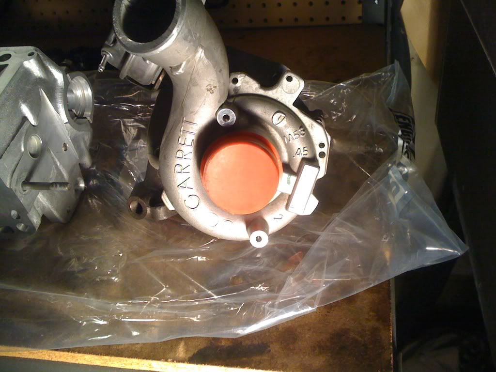

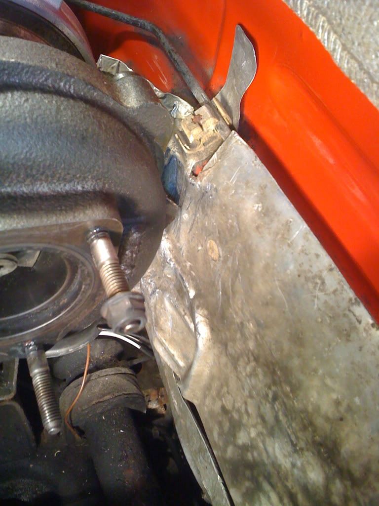

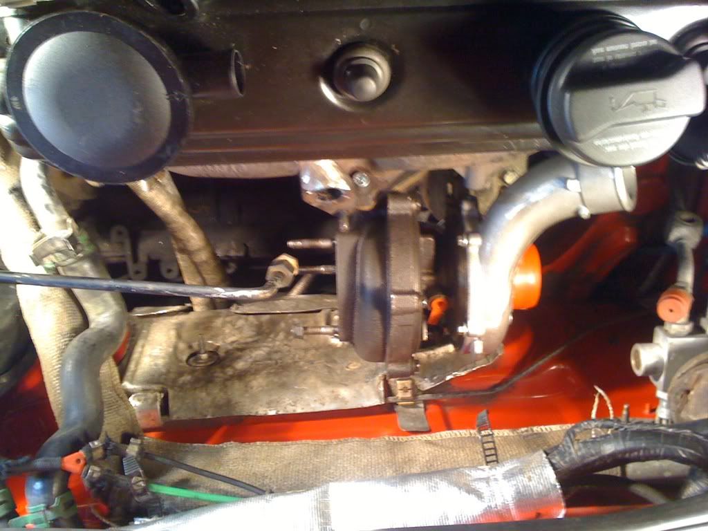

VNT GT2260VK and AFN fits, but BARELY

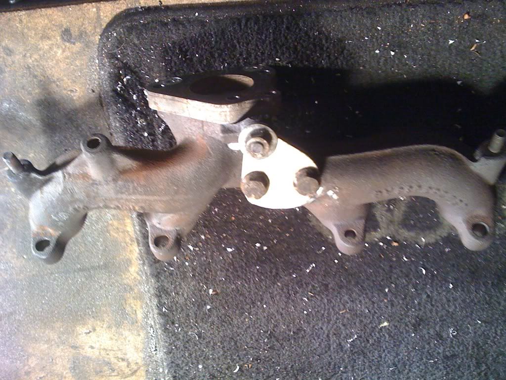

No egr, and it didn't clear so hamfisted something
Originally
Mo betta

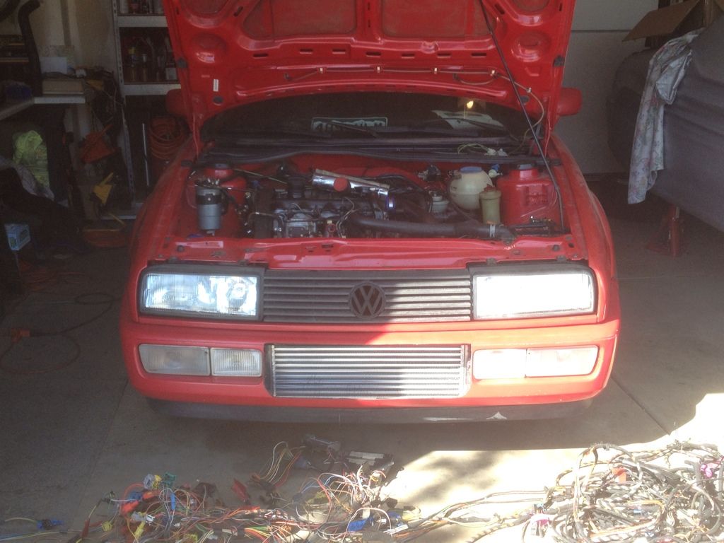

Aaaand more wiring

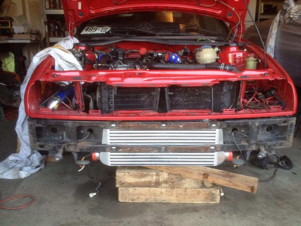

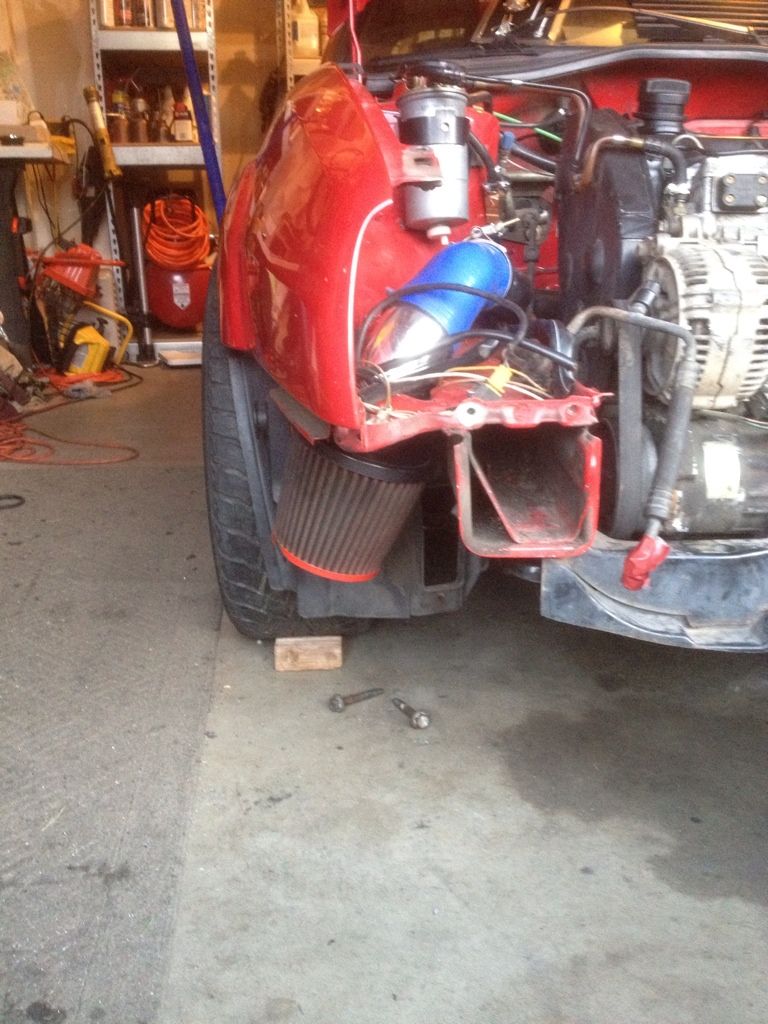

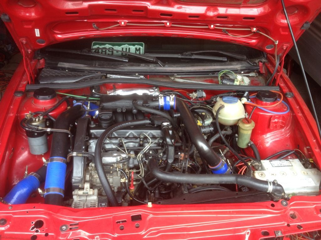

In place and starting to work and charge pipe routing
Slight improvement over the stocker
Jimmy, these look familiar?? :wink:
Making G60 AC and power steering work with the 1Z
Death by wiring
Ventilation
Chasing wiring ghosts
A20V200

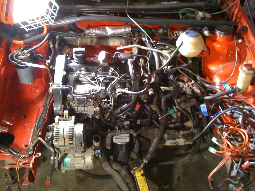

Looks good, what a cluster F*&k of wiring, better you than me..how's it run?

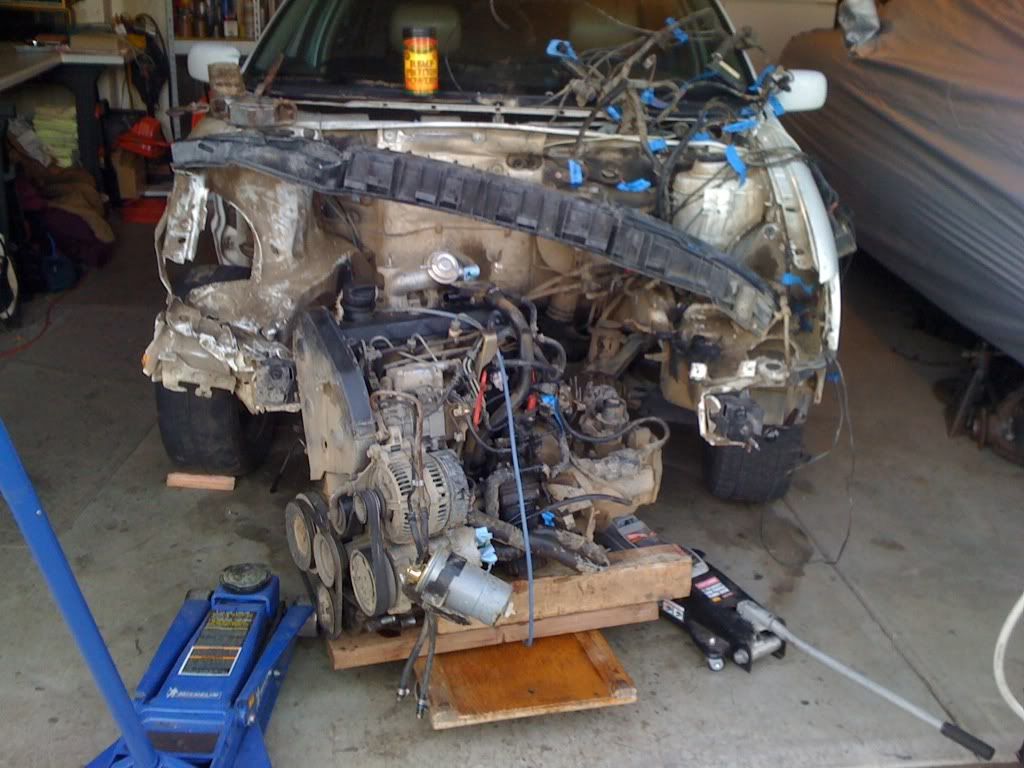

Commuter travel car/weekend autoX and track car. I'm still getting it road worthy. Hasn't left the garage yet. Still working on sorting cruise control integration, have to wire in the final lift pump control circuit, bleed brakes/clutch, re-torque ARP's, build final down pipe, etc before i can start driving it.
A20V200 wrote:Looks good, what a cluster F*&k of wiring, better you than me..how's it run?
Starts right up and idles/runs beautifully...but haven't driven it yet.

MikkiJayne
Re: TDI ratrod
Post by MikkiJayne »

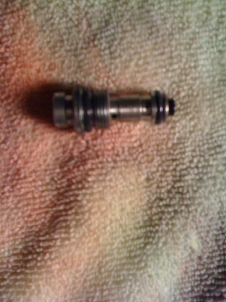

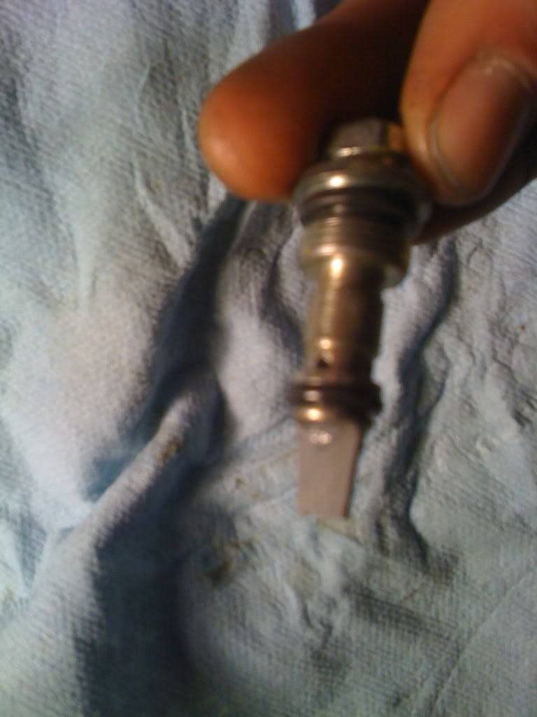

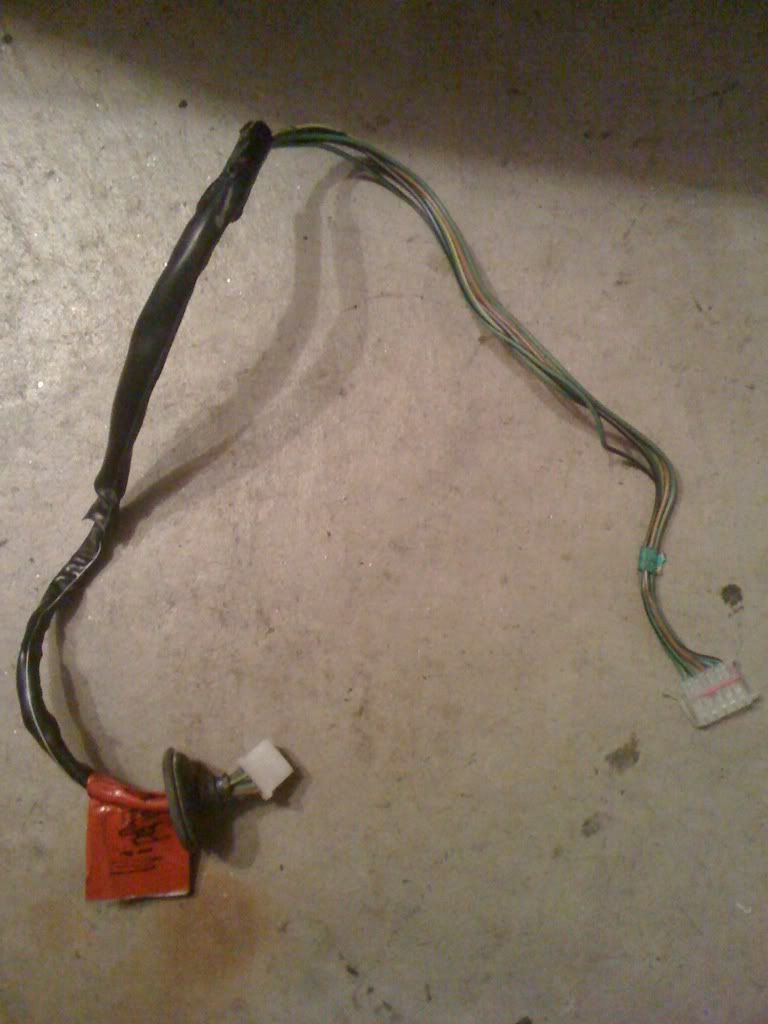

What did you do to that doodad from the pump? I can't tell from the picture - it looks like you extended it somehow?
PRA4WX
Posts: 589
Re: TDI ratrod
Post by PRA4WX »
It's a small plate added to the case pressure relief valve. They tend to "pop" with revs, and this plate prevents that. Case in point-the donors had popped and the previous owner was un aware. You can tell by the small black portion you see exposed from the valve in the first picture. That black tip should sit flush with the valve body.

PRA4WX wrote:It's a small plate added to the case pressure relief valve. They tend to "pop" with revs, and this plate prevents that. Case in point the donors had and the previous owner was un aware and it is the small black portion you see exposed in the first picture. That black tip should not be exposed but sit flush with the valve body.
Interesting thanks. I'll have to check that out :thumbsup:
You can glean some info here:
http://forums.tdiclub.com/showthread.php?t=206384

Ah right :) I never rev mine hard tbh since it just goes flat at 4000.

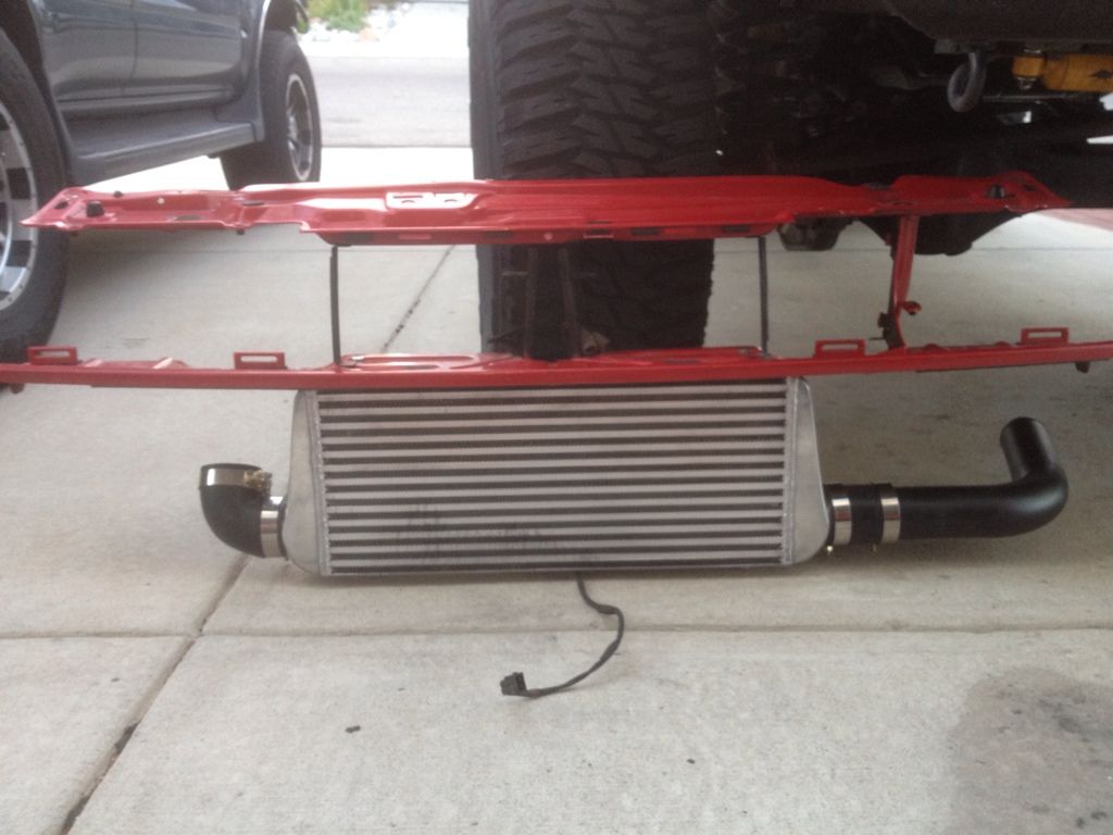

Took a spin to the bike shop last night. Can't wait to have the down pipe/exhaust on and turn it up a bit. Even at only 5psi it moves all right. Popped an intercooler hose last night. May have to rework the junction where the intake side turns down and connects with a lower hose. You can see said junction here:
With some tweaking it joins better now......but i'm not totally happy with it

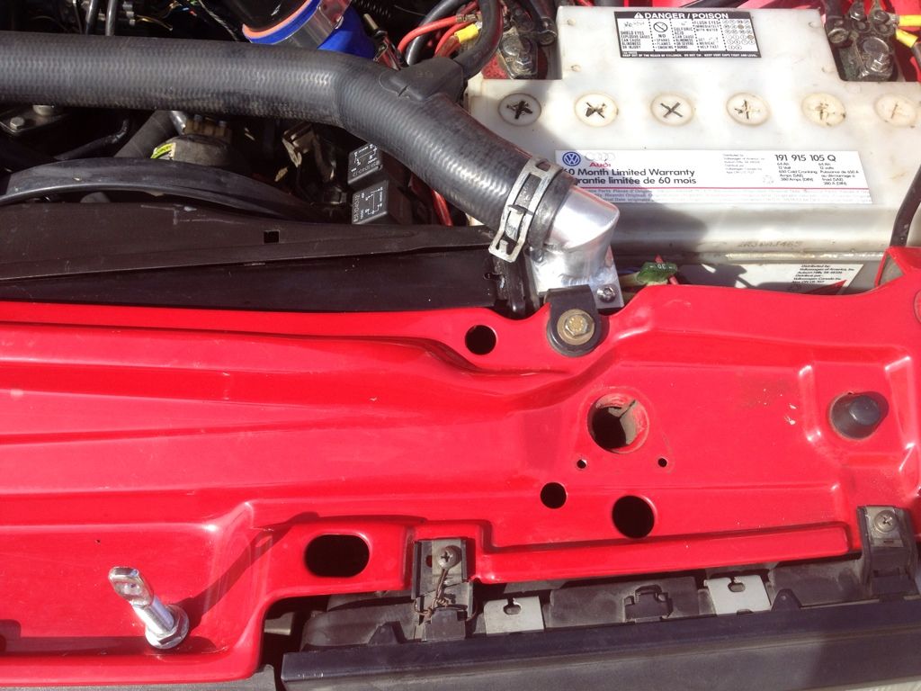

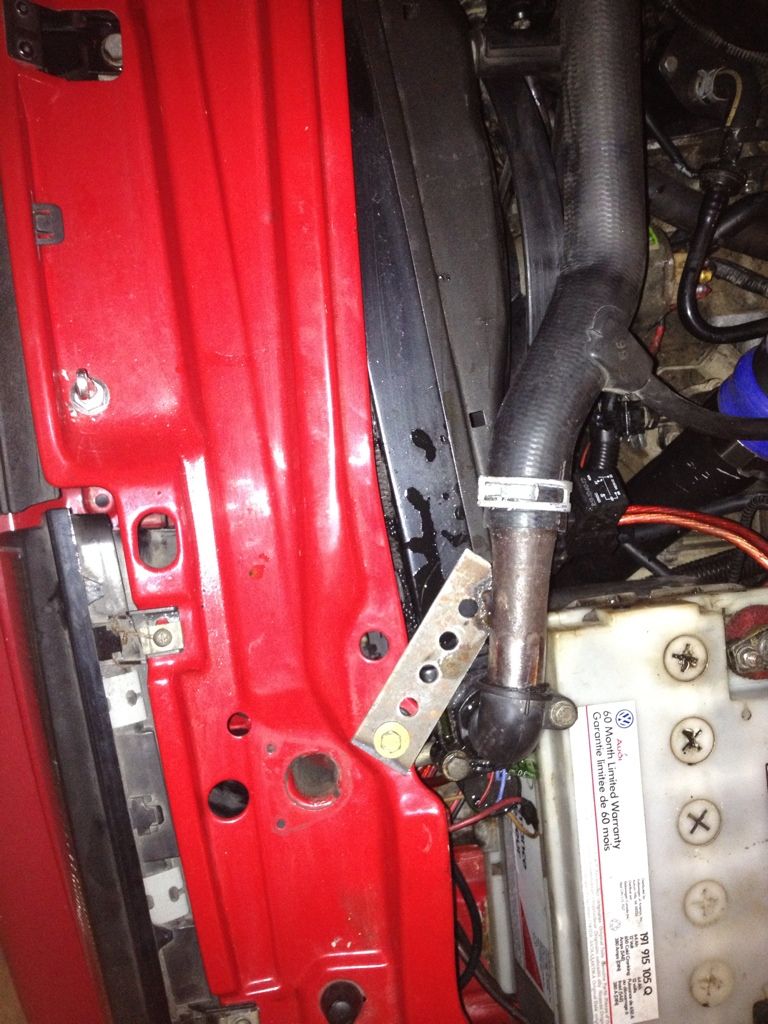

It's exhausted now. While on the lift getting the exhaust done the infamous corrado radiator neck broke completely off w/o room to reclamp enough to even limp home. So this is the rig we came up with to get home:
Finally have given in and a billet replacement is in its way. I was looking forward to beginning to drive it......

And that problem solved:

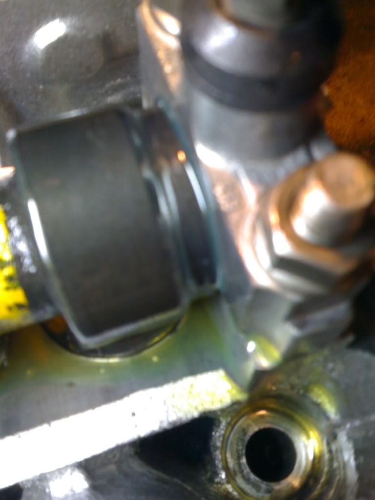

On to the next. Took it out last night for a quick spin to get the wife some cider. Boosting to about 10psi. First two gears easy throttle but enough to see about 5lbs. Did a stronger pull through 3rd two times up to and backed off at 10psi.....everything good to go. Runs out pretty good too. I'm excited! Turn around to head back and decide to do one more 3rd gear pull from cursing at 2k rpm. Back off before 4k, and on decel the engine shuts down. Add throttle, and it comes to life but its running weak. Have to stay in the revs to keep it running when off load, on load can only use light throttle or it bogs and dies. It would die at idle. I would then crank, crank, crank, and some throttle and it would come to life. Managed to nurse it home. Sounds like fueling to me........ Lift pump is still running, no air in line, no fuel leaks-okay so that all seems good. I've put off changing the fuel filter-it has the filter from the donor and i don't know how long it had been in service-but was planning on it anyway. Gonna pull the lines after and at the filter and verify i still have good fueling from the in tank and through the filter. Maybe clogged filter? Water?
Any of this tell the experienced tdi'er something? Sound like fueling?

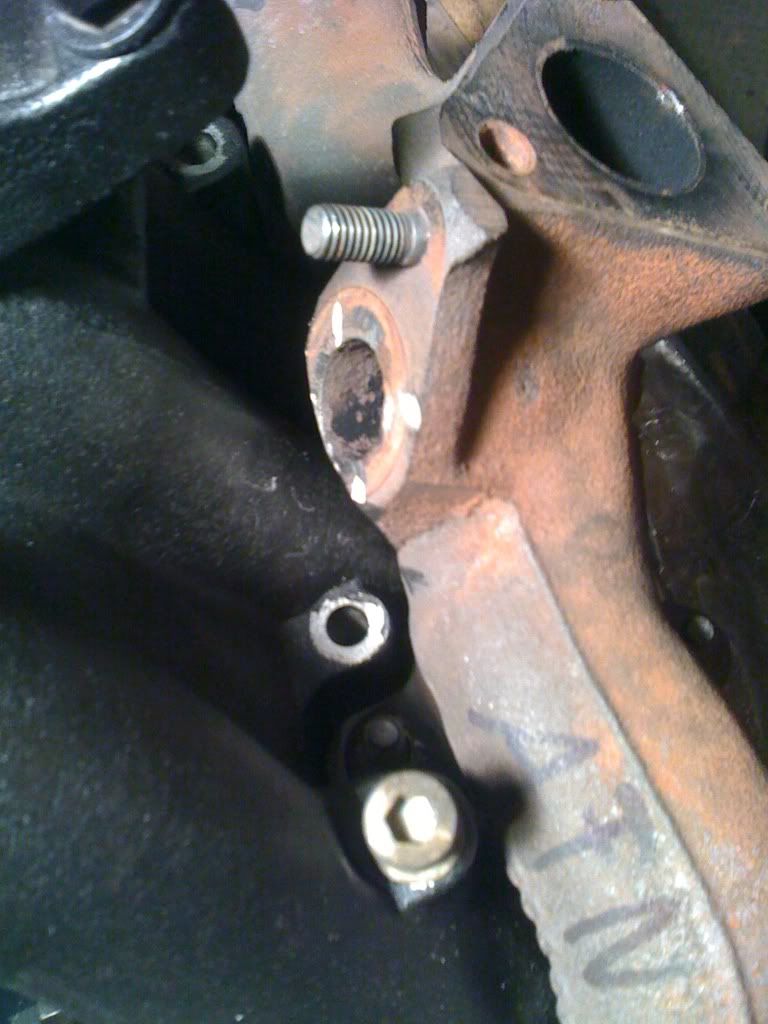

Have an exhaust leak somewhere in the at the back of the head.
Noticed some exhaust track from the #4 injector as well. Retorqued it. How common is blowby at the injectors? No fuel was leaking from the injector tops but a couple were slightly wet at the line and nut junction. Retorqued the lines.

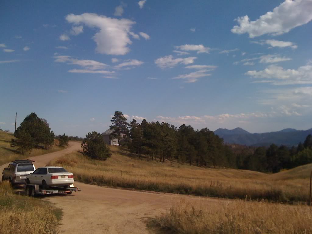

Made the first road trip today in the tdi to meet a friend with a super proper TDI swapped MK2 GTI. Drove Pikes Peak. The tdi RatRod ran well. Image
