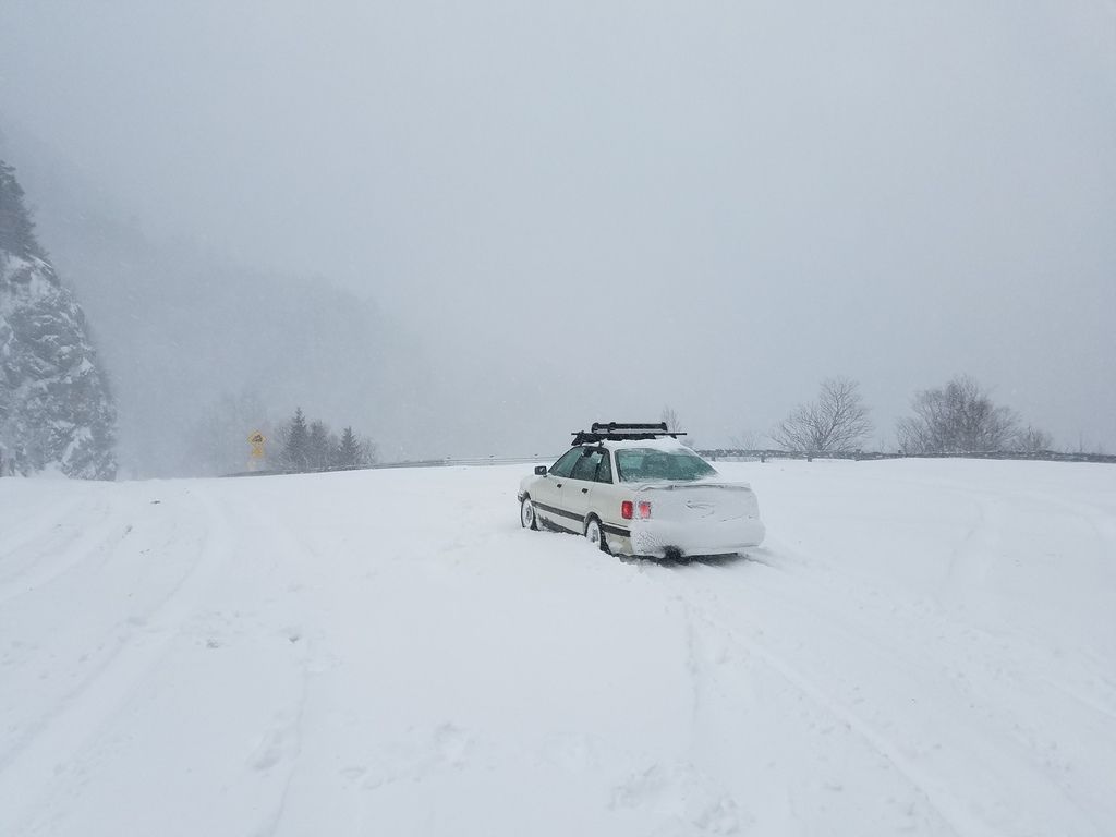

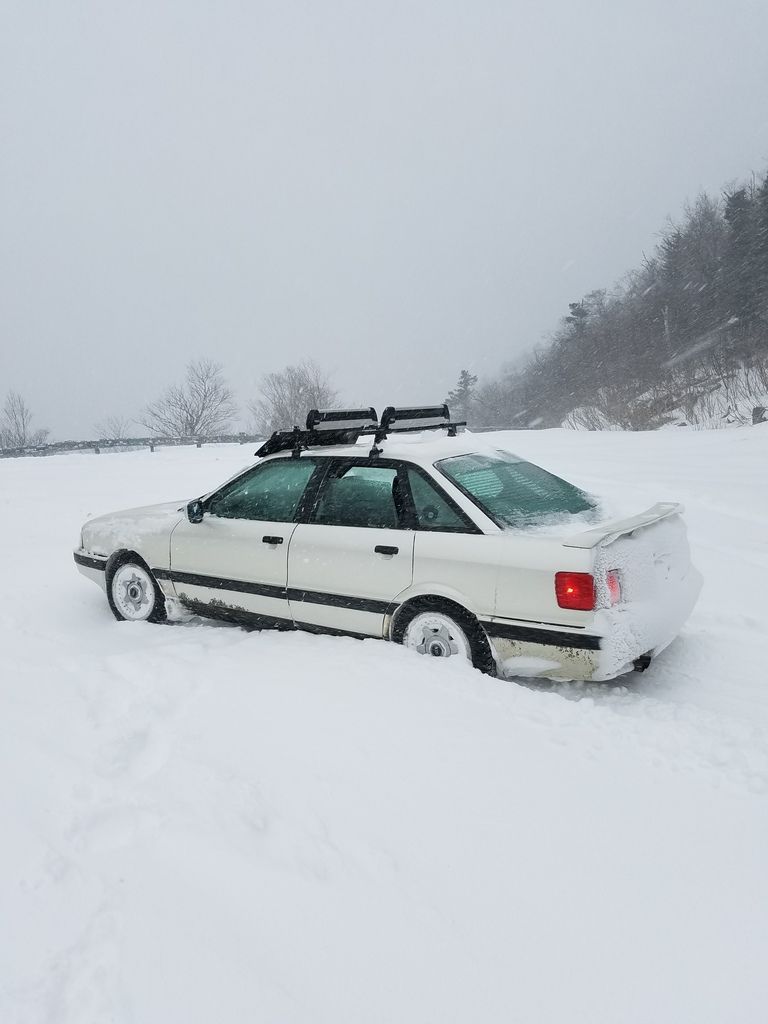

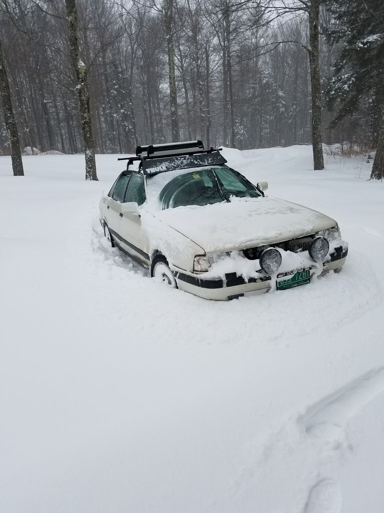

Quattro mode was fully engaged the last couple days. It snowed somewhere around 40" at my house. Tuesday after work I came over the mountain in 12-18" of snow that had not been plowed. I shot a few videos that are typically disappointing.
There was so much snow that I couldn't play at all, just basically survival mode. Somehow I got to the top and got home. At times snow was coming over the hood. The car was getting warm because the grill was PLUGGED completely with snow. A couple other cars were off the side of the road and overheating. I somehow was getting through more snow than people with trucks and SUV's that had studded snows. Got to love old quattros.
Disclaimer: video quality is bad, holding a phone and fighting the car over a 3500' climb is not easy.
Pics taken mid storm, got about 30" more after this.
top of mountain Image
