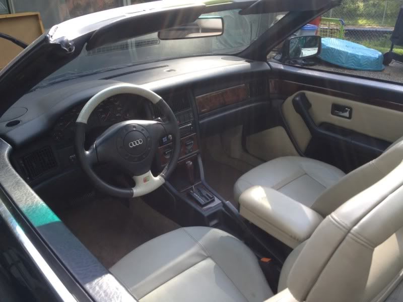

Some interior shots...

Postby Wheeljack » Mon Jul 16, 2012 12:27 pm
I guess I should mention that this was all before the sport wheel as well. And when it was all fully assembled. I only pulled things apart to access the console diagnostic plugs, which I could not find. So I've had two different clock springs in here with the same outcome, so essentially should eliminate that variable.
From the underhood plugs, VAG-COM doesn't see the airbag module at all. 'No response at address 15' or something like that.

Postby Grillage » Mon Jul 16, 2012 12:50 pm
I had the same problem putting in my new two tone sport wheel on the 94 cab. Airbag light and I can't connect to the module
I just pulled the bulb for now - I looked a little bit for the control module and a hookup but gave up.
