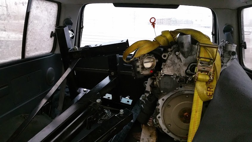

Mcstiff wrote:So this happened:
It's a 2005 that had "something" happen which required it to be replaced. I'm hoping that it was a chain tensioner issue with some mildly bent valves and a nice forged crank. I'm also hoping to be at a $0 investment once I sell off the VW parts that I wont be using! Don't expect Jim Green pace here, I still have a bunch of work to finish on my CQ before I can even think about taking the 90 down!
It's funny, I am excited about the power the 07k will make but I can't hardly wait to drive the car with a lighter front end.

There has been one near me FS too. My issue with the G2 are that it's a pretty vanilla Eaton M62 with a manifold which is wrong for the 12v, no intercooling, and an ECU which is wrong. Seems like a bad place to start, especially compared to spending the same on 07k conversion parts.
Re: 1PissedOff90
PostPosted: Thu Sep 24, 2015 11:48 pm
by Mcstiff
