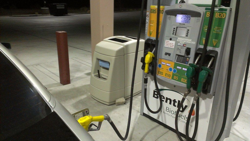

Just filled up with E85 tonight. Excited to start messing around. Took a bit to tune it properly with my horribly slow laptop, but a lot of logs, Some auto tuning, and schematic tuning and I'm doing pretty good. Got cruising pretty good. Fattened up boost areas while offline, gonna check to see how rich I am tomorrow. Hopefully right on target.
Hoping the RS2 Injectors will be enough for my power levels.
