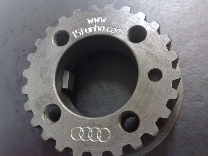

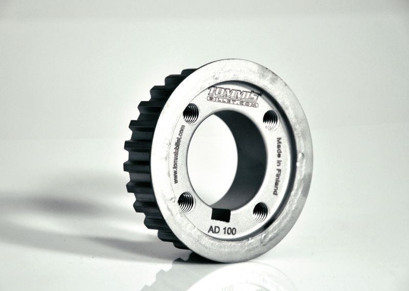

Tommi's Billet
Material: Steel (???)
Construction: 3 piece (separate dimple and separate key)
Tooth Profile: Squared-off teeth, correct valleys?
Price $180
Availability: Readily available at [url]EFIexpress.com[/url], Tommi's Billet website, and more
Disadvantages: At least one user has reported that the teeth of the gear are not timed correctly with the clocking of the holes for alignment with the crank pulley. This makes setting timing and adjusting belt tension nearly impossible with a stock cam pulley. Also, the teeth are not rounded at the top like the supertorque belts are made for. This could cause premature wear on the belt. Look very closely and you will see that the edges of the teeth are angled rather than rounded. Don't let the curved front face of the gear fool you into thinking they have a curved profile.
Stock vs SPM vs Tommi's Billet
Illustration of tooth alignment problem on the Tommi's Billet

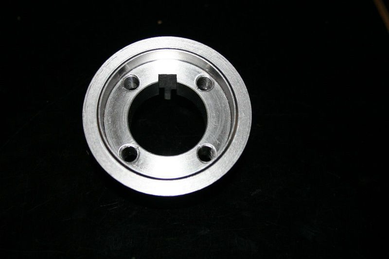

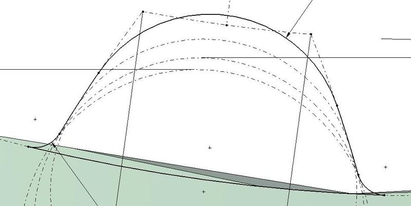

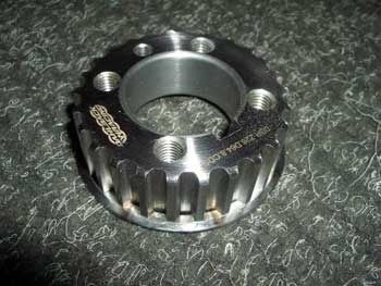

CWG Racing
Material: Heat treated 4340 steel
Construction: Single piece
Tooth Profile: Stock teeth tops (rounded), rounded valleys
Price: $200 plus shipping. Could go lower in quantity.
Availability: I could have more made if anyone wanted some, but I think there is a better option.
Advantages: Among the strongest of all gears using heat treated 4340 steel. Ground inside diameter to ensure perfect fit onto crankshaft. Top tooth profile is exactly the same as stock, rounded “super torque” style teeth. Machined dimple for crank pulley alignment. Can be made more cheaply than most of the other gears here because of the milled teeth (rather than cut by gear), although testing still needs to be done on this tooth design with respect to long term reliability and power-holding potential.
Disadvantages: *FAIL GEAR* These were made with the bolt holes for the crank damper in the wrong place due to manufacturer mistake. Production has ended since. No plans to continue production because it isn't easy to compete with the Terrybullwon gear! Valleys of teeth are rounded in order to keep cost down and allow the gear teeth to be produced by milling rather than by grinding with a special-made gear cutter or by wire EDM (both processes would generally require the gear to be made in two pieces). Whether this is a disadvantage or not is questionable. I will test this gear out on my avant for stock, long-term reliability, and may also test it on the revver if I have the balls :lol:
CWG Racing vs stock
CWG Racing modified for dry sump use - with belt wrap
Tooth valley profile vs stock (valley is pointing up) stock is dotted trapezoid, CWG racing valley is the solid line

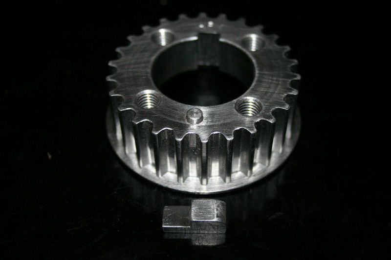

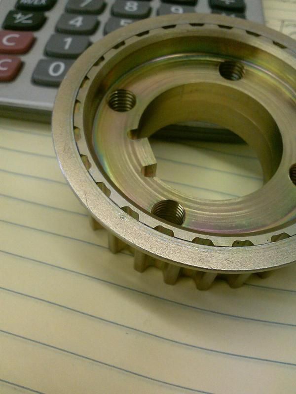

Terrybullwon from S2 Forum
Material: EN24 Steel
Construction: 3 piece (separate belt guard and pin, but integral key)
Tooth Profile: Same as stock (confirmed by Jeff Gerner)
Price $155 plus shipping from UK
Availability: Currently available from Terrybullwon http://www.s2forum.com/forum/showthread.php?t=66425
Advantages: Recommended by Jeff Gerner as the crank cog of choice due to it's build quality and especially the gear profile which matches the stock "super torque" (rounded edges on teeth rather than squared off) tooth profile. Valleys are same as stock as well. Also coated for corrosion resistance. Made by HPC gears, most likely the biggest and best gear cutters in the UK
Disadvantages: ??
Terrybullwon gear
Here you can see the separate belt guard which is pressed on
Belt wrap

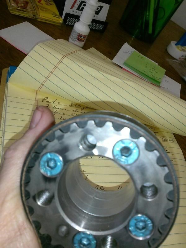

SPM?
Construction: ??
Tooth Profile: ??
Price ??
Advantages: ??
Disadvantages: Possibly not available. I have only seen one in this picture. Tooth design looks like it could be "off."
SPM in the middle apparently

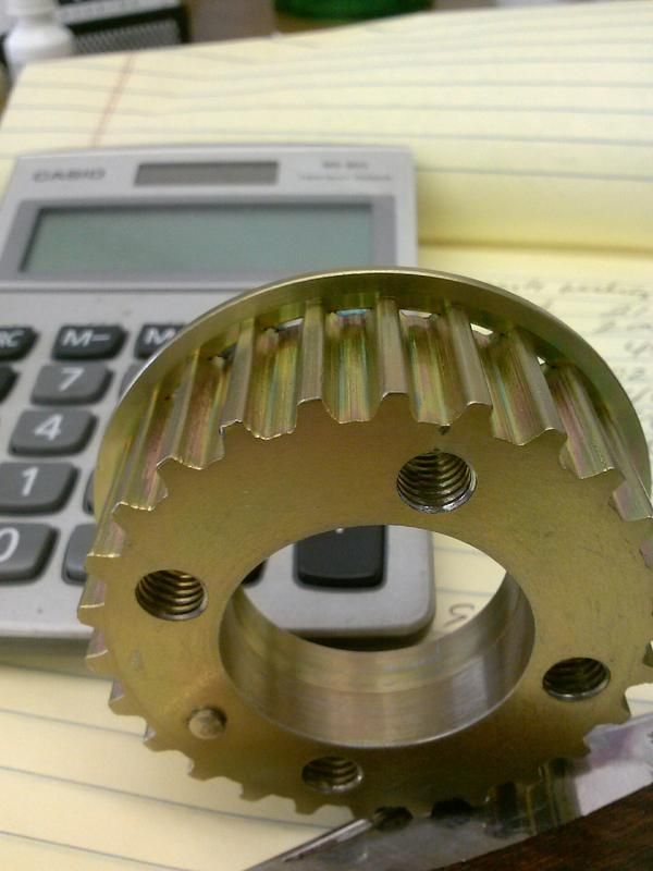

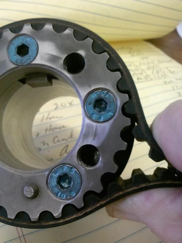

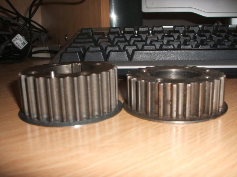

Volcano RS from S2 Forum
Material: Steel (???) Heat treated
Construction: 3 piece (separate key and alignment pin)
Tooth Profile: Possibly rounded teeth and has rounded valley
Price ~$108.50 plus postage from the UK
Availability: Last post on thread was in 2013. Not sure if still available http://www.s2forum.com/forum/showthread.php?t=33219
Advantages: Cheap!Comes in wider width as well for using 25 mm belt. Appears to have correct, rounded teeth.
Disadvantages: Possibly NLA
Volcano RS cog 25 mm vs stock width
Belt wrap

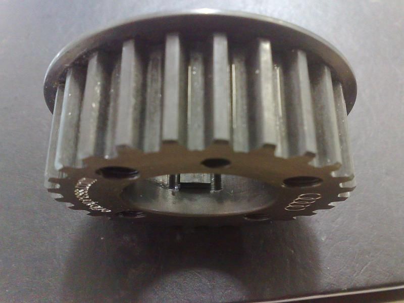

034 Motorsport
Material: "High strength chromoly"
Construction: Appears to be 3 piece (separate key and alignment pin)
Tooth Profile: Appears to have squared-off teeth
Price $204
Availability: Order from 034 http://store.034motorsport.com/crank-pulley-cog-high-strength-chromoly-audi-i5-super-torque.html
Advantages: ??
Disadvantages: Teeth appear to be squared off and not the "super torque" style even though it is advertised as such. I could be wrong though. If so, belt wear will be accelerated.

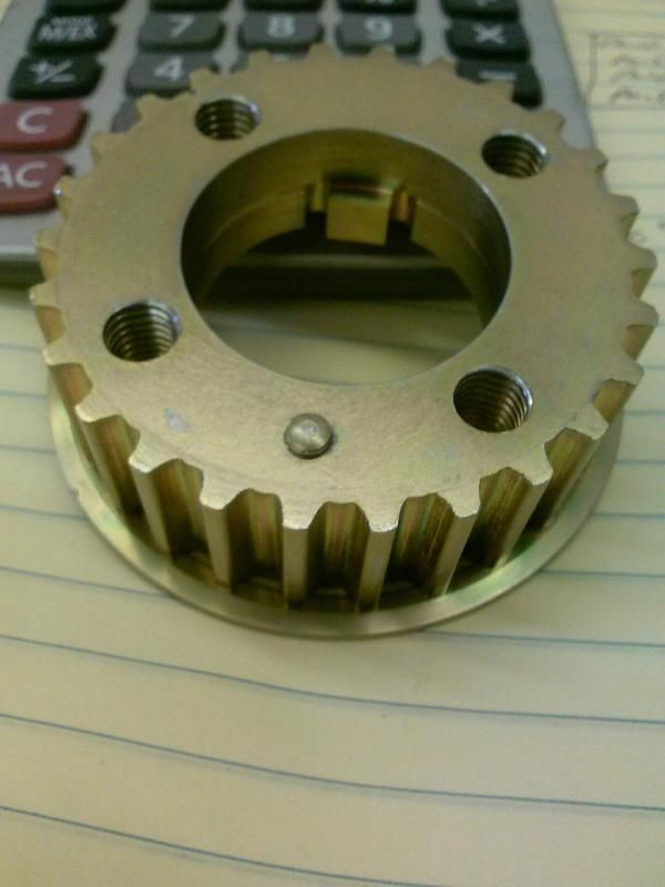

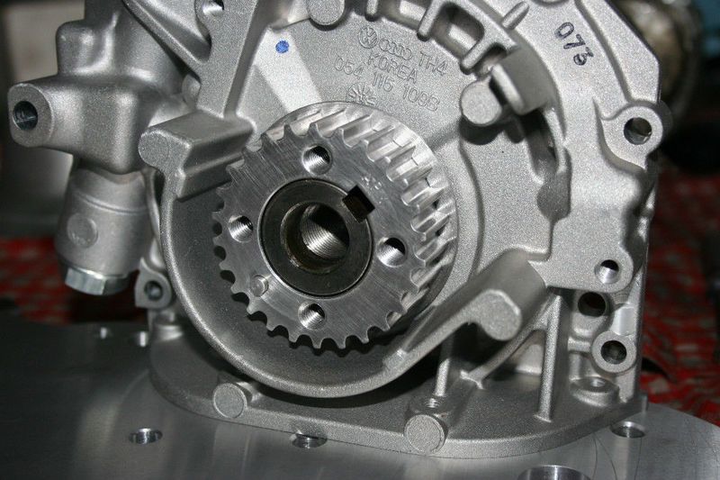

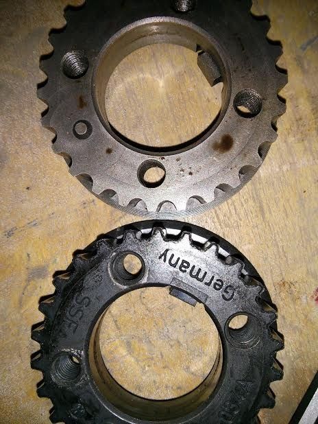

Faheemo from S2 Forum
Material: EN19T tool steel. Some (not all) heat treated and have corrosion-resistant coating. It seems that all the latest ones were coated at least.
Construction: Two piece? (undercut integral key and separate alignment pin)
Tooth Profile: Teeth cut on a gear-cutting machine. Not sure if super-torque style tooth edges or not
Price $225
Availability: http://www.s2forum.com/forum/showthread.php?t=32516 It seems they may not be made anymore.
Advantages: This is the gear EFIexpress use to sell. It was of good quality. The only questionable thing is the teeth, but they haven't seemed to cause any problems.
Disadvantages: No longer in production?? Appears to have sharp, squared-off edges on teeth rather than rounded.
Faheemo from S2 Forum cog

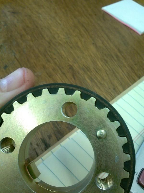

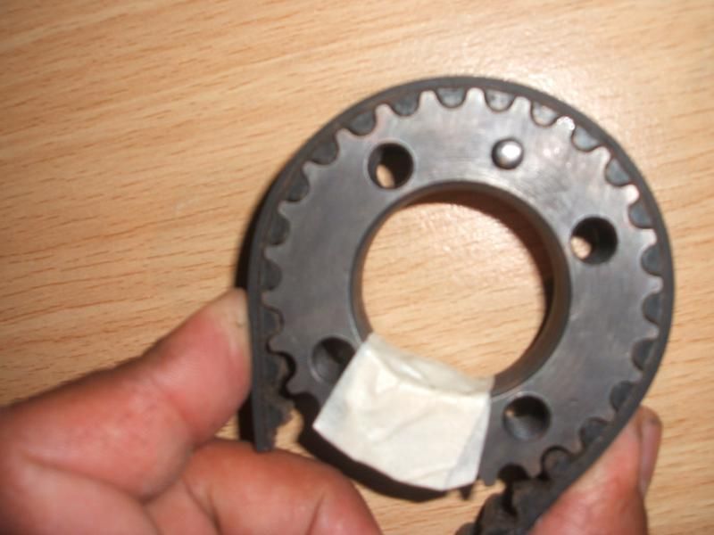

audi * line (eBay.de user)
Material: C45 steel
Construction: 4 piece (separate key, alignment pin, and belt guard)
Tooth Profile: Appears to be very good. As close to stock as the Terrybullwon gear from the looks of it
Price 148 euro (approx) $163 US without shipping. Shipping is likely more than 20 euros
Availability: eBay.de username audi * line - located in Poland - may or may not ship to US. Contact seller
Advantages: Appears to have very nice teeth in the correct profile. Seems to be well made by an experienced machinist judging from pictures.
Disadvantages: Seller may or may not ship to US.

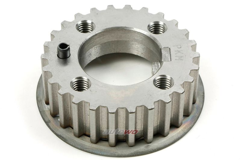

PKM
Material: ???
Construction: Appears to be very similar to Terrybullwon's gear but with separate key and rolled sheet metal pin (not a fan of these two things)
Price ~220-230 euros
Availability: Autewo.de (and eBay)
Disadvantages: The separate key and rolled sheet metal pin are... cheap. It may be perfectly functional, but I prefer integral pieces and precision machining. It makes you question the quality of the rest of the gear.
