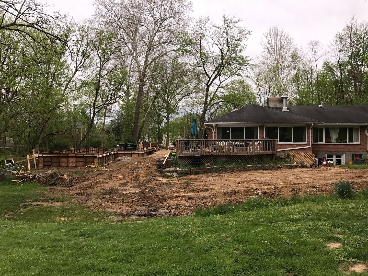

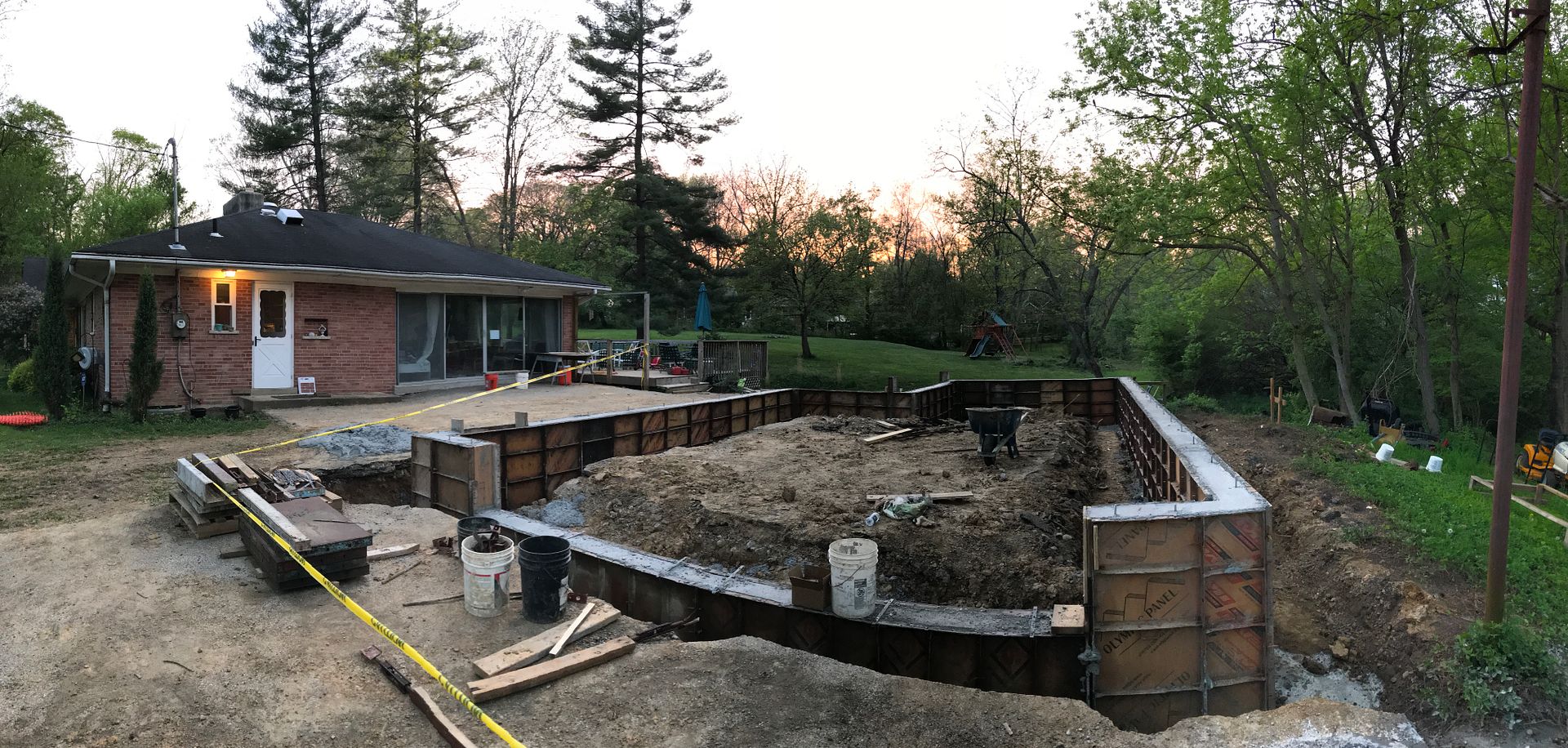

My yard is a construction zone right now with a garage being built

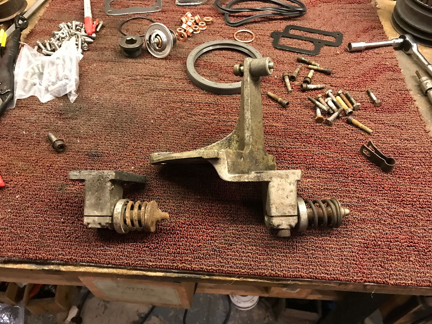

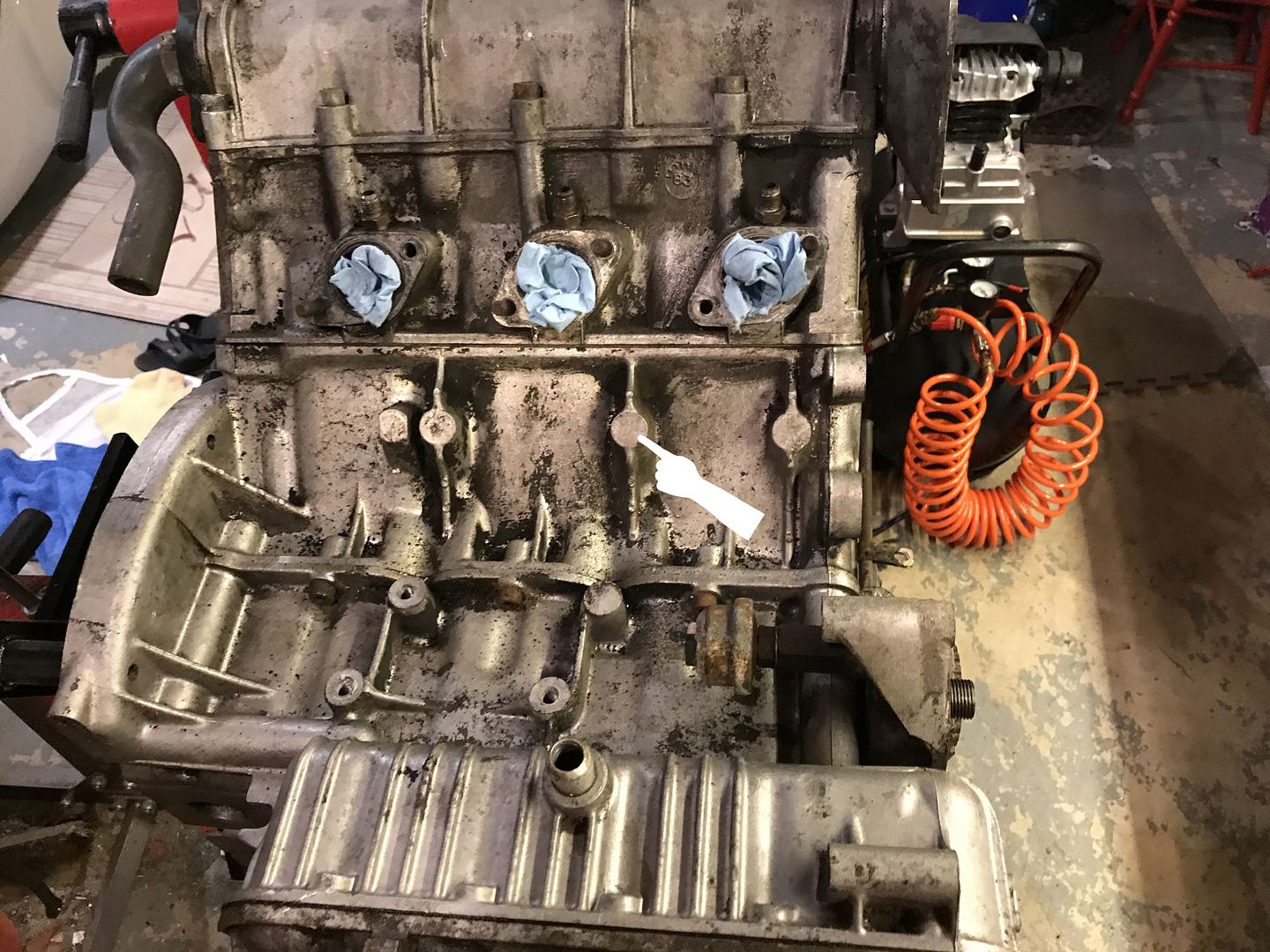

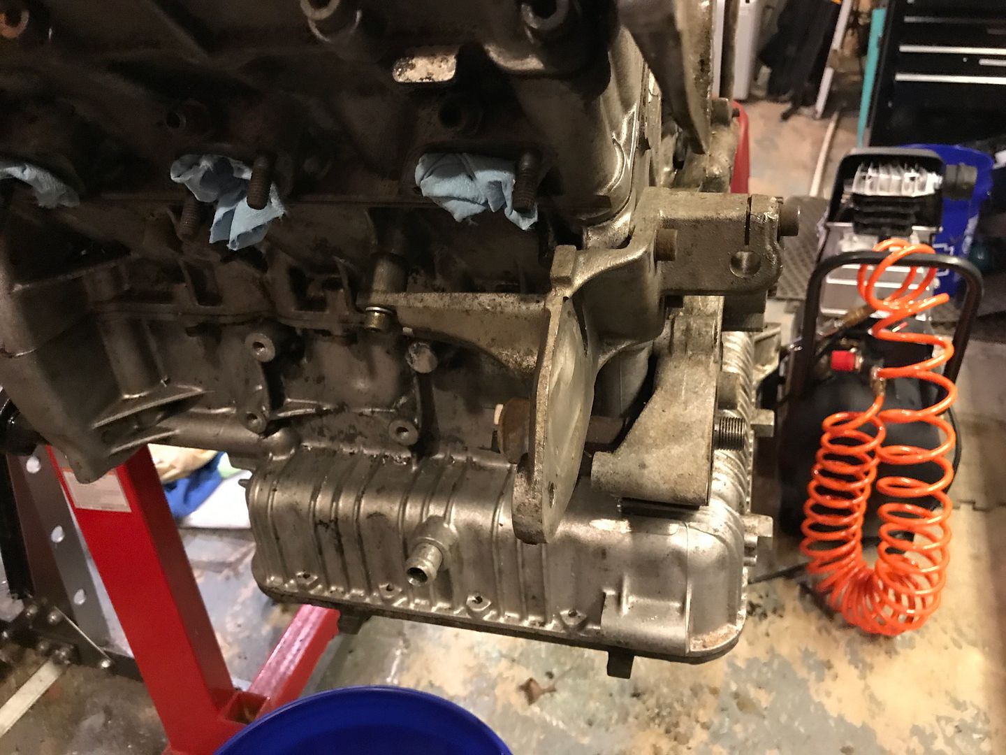

Anyway, I am moving forward with building up the spare engine I bought to put it in the car (once I have level hard ground again)
So I was able to Drill out the oil provisions that had been blocked off by the prior single turbo configuration
Another thing that wasn't obvious to me before is that I needed to figure out a place for the power steering pump. The '85s didn't come with Power steering at all but my '86 did. Happily this was pretty simple. The TB tensioner bracket doubles as the mount for that pump
Only thing was I had to drill into and tap the block for that rear bolt in the above picture. Thankfully, the block had the same aluminum cast flange (or whatever you'd call it) as the '86 did:
Voila!
