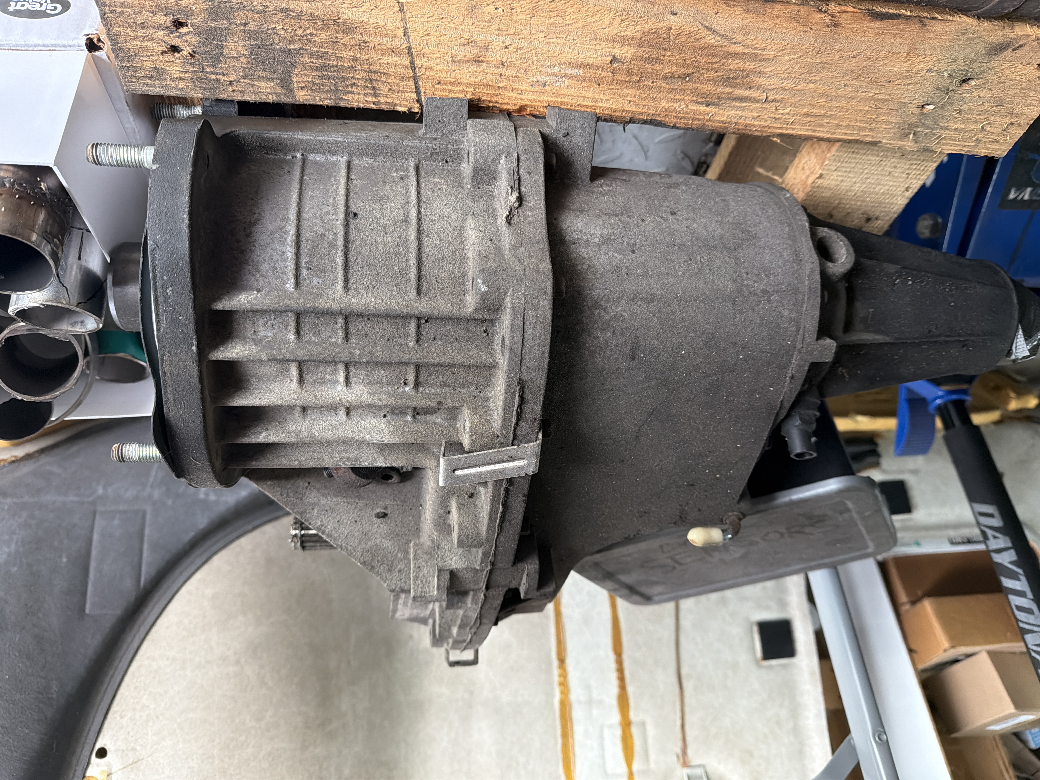

Hahaha. I hope this can be posted here! But, here goes nothin
The plan: Take an 02’ Tahoe Z71 and put a TorSen in the transfer case. Turns out the trailblazer SS has one in its transfer case. So the 4L70E transmission is the only thing that it bolts up to. It’s rare and blows to pieces. So I found a 4L80E adapter to put in the case which bolts up to my 5.3L LS V8 that’s in the truck now. Using an awd front axle from an Escalade or Denali I can make it happen
