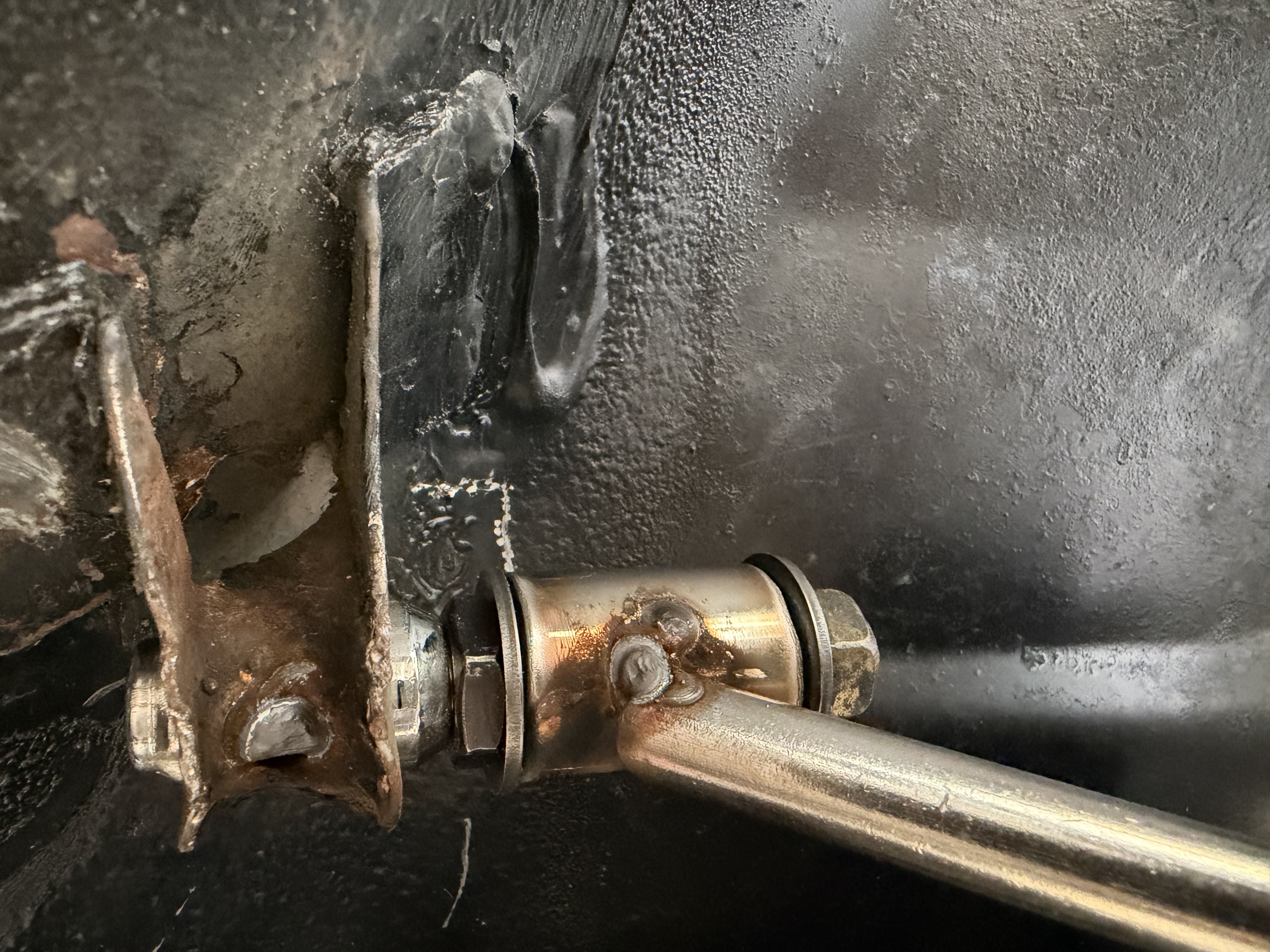

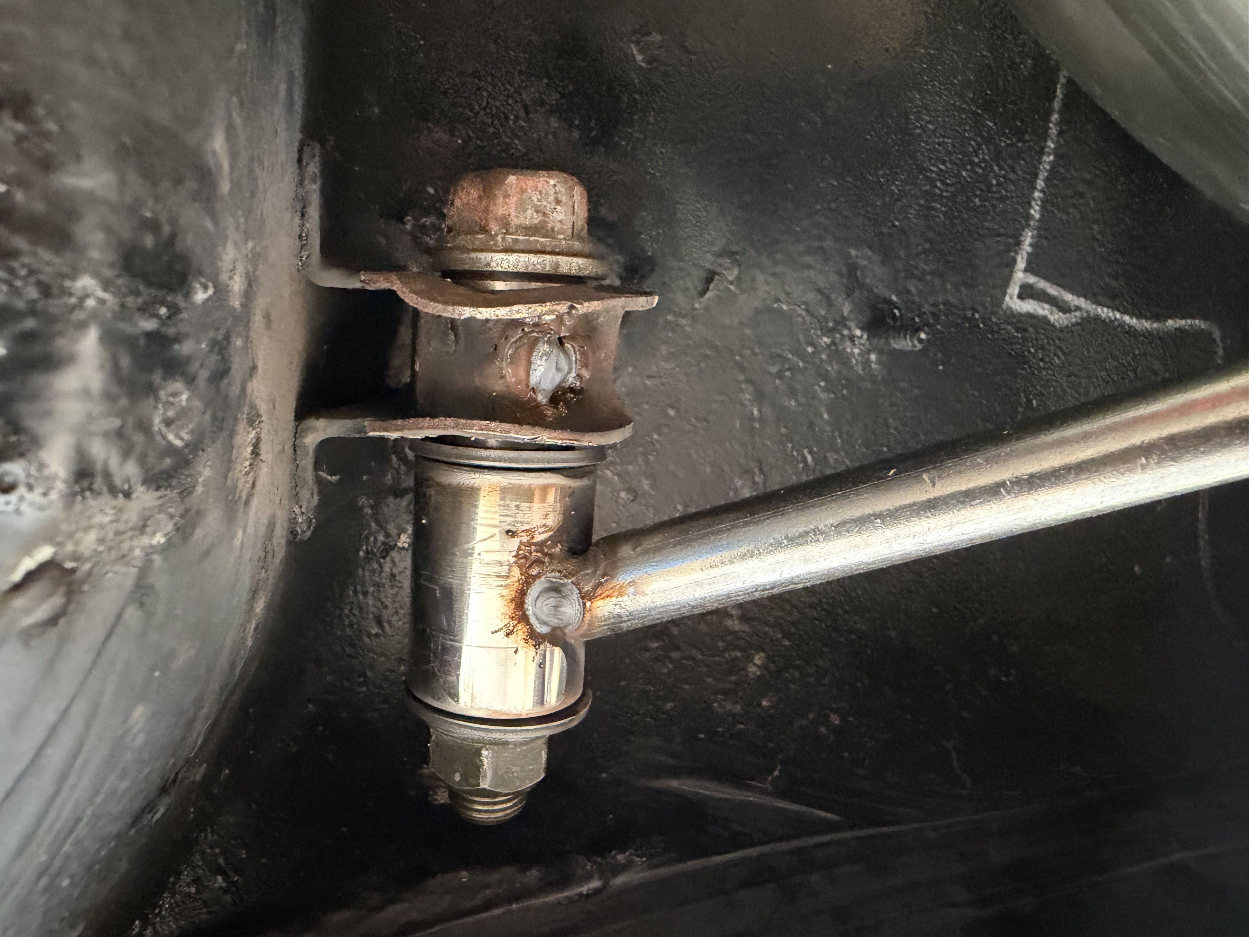

I welded lug nuts in the 3 exhaust hanger brackets
rennenmsports
Posts: 184
Re: Andy's 91' 80q
Post by rennenmsports »

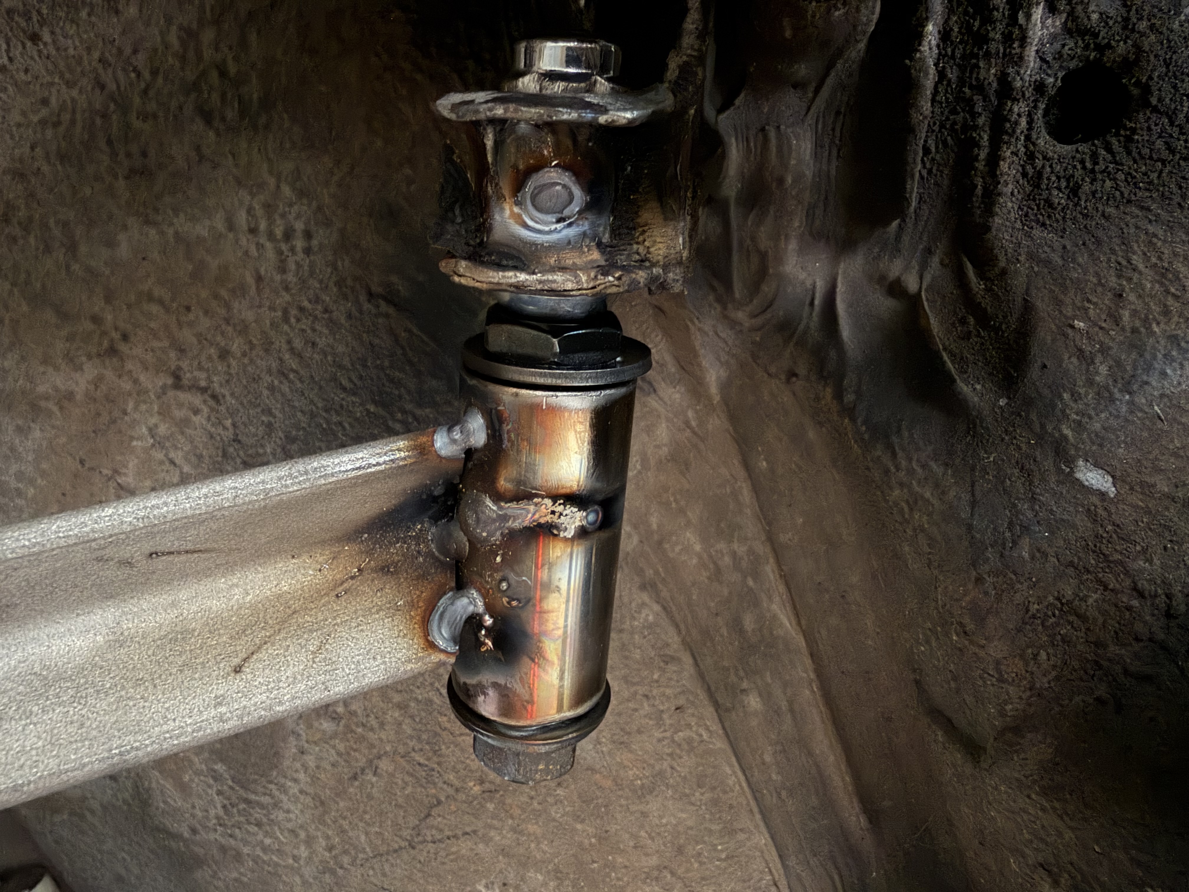

I got some 1/2” stainless steel round stock to weld to the exhaust side. The other end is welded to SS pipe with high temperature silicone hose pressed into the inside of the pipe with a 1/2” inside diameter. Which is bolted to the lug nut. I’ll get pictures when I finish

Looks like poop. But it should work out
