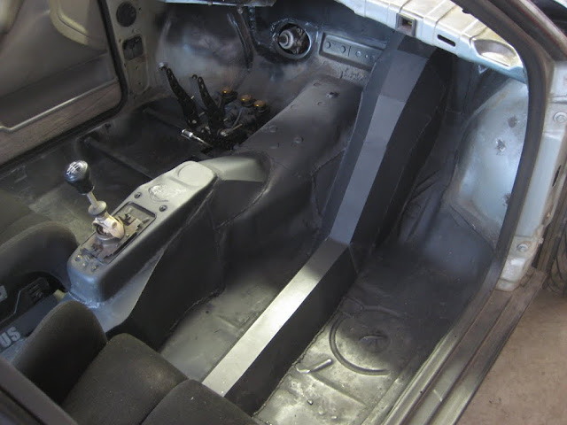

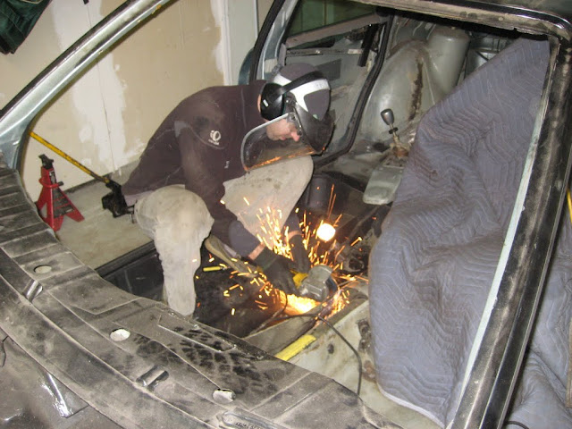

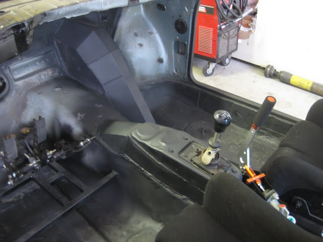

Time for some updates. Been busy with other cars but the 90q has gotten some attention lately...
Working on the sheet metal....

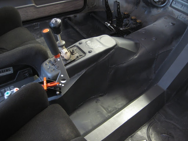

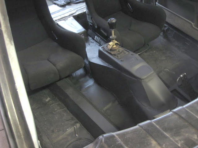

Moved the shifter back about 8" and up about 4". Also created a platform to the right for a hydraulic ebrake.

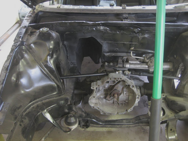

Also created an exhaust tunnel so I don't have to share the trans tunnel. Should make servicing much easier and makes a 3.5" exhaust fit nicely. Also allows the turbo outlet to point straight at the firewall so the downpipe has plenty of room.
Should be fun to use the ebrake handle from time to time...

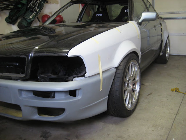

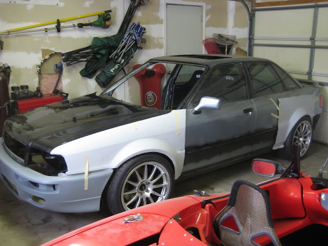

Getting the body set for 275's as well. These are 265's mounted up on 18x9's with an extra 10mm spacer so when I mock everything up I'll have room for 275's.

So the flares are completely different now, not the ones based on 944. Who made those? I think you'll either have to modify the leadinng edge of the fronts or run suspension so stiff with basically 0 body roll.
Shifter setup looks great! Are you going to keep your seats that far back?
Exhaust tunnel is also great idea, I'm just not sure about cutting out the main frame rail out of the car - it looks like you did? I know it wil be caged, but still...

Got a good deal on these fenders. So going this route even though the boxy 944's would have been cool. Planning on some mods much like Mark did for his coupe. I clearly see there will be some rub issues.a_CQ wrote:So the flares are completely different now, not the ones based on 944. Who made those? I think you'll either have to modify the leadinng edge of the fronts or run suspension so stiff with basically 0 body roll.
Seats are pushed back. Pedals are pushed back. Shifter is pushed back. Just gotta move the steering back now and I have all but one piece to finish that job.a_CQ wrote:Shifter setup looks great! Are you going to keep your seats that far back?
Main frame rail is untouched. Just touches next to it near the firewall.a_CQ wrote:Exhaust tunnel is also great idea, I'm just not sure about cutting out the main frame rail out of the car - it looks like you did? I know it wil be caged, but still...

So these are 034 pieces? Or..?

WHOA....that's going to be badass! Are those the supertorismos?

034 did a group buy a while back.ChrisAudi80 wrote:ts, where did you get the CF hood?

Wheels are team dynamics. Not the lightest but a cheap 18x9 that looks good to get me started. Might move to 18x10's at some point. 17's would be nice to keep the weight down and I could get the car lower as well. Harder to find wide 17's though.Alloutofdonuts wrote:WHOA....that's going to be badass! Are those the supertorismos?

Definitely bad ass...Alloutofdonuts wrote:WHOA....that's going to be badass! Are those the supertorismos?
I don't think they are OZ Superturismos. The area around the bolt hub is different.
http://www.ozracing.com/car_wheels_var/ ... 25497.aspx" onclick="window.open(this.href);return false; ... 25497.aspx
