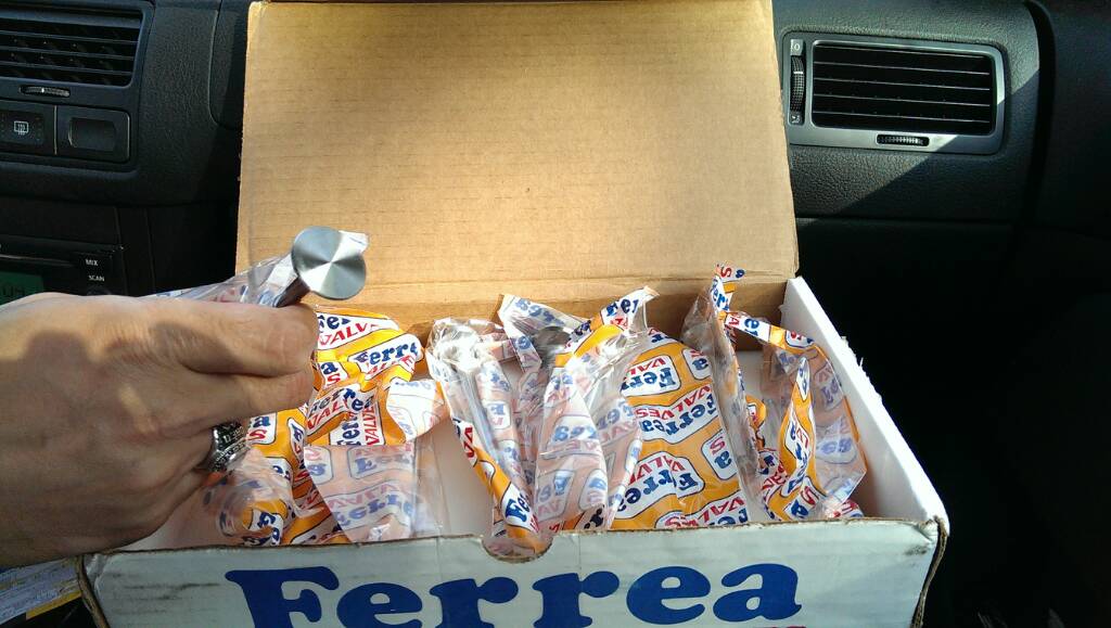

by mushasho
Like a box of chocolates... Mmmmmm
- uploadfromtaptalk1368220416335.jpg (82.75 KiB) Viewed 59815 times

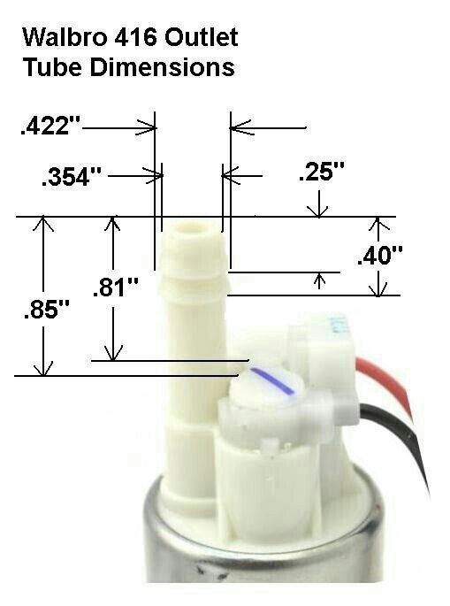

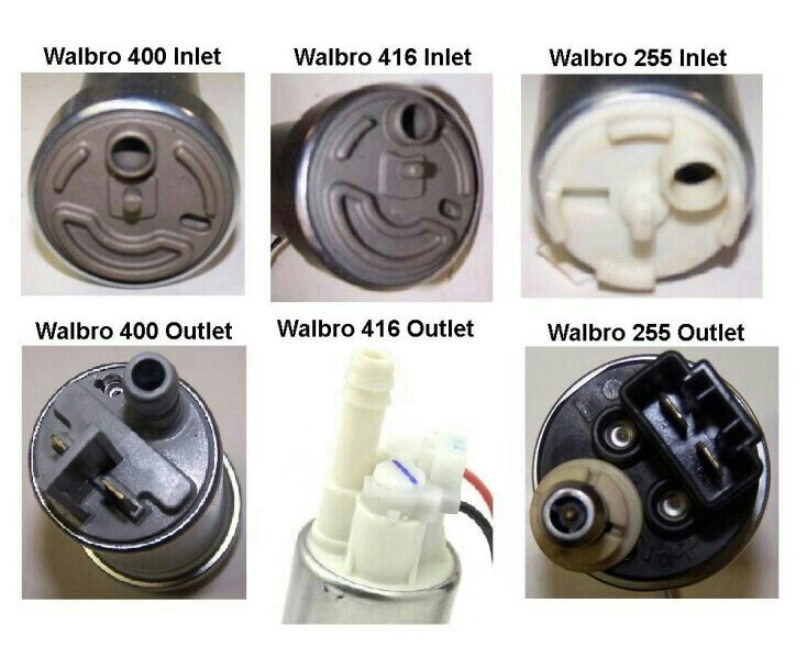

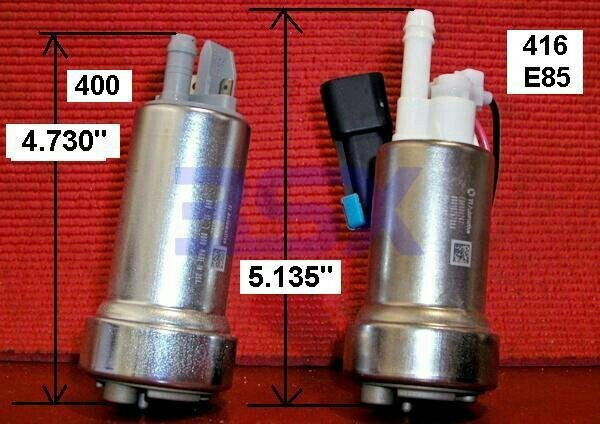

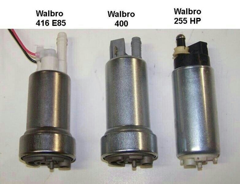

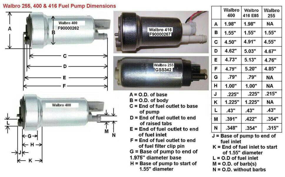

Thinking of running the new line of Walbro (Part #F90000267) as I'm running a stock pump at above rs2 levels...
Seems like there is a packaging constraint I may encounter...
Quoted from Walbro:
"Due to the specifications of this fuel pump, please take note of the following:
The larger diameter at the base of the fuel pump will prevent this from being an OEM drop-in replacement on most applications. Modifications to the mounting bracket, wiring, and connector may be required for proper fitment. We recommend 14 AWG wiring to account for the current draw this pump has.
Technical Pump Specifications:
Overall pump length: 121mm
Main Housing Diameter: 39mm
Lower Housing Diameter: 50mm
Fuel Inlet Diameter: 11mm OD
Fuel Outlet Diameter: 11mm OD
Flow rate: 400LPH @ 40PSI
Test Voltage: 13.5 Volts"
The stock pump is about 43mm, so the top part of this pump should slide right in. The base, however, is where I can't remember if there was enough room down there from when I did an 044 in my previous car.
- uploadfromtaptalk1368246290521.jpg (37.03 KiB) Viewed 59784 times
- uploadfromtaptalk1368246275596.jpg (72.18 KiB) Viewed 59784 times
- uploadfromtaptalk1368246264517.jpg (62.28 KiB) Viewed 59784 times
- uploadfromtaptalk1368246249248.jpg (96.87 KiB) Viewed 59784 times
- uploadfromtaptalk1368246230662.jpg (65.36 KiB) Viewed 59784 times

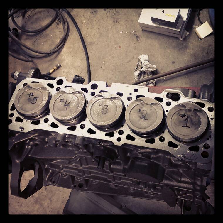

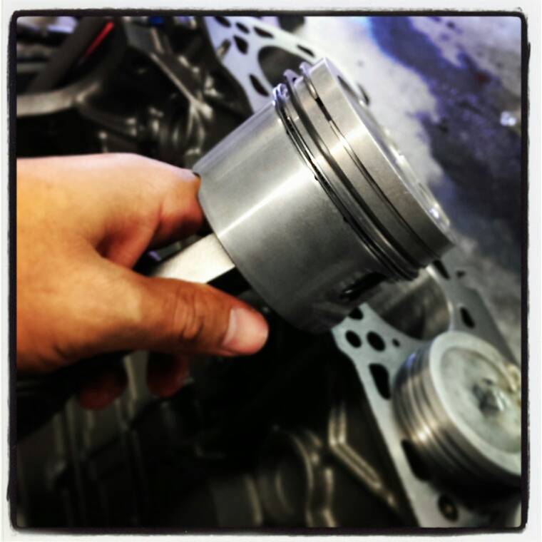

Anyhow, some assembly got done today on the block... I wanna emphasize on "some" because it would've been done had the oil squirters had been picked up with the block... I had sort of rushed in and out when I picked it up...
Oh well here are some pics
- DM Forged Assembled
- uploadfromtaptalk1368311200213.jpg (75.9 KiB) Viewed 59762 times
- Pistons Resting on Block
- uploadfromtaptalk1368311246749.jpg (82.99 KiB) Viewed 59762 times
- With Rings ON
- uploadfromtaptalk1368311226426.jpg (49.65 KiB) Viewed 59762 times

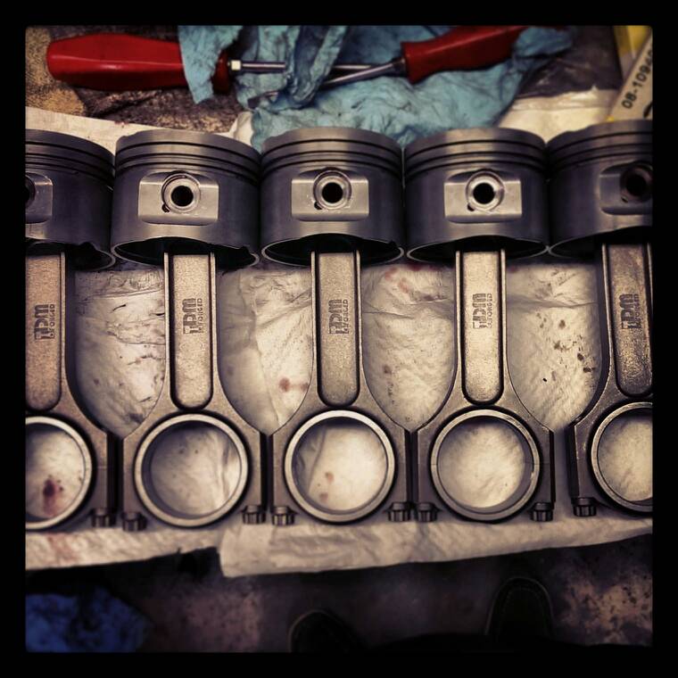

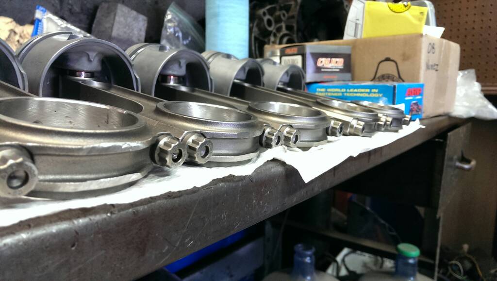

Some balance correction marks on the rods...
- BigEnd Corrections
- uploadfromtaptalk1368311302911.jpg (68.93 KiB) Viewed 59762 times
