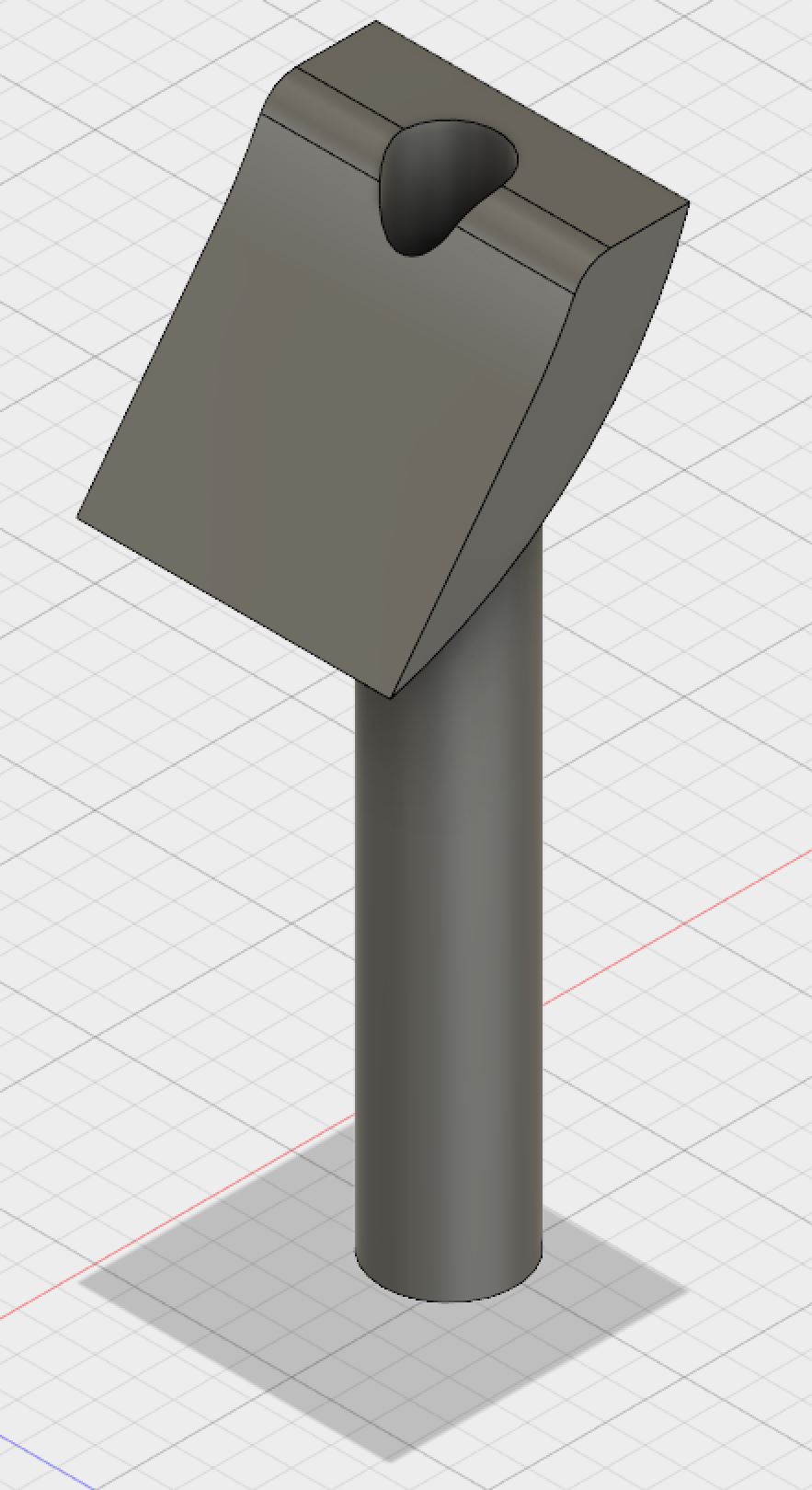

This thin gray stuff is very unpredictable. I've got a good thing going and then all of the sudden I'll get a jam! Dammit. I guess back to the drawing board.
Re: 5 Channel Thermocouple Gauge/Amp w Analog Out & More
Posted: Thu Jul 14, 2016 9:39 pm
by loxxrider

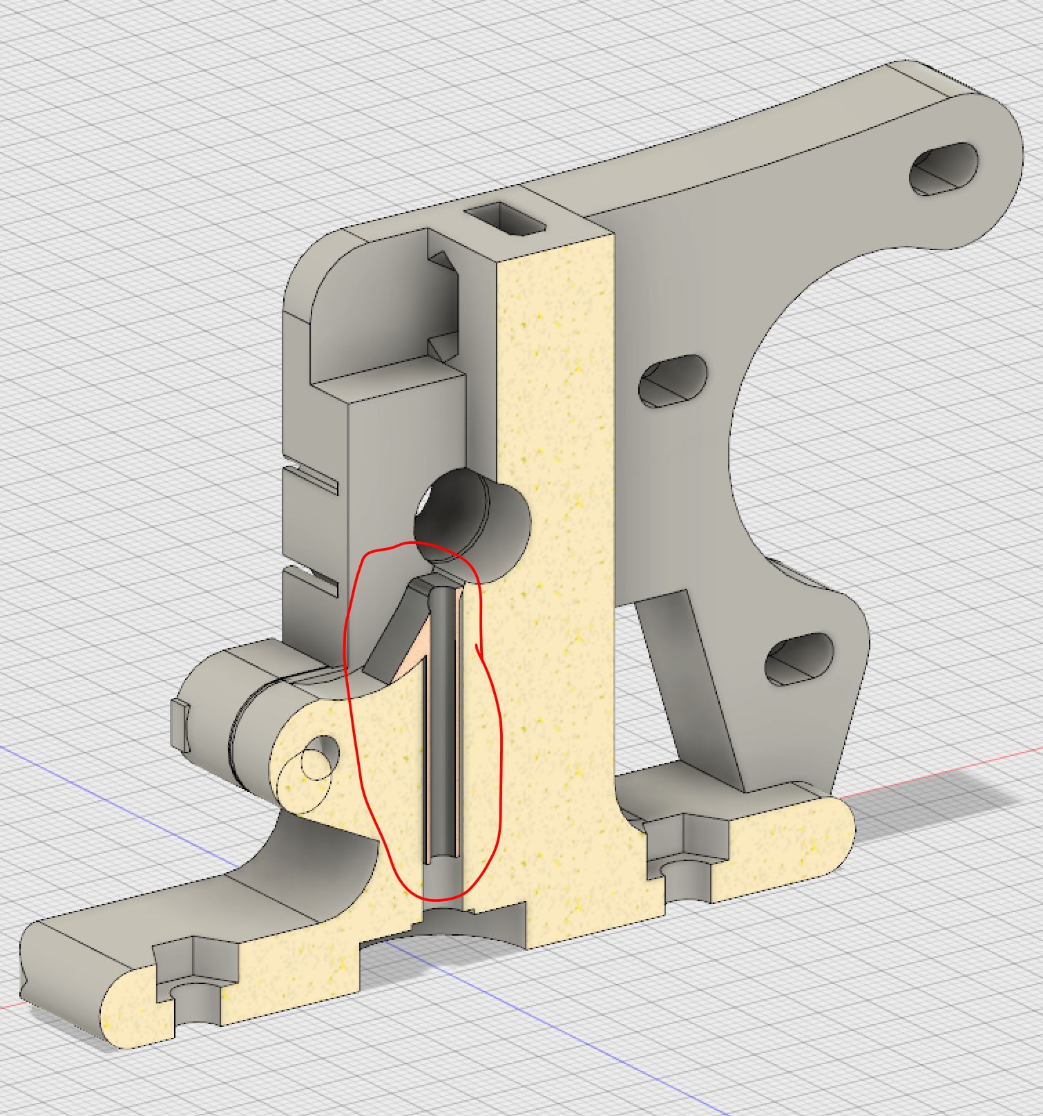

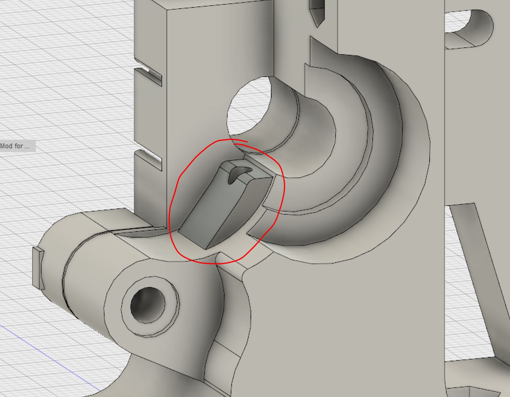

Well, going back to the drawing board (literally) paid off. I searched online quite a bit for a solution for my problem, but there really wasn't one that didn't require buying new parts or modifying something to the point where I wouldn't be able to use it for the regular size filament. The other solution offered up by people was, "you can try it without any modifications, but your mileage may vary." Well, mine definitely did vary. I had luck sometimes, and not others.
As I said before, it seemed that there was a clear issue with the filament buckling. It seemed to me that one could essentially just print a support "tube" to support the filament until it gets to the hot extruder. Well, that's exactly what I did! It took a few tries because I've never attempted printing a part so small (ID is ~0.250 mm, OD is ~3.40 mm). The software doesn't even recognize that wall thickness as something printable, but I managed to get it to cooperate with just the right settings.
Ever since I did this, the prints have been flawless and most importantly, repeatable! Of course, the same result could have been had with the correct size filament and no dicking around LOL.

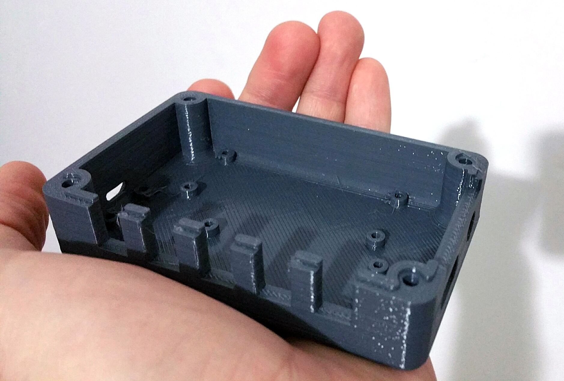

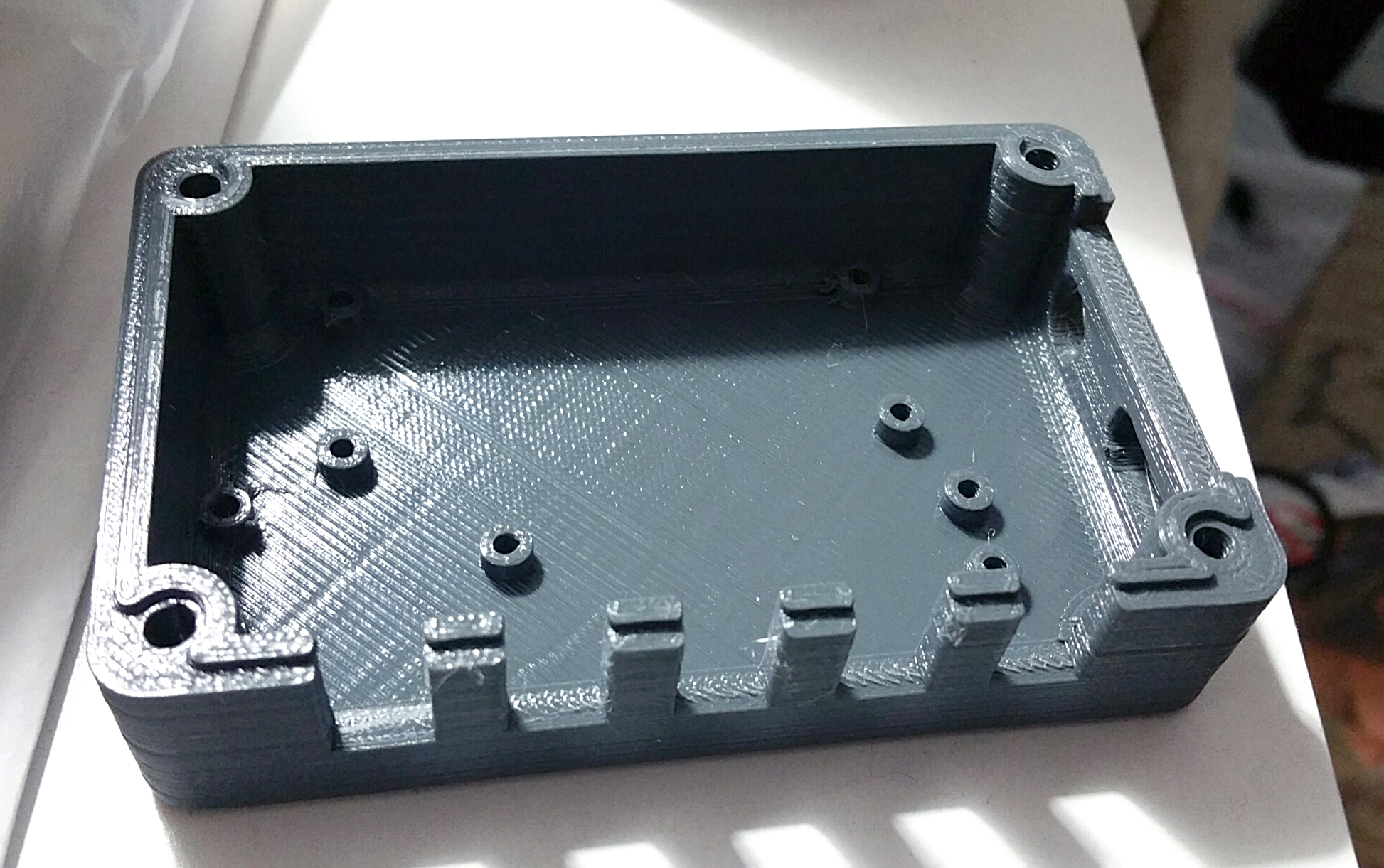

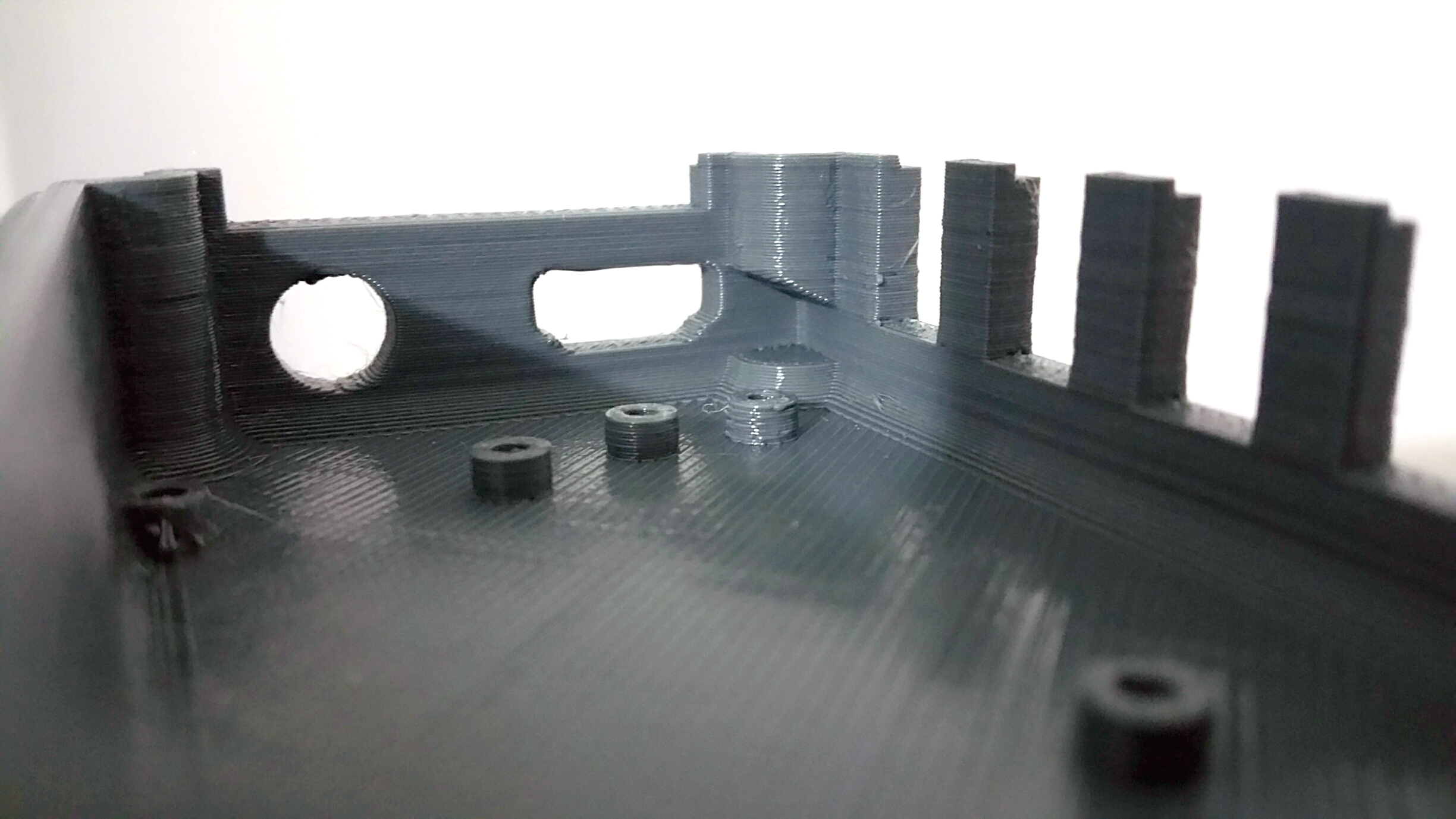

Some bottom-half gray boxes are the fruits of my labor.
Don't have room for something? Just print a relief in!
New texture
I've tried like hell to break these, and I think I'd have to break out the hammer if I wanted to do any damage. The only part you can break by hand (unless you use some caveman strength) are the little posts that go between the thermocouple connectors. I thought I was going to hurt myself when I tried to break one off honestly, so that coupled with the fact that they will not be stressed due to the way the TC connectors mount, mean that they should never ever break. I would put the strength on par with a molded plastic case in all reality. :thumbsup: I'd say development on this is over unless any design changes need to happen due to wire routing or circuit board integration.

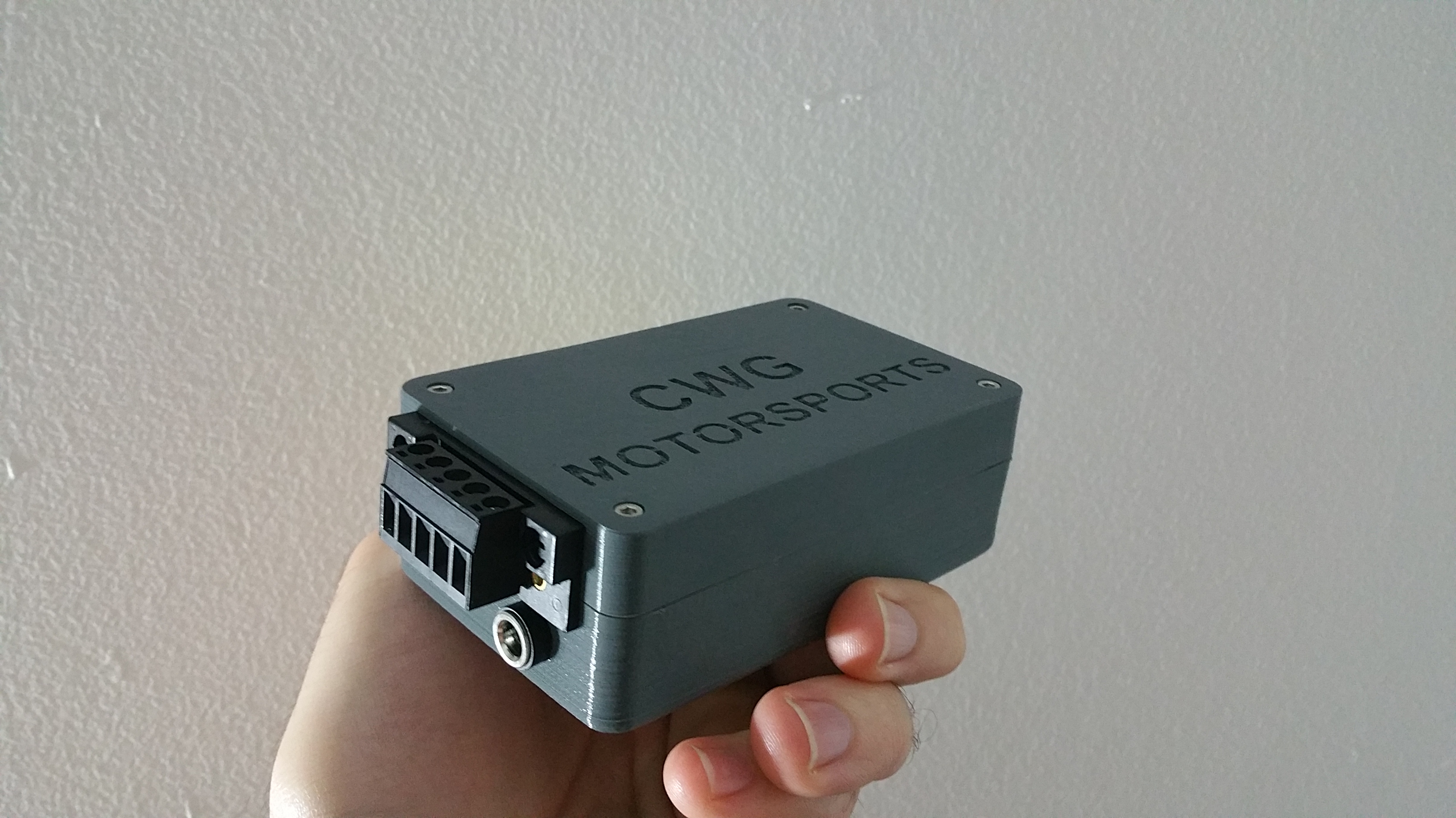

I printed a top half that's quite nice other than a flaw in the finish that I knew would be there when I started the print (I scuffed the print surface by accident just as it started to print).
I like the gray and I'm quite happy with the surface finish. The bottom half I used in these pictures is a messed up one, but I will print a good one in the morning. Even with a warped bottom, the closure isn't awful. With a straight print it should be presentable. This is the most finished I've had one so far. The only thing missing is the hdmi port as it's being used elsewhere at the moment.

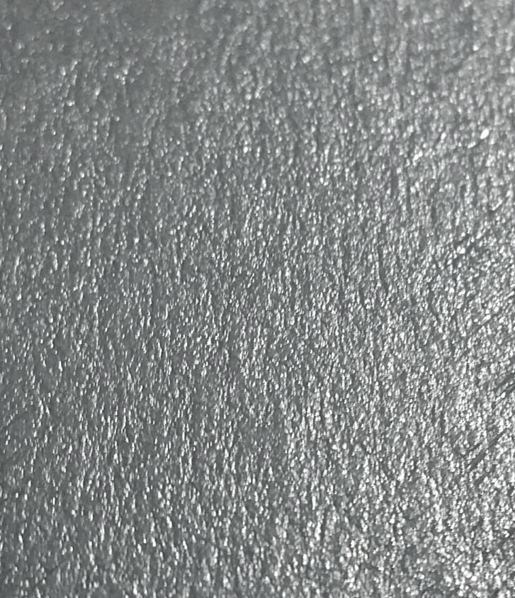

Good shot of the finish

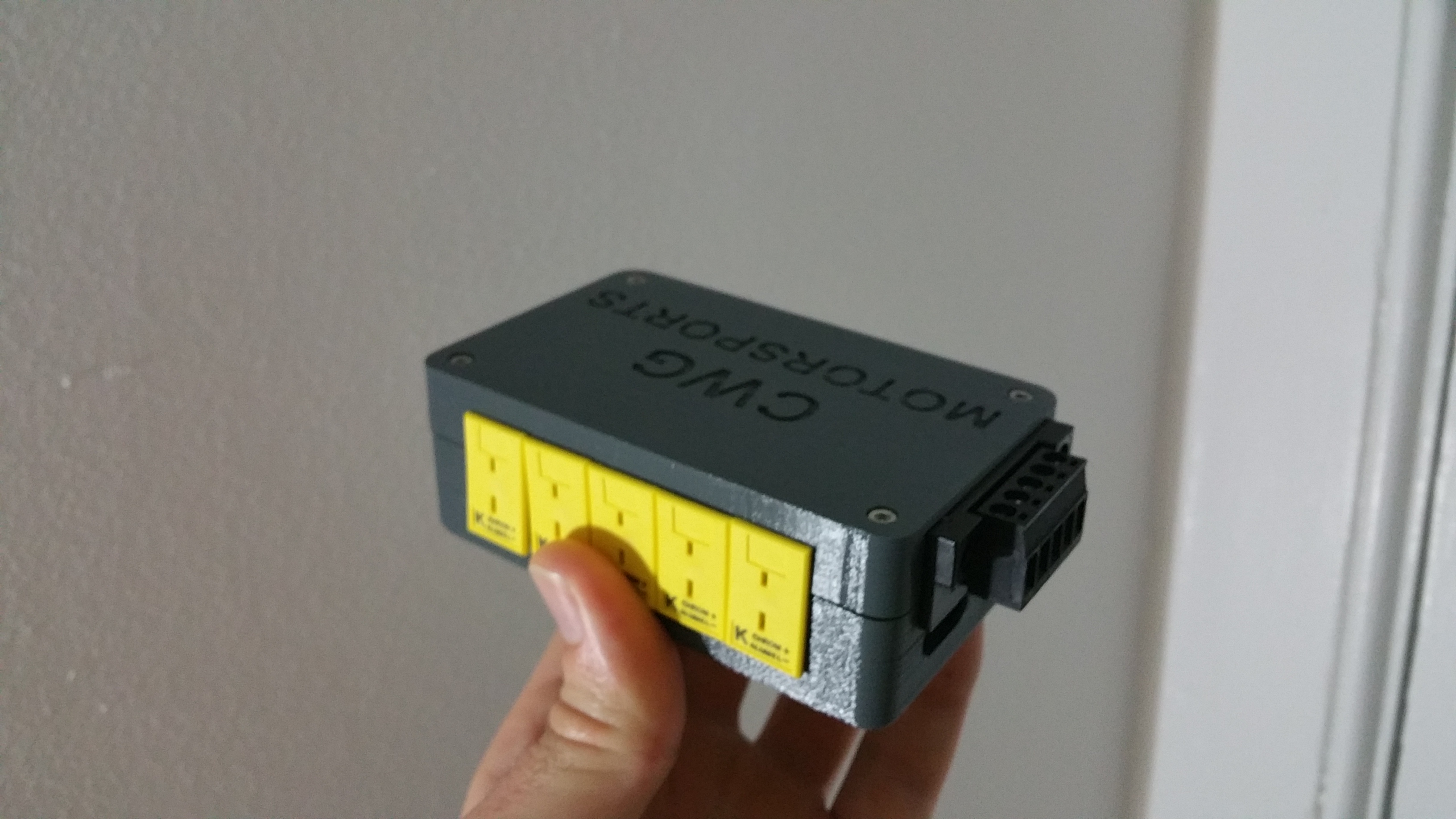

Had to do another print just to make sure I could get it perfect. I'd be happy to sell this one. I think the closure lines are about as good as can be expected with this technology. They're pretty tight and even all around. Nothing really changed, just got it not to lift off of the build plate this time. Warping is very, very minimal at this point. I'm happy with it. I may try some things in the future just in the interest of perfection, but like I said I find the current parts more than acceptable.
The only thing is I keep forgetting to implement is outputs for the alarm and extra outputs for buttons in case you want to locate them remotely from the screen. Just three more wires that need to exit the box. Probably in a similar fashion as the analog outputs, but on a separate connector.
Here are some pics of the closure, plus one to show the bottom finish.
