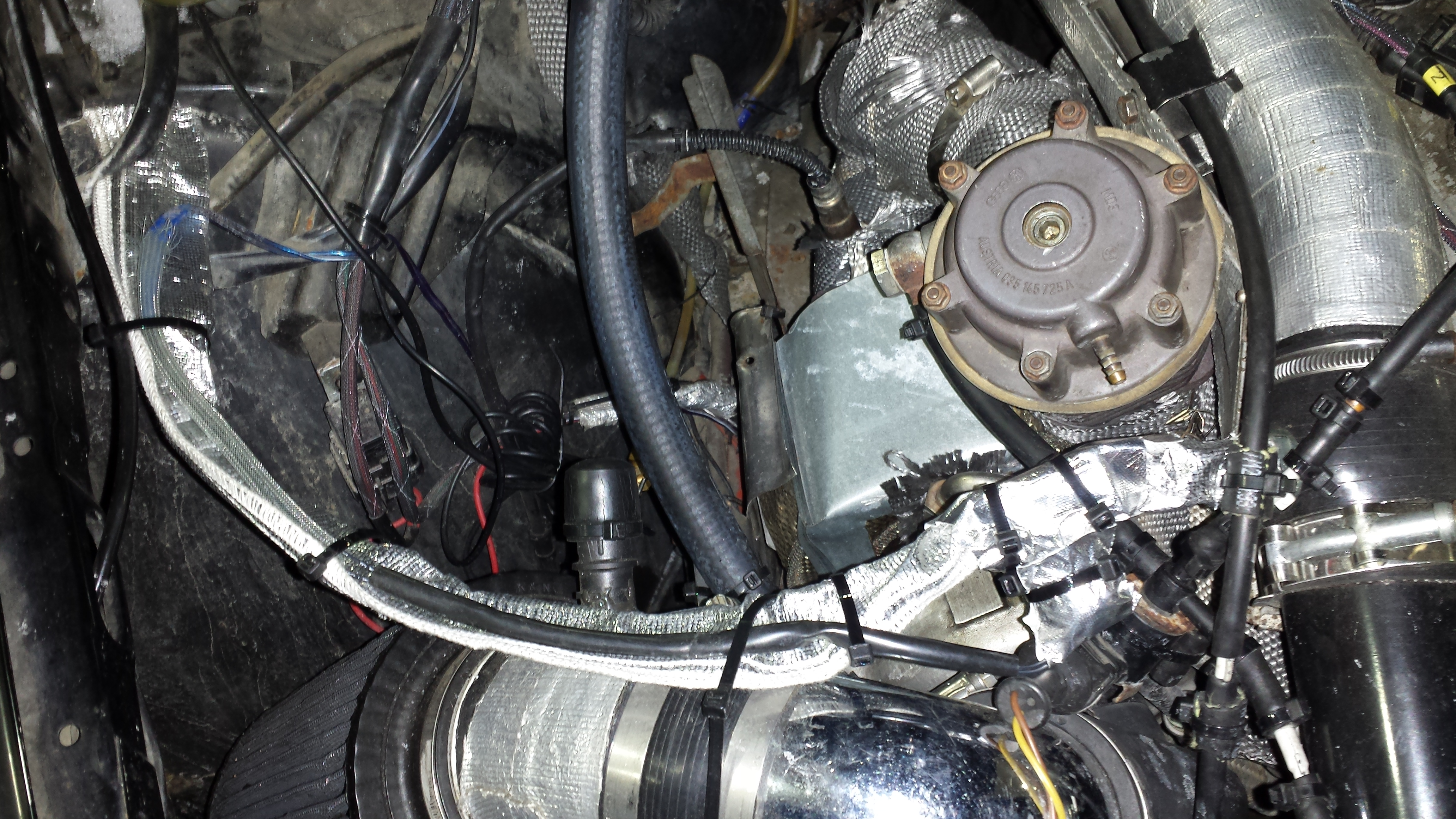

Small update. With w/m injection, the ability of each compound to absorb intake charge heat and dissipate it is based on how much of each is present in the mixture. I figure it stands to reason that the cooler I keep the mixture prior to injection will give a beneficial increase in that property. I did this with my supply line since it runs from the fender area over the exhaust manifold and turbo/WG area:

Wasn't costly bot difficult and I may even modify my ignition table with the cooler weather arriving.

Besides, my solenoid valve is a big block of aluminum right next to the WG :D
Posted: Sat Jan 16, 2016 7:58 pm
There is theoretically a small benefit, but we are taking unmeasurable. The benefit of having a colder injection is orders of magnitude smaller than the true reasons why water meth injection us effective. That is, the high specific heat capacity of water and the energy absorbed when changing phases. Do not modify your ignition table based on a marginally cooler mixture of watee/meth.

SCIENCE! I think if I run any higher than 30% mixture, I'll be relying far too much on the mix for fuel vs the injectors. I am already spraying as little as possible using my new AEM controller and the discontinued nozzle (so small it's been dropped from production lol). I have seen how how much the lambda drops and it makes me uncomfortable. To be specific I'm running 30% methanol. Runs great but spraying volume is worrisome.
