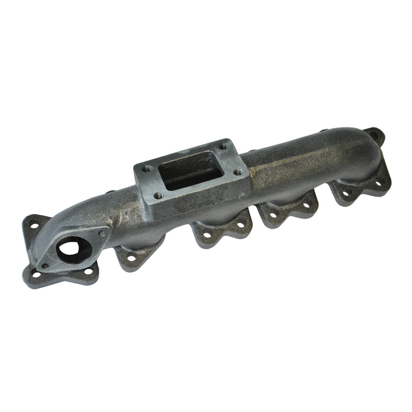

A plan, I made:
A fake Tial
= fake respectable build :flag:

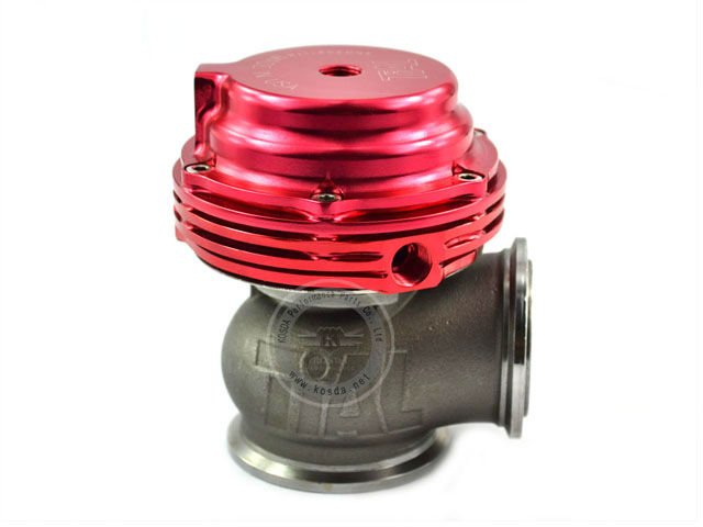

Posted: Wed Feb 10, 2016 11:06 pm
Fake Tial :(

ive heard lots from my friend Dave (hi Dave :wave: ) about the merits of owning a turbonetics 38 mm wastegate. I see there are fake Tials and obviously the real ones would have to be out there too. So what do yous think of a friendly competition of comparison between Tial and Turbonetics WG's? Thought? Anecdotes? Thanks all
REALLLLLY don't want to spend overy $200 on one. Used is likely a preference so as to obtain a higher quality piece on the cheap-ish-er. Have my eye on a used turbonetics one right now but I dont want to find out it needs a diaphragm or more in the end

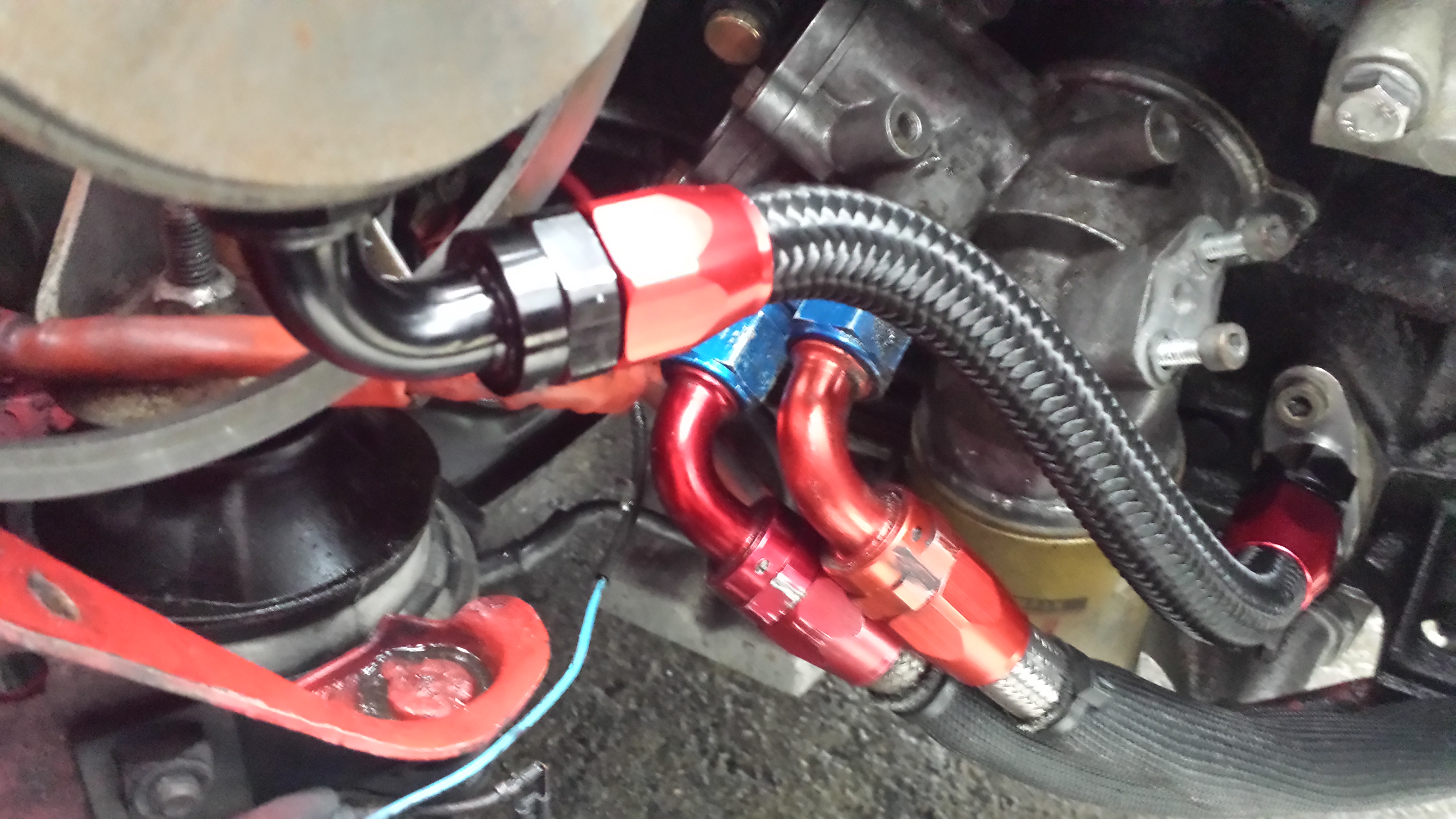

I did end up using a restrictor on my HX35 with good results, but take that as you will. I'm only running a -10AN drain so I was a little worried about the drain flow. The restrictor was my way of making sure that oil pressure buildup was pre-turbo.
Here's the setup I used for the drain.
http://www.ebay.com/itm/201137285873?_t ... EBIDX%3AIT
http://www.ebay.com/itm/310739535043?_t ... EBIDX%3AIT
HX35 Drain Line
HX35 Drain Line
More details here: http://www.motorgeek.com/viewtopic.php? ... &start=175
