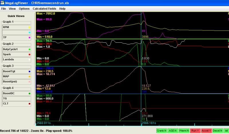

Fuel cut? on a VEMS unit?
yes sir wanna see a log?
It cuts fuel over a specified boost level so really I should call it boost cut.
Justin517
Posts: 282
Post by Justin517 »
I would think you would wana cut spark, not fuel... well both actually, but fuel a split second after spark to not run lean or pump raw fuel.
but you cnat really do that on a dist ignition. you dont really just cut spark, you drop them to the wrong cylinders IIRC.
nuugen
Post by nuugen »
loxxrider wrote:yes sir wanna see a log?
Did you program that in for 17psi? Or was it default..
Justin517 wrote:I would think you would wana cut spark, not fuel... well both actually, but fuel a split second after spark to not run lean or pump raw fuel.
its not dizzy anymore ;)
and VEMS give you the option of "fuel cut above kpa"
mine is set at 226 kpa or 18 psi...I set it at that.
In the log it crept up to about 18.9 after fuel cut kicked in. Then of course I let off the throttle :D
sorry for the crappiness of the pic...i only have stupid paint on this computer and its bitmap to jpeg converter sucks and so does photobucket's.
nuugen
Post by nuugen »
Why do you limit yourself to 18psi LOL
haha I dunno!
It still hasn't even been tuned yet (and I'm a safe better). I'd just rather have it max at like 16 psi and see how afr and such is and then move the limit up in slow increments just so I dont run out of fuel or something.
That being said, this is a kickass base tune from Kevin. I have to hand it to him!
