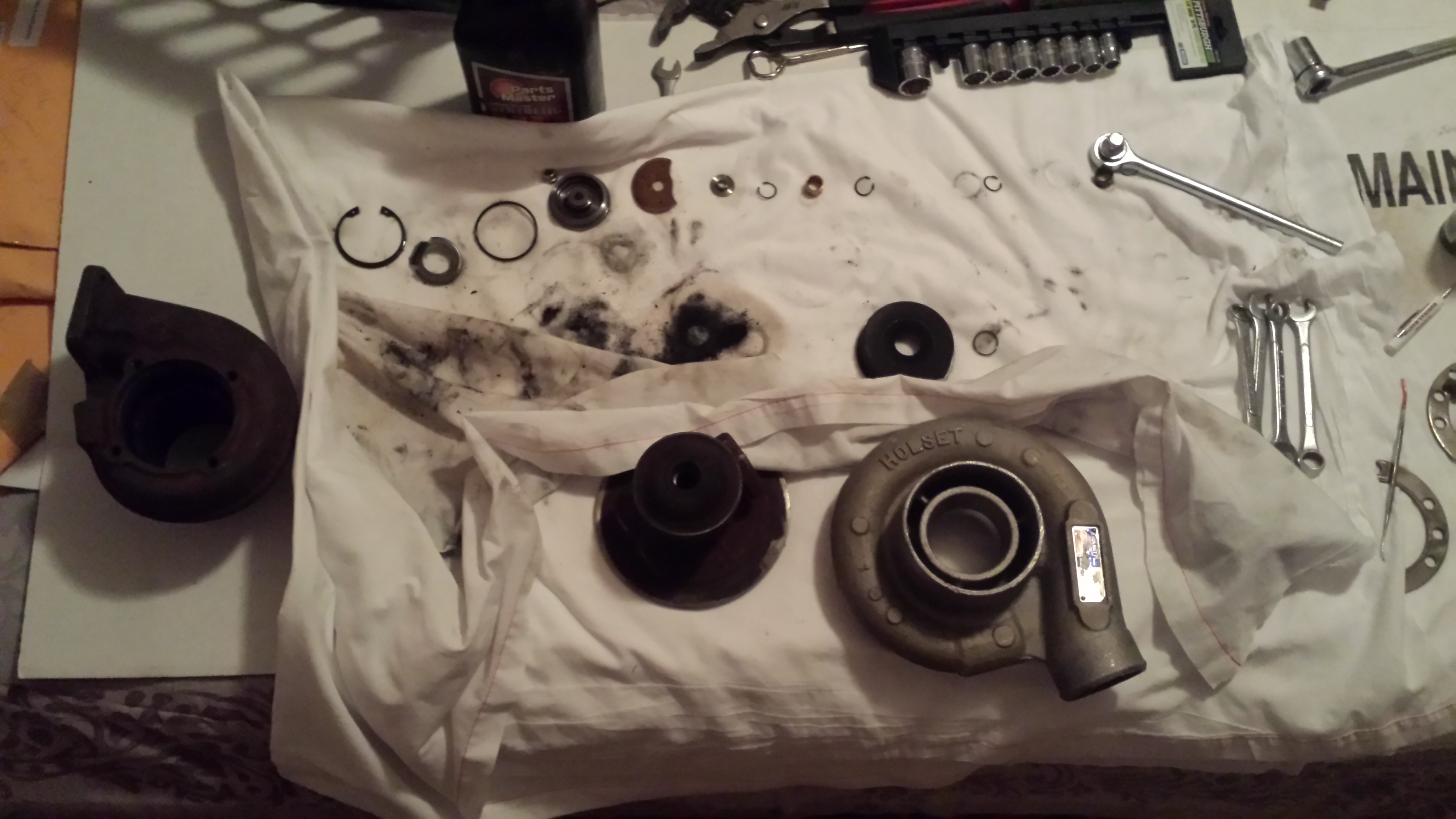

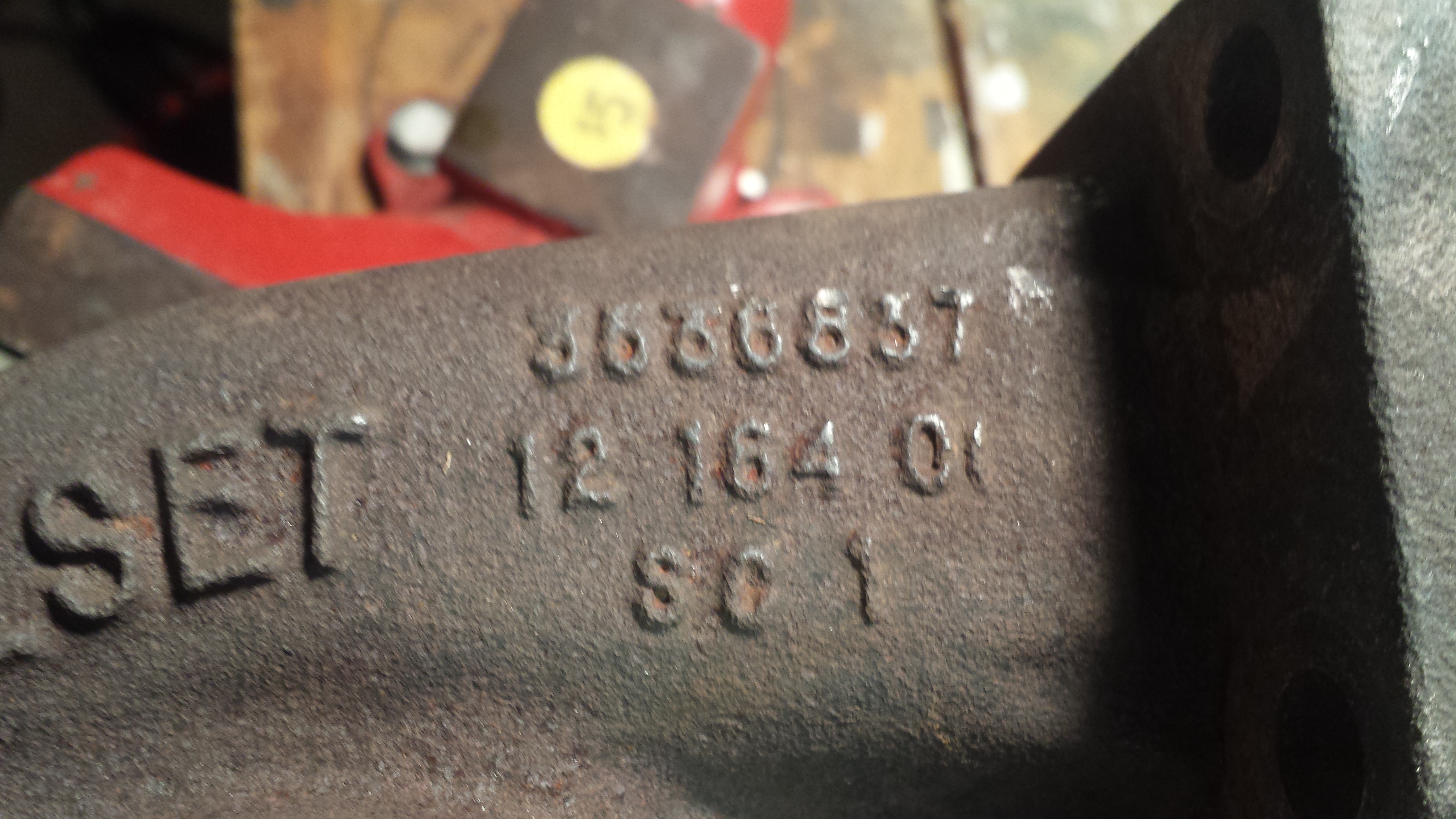

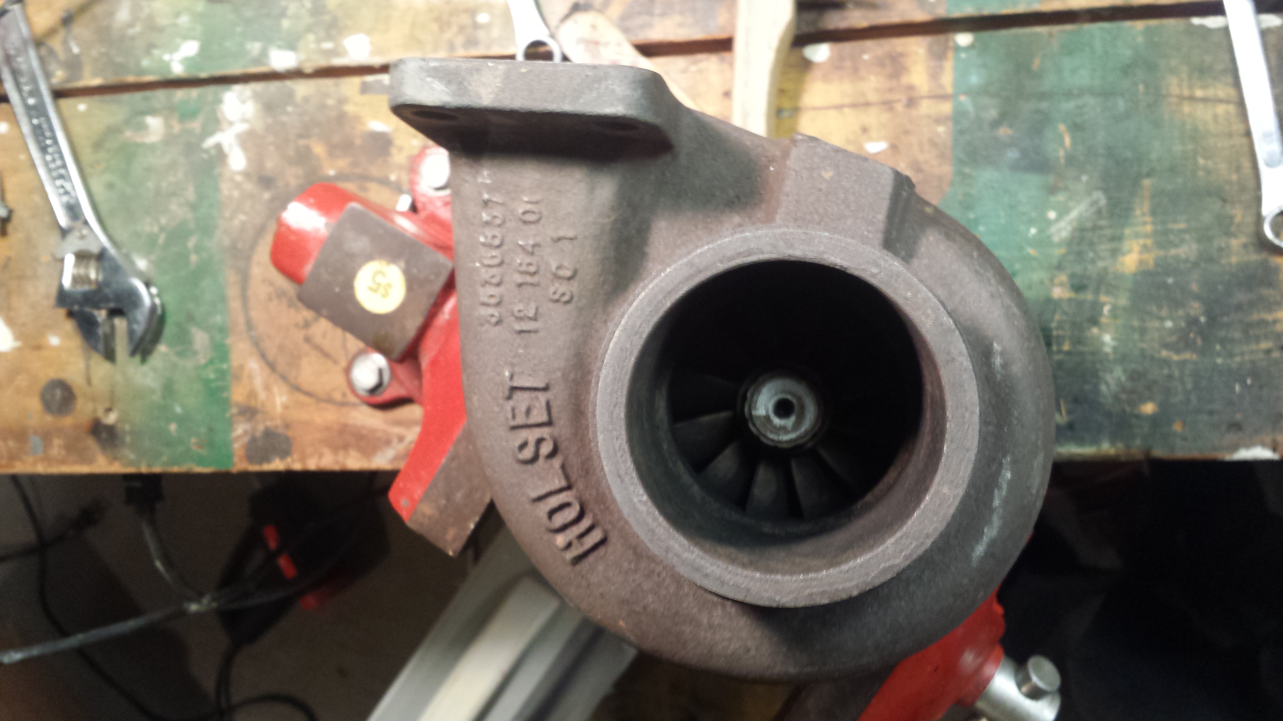

Posted: Sat Feb 20, 2016 3:14 pm
by 88a5tq
Jesus Christ it took 2 or 3 hrs with the heat gun and torch to free this bastard. Oh and a week of trying
For the curious few:
Hotside reads... dam I can't even read it lol
- 1455999742253-1261207203.jpg (3.03 MiB) Viewed 31902 times
- 1455999807231848874406.jpg (2.52 MiB) Viewed 31902 times
Posted: Sun Feb 21, 2016 9:35 am
Look inside the volutes to verify the hotside size.
Posted: Sun Feb 21, 2016 12:08 pm
by 88a5tq
Found early on that it reads a 12

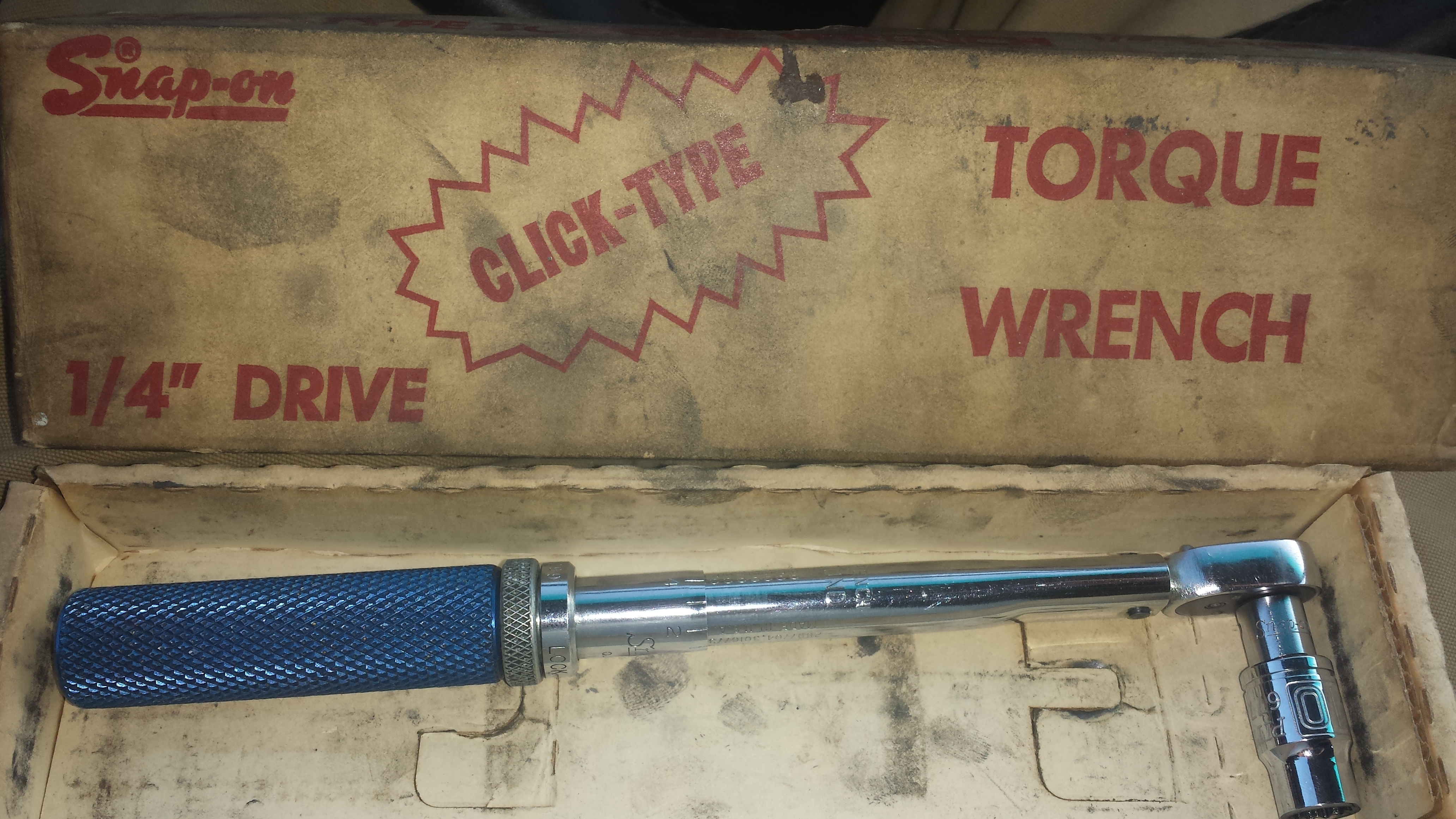

Posted: Tue Feb 23, 2016 5:13 pm
by 88a5tq
Borrowed this really dope snap-on from waaaaaay back. Really good friend coworker at the funeral home lol. Ooooh, blue anodized! This will do the trick
- 1456265548575-2144825596.jpg (3.85 MiB) Viewed 31806 times
Its only fitting that I used this TW. Guy said he "set many a rack on the Cummins trucks with it."
Worked great for the job but I had to try like 6 times of torqueing the nut to get my initial marks aligned. I know they're all separately balanced pieces but I hate taking chances on things like this that take up many hours of my life from start to finish. Longevity was the starting goal and I could control that by doing the rebuild myself, if at all.
Posted: Tue Feb 23, 2016 7:38 pm
It's a Holset. Longevity is the name of it's game
