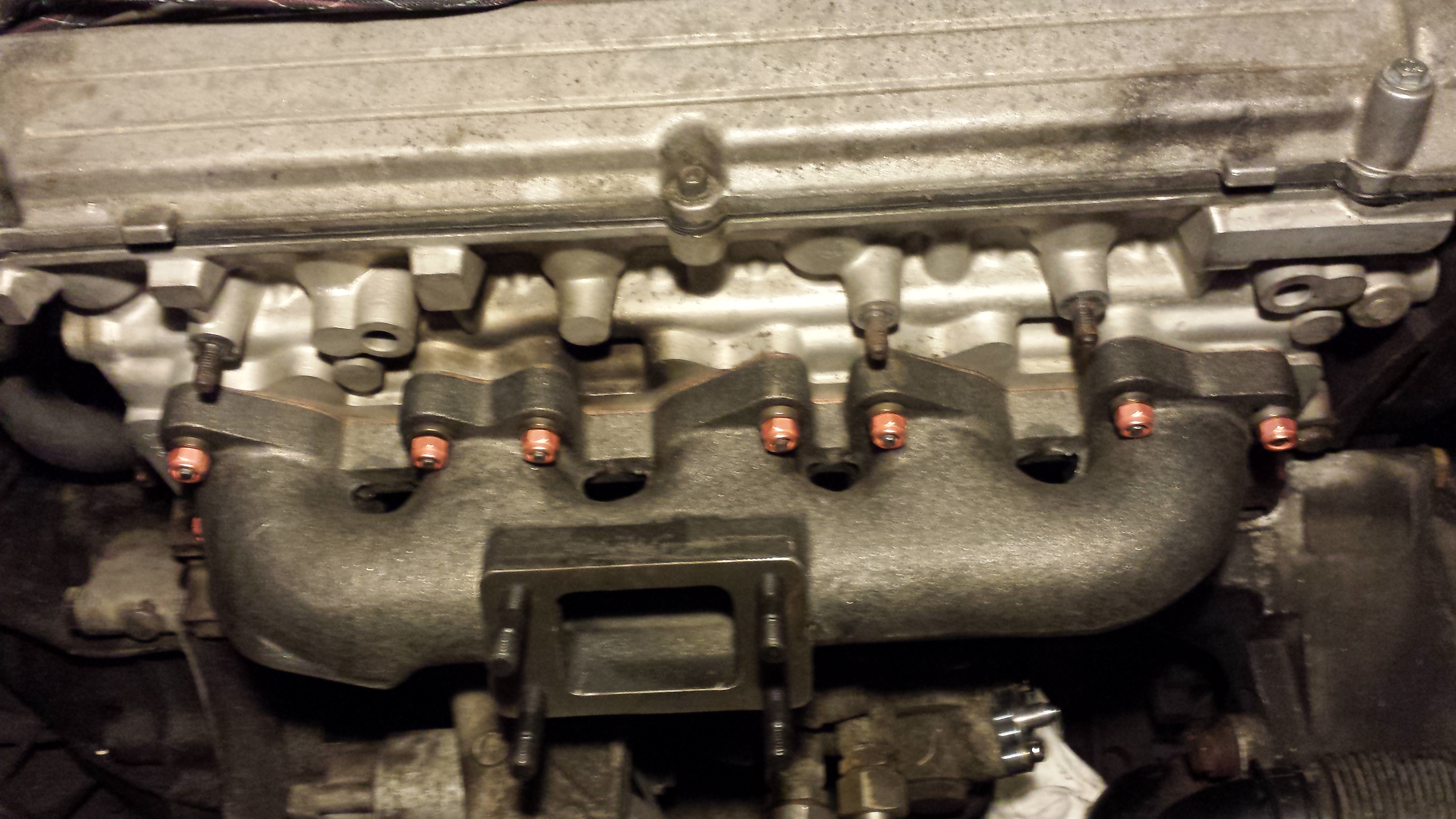

Love showing off my nuts
Being held up by the vibrant fittings and a 90° oil feed line elbow for the 034 flange. Pretty much all the F*ingUSPS's fault. Can't stand them. They never fail to disappoint out here in PA. Hope none of you work for them.
Also this welder is holding me up with the band welding of the exhaust housing. He knows he goofed. Told me 1 to 2 days on early Wednesday and now he won't have even done it until next Tuesday it looks like :roll:
Had to find proper length studs using a caliper measurement instead of the real items. Then on top of that my attention-wh### mother took out her brand new pistol to blow her brains out right in front of me in the kitchen when I stopped in to use the work bench and clamps to open up the t3 spacer flange bolt holes. She's been doing that for 3 weeks tho. Gotta take it in stride :o
Still it's PROGRESS on the racecar front!

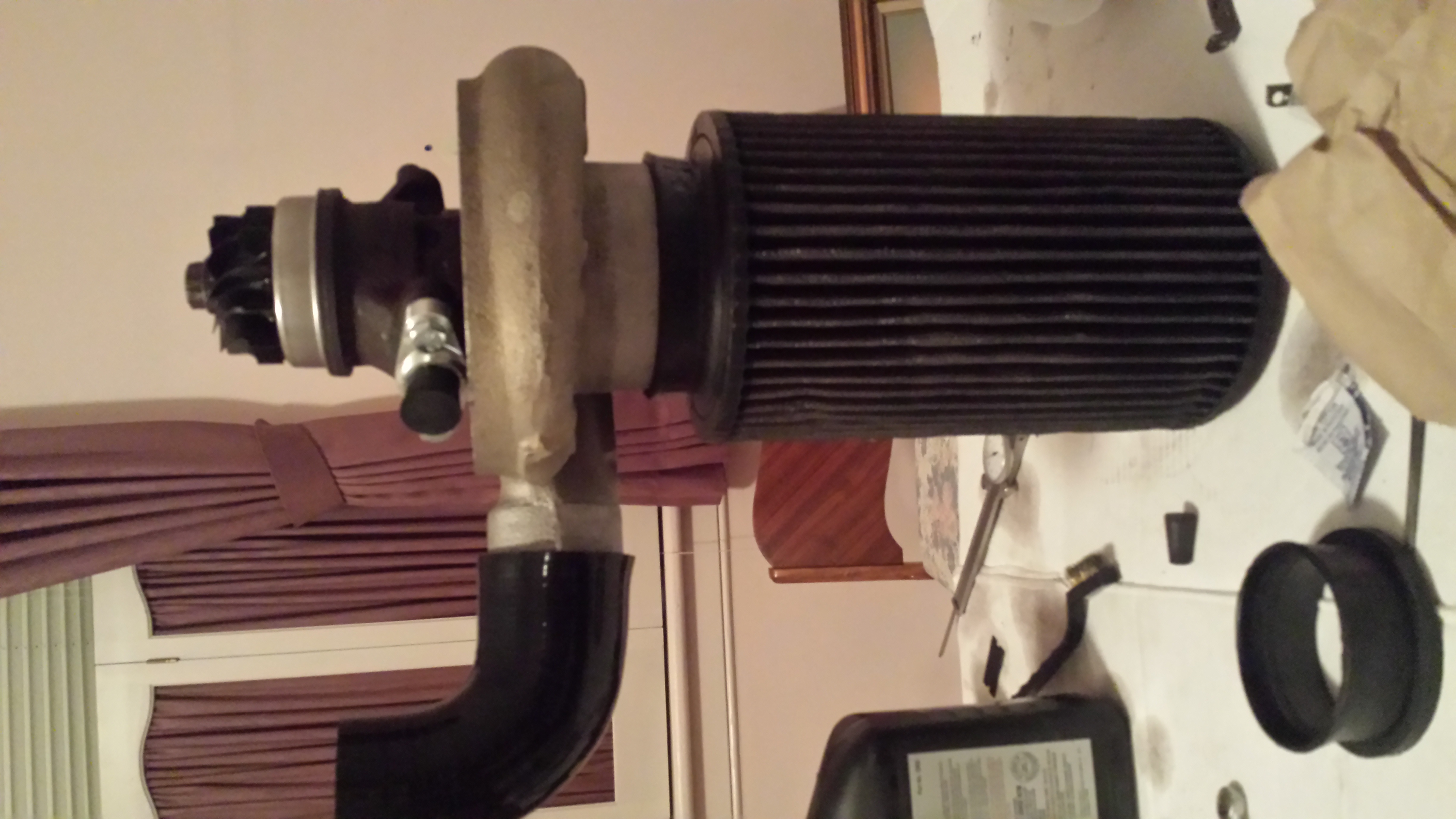

I'm losing confidence in my diy ebay catch can so this is in its way. I may still add some things to it on the inside tho.
http://pages.ebay.com/motors/link/?nav= ... 82&alt=web
Just got off the phone with Summit as well. They say that normally cancelling an order (on ebay) would require a phone call instead of an ebay message. They were kind enough to waive my return shipping tho :)
It's probably tax deductible for them lol. One thing I see concerning these and vibrant's fittings are the summit ones might be longer? Could just be the woman holding them has small hands ;)

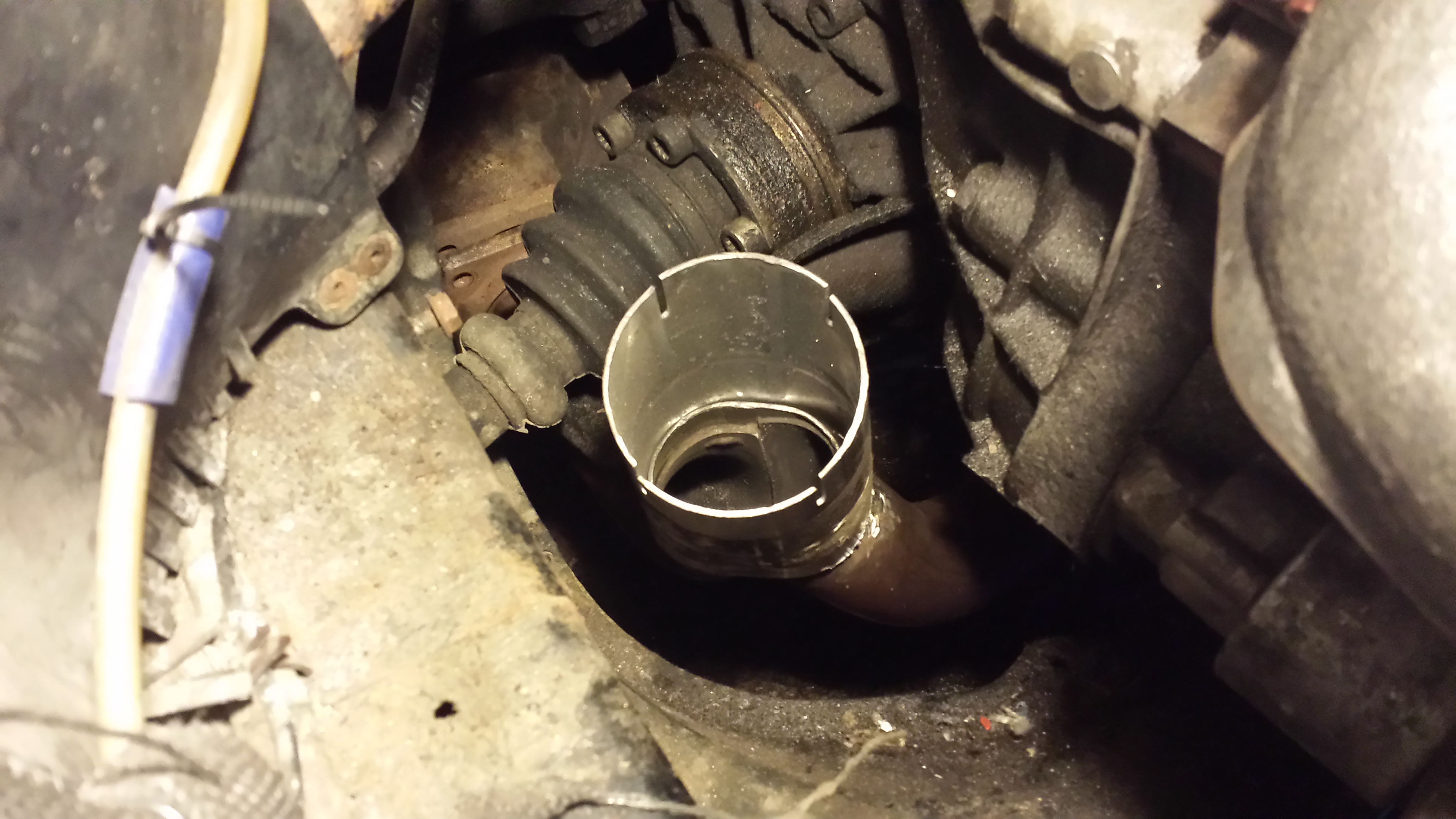

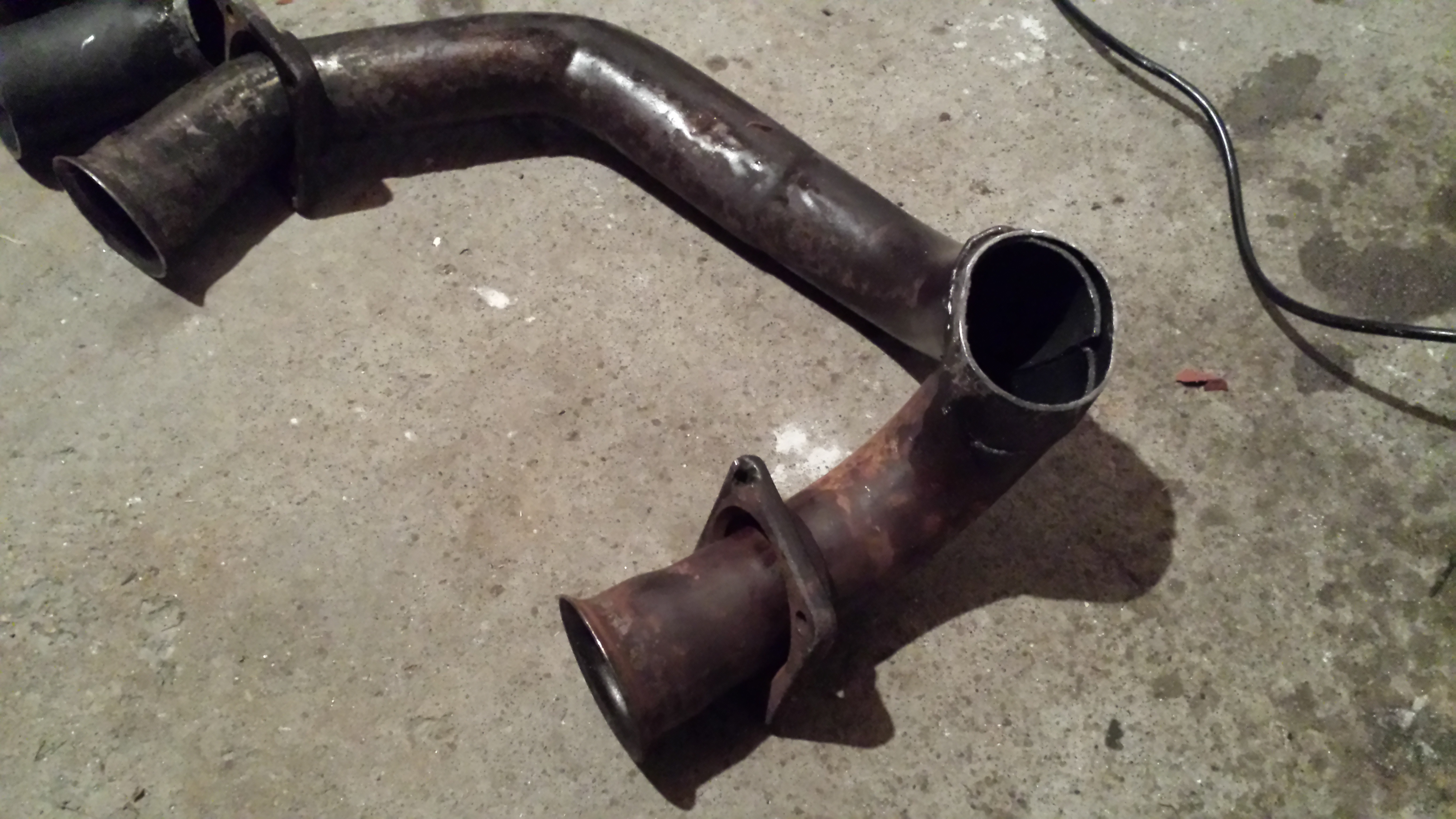

Some bitching scored me a free elbow via priority mail. Still getting boned by the welder tho. This OD is about 3.1" by taking C/Pi. Measure 9.75" around right above the weld so I'm going to take a shot at welding a 3" pipe to this for the DP. 3" v banded DP to stock dual 2.5" should be fiine.. Besides I love my exhaust from that point back lol. No more bottle-necked upper DP :wtf:
My "plan" is to crimp the 3" pipe around that area at the welds or butt weld it I guess.

Everything/one is holding me up! I ordered a die grinding bit to do the inside work on the old DP and widen the t3 spacer flange. Got thishttp://www.tooldiscounter.com/ItemDispl ... Ai7A8P8HAQ
I think it will do the job on mild steel and whatever else if I lubricate it during use.

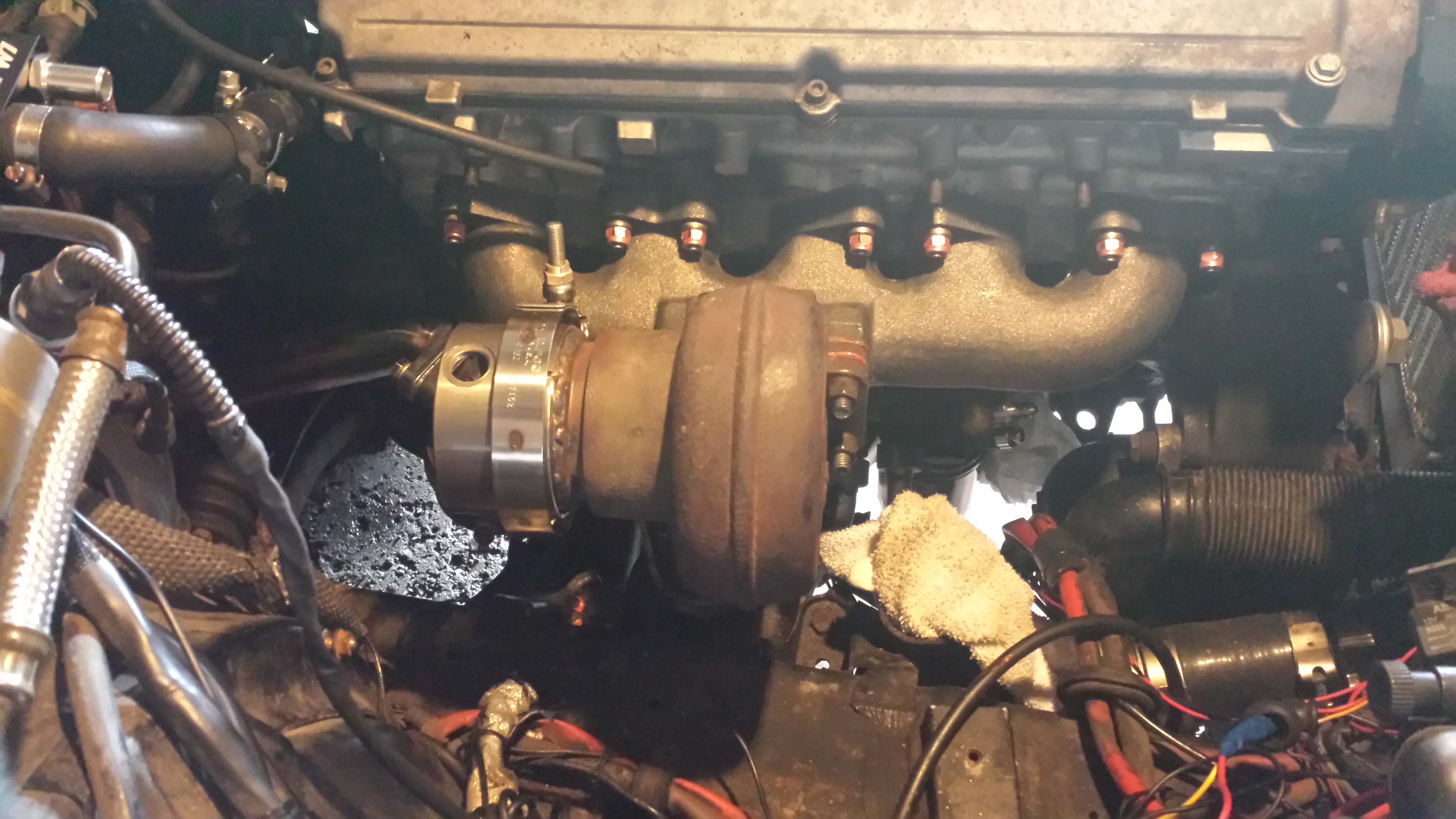

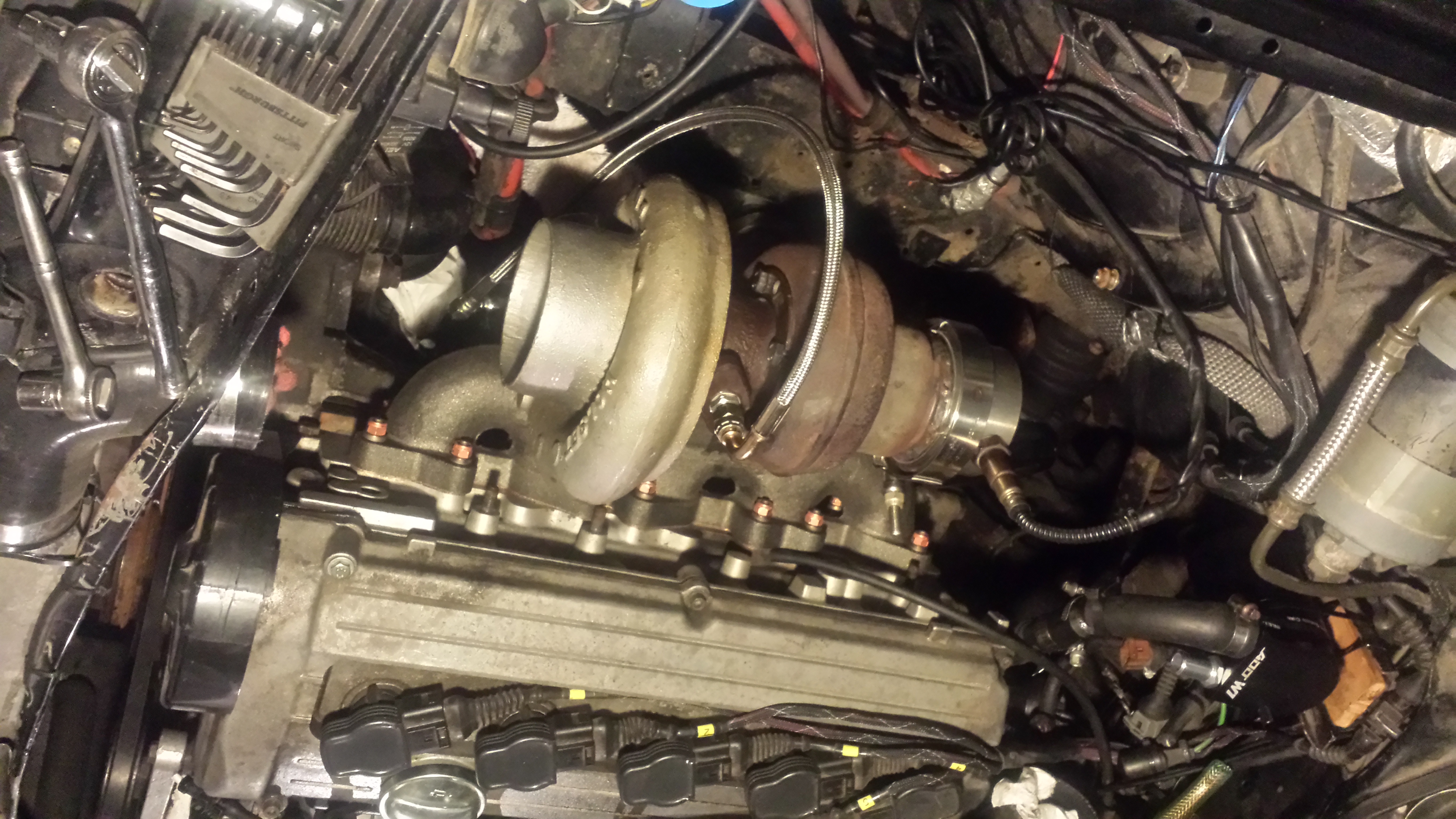

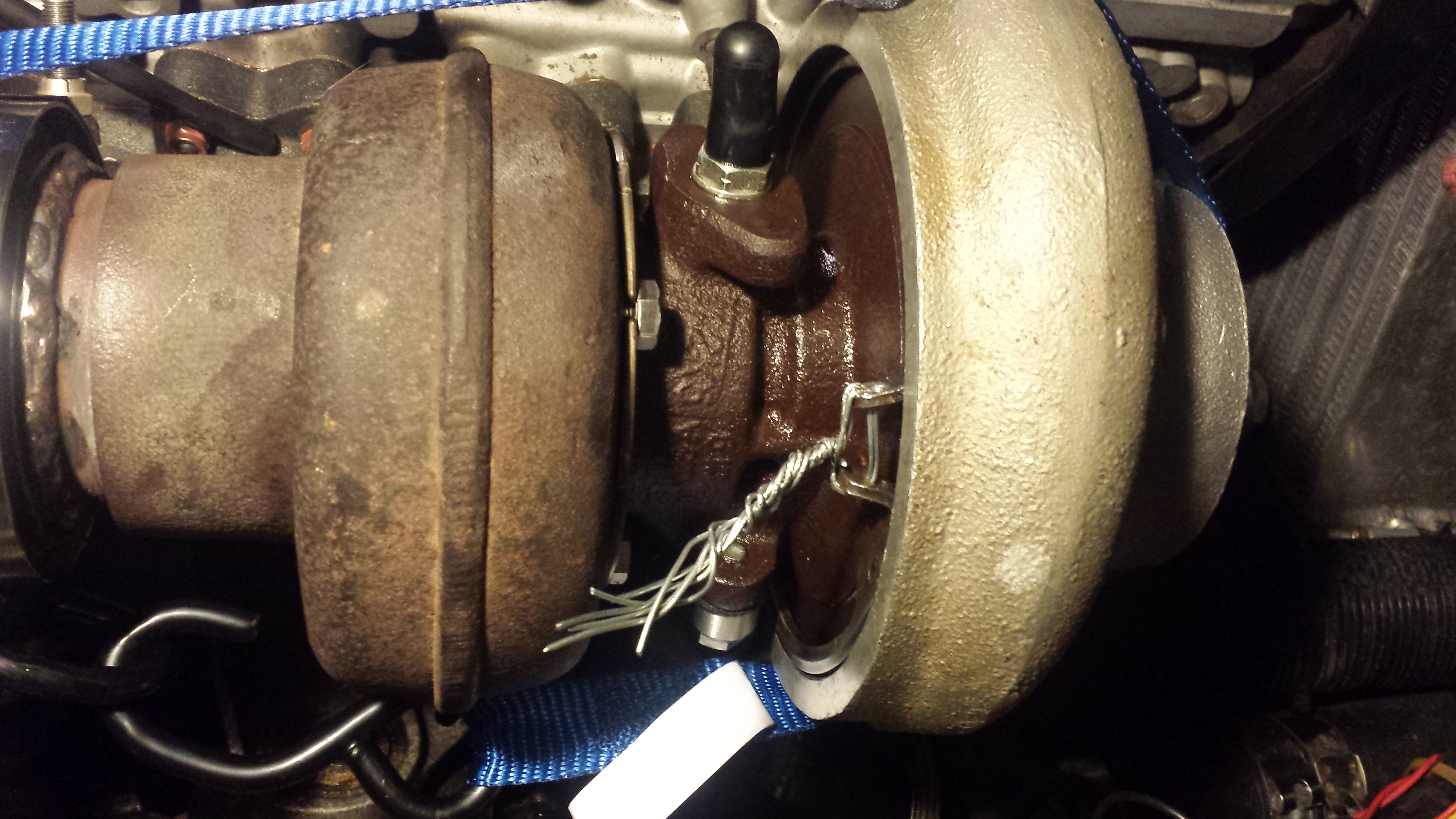

Got my AN12 drain run in one shot. It was the worst trying to thread that npt fitting with the turbo in place tho. Don't wish to do ever again hah. Just have to put intake together and prime the turbo feed line and BOOM
