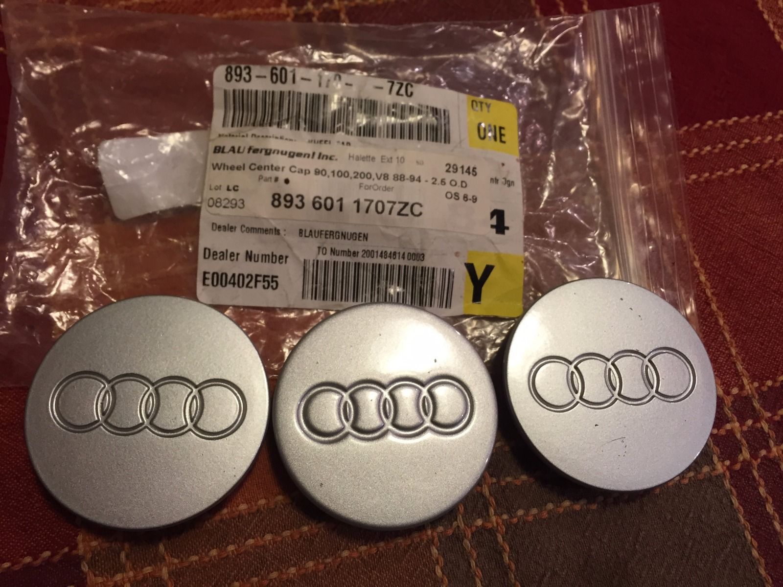

loxxrider wrote:Will do Dave!
Ed, do you have the caps with the correct color code and everything? They should say 7ZC somewhere on them to indicate that. They're painted right? Got an up-close picture?
**edit** nevermind, I found a good picture on ebay finally. Looks like the 7ZC is not cast into the part, only on the package they came in (makes sense from a manufacturing standpoint). That is definitely the correct color code though.
I'll check in a few, busy day. Sounds like you have it figured out though!

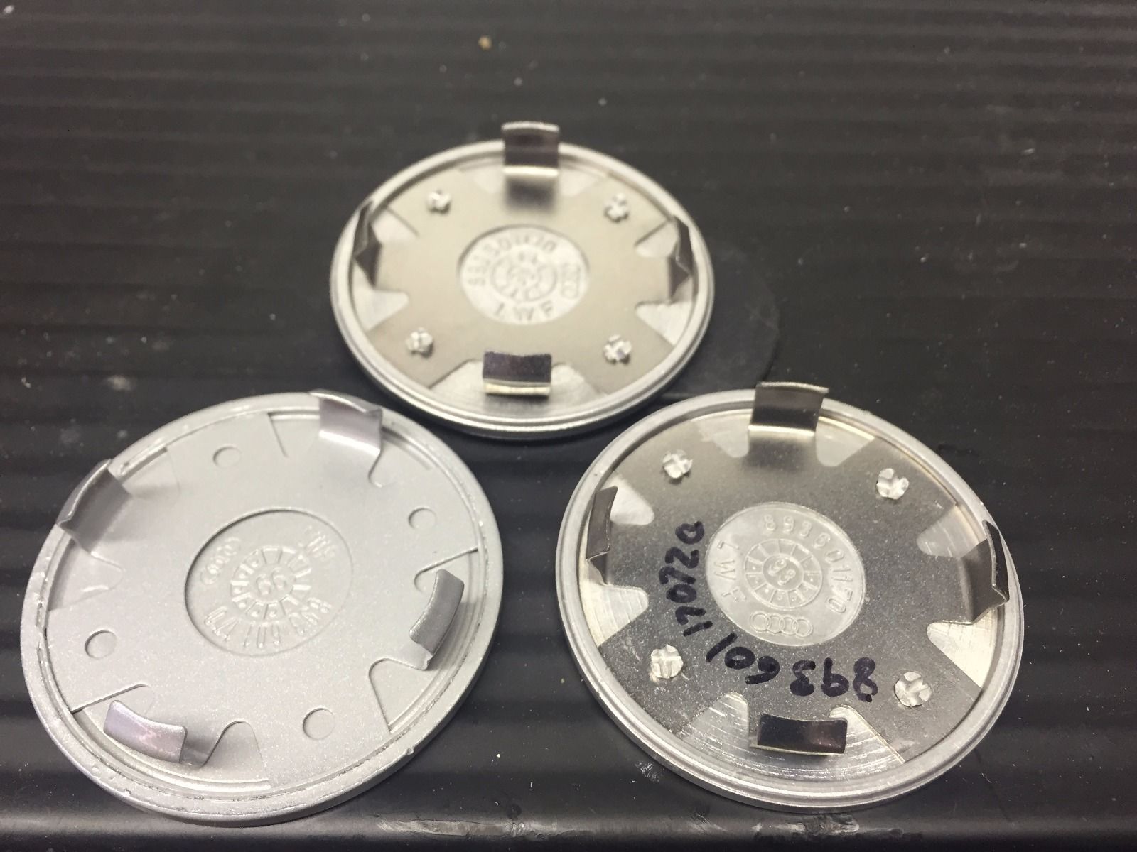

I measure 63.5. The color is not an exact match but really close.

Mcstiff wrote:I measure 63.5. The color is not an exact match but really close.
Thanks Ed! That's about what I expected. Now I have to make a decision. To get caps like these and have them machined for customization purposes or go with resin covered "stickers" for Ronal style plastic center caps.
Something marginally interesting, but definitely a concern for me if I go the machined metal cap route is that there seem to be some slight differences between these little caps over the years. Likely due to manufacturing efficiency changes. Check it out... one is not like the others, and none are quite like yours!
CENTER CAPS.JPG (264.12 KiB) Viewed 32909 times
CENTER CAPS 2.JPG (180.78 KiB) Viewed 32909 times
The differences are slight, but they will bother me! I like the smooth edges of the middle one (and yours), but if I have something engraved into it, the tool will leave a more square edge around the lettering like in the two caps to either side. Bah! So stupid lol
