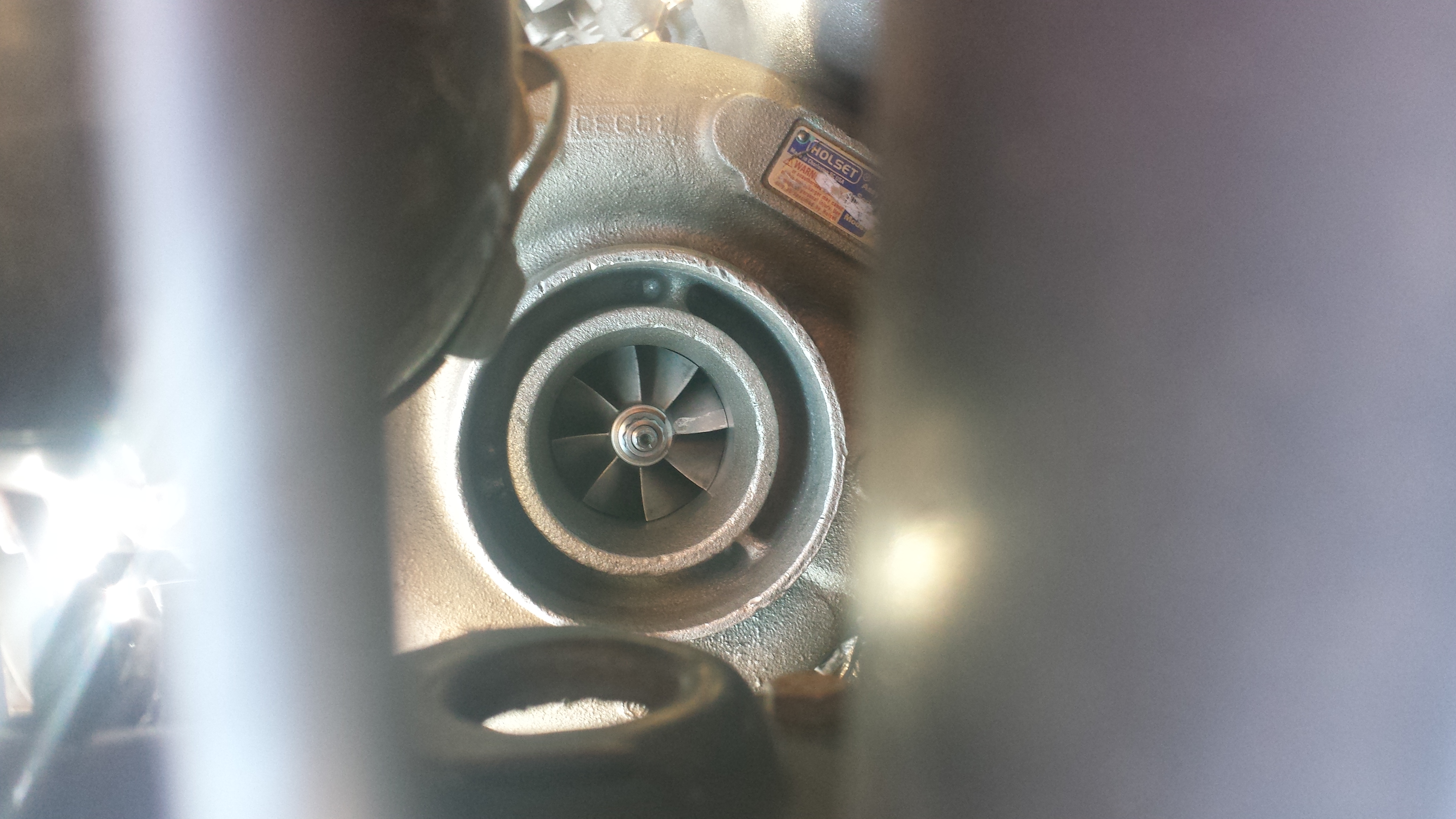

Does this answer your question Chris?
Posted: Mon Mar 21, 2016 5:02 pm
by vt10vt
Is it an HX35 or H1C? I don't think all (any?) H1C's came with an anti-surge housing.

88a5tq wrote:Does this answer your question Chris?

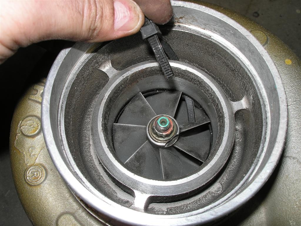

I'm not 100% sure if I can see it or not, but it looks as if you don't have the anti-surge groove cut out. That is why it is quiet! The groove looks like this (although this is an HY):
vt10vt wrote:Is it an HX35 or H1C? I don't think all (any?) H1C's came with an anti-surge housing.
Not all H1Cs came with anti-surge housings, but some certainly did. I had one! My friend had one with the casting for the anti-surge, but it didn't have the groove which leads to the compressor wheel. We cut out the groove very carefully with a dremel and it whistles louder now :D :drive:

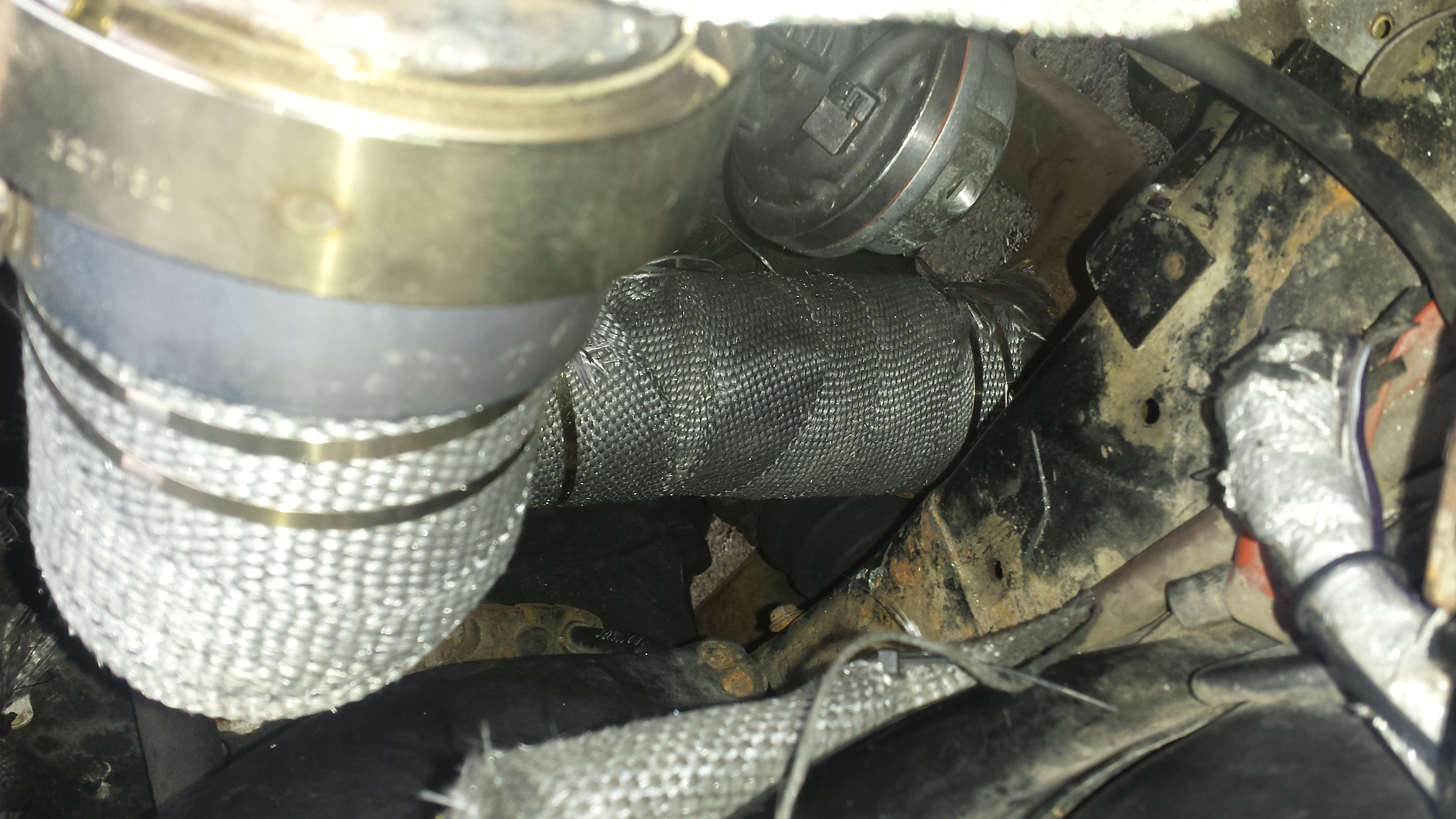

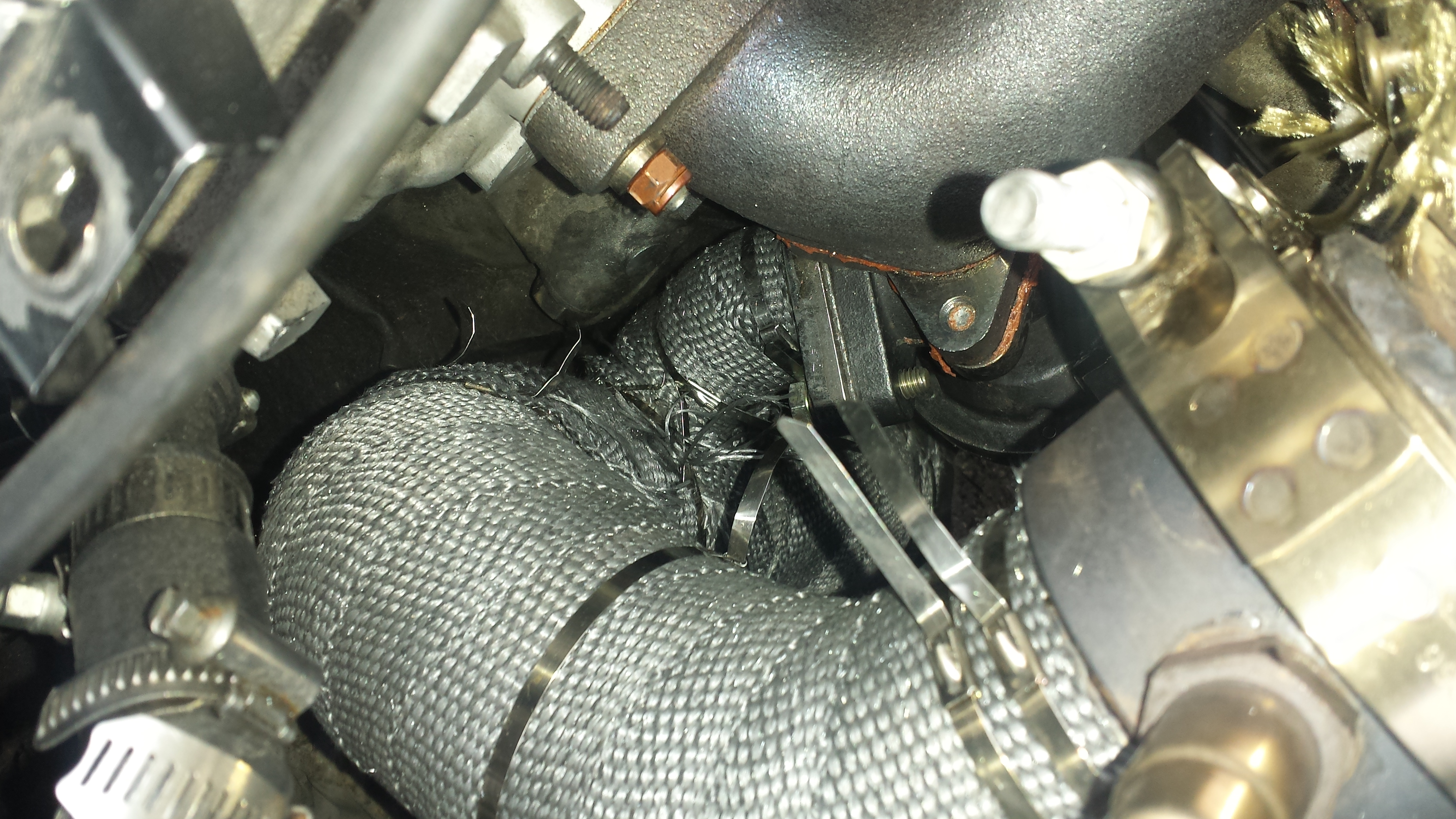

I wrapped the DP in 4 sections with overlap since I did it while on the car. I'm told I'm a quack for even trying lol.
It's fully dressed now above the y-pipe. I was concerned that the WG might overheat with all the heat soak going on. It's still hot as shit right where the v band is. Gonna wrap that part too, I guess, as much as possible.

Thanks. But I just got worried because I wrapped over my vband clamp. You think that will be alright long term?
Looks like it's being controlled to 24-25 psi. I had a guy almost run me off the road so I followed him at over 60 mph through back roads. Car kept up no prob and I felt like it was a a good test of the new setup and longevity. I only just put the wrap on over the v band so if it's a bad idea I can revert it hopefully before a doomsday clamp catastrophe :)

I don't really see why wrapping the clamp would be a problem.

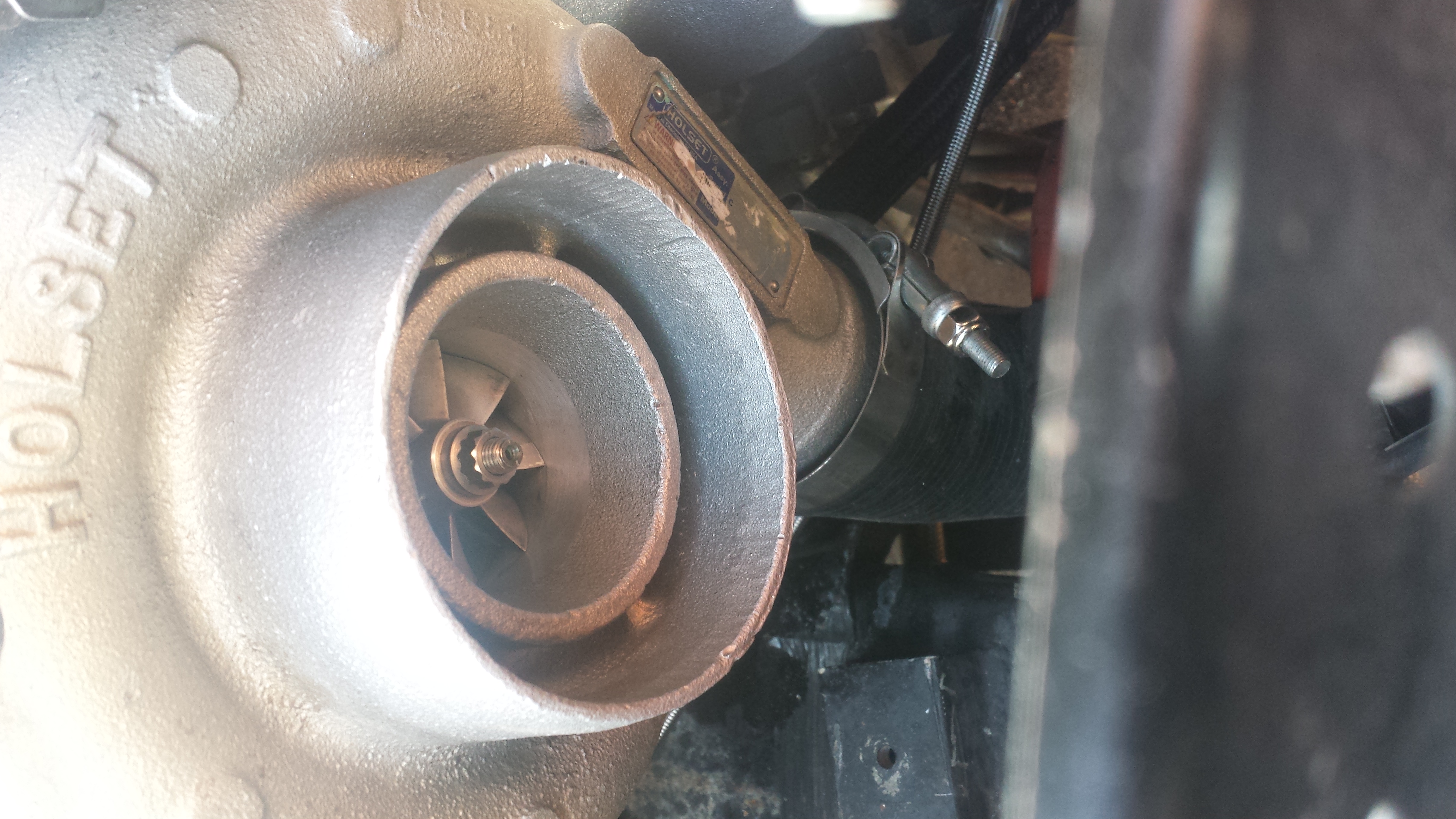

We've hit a brick wall that presented itself concerning Goldfarb. They don't know the inducer size of my 8 blade hx35. Its frustrating as I don't think I could even measure it accurately while its on. I sent them this info from the turbo's ID tag:
3537132
03068978
3537132-03-11/5
HX35
8 blade\ compressor wheel.
That coupled with looking at the close up pics of the inducer leads Brant over there to believe I have a 54 mm inducer. He doesn't have them at that warehouse so he has to check the others over the weekend. :( :( :(
He mentioned selling me a 52 mm and having a lathe bore it to 54 for me since it has a slip-on outlet like my current housing does. Does that sound insane?

Sounds a little silly just for some sound lol. But I'd be looking for one! You don't think you could measure the inducer with a micrometer while it's in the car?

So. As far as holsets go.
Baby H1C is a 54mm compressor with a slip on compressor outlet. Nothing cast for a MWE groove. Available on non-IC Cummins from 89-91. Only had 18cm exhaust housings.
Big H1C is 56mm. 91.5-93 Cummins had them. Available with either a 18cm or 21cm exhaust housing. Has a MWE cover but no groove. Also has a clamp on outlet.
WH1C is a H1C with a antisurge compressor housing and a 12cm WG exhaust.
Hx35 is a 58mm WH1C basically.
