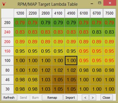

Your lambda target table is funky... not that it's affecting anything right now, but still. I would smooth it out a bit and in general, I'd change the scale and values up a bit. If it were my car, it'd look more like this.
target lambda.JPG (50.65 KiB) Viewed 40405 times

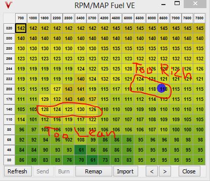

You should easily be able to see from that log that you are too rich in the high RPM "high" boost area, and too lean at boost onset. Your VE table shows why instantly upon looking at it.
Your refDC table still has that dip in it. Why? That is what caused that weird dip in your MAP. I see that you are now using PID, so I think you'd be best to just leave the refDC at 80% across the board or something like that. Then the PID can do it's job better. Putting that downward spike in the refDC is like adding an external disturbance to the system.
"This is one single pass with meth. Taper is ridiculous at the end of the rpm range. Seems to be out of my control as refDC is 100% at the end. Thanks in advance Chris! BTW I notice that when the boost starts its downward spiral, the MAT spikes from 4 to 5 degrees upward. Overspun turbo? If I reduce the boost just before this downward dive is it feasible that I could maintain higher boost further towards redline?"
When does the meth start spraying in this log? Taper is indeed sucky, but that may just be the nature of the K24... It has been a long time since I've tuned with one. It could also be a boost leak. I thought I remembered mine holding more than 15 psi up to about 7k, but I could be wrong. Someone should be able to verify? The other thing you'll notice is that you're totally out of injector at high RPM and 15 psi. This is exactly what we all experience on a stock 3b or AAN. You do have some room to lean it out up there though.
Also, I believe the MAT spike is due to that little turbo spinning so fast and being outside of it's efficiency island. That is, IF your MAT sensor is reading correctly. Anyway, no, I don't see how reducing boost before that would let you maintain boost further toward redline. The reason it can't maintain boost toward redline is because the compressor simply can't supply air it as fast as the engine can consume it.

Phil, about this cruise thing... I didn't adjust any of that part of the table. I was just adjusting the areas of my concern (boost tuning). However, I still stand by the lean burn idea. Let me just say this. Combustion efficiency is NOT the same as fuel efficiency! This may be a little choppy, so I apologize, but here's my explanation of why:
You cannot necessarily say that an engine will make more power or be most efficient at stoich. Combustion will be most efficient at stoich, yes, but that does not translate into maximum fuel efficiency or power, especially when combined with a smaller throttle opening.
When the engine is throttled back, it may be overall less efficient than if it did not have a throttle on it and was allowed to operate at the same load point by throttling fuel. IE, pumping losses may be greater than the loss derived from a less-than-ideal air to fuel ratio. Again, when running the engine with a comparatively small throttle position, the engine must do more work to "pump" the air through the smaller opening. If you could throttle a gasoline engine with fuel alone and have no throttle body like on a diesel engine, the engine would be much more efficient. Pumping losses are a huge factor in volumetric efficiency and fuel efficiency. Think about that... More restriction on the intake side = more work required from the engine for the same output. Best combustion efficiency will lower fuel consumption relative to lower combustion efficiency, but to achieve that combustion efficiency at a particular RPM, we must throttle the engine. Throttling the engine results in an increase in fuel consumption. If the throttling losses are greater than the combustion efficiency losses, then running at leaner than stoich will result in the better fuel economy. Another way to look at this is that by throttling the engine, you are reducing the effective compression ratio. We all know that higher compression ratio means better fuel economy in general.
Also, Your O2 sensor does not really know what stoich is. If you calibrated it wrongly, then the engine may actually be running richer than you think.
Changes in throttle position can adversely effect fuel economy for short periods of time if not tuned properly. Most people don't seem to tune this as well as they should. Repeated dips into the throttle (even small ones) over time can make your average AFR much lower than stoich. Keeping it in a slight lean burn condition can mask this tuning issue and keep the AFR in a more acceptable range.
It isn't as simple as "you take fuel out, then you have to add more throttle which means you need to add more fuel". In reality, you take fuel out, add more throttle, and don't add any more fuel in! The reason you can maintain the same amount of load on the engine is because you are gaining efficiency in other places.
And yes, I do routinely achieve better MPG running like that.

Sorry I gave the potatoes and forgot all about the meat! Chris, I followed your advice and used your target lambda table and fixed those fuel areas, however, I turned on fuel VE auto-tune right after in hopes of catering the fuel to my new target lambda table so im sure it all got screwed up again. I still need to review these too. I primarily noticed a reduction in high rpm butt-power and less frightening turbo screaming noises. I liked how it scared the shit out of old people in convertibles before :D It was like a black hole was approaching them on the road from behind.

These are the fuel ve changes I made following your previous advice. I believe my lambda should not be dipping much below 0.81 in the areas you pointed out so I hit the logs acting like I knew what I was doing for a change :)
