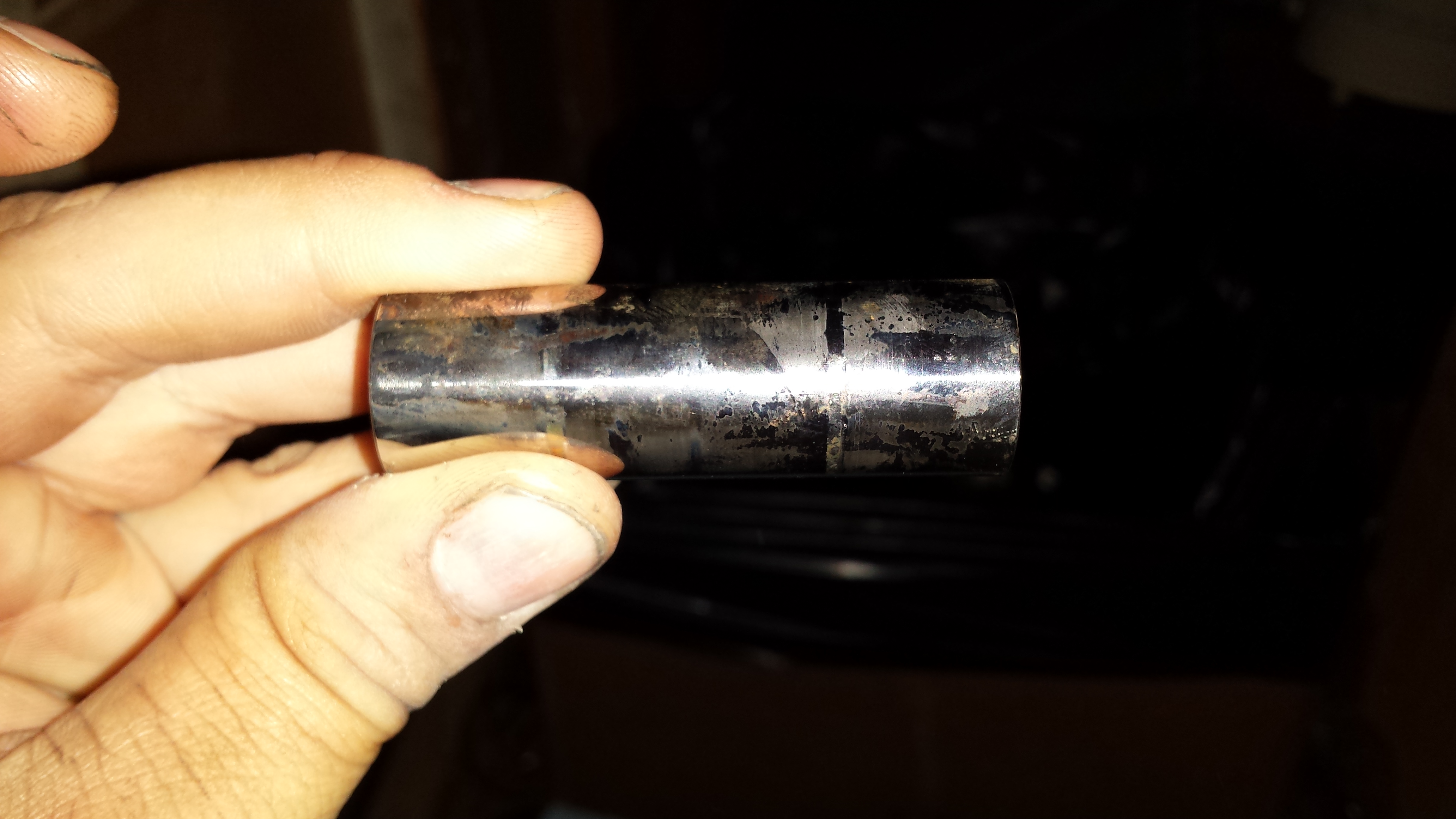

So I'm stumped about what happened to the wrist pins from the spare motor. So weird but I let them soak over night in a box lined with a huge black garbage bag with a high mix of pinesol and water. It appears that the dye from the garbage bag transferred to the wrist pins where the we're laying on it or something. When I run my nail of the stains they seem to have more drag on my nail than the polished areas. Wtf am I supposed to do with these to salvage them? TIA
Above is after sitting in paint thinner all day :idunno:
Posted: Sun Sep 04, 2016 1:55 pm
by 88a5tq
I test fit the pin into a rod with no problems at all. No resistance. Seems to spin quite well in there :)
Run em?
Posted: Sun Sep 04, 2016 2:06 pm
I would definitely not run them unless you don't mind the possibility of having the engine out again.
Posted: Sun Sep 04, 2016 2:14 pm
by 88a5tq
They looked perfect before I put them in the pinesol except for the oil lines left. I will try to clean the crap off before I go looking for new pistons. I don't think those pins are sold separately

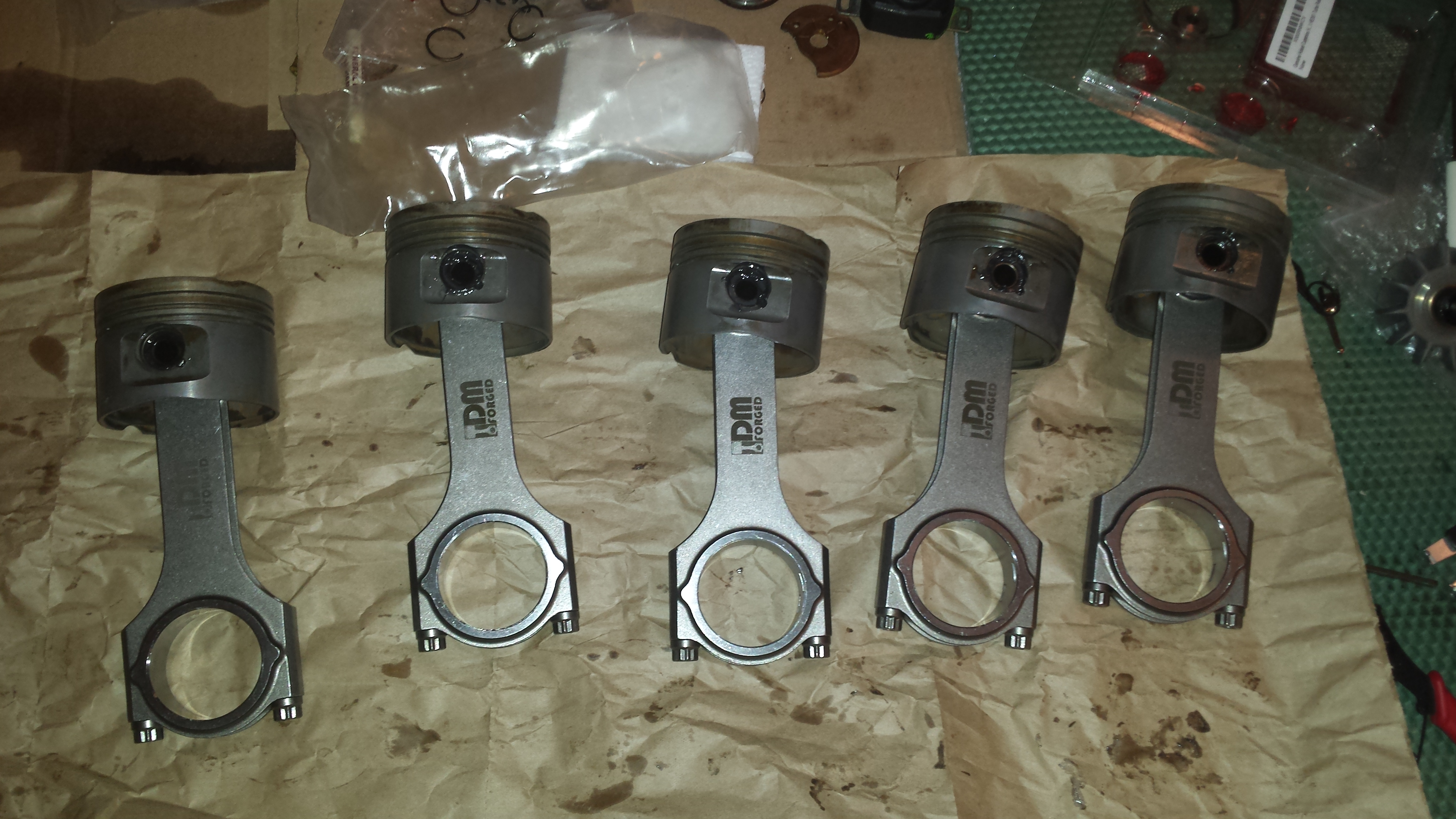

I recovered my blown motor's nice wrist pins. Thank god they survived unscathed! Once I got that motor torn down I found ALL 5 cylinders had broken oil control rings. They were broken in a very uniform fashion that had the bottom portion fully intact but the top of the ring was broken in an eerie manner that looks like equal lengths intact and equal lengths broken away, one after the other. Very weird to see while tearing away at things lol.
These will go in soon but first getting re-ringed at the shop and tolerances checked.

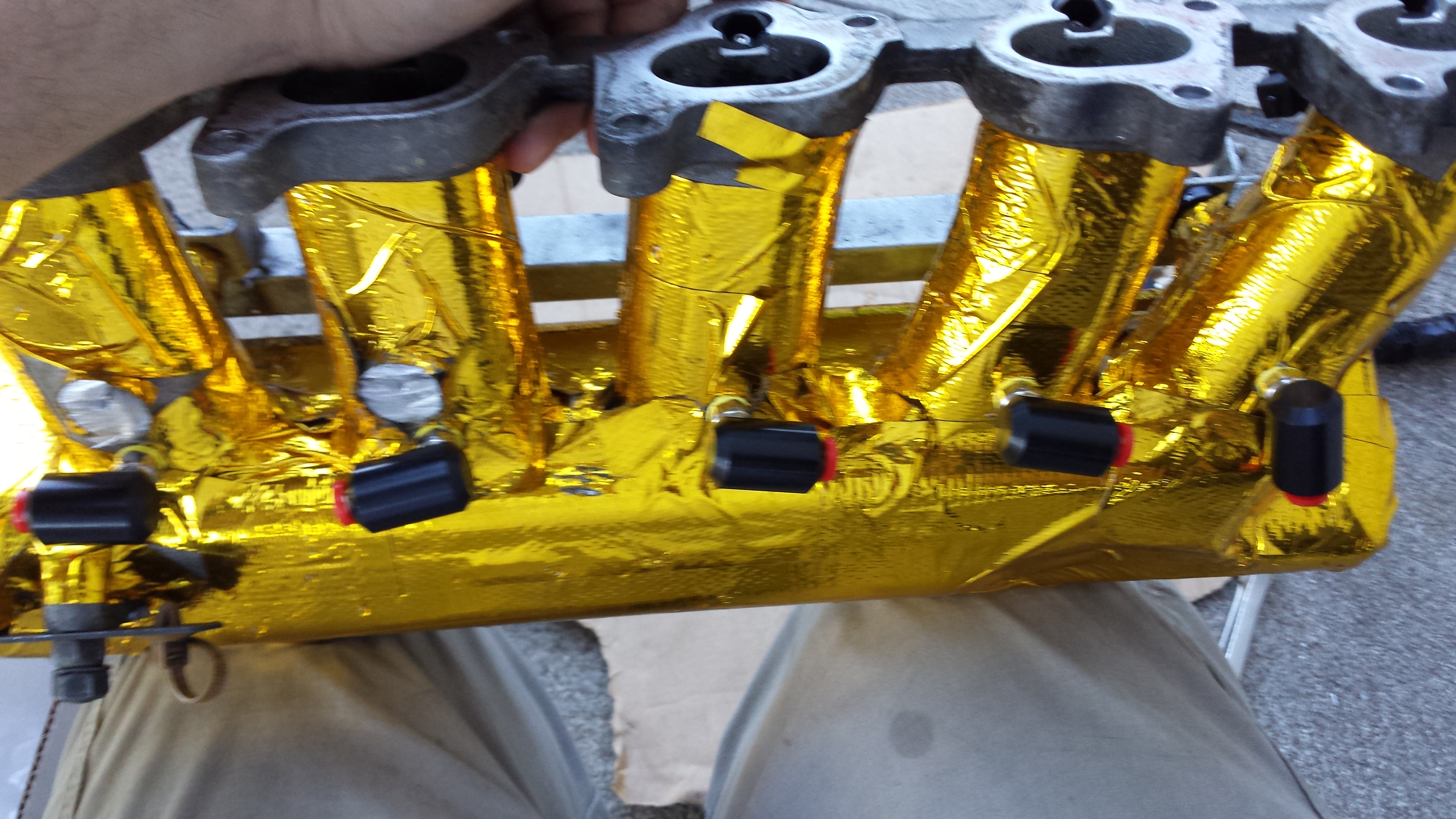

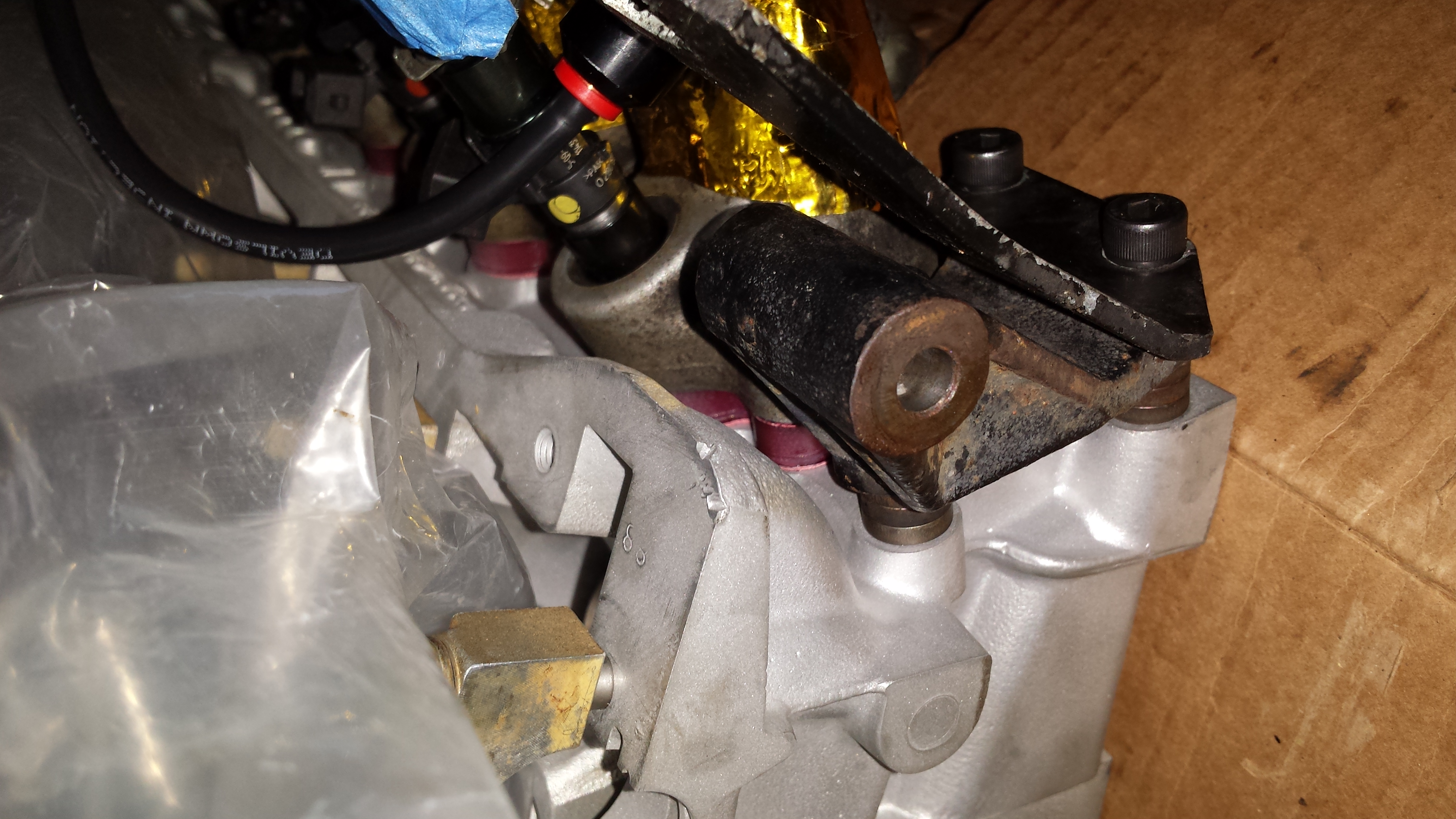

Question... neglecting the 2 inlet bolts on the oil pump feed with the locking plate (new), which bolts would you consider important to use some form of loctite on inside the sump area? I didn't use any on the 4 baffle bolts that are at 7 ft lbs. Nay?
BTW holy shit does this phenolic spacer make problems! Fitment issues arise between the manifold flange and the water manifold as well as not being able to fit the p/s pump without spacers on its bracket. I used old exhaust manifold washers lol
Posted: Mon Oct 10, 2016 4:05 pm
by 88a5tq
Thanks DE80Q for hitting me up with an answer! I will not be using any loctite unless specified by Mr Bentley.
