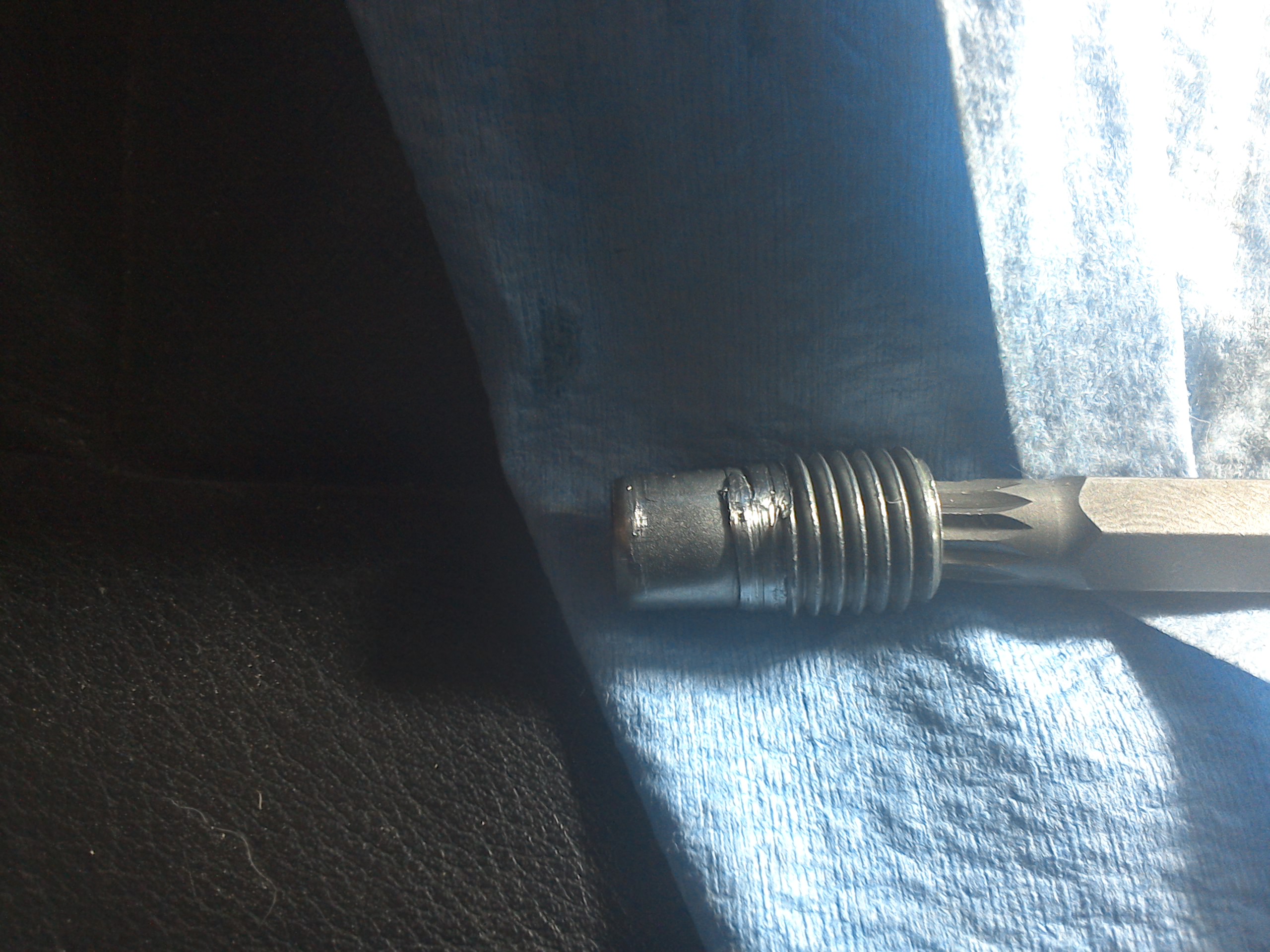

Posted: Sun Oct 30, 2016 9:30 pm
by 88a5tq
Update via s2forum!
Gah! I'm leaning toward faulty checkvalve possibly? This is the extent of damage to it below but when I tried to start the car with it out oil came shooting out and it didn't even actually start! That was a split second of rotation only :)
What do you guys think?
Lower threads are effed up tho?
Posted: Mon Oct 31, 2016 3:14 am
Hmm machine shop should be questioned
Posted: Mon Oct 31, 2016 6:34 am
by 88a5tq
Right on. I feel like those mash marks are unacceptable. Maybe it was bottomed out too harshly? When I install the new one should I only put it in to a certain point? I feel like torquing it might result in the same damage possibly.

Posted: Mon Oct 31, 2016 8:21 am
Kinda looks to me like they cross-threaded it. You will want to chase the threads in the block with a tap if you can.
Posted: Mon Oct 31, 2016 11:13 am
by 88a5tq
Holy shit idk if i trust myself to get everything out after
Posted: Mon Oct 31, 2016 3:34 pm
by DE80q
It's not like your tapping a fresh hole, just put some grease on the tap.
