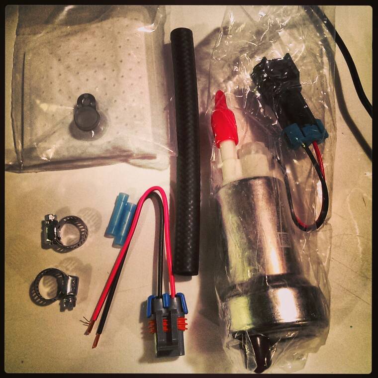

Walbro 416 E85 PUMP received...
S4Pirate
Posts: 58
Joined: Sat Mar 09, 2013 4:46 pm
Re: A tale of Rubí... Bottom End Assembly Commences w/PICS
Post by S4Pirate »
You gonna pop some kind of pickup on there? Curious to see how that works out. Looks good!

S4Pirate wrote:You gonna pop some kind of pickup on there? Curious to see how that works out. Looks good!
Wouldn't that cloth like pickup suffice?
Funny, didn't even notice that in the pic. That looks a little different than the material I've used (not worse/better...just different). I've used pickups in jeep fuel cells and they all are usually more of a nylon mesh. Now we just need to get you some e85 to go with that pump :D
