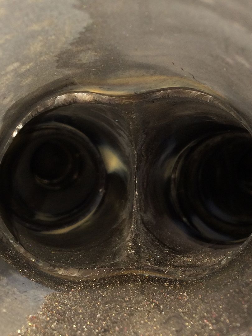

Here's more, it's a 2 1/4 from the down pipes merging into a 3" vband which will reduce to 2 1/2" for a resonator and muffler.

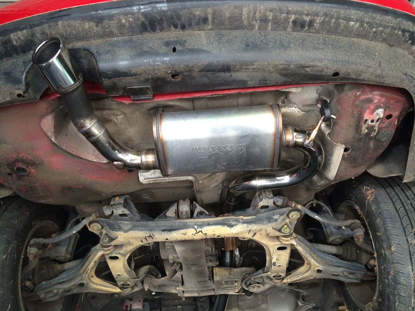

Anyway, I also realize I never showed any final pics of the exhaust...
you've seen the front part - here's the back:

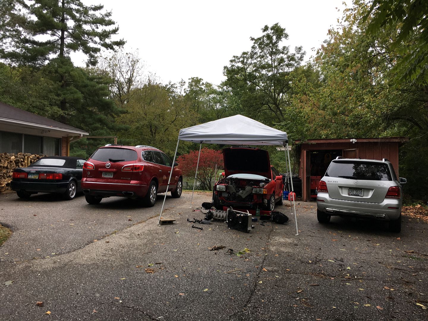

And I need a damn garage!

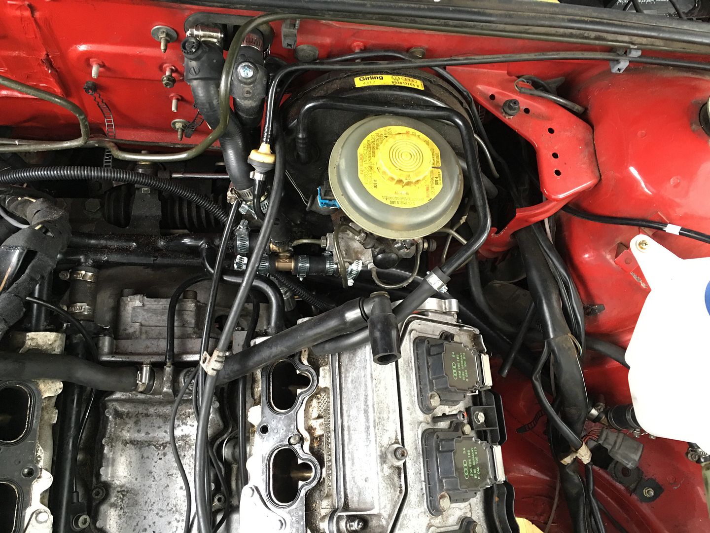

Also, I tackled the heater core and overflow bottle plumbing today. The ABH has the coolant bottle on the PS while the ABZ has it on the Drivers side - like the B4 V6 bottle I am using. So I had the ABH installed originally (pictured below and bottom) but hoped to use the ABZ (pictured below at the top). However, to swap these you need both this piece and the water pipe that sits above the valley pan - which I don't have.
I ended up blocking off the long run on the passengers side and installing a T on the other side to hit the bottle.
I used 2 V6 bleeder hoses for the Heater Core. I bought one from the junkyard the other day and when I got home I had two already.
