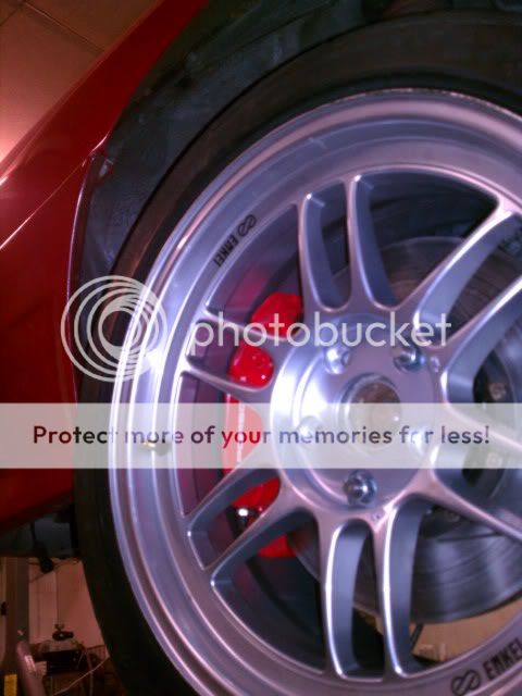

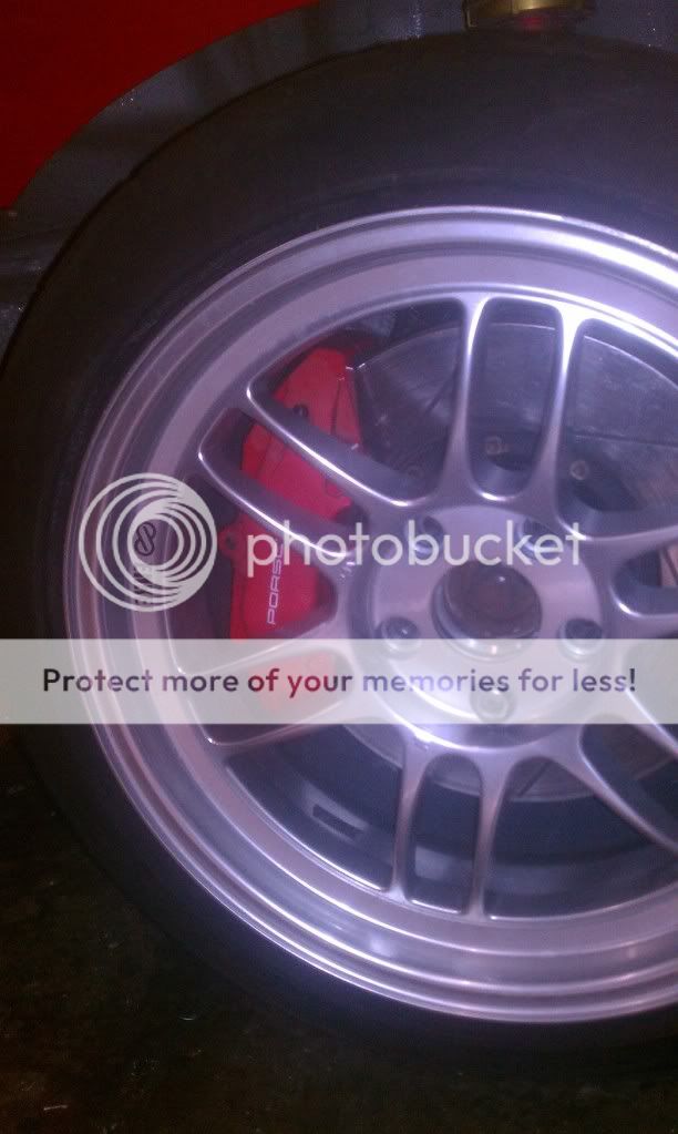

I also did some brake work. At Miller two weekends ago, my poor TT brake setup was just not up to the task of hauling down the car from 130 on multiple straits lap after lap. Even with Hawk blues, it still struggled to keep a stiff pedal. I got ahold of a couple of calipers and swooped on some really nice Racing Brake 2 piece fully floating 320x30mm rotors with b5 s4 offset. I could pass them up. I wish they had about 6mm more offset, but I will probably make some new hats to put them inboard. You see, I got some 996 tt calipers on ebay that were in great shape and came with some nice track pads. The problem is that they are HUGE!!! I wanted them because they are stock with 32mm wide rotors so running 1.25" aftermarket rings would be cheaper than the oddball 28mm size. The problem is that they are having a hard time clearing hte enkeis. I am pretty darn attached to them. I made brackets for them, but they just are not going to work with the current 35mm offset of the 17x9 rpf1. I may try a different offset rpf1 to see if I can push the spokes out and then run spacers to clear the brakes. It is too bad because the car look menacing with them on. The thing that pisses me off is that the Fat Fives clear just fine.. I probably only need regular 996 stuff anyways. The car is light, and I am not a good enough driver to really overwork them. So I switch plans and used some Cayman S calipers which have the same part number as the 996 stuff. They look great, match the paint and will probably haul the car down just fine.

Wow that looks sick! We need a full body shot with the calipers.

Very nice Hank!! Makes me wonder why I'm even messing around with a log manifold. :o I know, I know that it is to keep the power levels down below tranny grenading levels, but a tube manifold just looks so nice. I am way stoked about the brakes. Nice score.

look who is ballin' with their brand new 996 calipers ;)

Lookin great Hank!!! I am diggin the brake set up!

nice calipers! :curses: :curses: :curses: :barf:
:P :wink: ...don't I currently own those?
No really, nice calipers. And nice work on that new setup. Can't wait to see this in a nicely sorted and painted bay.

Can I renig on a renig? I want to try the 996tt calipers one more time with a custom hat I am going to machine mid week. I think I can move the rotor in 6mm, which will negate the difference in caliper width between the 996 and 996tt caliper. If this is the case, you probably can end up with these calipers and the brackets as interest :)

Hank, i picked up a pair of 993 non-turbo 4 piston calipers (for no real reason) if you think they will work for you.... one size under the 996/993TT. with rotors, too. (the Porsche rotors)
