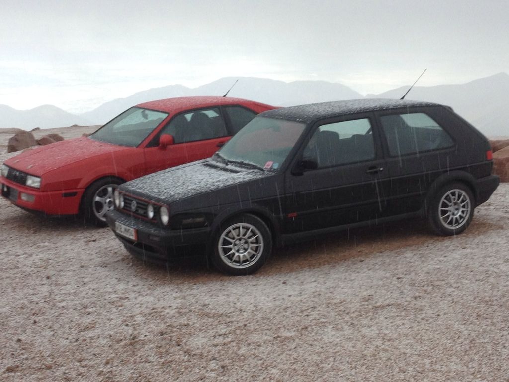

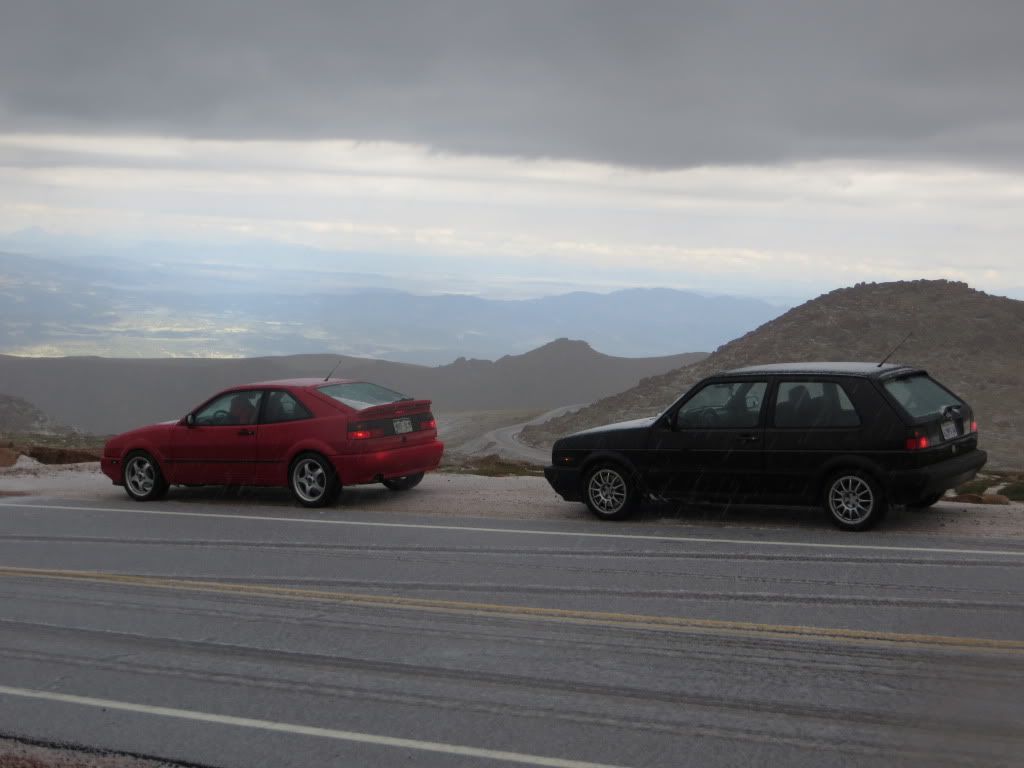

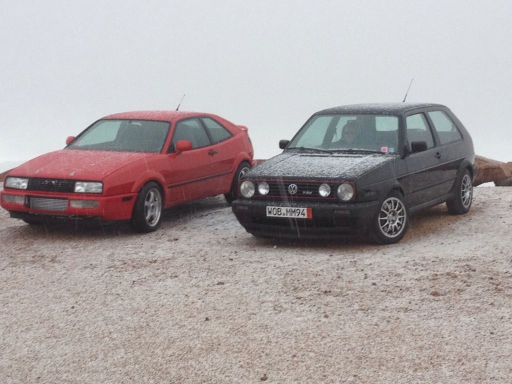

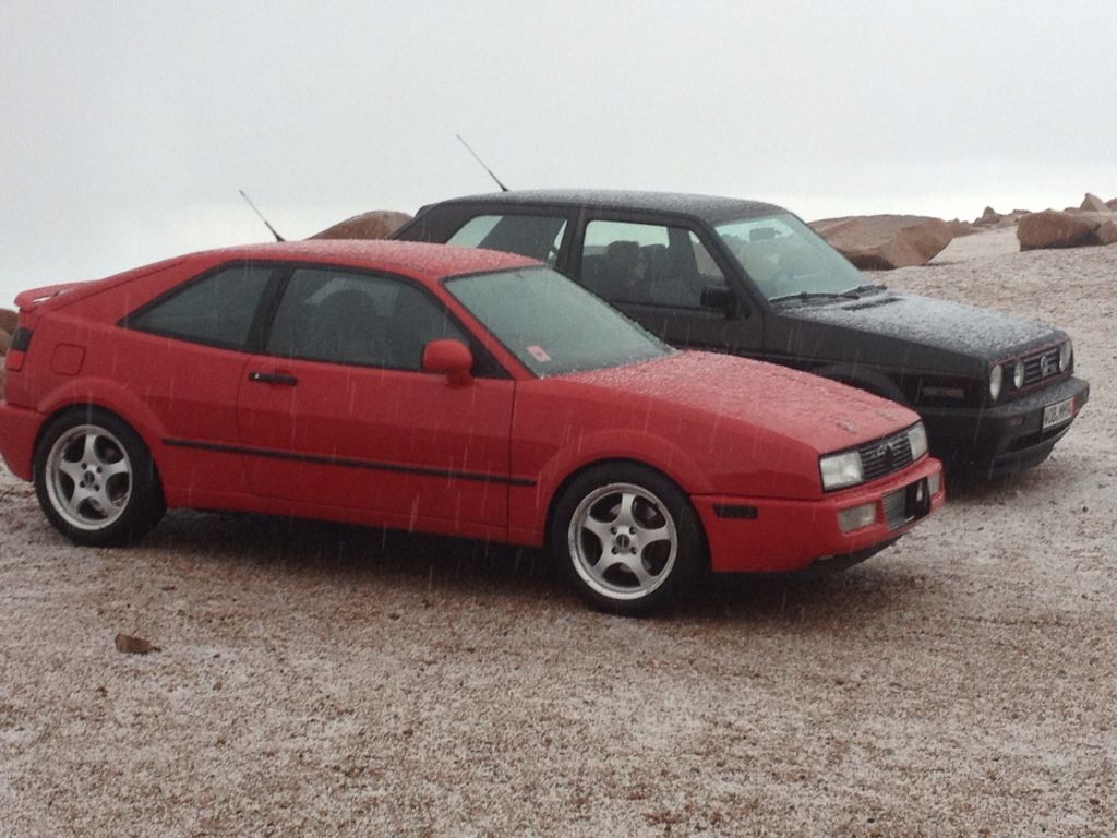

First the only pictures i took from Pikes Peak:

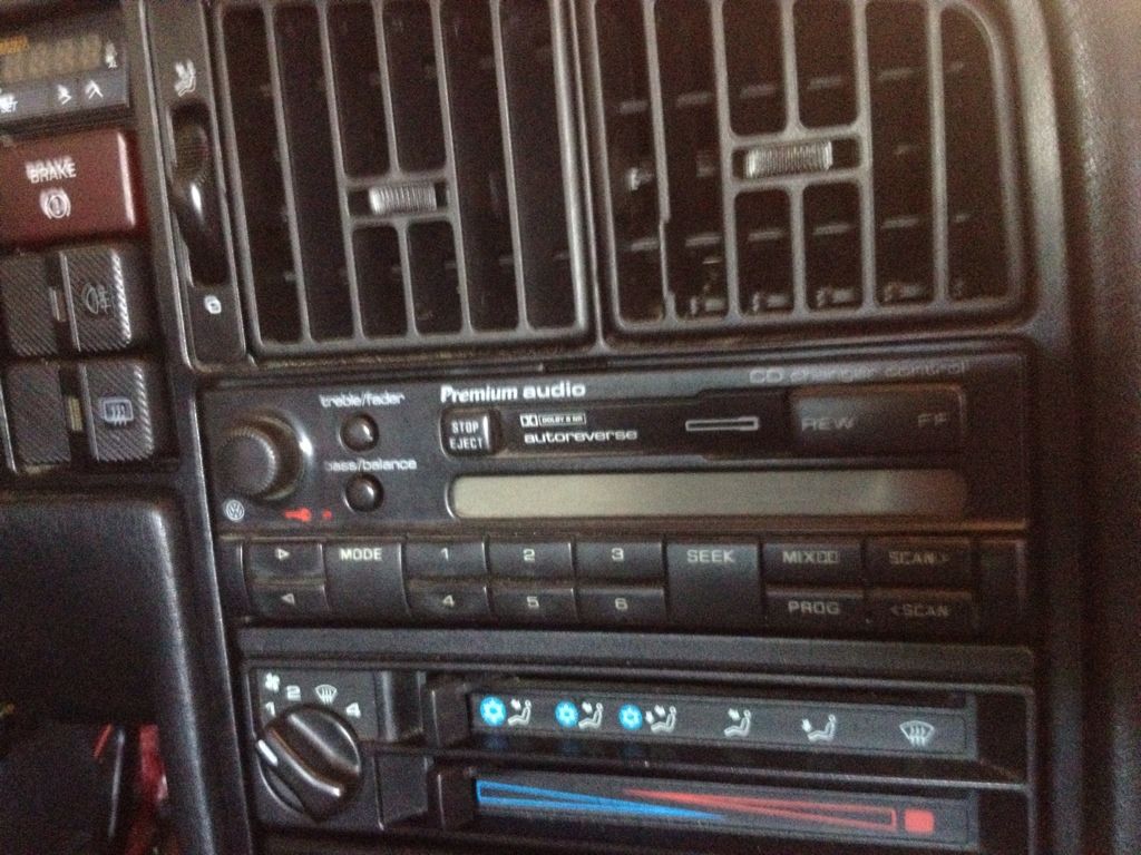

Moving forward to this past week......Got the exhaust gasket(s) replaced. Reset my EGT probe depth (too shallow). Cleaned up the turbo/adapter mating surfaces (it was leaking there). Of course keep in mind this requires unbolting the engine and rotating forward to get the exhaust mani of the studs...so intake mani has to come off, turbo unbolt from adapter, unbolt engine from mounts and rotate engine forward, then barely, and just barely, squeeze the EM off the studs. In the big scheme of things (other motors) its not bad, but on an engine and platform i find mostly VERY easy to work on, EM gaskets aren't. Also, went with an 20vt MC1 intake gasket that matches ports better on my IM. I had to trim, and slot bolt holes but it's much better than the old one.
New passat radio added too.

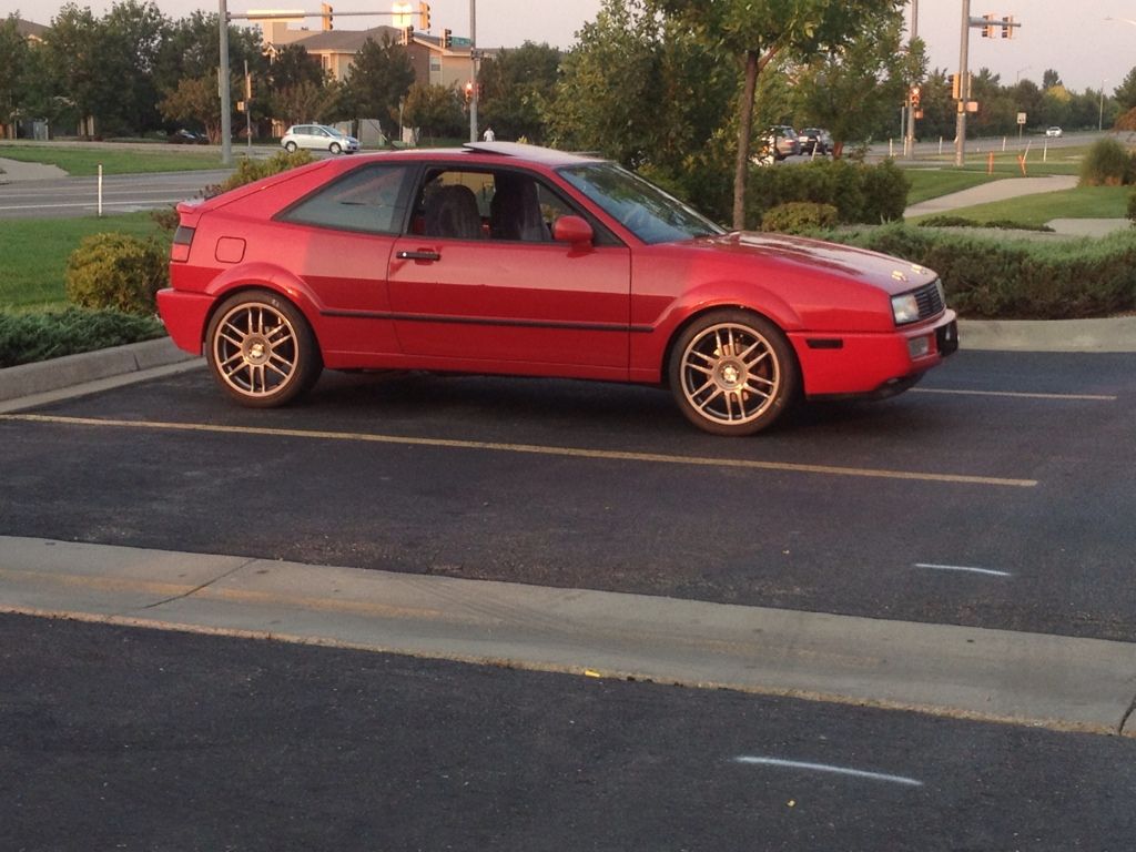

Replaced shot strut tower bearings. Adjusted ride hight for the higher rolling diameter (see poor mans R&P) of the new summer shoes:

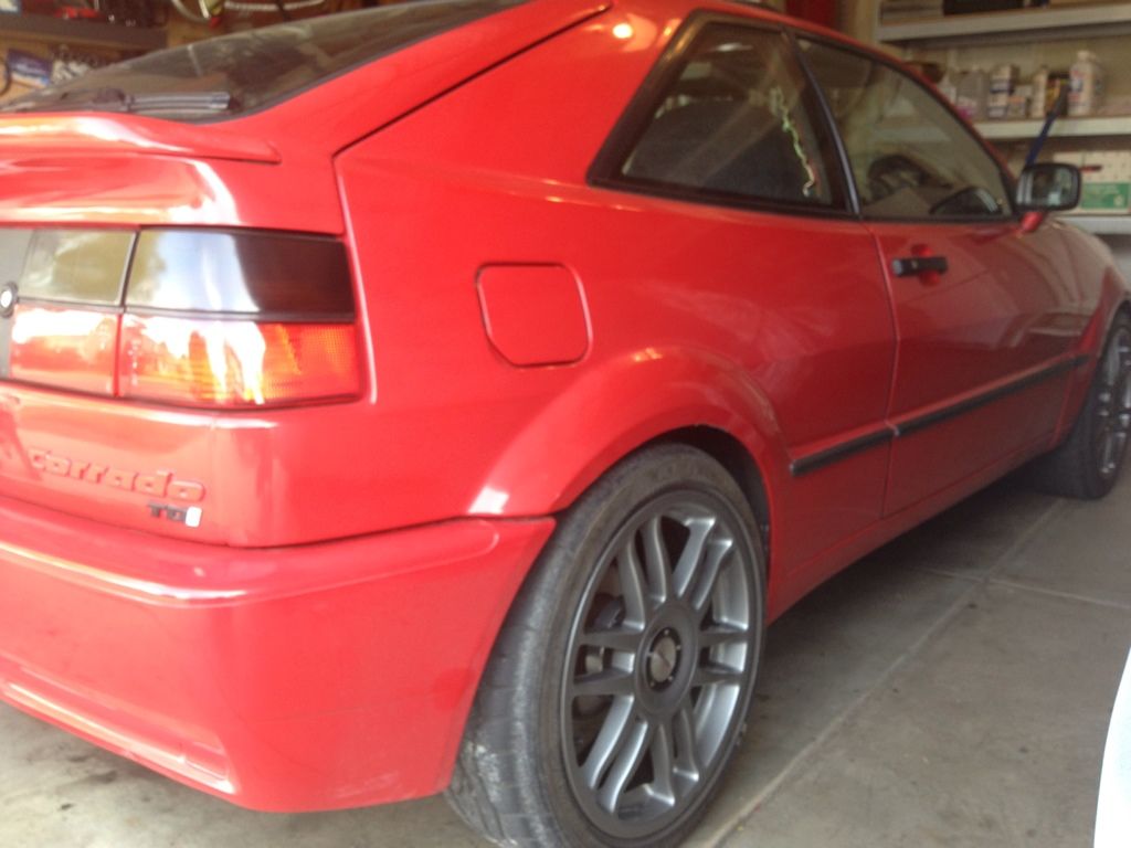

Replaced the failing battery which caused my no start issue. Cranks much better now. Last night a Jeep Grand Cherokee SRT8 played games at a stop light and accidentally got into it in second and third. Both gears i had to back off to keep wheel spin. Really need LSD. Also, full throttle yielding no smoke. :cool:

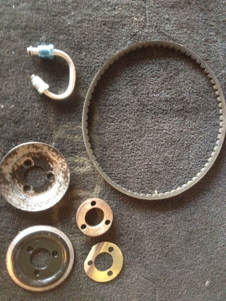

Project fuel economy improvement. Also have a 195 thermostat to install.

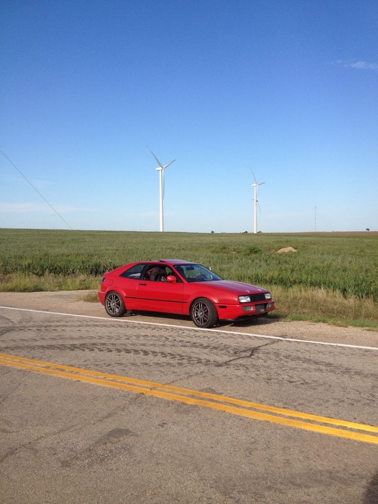

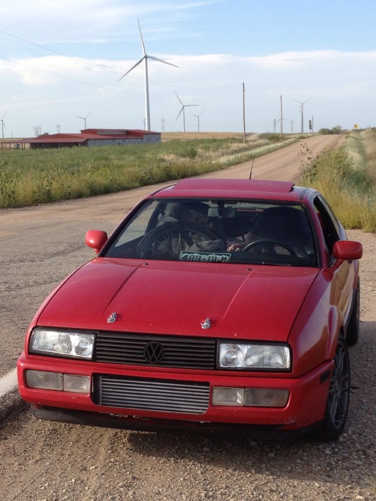

From road trip to Ozarks this week:
Best tank over the trip 58mpg, averaged 55mpg for the trip. VR6/G60 clutch slips in 3/4/5 when getting anywhere near 19lbs of boost...... So guess i need more clutch.
New front strut tower mounts are already sloppy. (boo) Guess i need some Ground Control units.
Let's see....GC strut mounts, more clutch, LSD, taller 5th gear......i NEED to win the lottery.

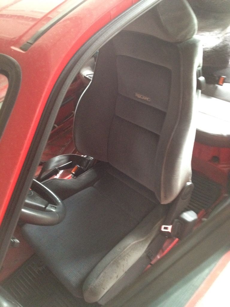

New old seats.
