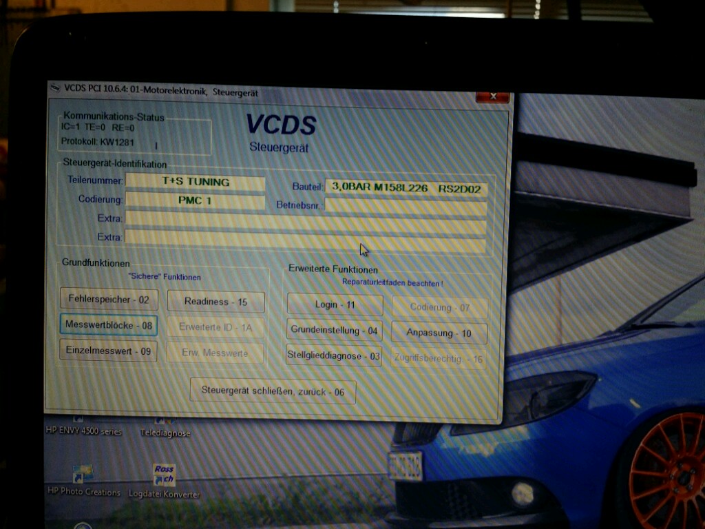

Okay. Mhm i used VAG COM / VCDS.
Have a look:
vwnut8392
Posts: 340
Location: PA
Re: Motronic 2.3.2 ignition cut launch control
Post by vwnut8392 »
KevinRS wrote:Okay. Mhm i used VAG COM / VCDS.
Have a look:
The attachment IMG_20150628_164401-1024x768.jpg is no longer available

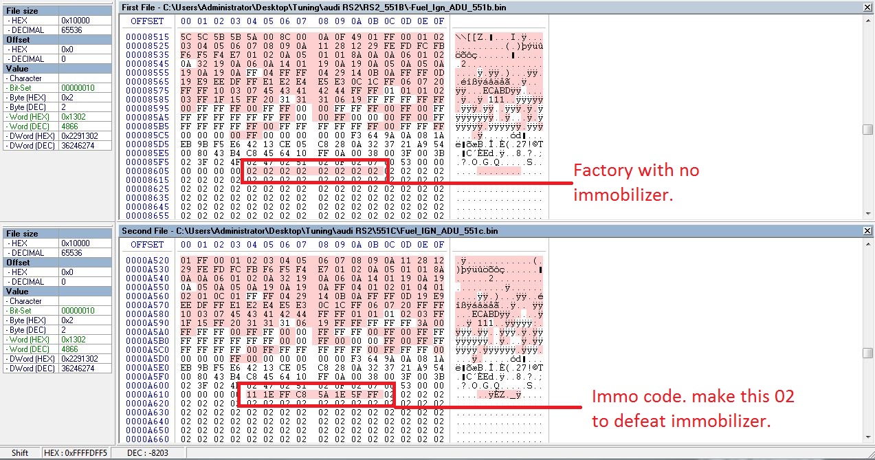

They changed the info string that had the software part # in it. well the only other way to tell if its 551B or 551C is if it has the string of code for the immobilizer in it. the 551C will have immo code and the 551B wont have it.
picture of the immo code. 551B top and 551C bottom.
offset rs2.JPG (383.24 KiB) Viewed 80658 times

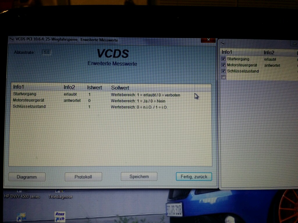

Okay thanks a lot. My chip reader is on the way. I got an ECU for immobilizer. He's a photo:
With connected engine ecu starting would be allowed. But with disconnected engine ecu starting would also be allowed.
So i think the engine ecu doesnt play a role for starting, only the car-keys. In that case i could use every fitting ECU without breaking-in the ecu to the immo.
But maybe its different because ist not the original ECU and immo was disabled/not used in this ECU.
Have to wait for the chip programmer to know for sure.

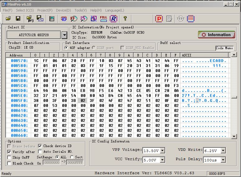

So, programmer has been delivered today. Now i have read the chip.
Here is an image of Offset 00008605, i dont know what to say about the immo. Offset 0000A610 is empty.
S2 01.JPG (159.9 KiB) Viewed 80641 times
So i opend the bin file with winOLS. It found a lot of 16x16maps, but none of them begins at any Offset you have written in Post 2.
WinOLS detected AUDI S2 ECU. Dont know if its correct.

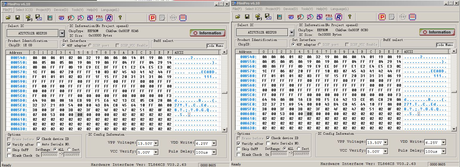

I downloaded your RS2 File 551B and compared it with mine, seems to be the much same:
Right is my BIN and left is your RS2
S2 02.JPG (304.4 KiB) Viewed 80640 times
S2 03.JPG (304.41 KiB) Viewed 80640 times
Please read the BIN with TunerPro. Ignition seems to be the same as OEM RS2. isnt it?

its an RS2 551B file. there's some pretty decent changes in that BIN. they dont edit all ignition maps, just the main map.

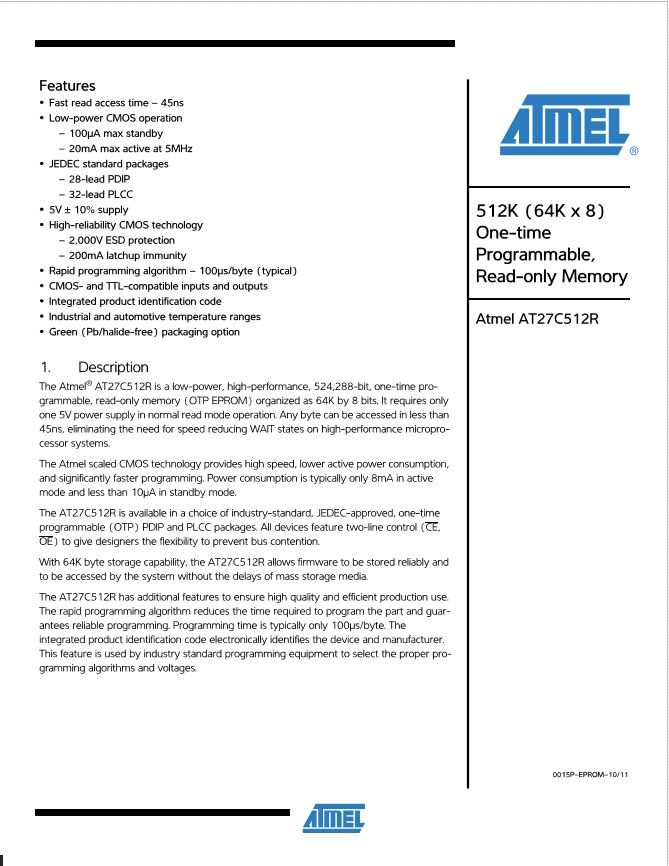

Why do think these Chip (ATMEGA8L-8PU) isnt suitable?
What? Really? The Atmel 27C512R ist e-erasable? I just searched for the Datasheet of the Atmel 27C512R and there is written the chip is only one time programmable.
S2 04.JPG (99.14 KiB) Viewed 80585 times
vwnut8392
Posts: 340
Location: PA
Post by vwnut8392 »
thats what i originally thought. the SST27SF512 is your only hope or to find more one time programmable chips.

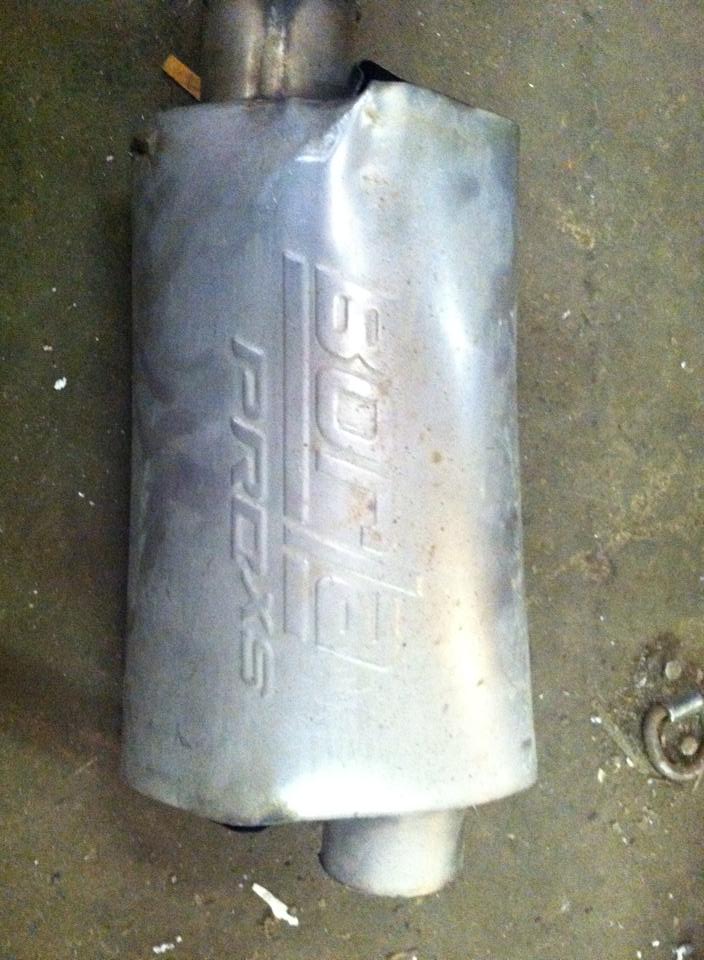

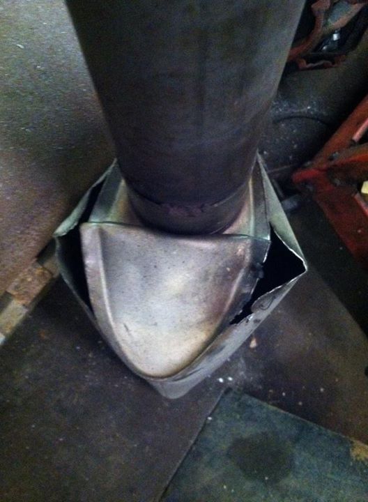

Be careful with it because it could do this to your muffler. this abused muffler is barely a year old :lol:. good job though kevin! now lets see a video of the car launching on it!

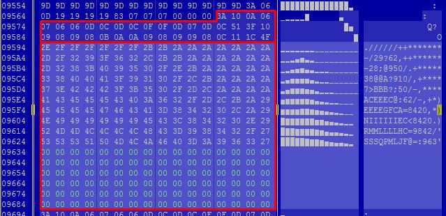

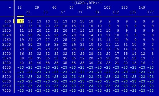

At the moment, I'm doing this mod (Launch Control with ECU Switch) to a friend's 551AA ECU too.
What I understand now is that the car will not throw flames or bang, as long as there is no wotbox installed (which I will not do).
Just for curiousity:
-Why isn't it enough to fit the wotbox without the ECU mod, why wotbox AND ECU mod?
This combination doesn't make sense to me.
-Will the car generate boost at 4500rpm with the ECU mod and without wotbox?
The car has OE turbocharger, 3" exhaust with 100cell motorsports metal catalytic converter - hopefully this will hold :-)
@KevinRS thanks for your detailed resistor info, ECU is OK :-)
martin6
Posts: 6
Joined: Mon Jul 06, 2015 1:13 am
Location: Austria / Europe
Post by martin6 »
Tested today, but no luck.
I did the change in the map at 0x9594 (ECU is a 8A0 907 551AA with 8A0 907 551B software).
When giving ground to the mentioned pin on the coding plug (or ECU pin 39, double-checked that),
the car obviously does not switch to the launch control map, and revs freely to ~7000.
The software is not OE RS2 btw, it's a modified chip, checksum is OK too (I let WinOLS do the job)
Any ideas, what the reason for this could be?

Okay. No it will not generate boost without wotbox. Maybe with a really hot manifold. Important is the late ignition.
Okay, did you copied your driving map to this map (beginning at offset 9594) and then corrected the ignition timing at certain RPM?

Yes, my map looks like this:
As you can see, my map starts at 9594, and is zeroed from 9634 to 9693.
Here the same map, with rpm factor:
Can you confirm that 551B "launch control map" is the 9594?
Maybe this is the wrong map and therefore it doesn't get active with Pin 39 to ground?
