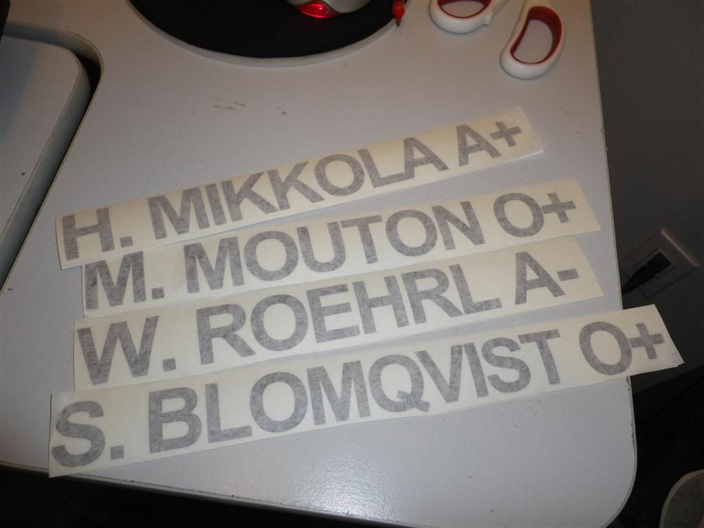

In my attempts to draw attention away from less than stellar paint, I like to play with decals.
Some of them are a bit small due to the limitations of my cutter (6.2” max. width), but I’m not trying to make a painstaking replica. Besides, if you really look at the factory decals on these cars over the years, the styles and sizes are really quite variable. You can target individual cars, but the similarity pretty much stops there.
Some of the artwork I had from a vector art collection I had purchased many years ago for another project, and some I re-created by tracing over bitmap examples pulled from the Web.

Not to nitpick, but weren't Mouton and Mikkola both drivers? I didn't think that either one was a co-driver.
Re: An American URQ in Utah - The Beginning
Frank the quattro tank wrote:[/quote]Not to nitpick, but weren't Mouton and Mikkola both drivers? I didn't think that either one was a co-driver.[/quote]
Not sure where I said either was a co-driver, but yes, both drivers. I have made artwork for most of the more popular/successful drivers/co-drivers, but only cut a few sets for samples. That is what you are looking at.
So, before someone helps me spell W. ROERHL correctly...that is the correct spelling on the early cars before they used the O with the umlaut.
