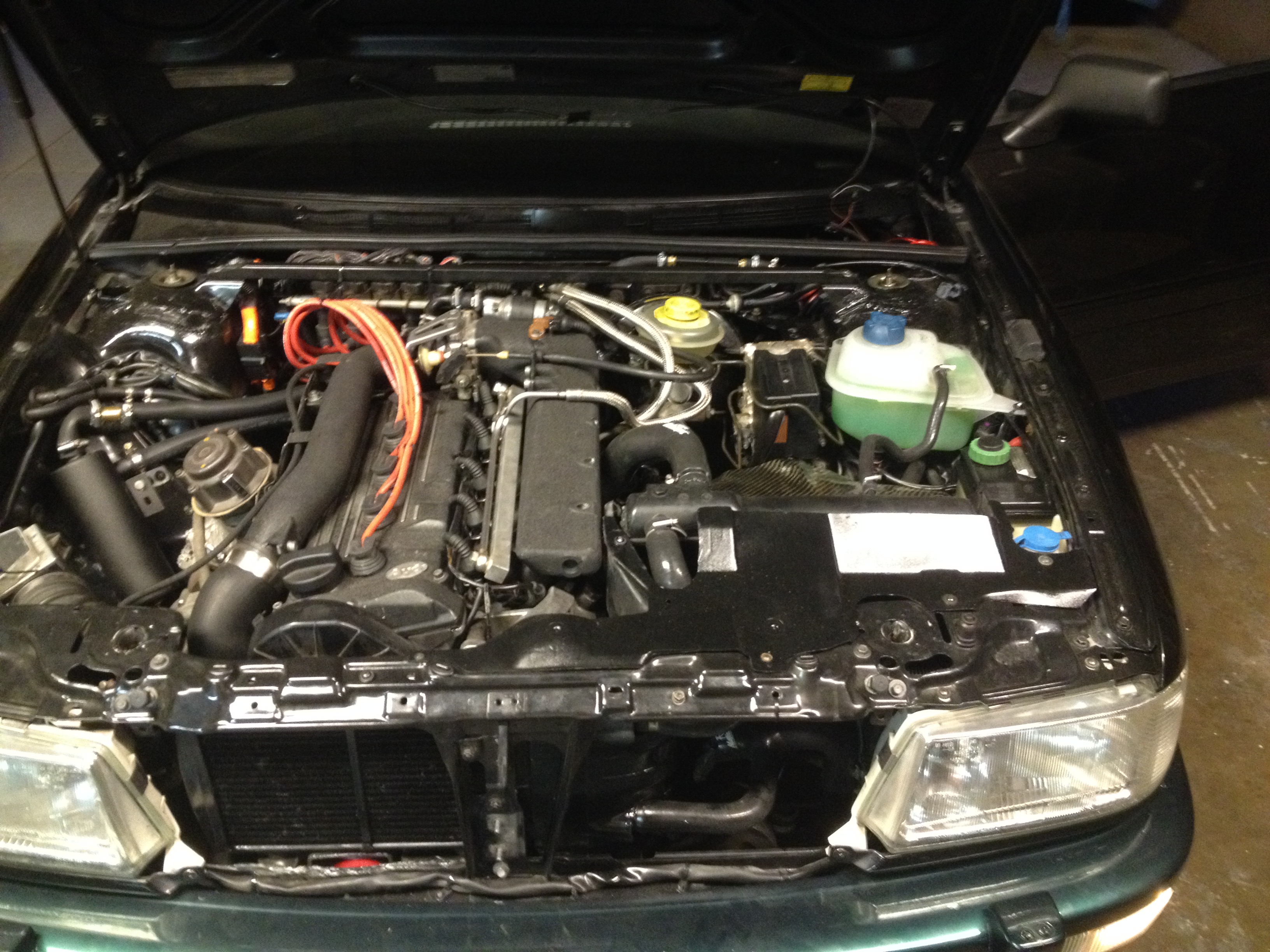

I couldnt get the car ready for BBQ5 however we made it there, and it was super!
Car is running.Electrical problems (gauges, rogue connectors, etc) are fixed, Finally I have illumination, changed almost all the bulbs...
It has 3" exhaust all the way, a highflow cat and a magnaflow rear muffler. It has a nice tone i think, exactly what i wanted, not too deep, or laud
Fixed the vacuum issues too (didnt have enough), I had to tap in 1/4 NPT fitting to the intake manifold and run a hose to the vacuum distributor

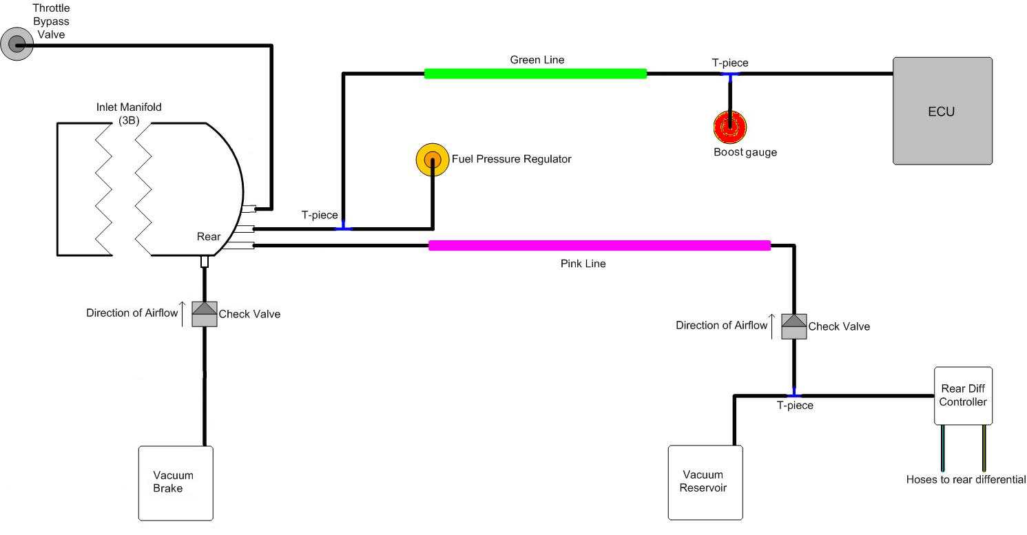

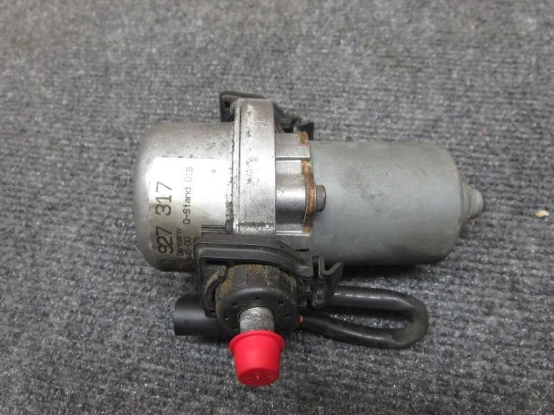

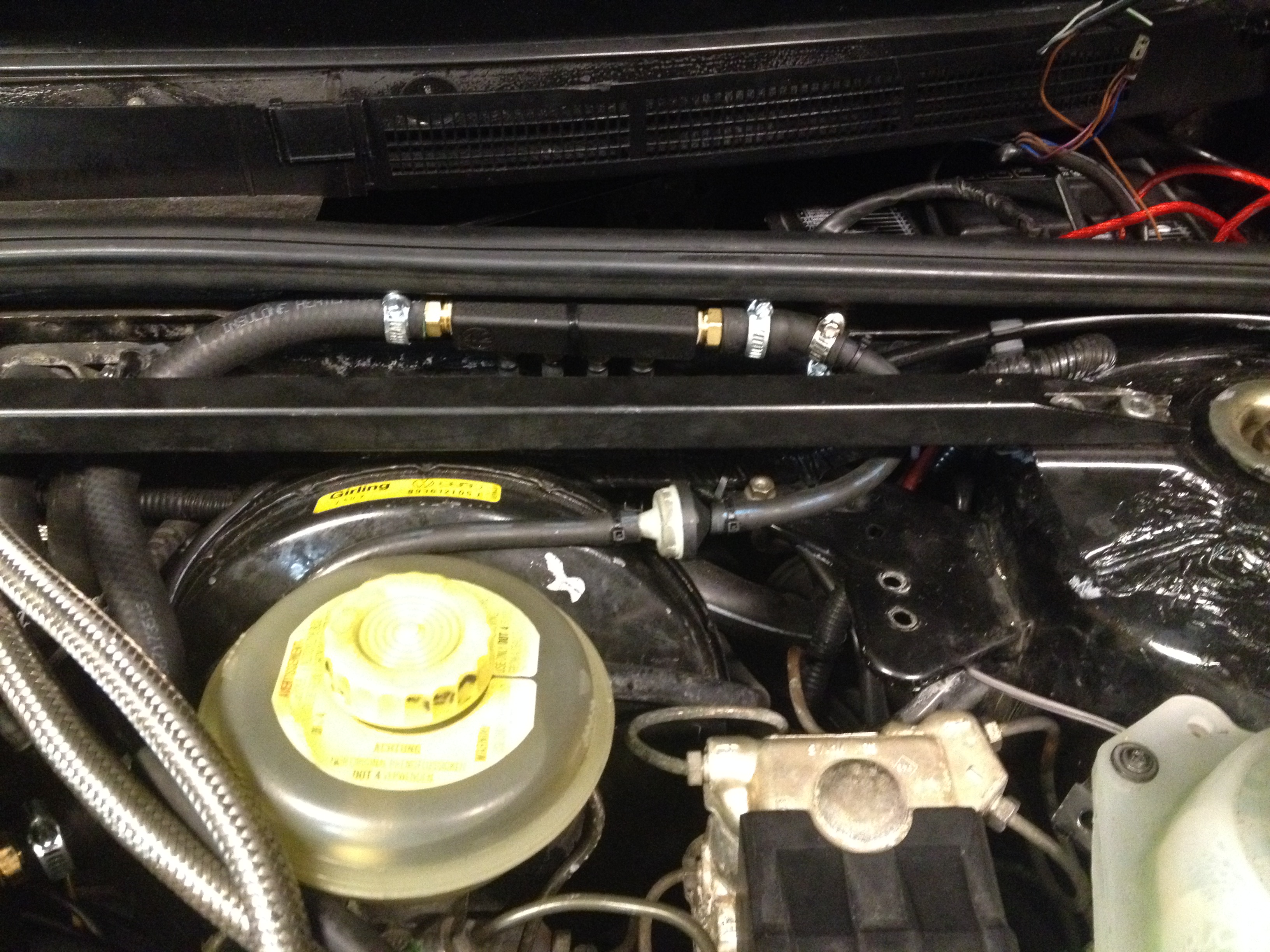

varia
Posts: 354
Location: Los Angeles

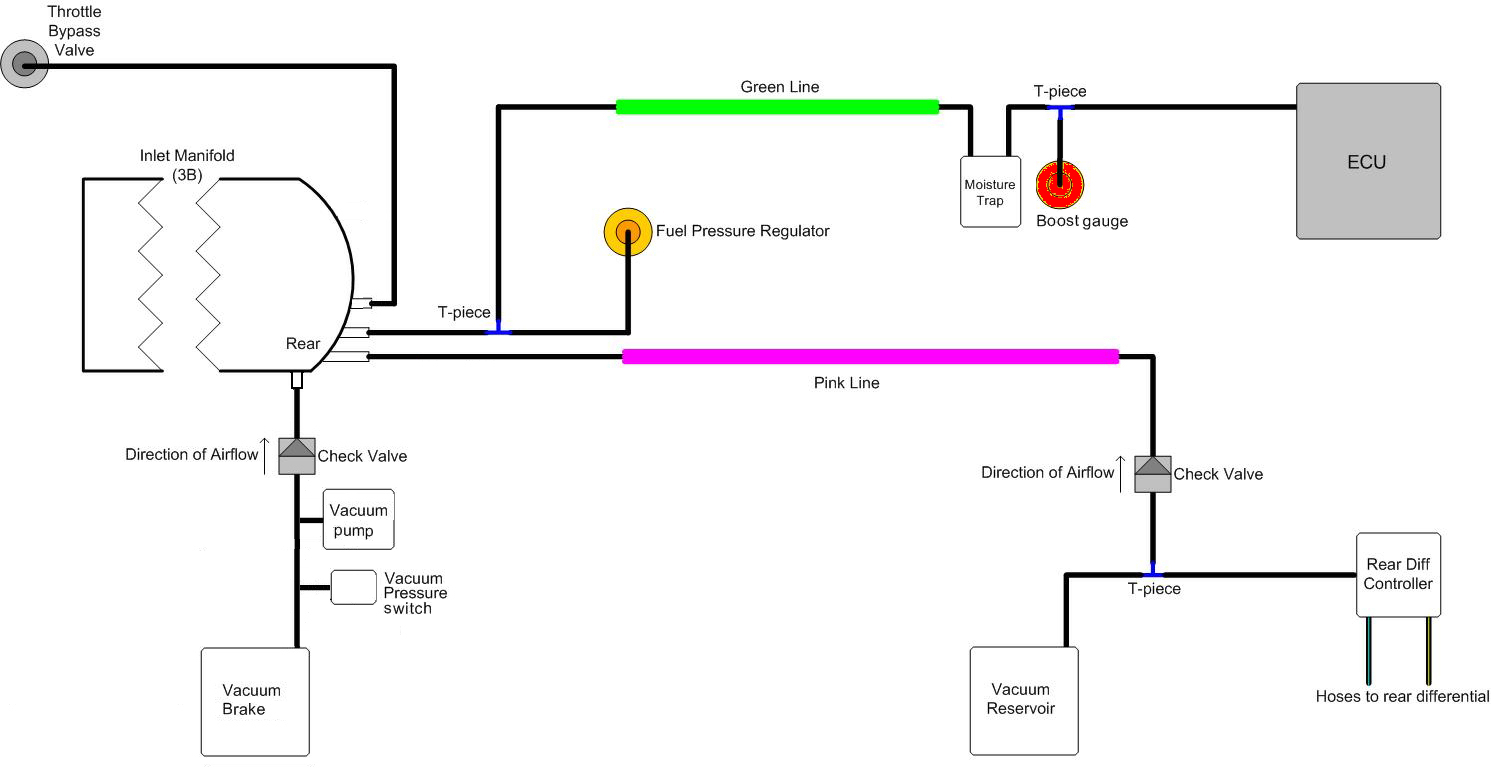

vacuum
Post by varia »
ive got rid off the power ass. brake (bomb) system on my cq. Now I have vacuum booster from a B3 80/90
I re-done my vacuum lines like 3 times, because i think i dont have enough vacuum.
This is my current sutup:
I will modify it, installing a vacuum pump from an later a4, with a pressure switch (first i though i will trigger it via the brake light switch)
8E0927317 2001 a4 vacuum pump.JPG (83.92 KiB) Viewed 43053 times
My question is:
What you guys think about my vacuum booster, is it normal that it makes this darth vader noise when i press the brake pedal?
I can see major vacuum pressure drops on the boost gauge.
https://www.youtube.com/watch?v=ZQSkxwKaADw

scubagli
Posts: 604
Location: leeds ny
Re: another S2 conversion
Post by scubagli »
Sounds like the booster is bad.
varia
Posts: 354
Post by varia »
scubagli wrote:Sounds like the booster is bad.
what a bummer... thats what i though.
anyway, i ordered an used one, to see whats up
Thx

ralleyquattro
Posts: 858
Post by ralleyquattro »
I use that vacuum pump on my TDI and its been working great for last 3 years... I used a VOLVO vacuum switch, much better than some of the aftermarket crap.
Unless you get a large vacuum accumulator you will hear that pump on each time you press the brake pedal.
HTH

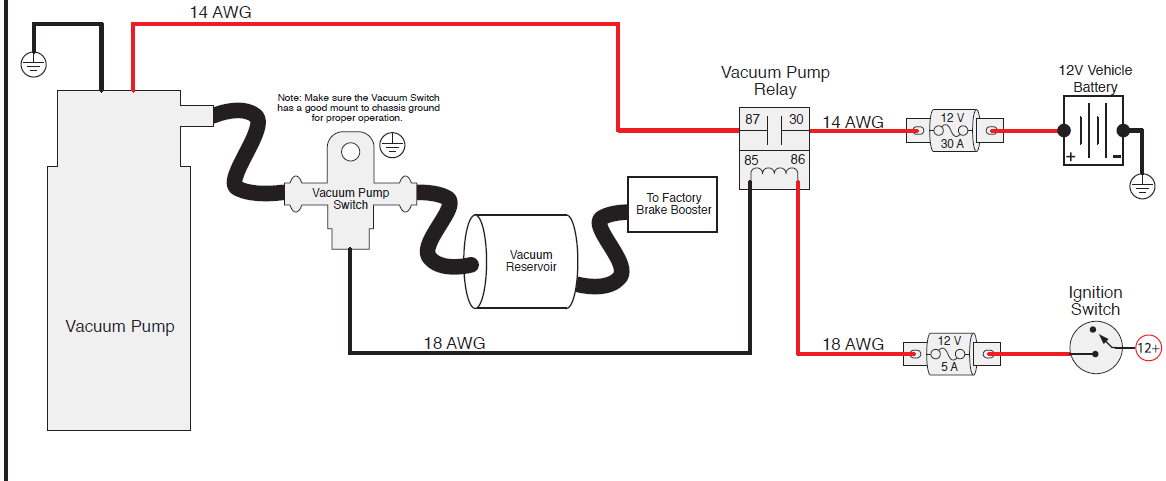

ralleyquattro
Posts: 858
Vacuum switch is just that.. a switch side (low amps) for the relay.
The power side goes via the relay to the pump.
Remember a 40A fuse in line before the relay.
HTH

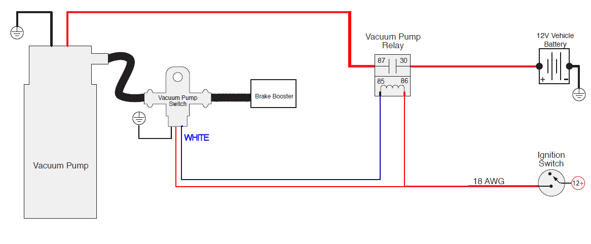

varia
Posts: 354
Post by varia »
ralleyquattro wrote:Vacuum switch is just that.. a switch side (low amps) for the relay.
HTH
got it. I just wanted to know because my vacuum switch has 3 legs, and adjustable
but i just ordered this volvo switch (its much simpler then mine was) , so i will wire it like this
Thank you again!
¯\_(ツ)_/¯
project 2226

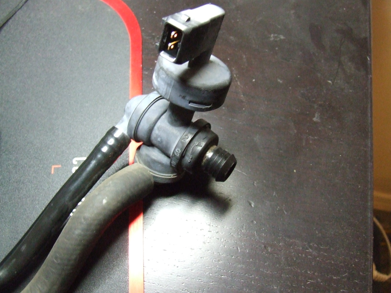

just found this:
2 build in check valve, 1 end goes into the booster, 1 hose goes to the pump, 1 hose goes to the IM
very simple, i like it
