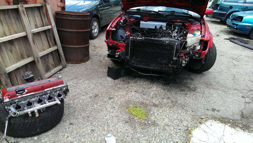

Original engine is coming out by hand, on the floor, bits and pieces being cleaned up and placed on the built motor on the stand. Seeing as I don't have all the hardware in yet to mount the turbo, I'll be pulling the head off this to inspect it's failure. So this motor should be out by tomorrow... I can then degrease and tidy the bay up for the built motor. If I get antsy, I might just throw the old t04e back on & break it in on the dyno, seeing as "recent" t04e numbers have sort of been requested for comparison sake and mainly just for my own...
I doubt that will happen as I wanna take advantage of an empty bay to figure out/route my meth kit & my oil cooler kit. Oh and that reminds me, have you been able to get a quick pic of that passenger side motor mount? I can possibly use those Mustang Motor mounts too, if I get my Summit order...
I have plenty to do though like that shiny new fuel pump that's just sittin there, though I'd like to leave that for after the motor runs. I wouldn't wanna introduce too many variables if a non start condition arises...

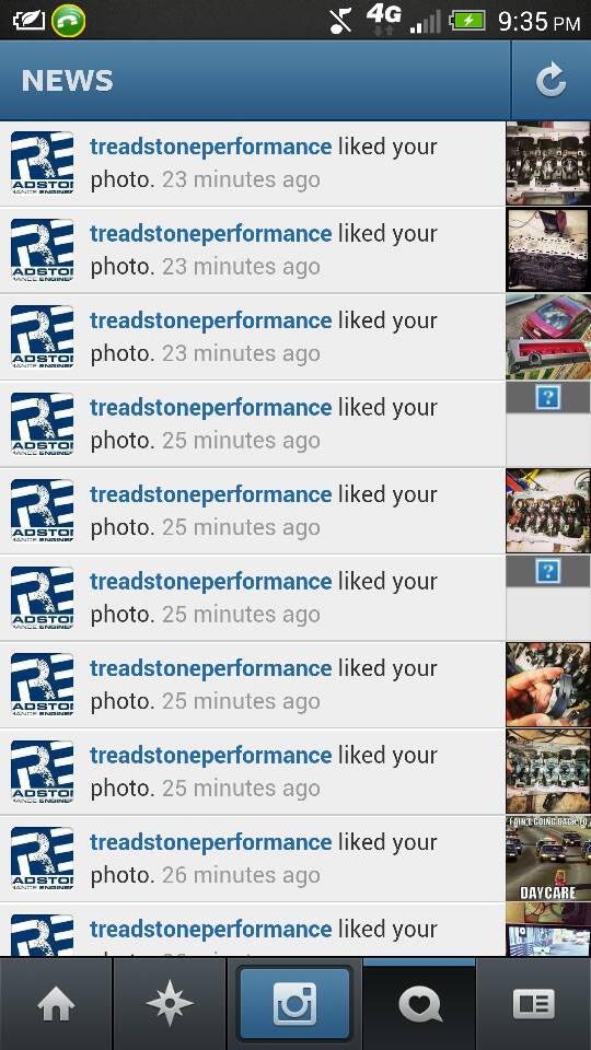

Someone at Treadstone has definitely taken notice of Rubi's build on my instagram... Pretty cool I guess...

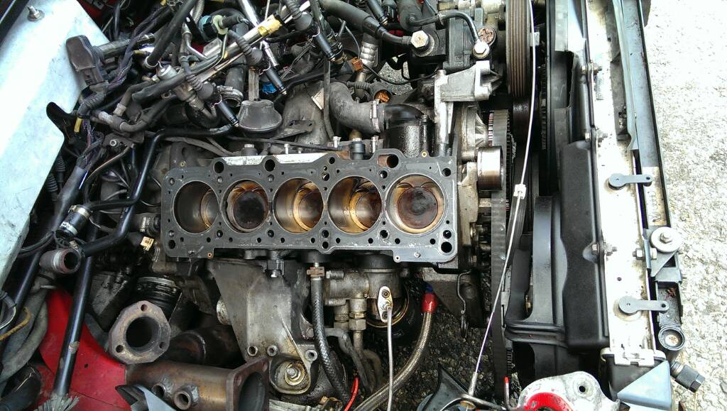

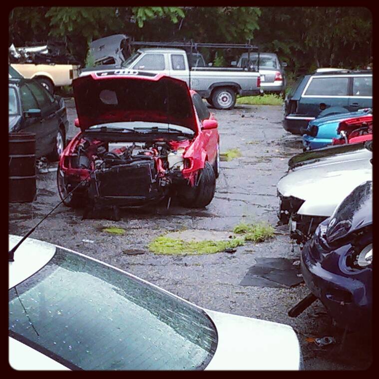

Head, intake, downpipe all unbolted ... Just need to pull it off then came the rain delay...

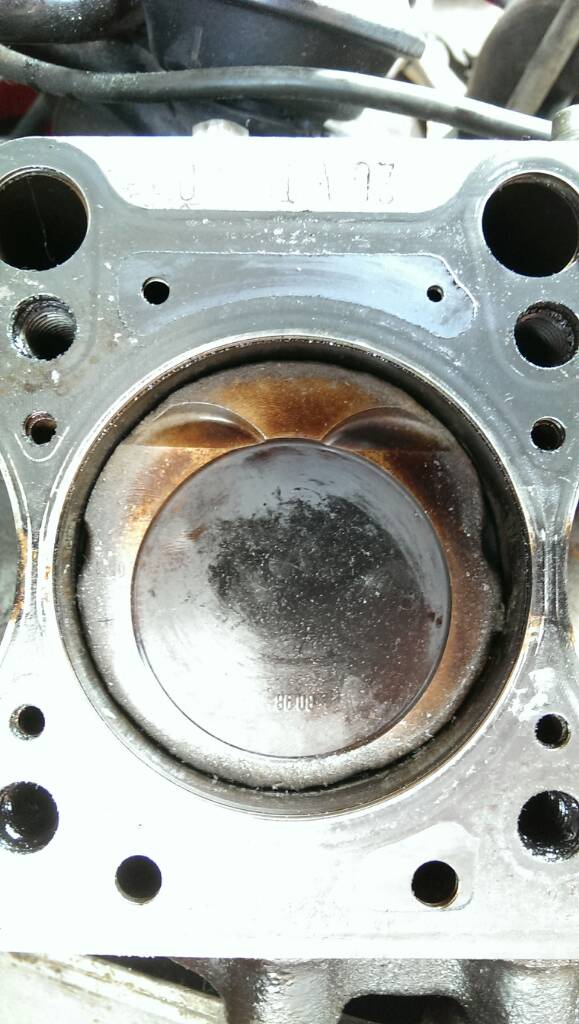

Cylinder 4

HEY THAT LOOKS LIKE DET, JUMP ON THE DET TRAIN WOO WOOOOOOOOOOOO
Or did the hg fail through cylinders? Can't see shit on my phone.

That is some bad detonation. Whatever you do, don't run that same tune on the new motor.
What do the rest of the cylinders look like?

ouch! I bet that t04e was scooting around.
