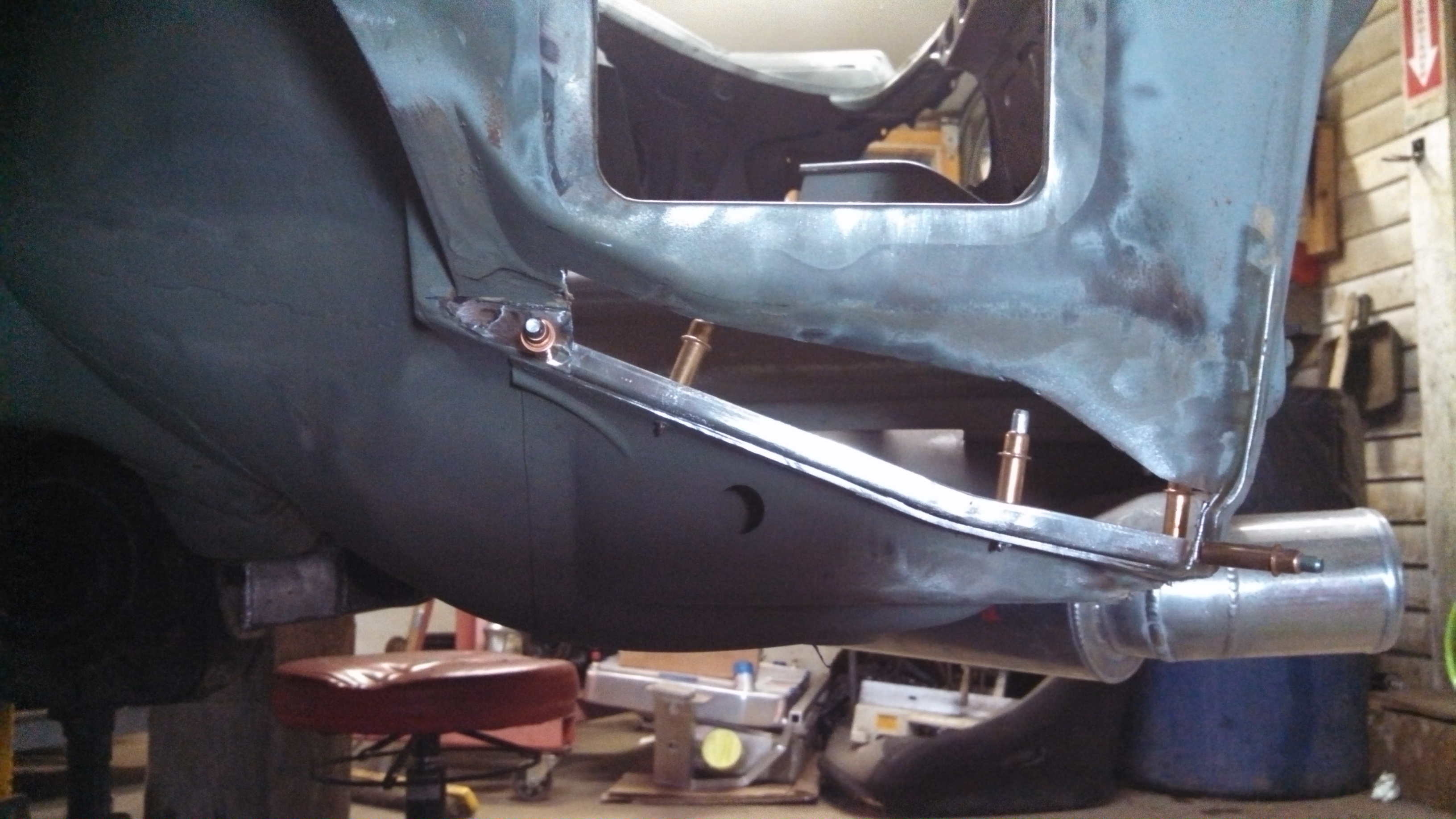

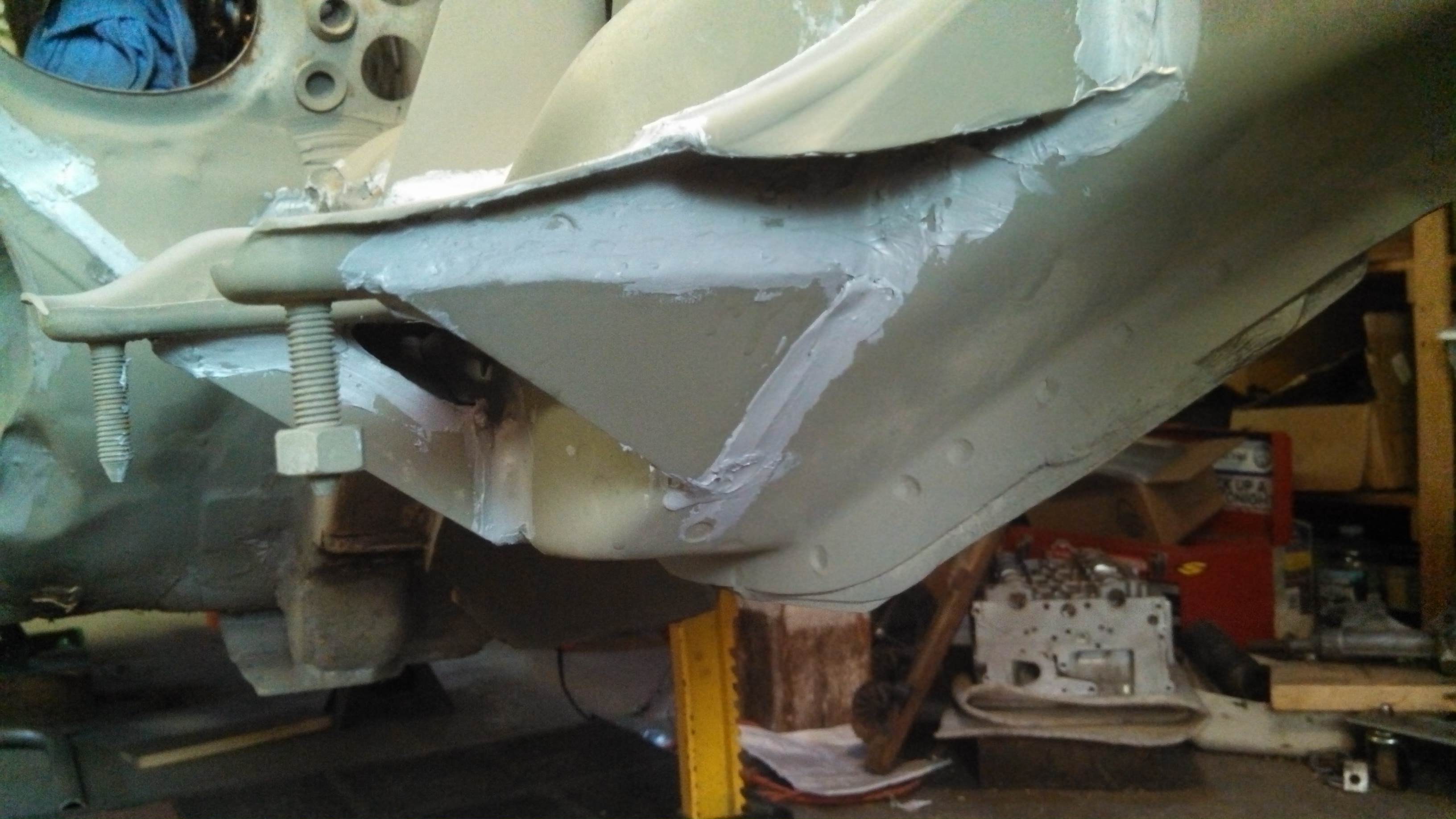

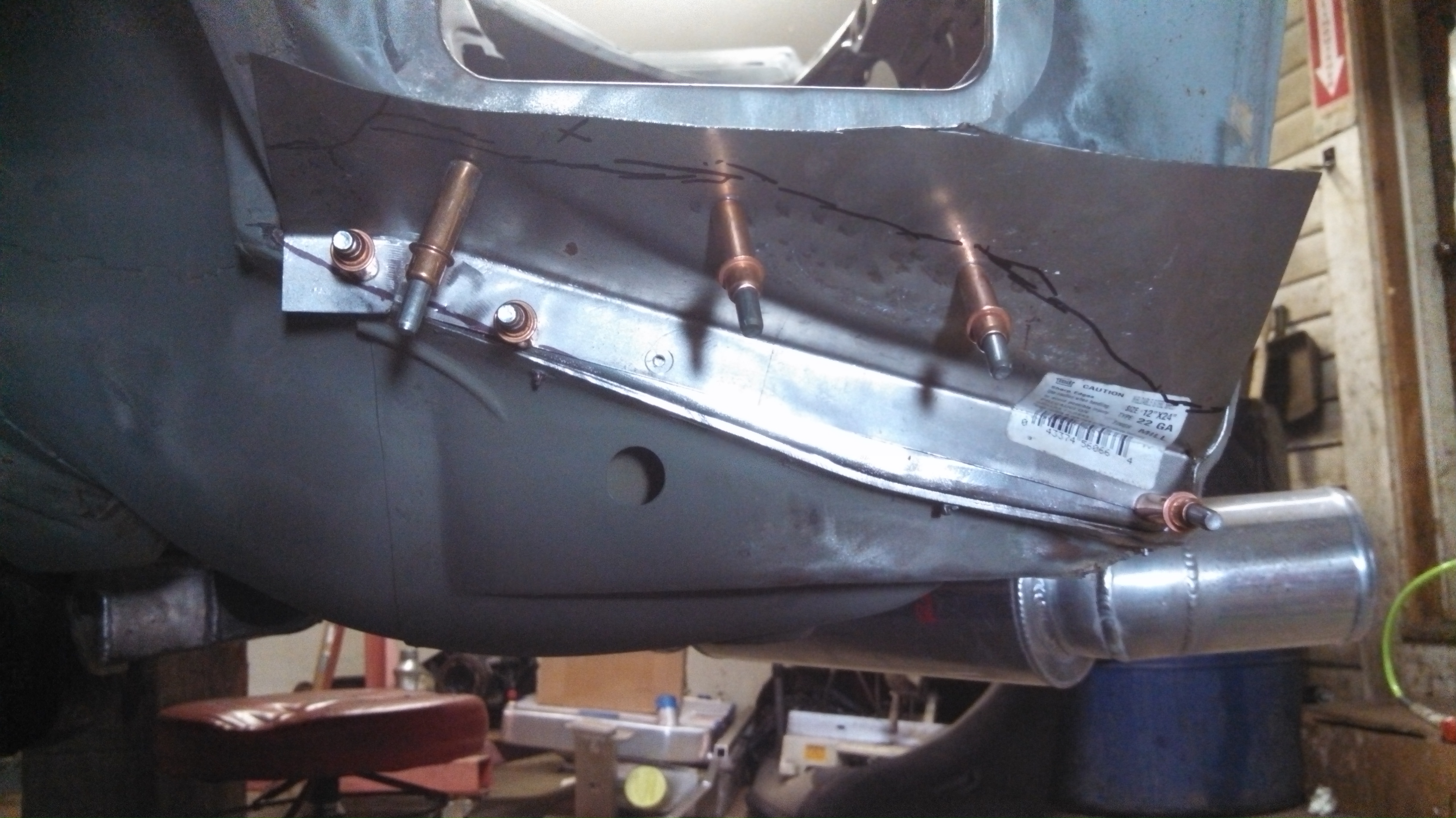

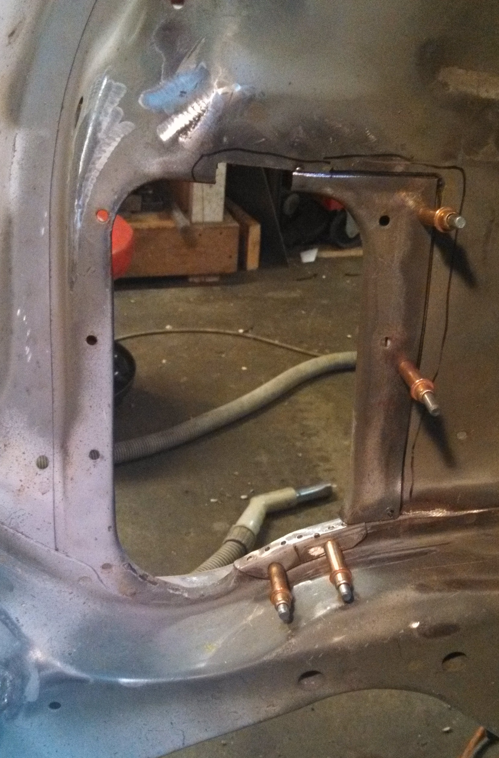

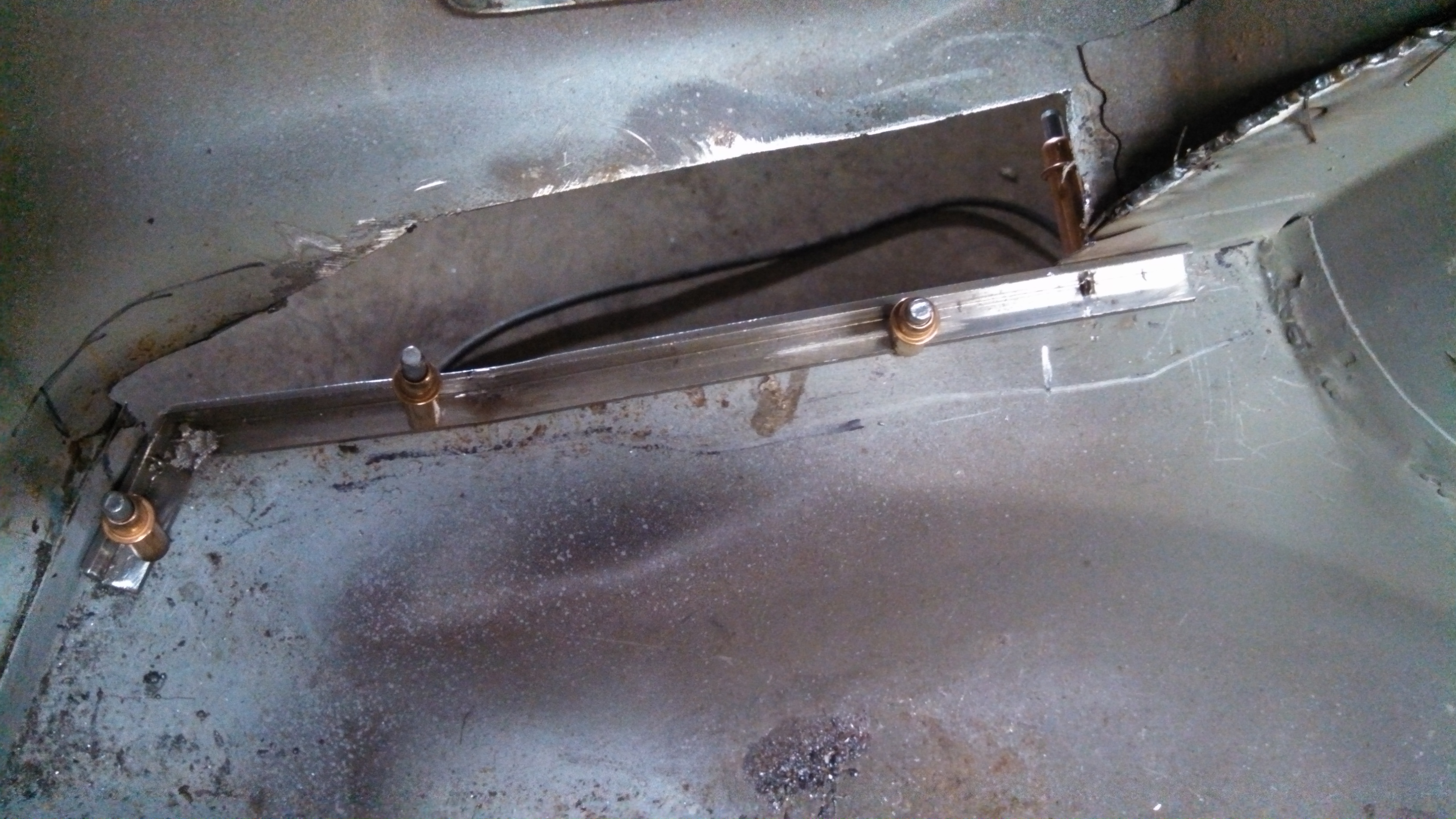

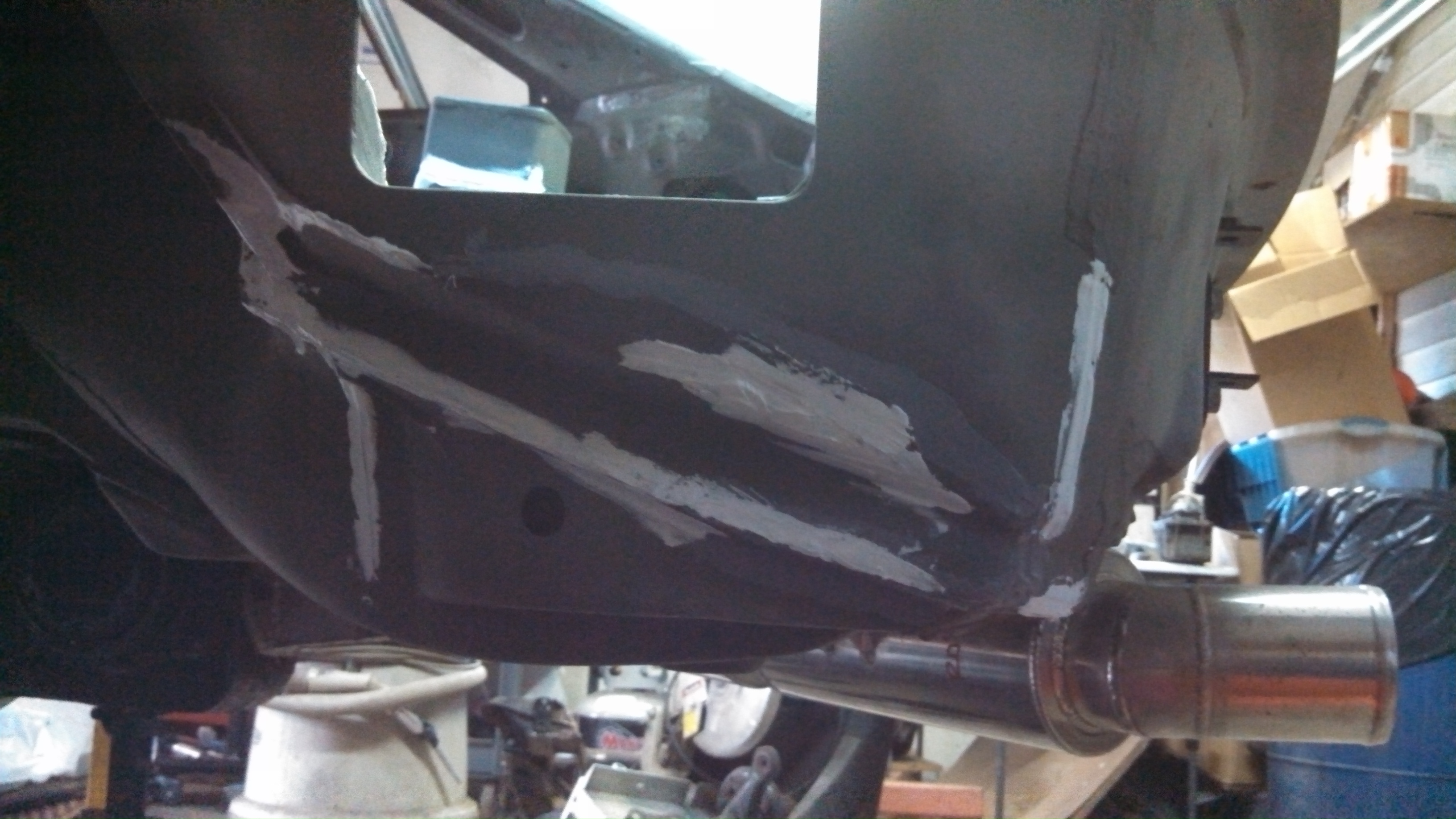

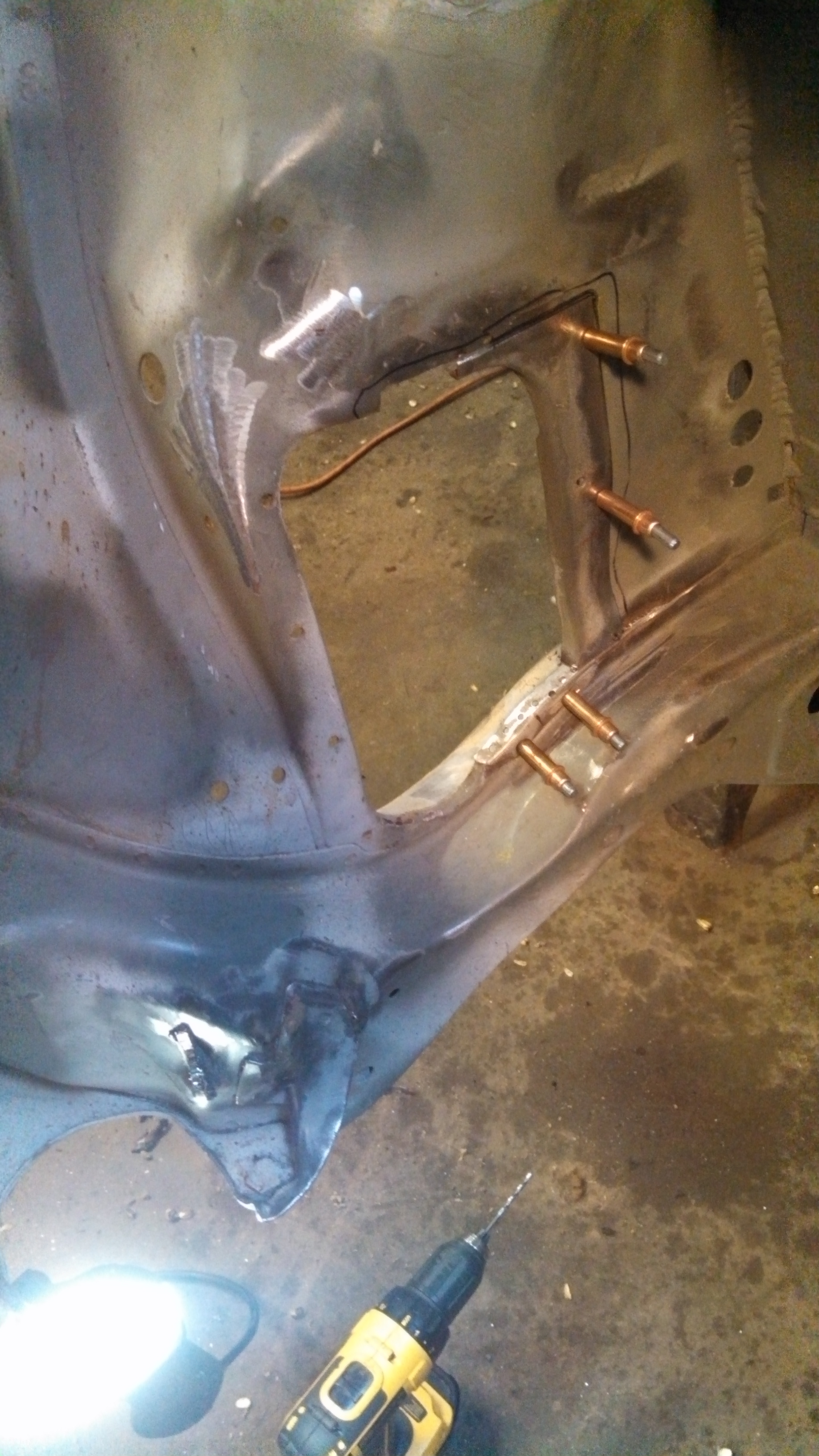

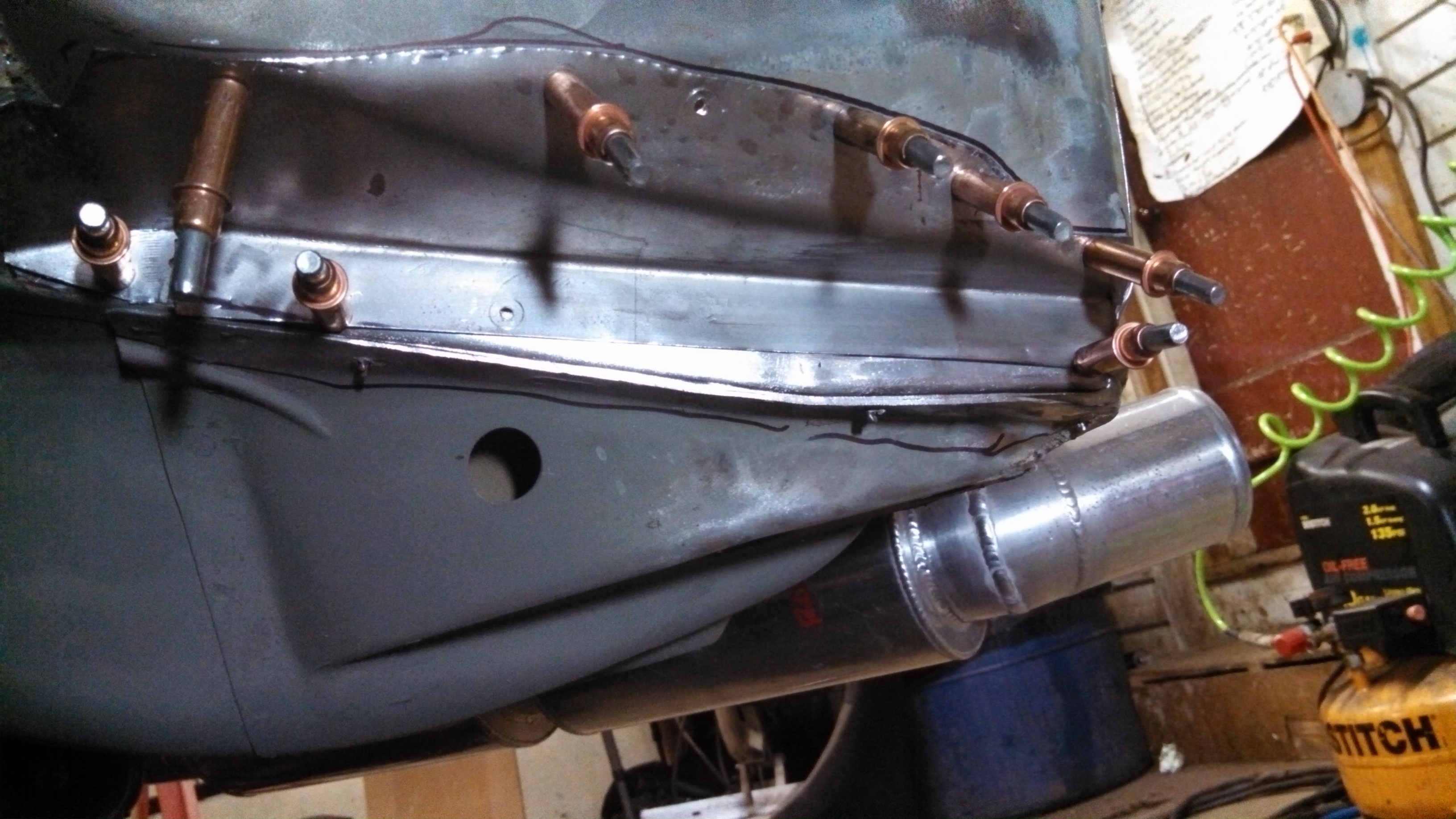

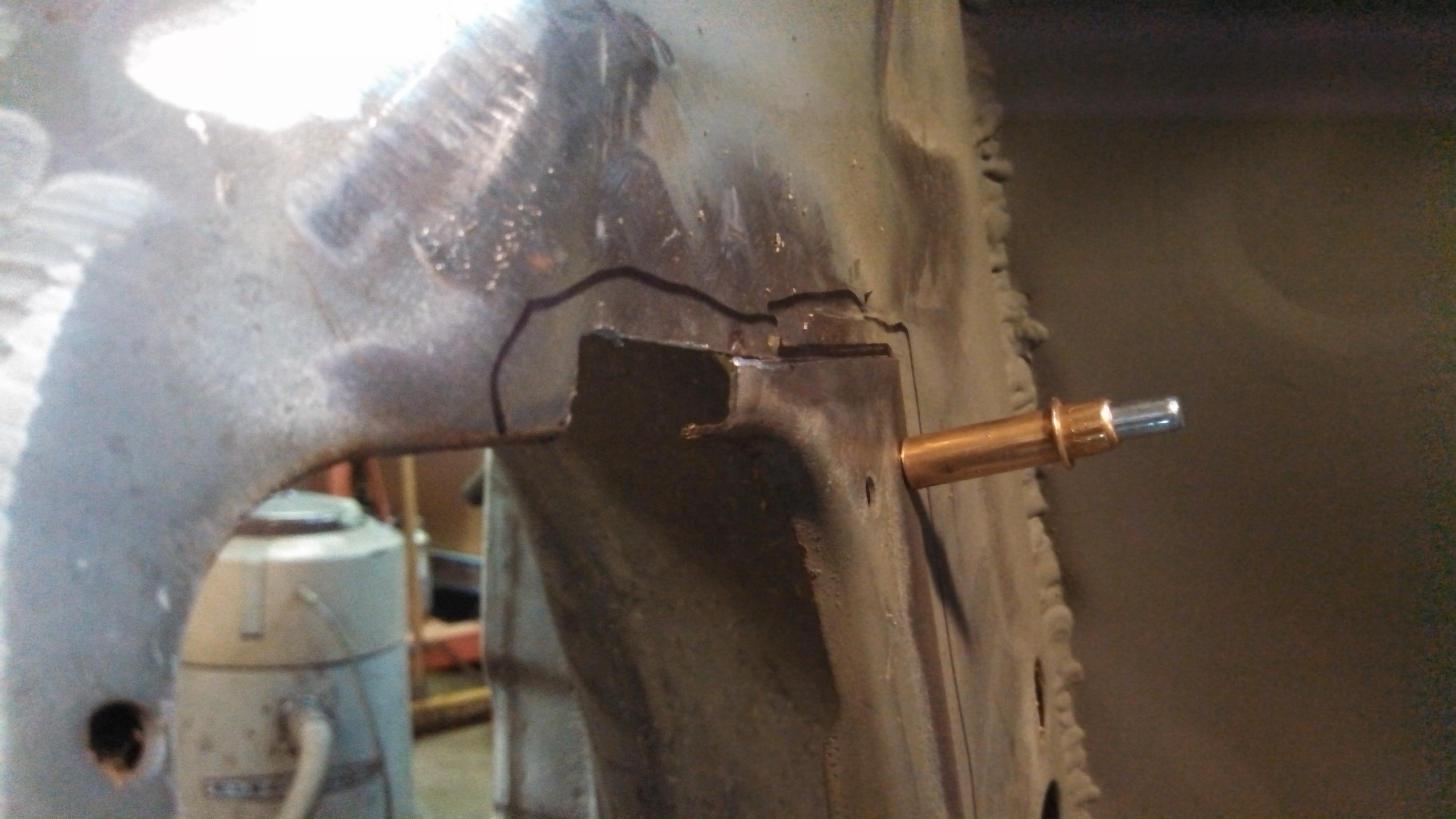

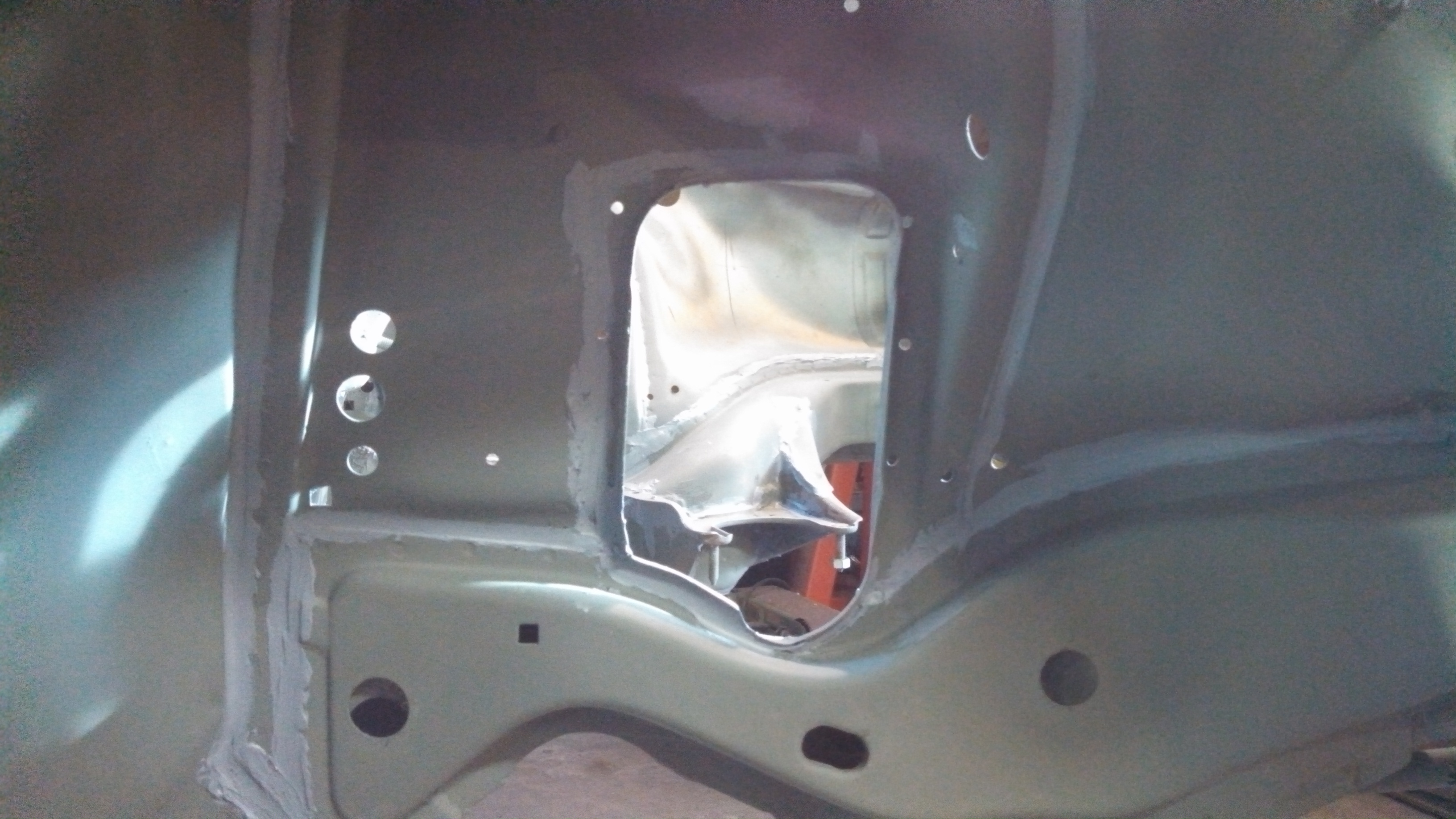

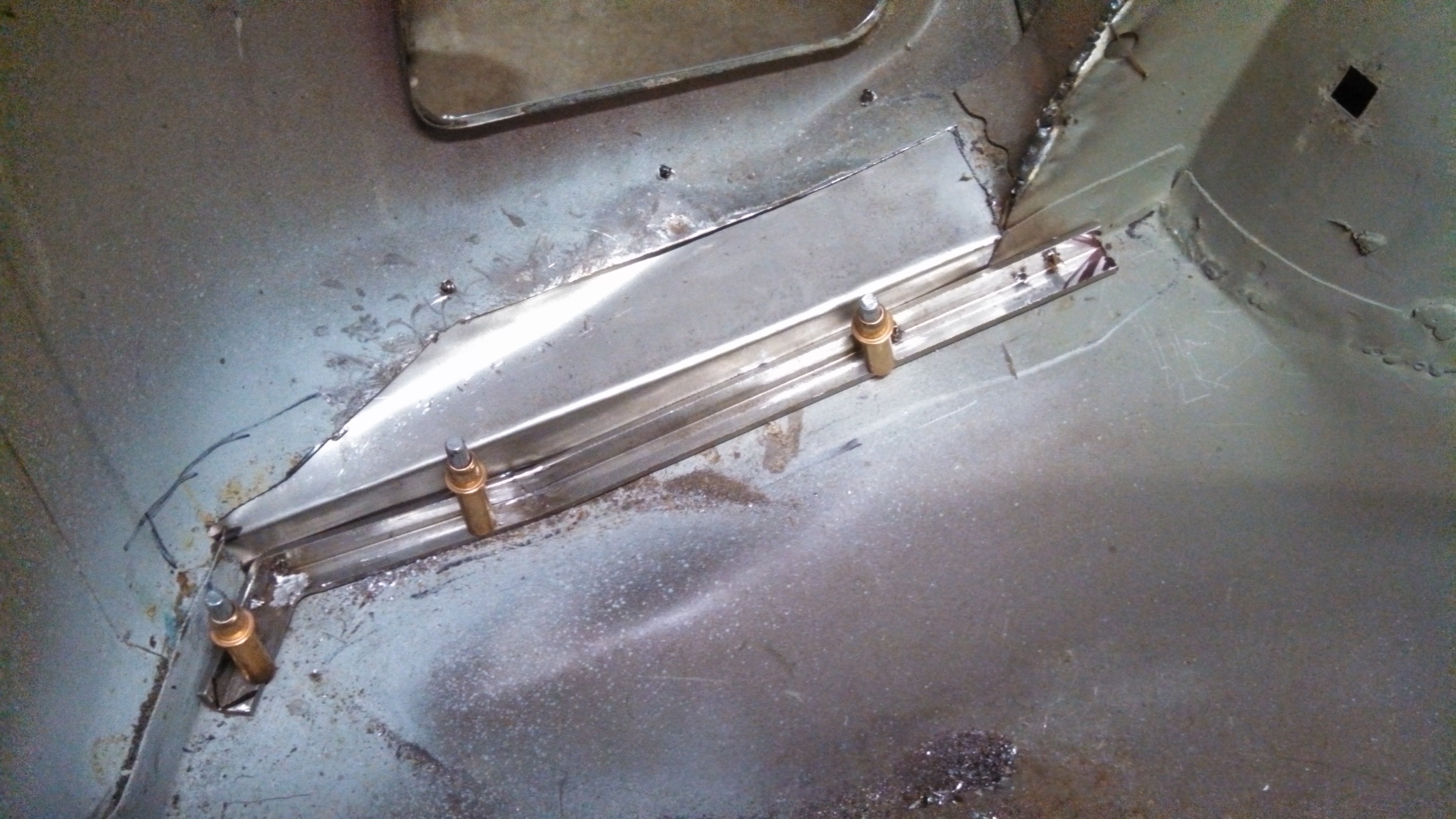

So I had a little bit of rust repair to deal with. Nothing major by any means and it was in an area that was pretty easy to access. The rear lower corners of the shell, where the seam comes together and wraps/goes around the lower corner of the uni-body behind the bumper, that’s where the problem was. The seam had started to rust and separate itself. The repair itself was pretty easy, it just took a bit of time.
The repairs are made with 1/8” thick, ½” x ½” angle and 20 ga. Sheet
Getting started
rear dr rust patch reinforcement outside.jpg (1.46 MiB) Viewed 47088 times
rear dr rust patch reinforcement inside above.jpg (1.6 MiB) Viewed 47088 times
rear dr rust repair patch inside.jpg (1.65 MiB) Viewed 47088 times
Cleco’s are the best !!!
rear dr rust patch being made to fit.jpg (1.51 MiB) Viewed 47088 times
rear dr rust patch ready to weld.jpg (1.54 MiB) Viewed 47088 times

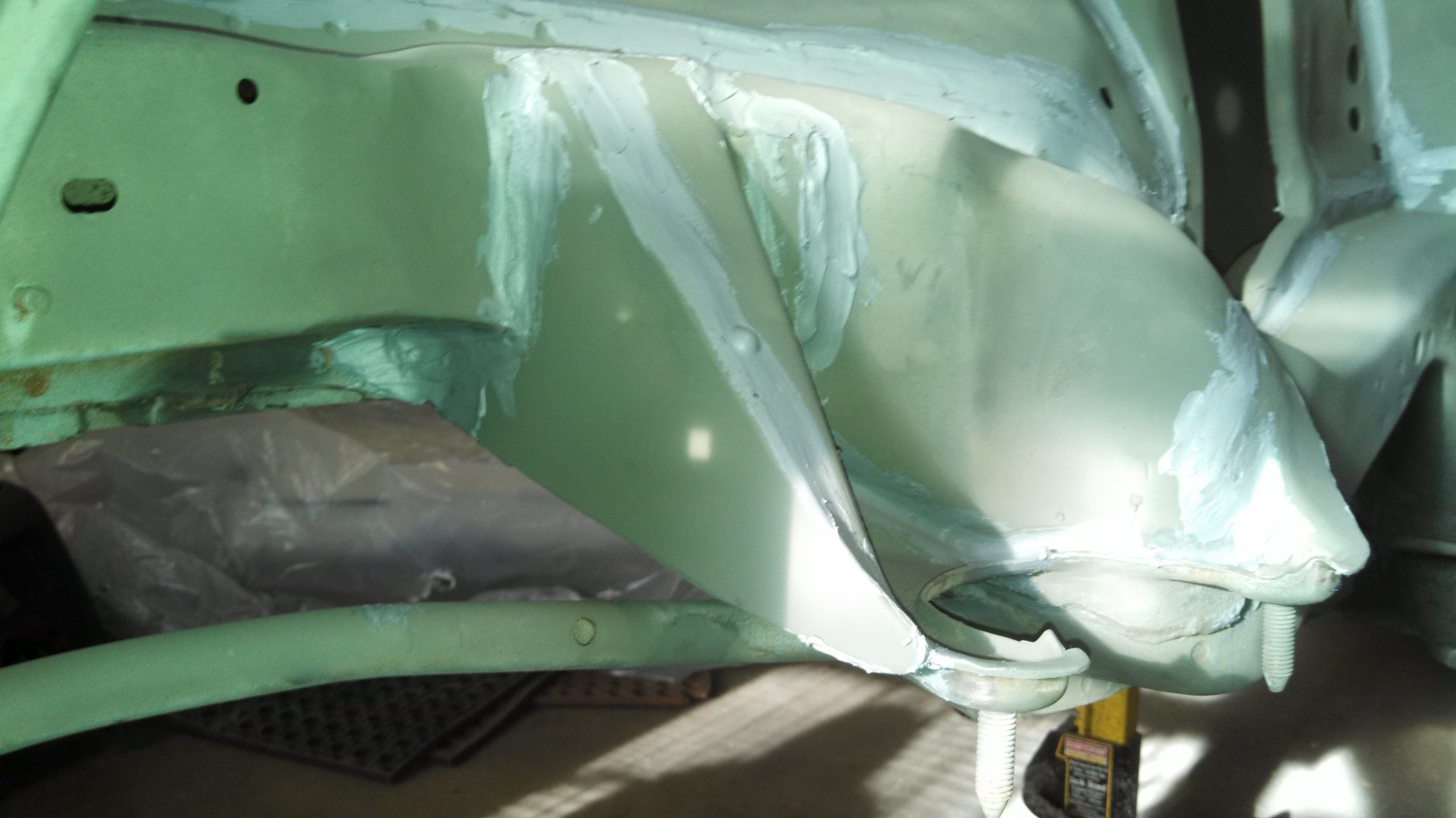

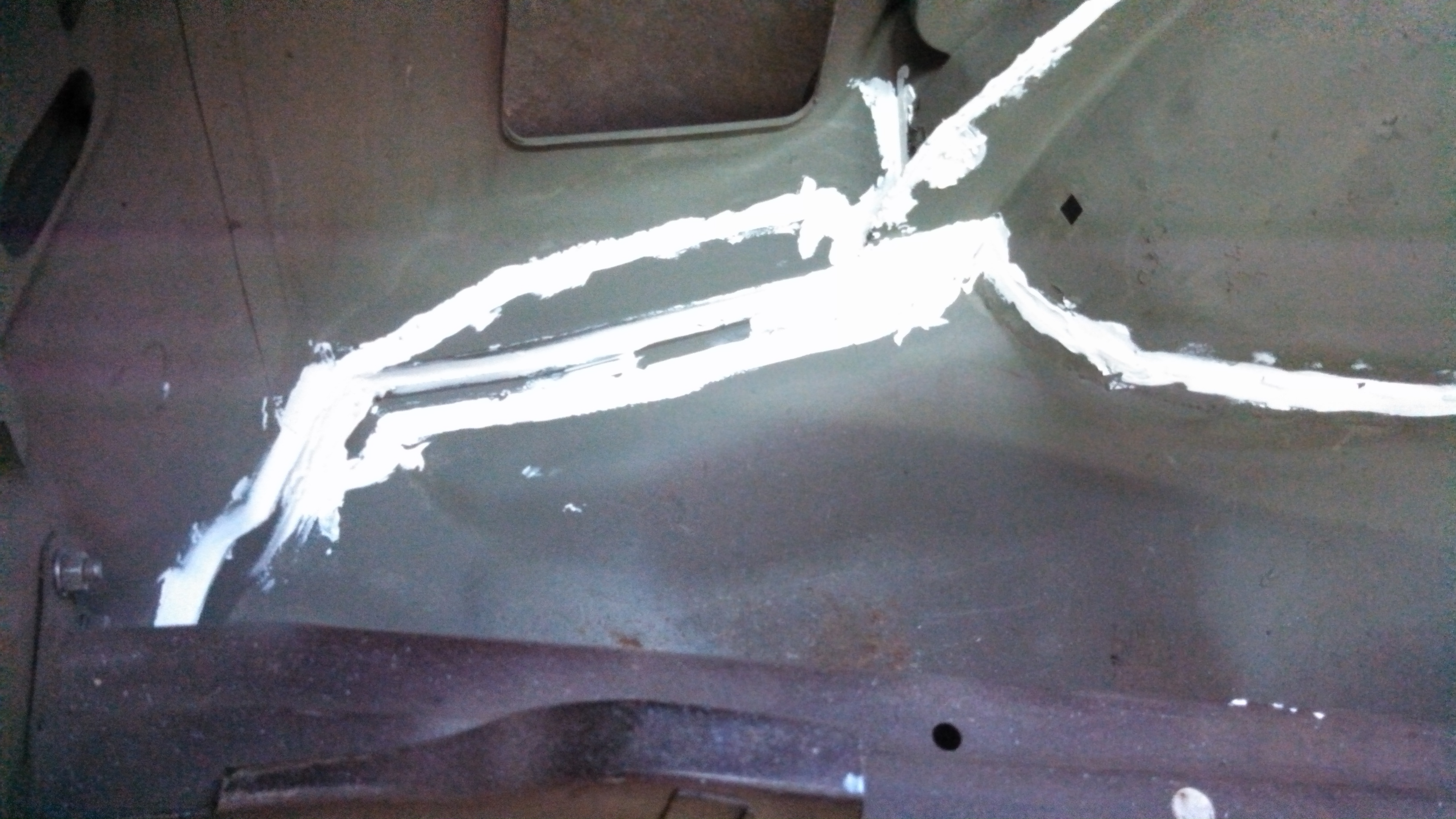

And finally seam welded, primed, and seam-sealed!
rear corner rust repair welded and sealed.jpg (1.44 MiB) Viewed 47088 times
rear corner rust repair welded and sealed2.jpg (1.2 MiB) Viewed 47088 times

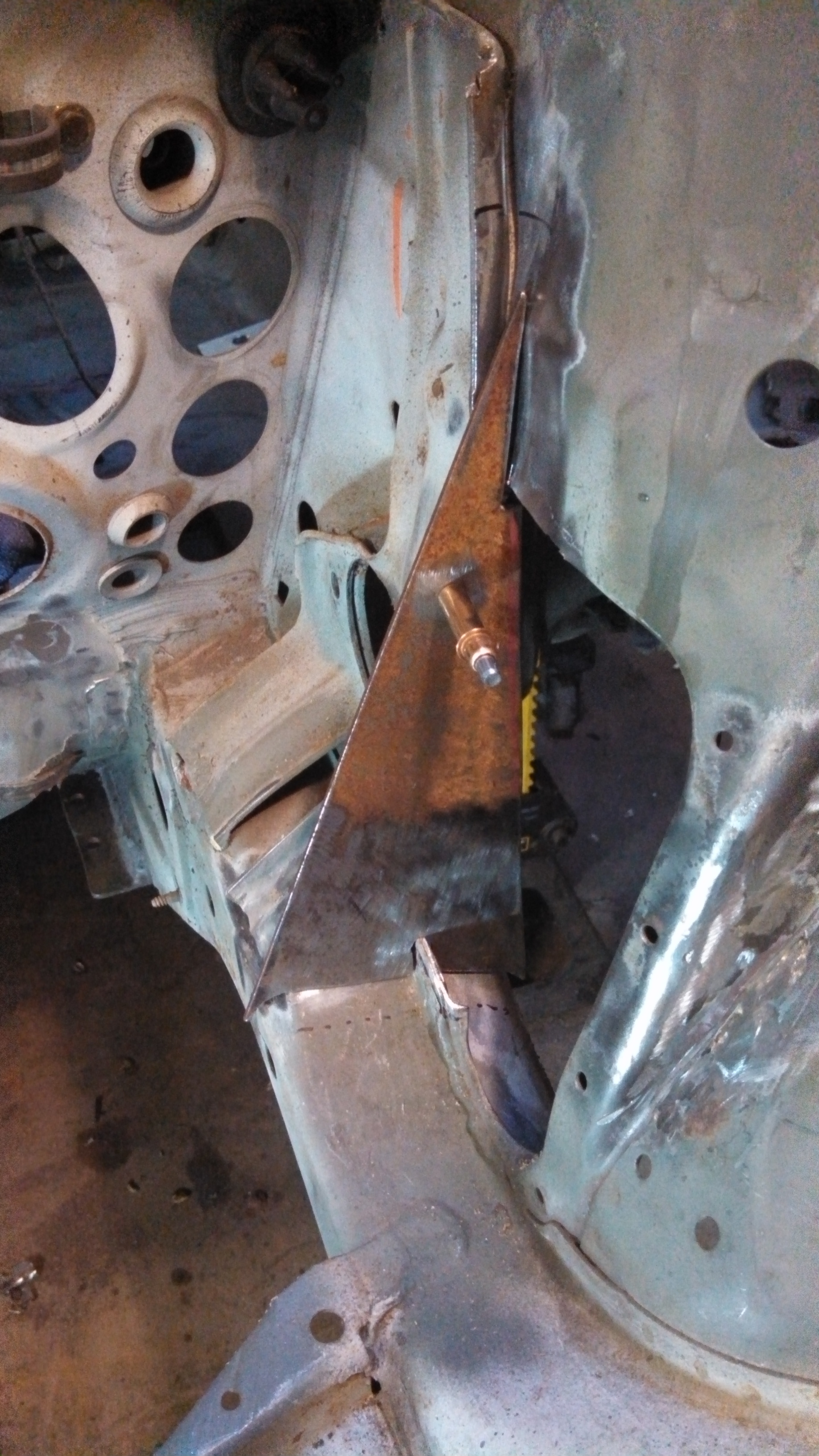

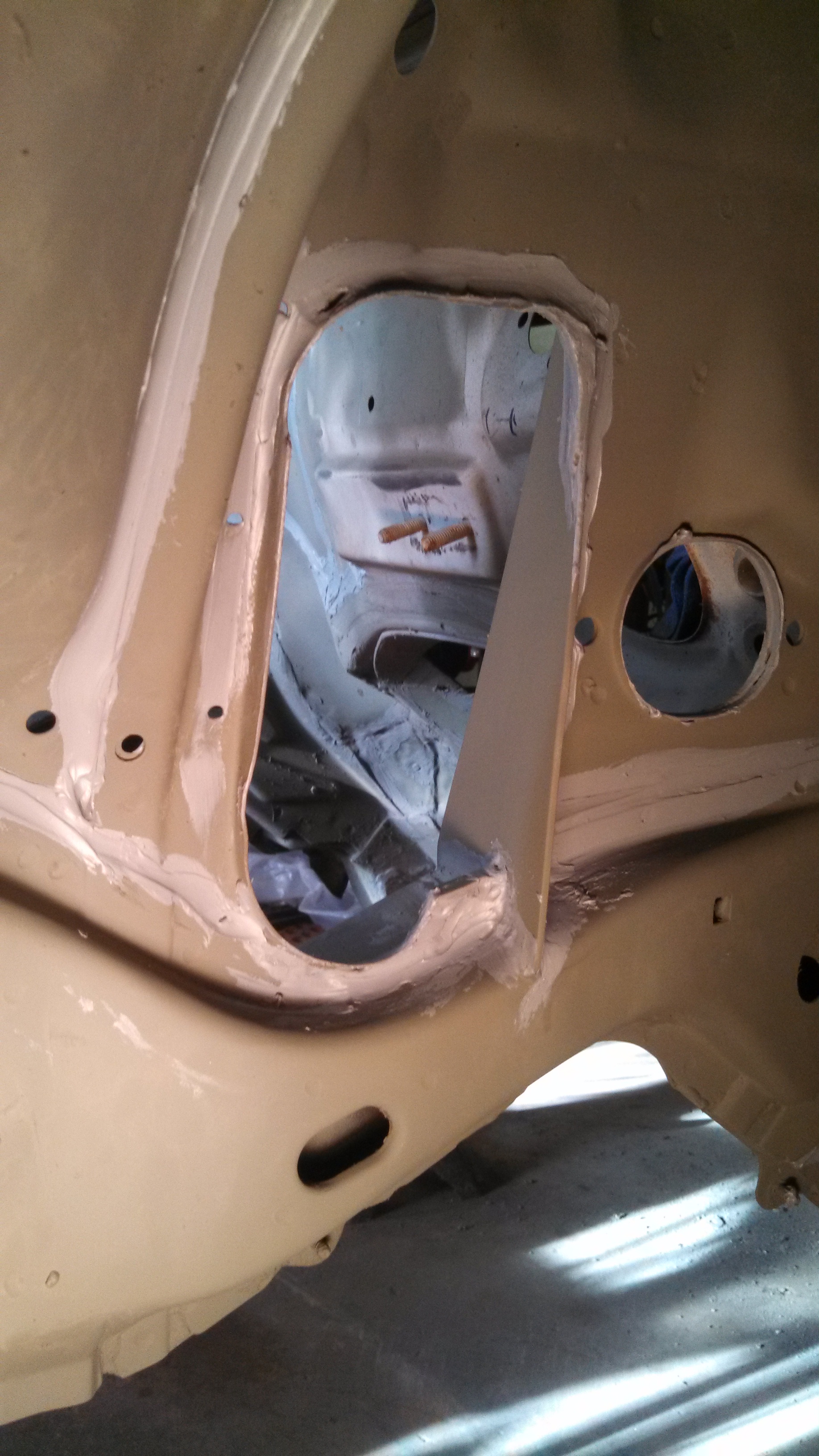

I’m running the HTMS steering arms, and with their adjustability I needed to open up the steering arms holes for proper clearances. I cut them out carefully so I could reuse the rounded corners for a nice, clean install.
Here they are cut out
steering arm holes enlarged.jpg (1.47 MiB) Viewed 47088 times
steering arm holes enlarged 2.jpg (1.48 MiB) Viewed 47088 times
steering arm holes weld detail.jpg (1.18 MiB) Viewed 47088 times

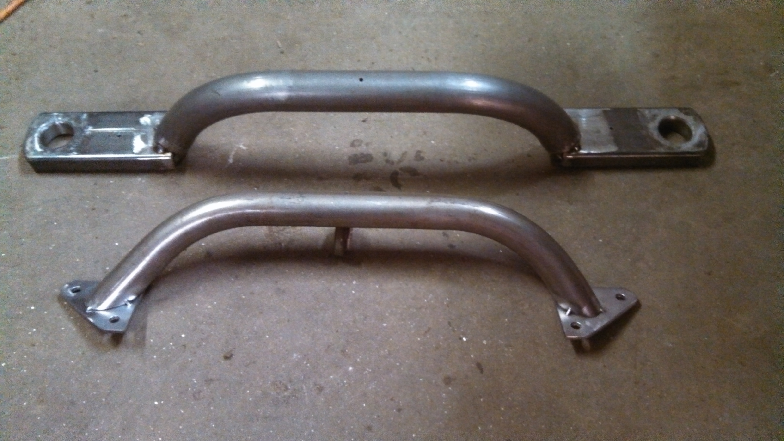

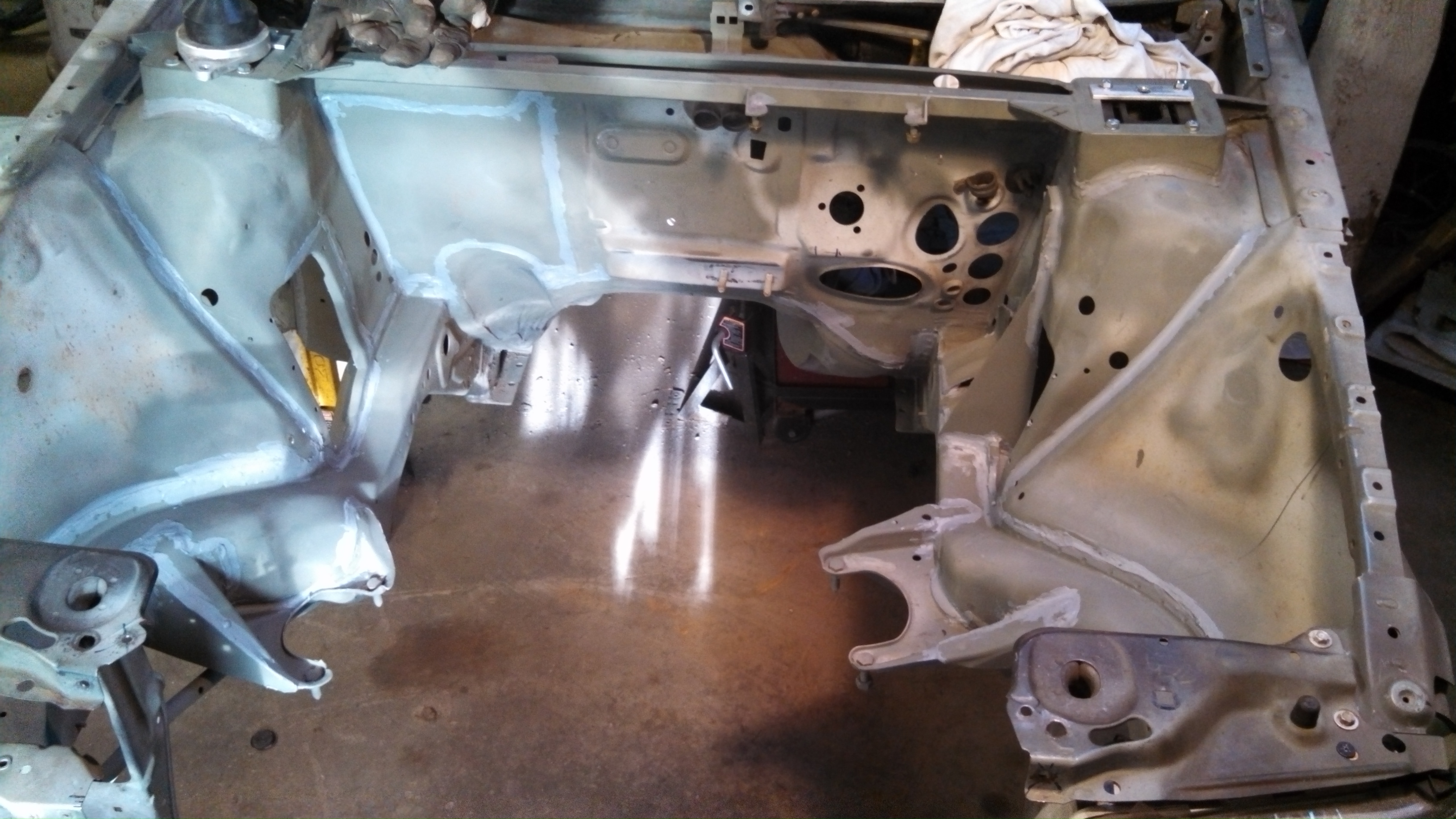

I also added a large steering rack to strut tower brace. These cars are pretty flexible and with the large steering forces that will be generated, I thought it would be a good idea to reinforce it. The brace is wide enough that it was fully welded to either side of the upper portion of the frame rail, and then welded in/out all the way to the top. Getting the rack in/out is a bit tight, but its well worth it for the stiffness and strength.
steering rack strut tower brace.jpg (1.6 MiB) Viewed 47088 times
steering rack strut tower brace2.jpg (1.51 MiB) Viewed 47088 times

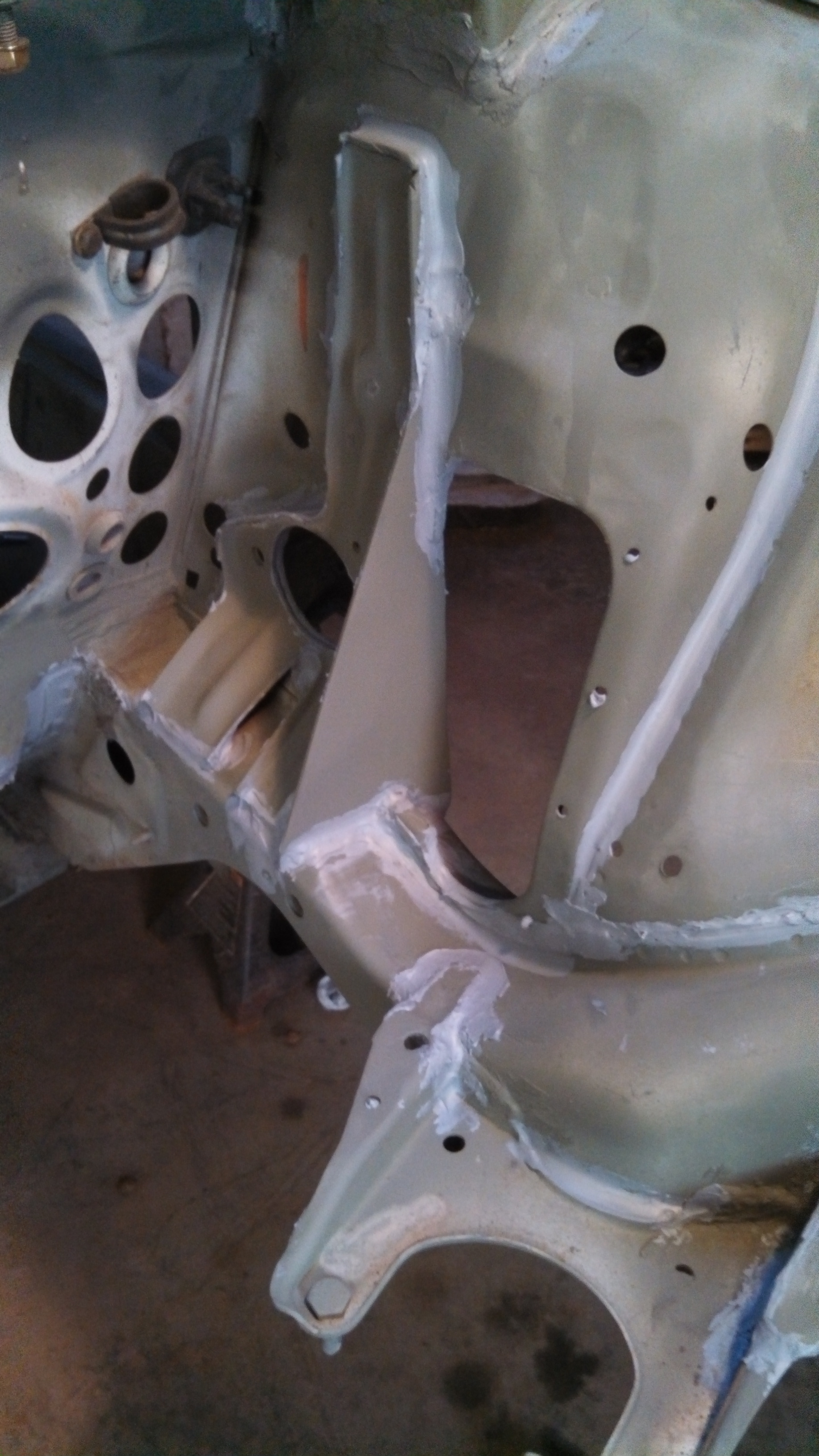

And here it is, all seam welded, etch primed, and seam-sealed
steering rack strut brace welded and sealed.jpg (1.4 MiB) Viewed 47088 times
steering arm holes welded and sealed.jpg (1.65 MiB) Viewed 47088 times
steering arm holes welded and sealed2.jpg (1.32 MiB) Viewed 47088 times
steering arm holes and brace welded and sealed.jpg (1.58 MiB) Viewed 47088 times
steering arm holes and brace welded and sealed2.jpg (1.39 MiB) Viewed 47088 times

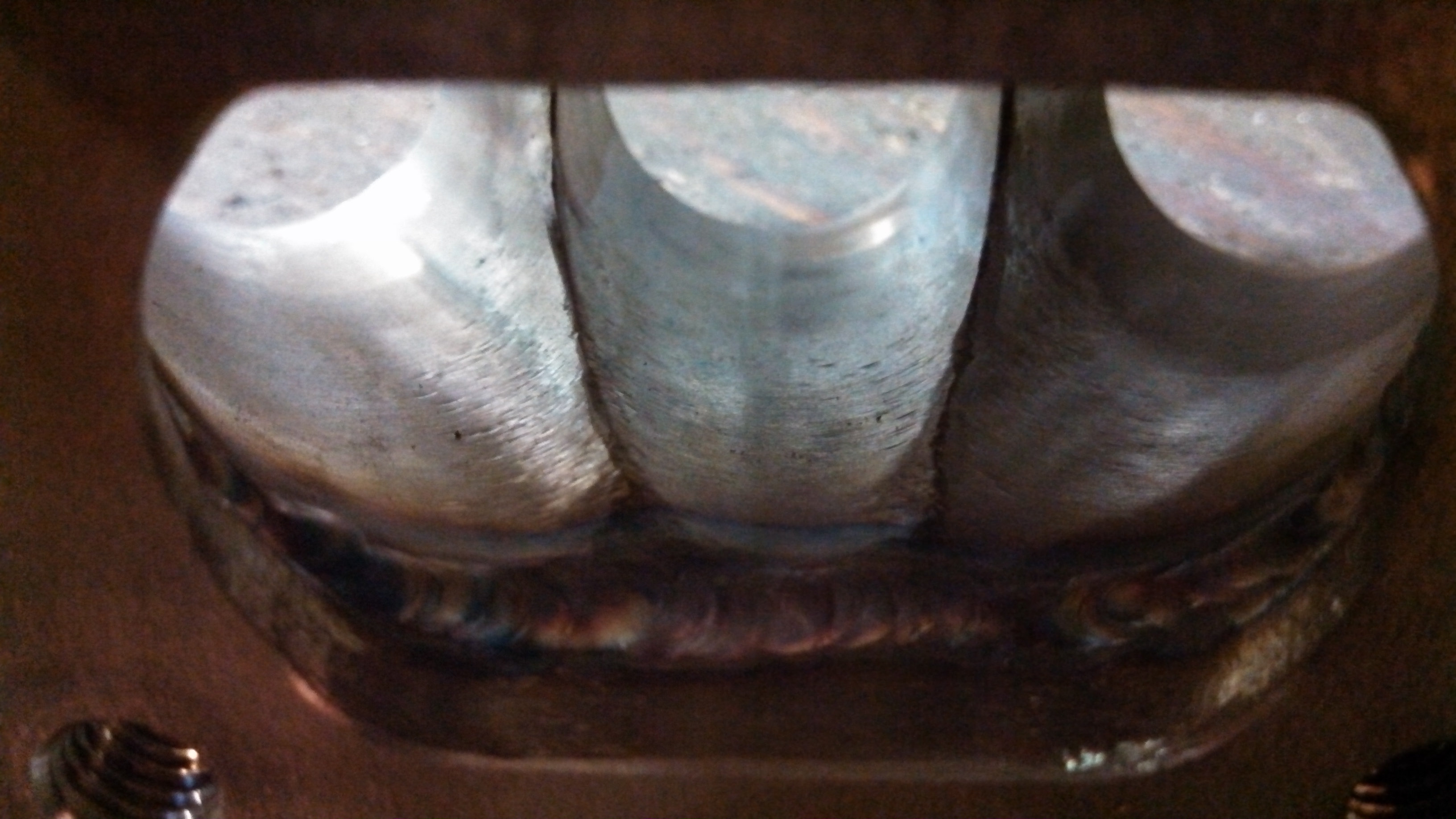

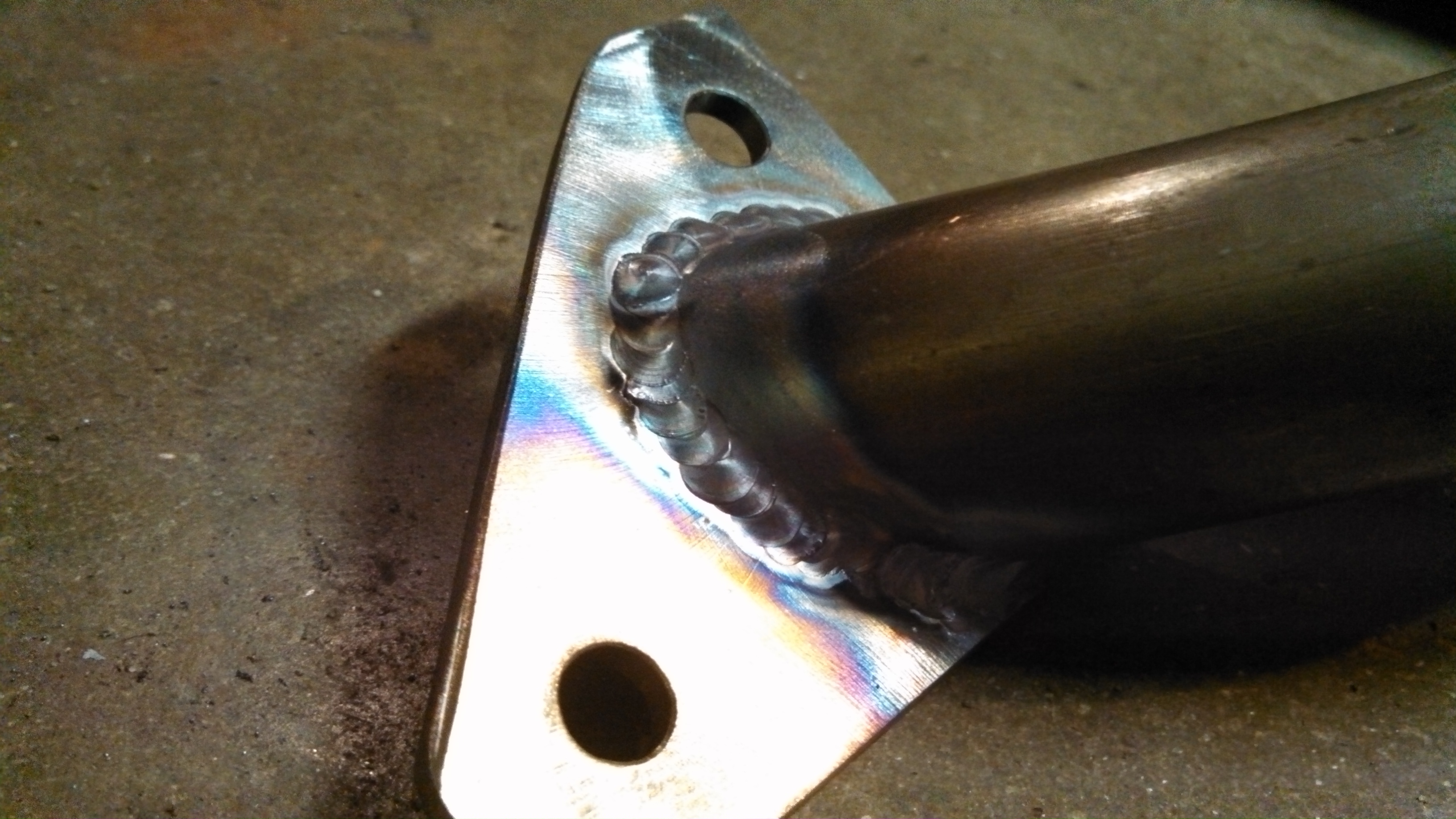

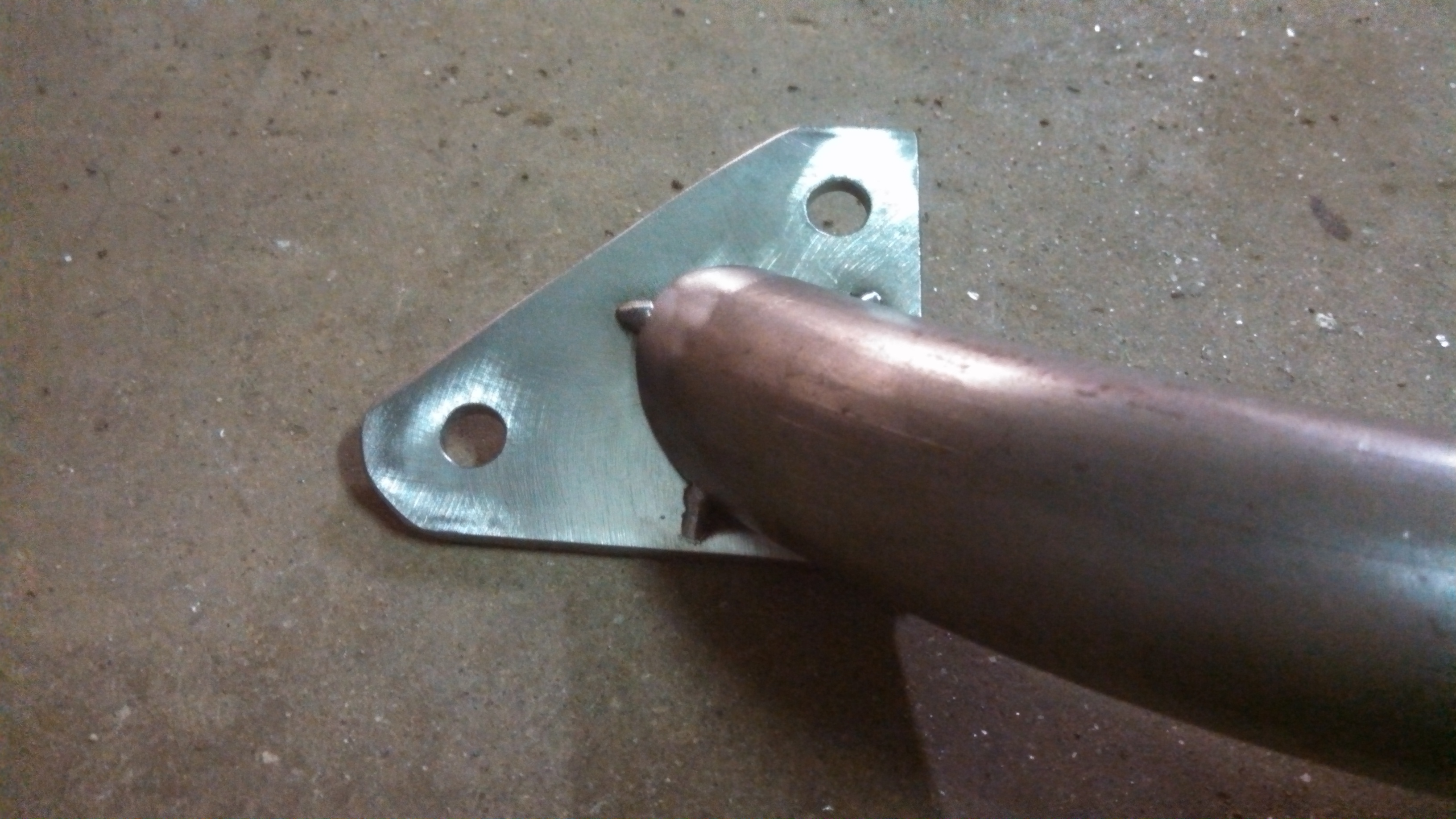

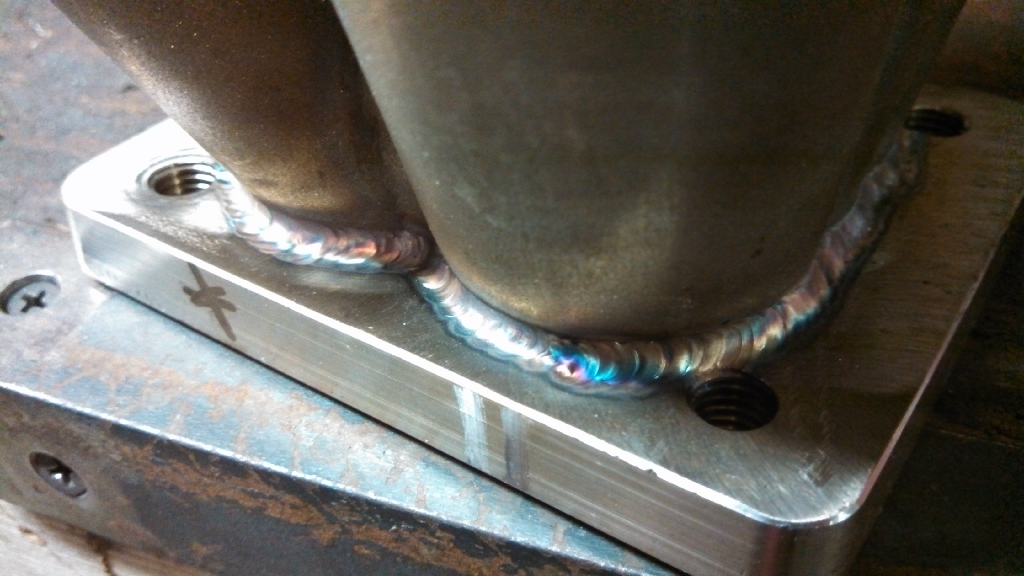

I had Ryan seam weld the exhaust manifold collector. The collector to flange to hotside transition will be beautifully formed. It will all get ground and polished.
t4 flange to collector welded.jpg (1.49 MiB) Viewed 47087 times
t4 flange to collector welded2.jpg (1.2 MiB) Viewed 47087 times

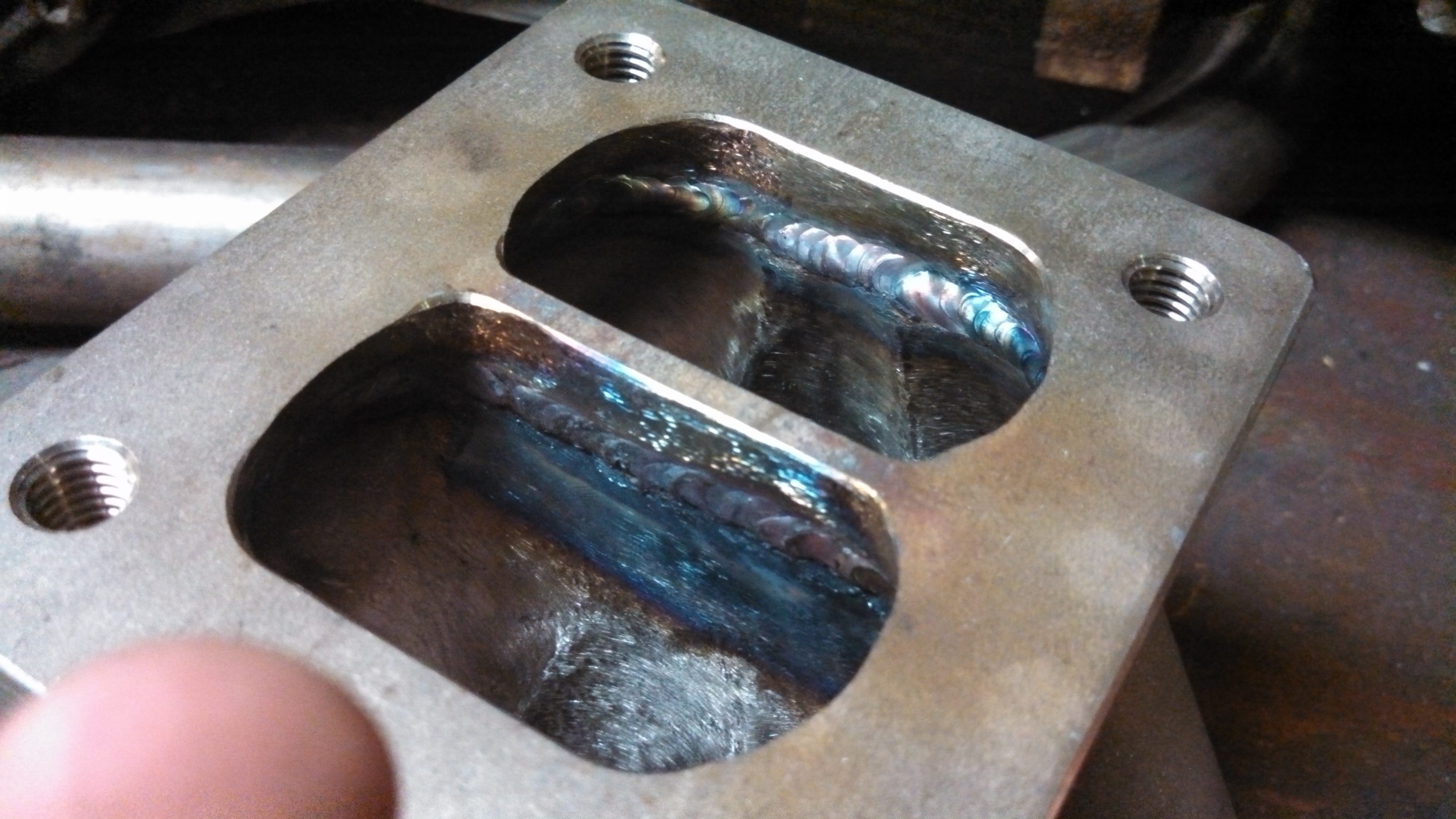

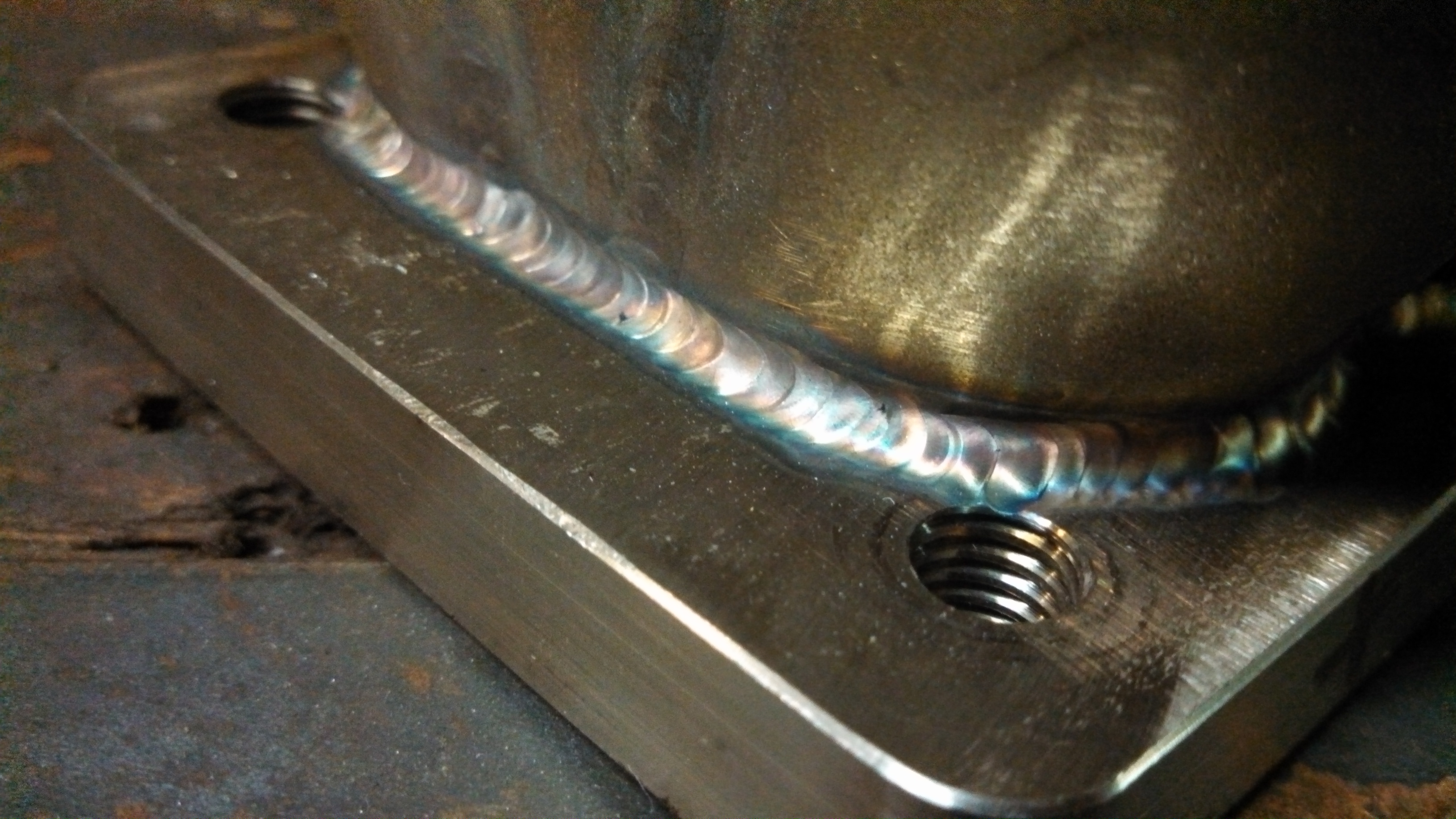

I got a lot of it done where the runners come together, now just to work on the collector to flange seam.
I will get this damn thing nice and shiny smooth!!!
t4 flange to inner collector welded.jpg (1.15 MiB) Viewed 47087 times
t4 flange to inner collector welded2.jpg (1.37 MiB) Viewed 47087 times

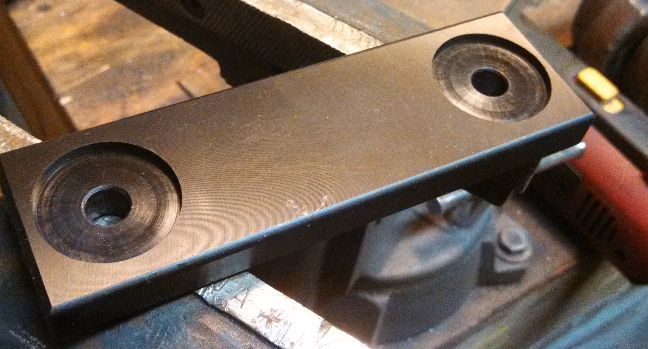

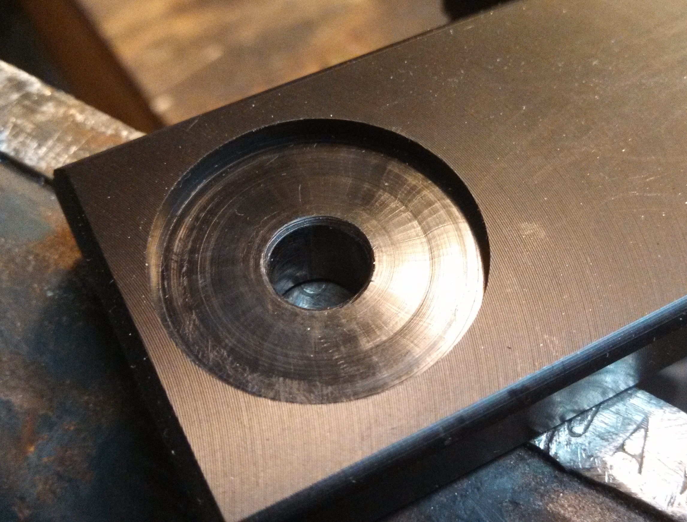

My Delrin trans. bar spacer/bushing is back from machining. It sits between the trans. bar and the transmission mounting surface. Its ½” Delrin plate, with a 1/8” radius on the edges, with 1 1/8” reliefs for extra thick 304ss washers on which the trans. will sit.
delrin transbar bushing machined.jpg (1.3 MiB) Viewed 47086 times
delrin transbar bushing thick SS washer relief.jpg (1.38 MiB) Viewed 47086 times

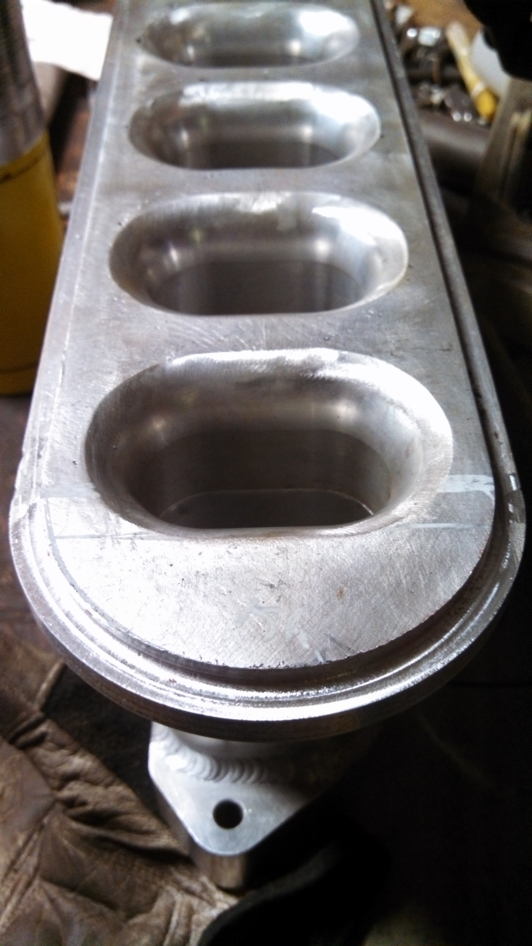

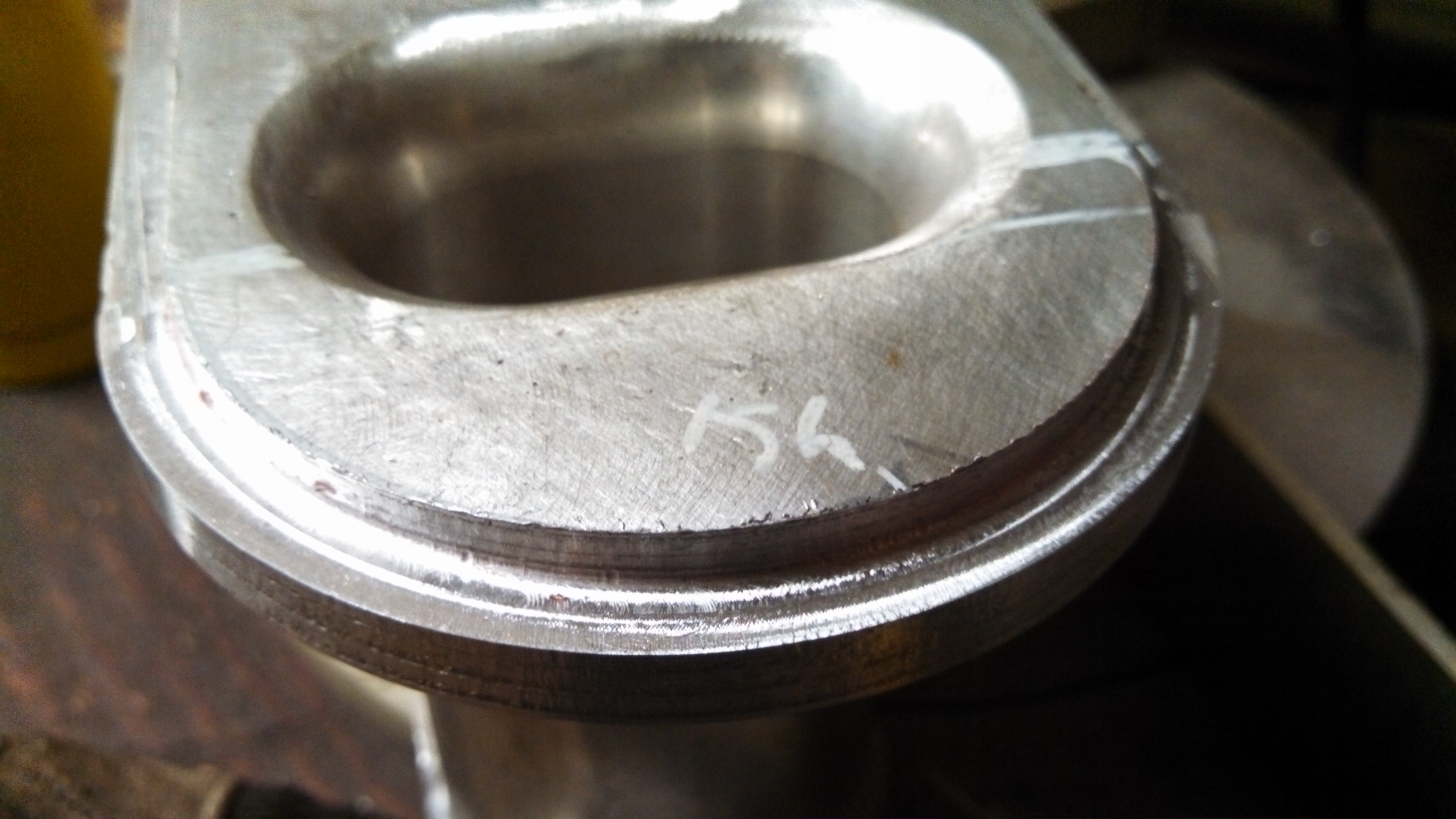

I also got my intake manifold plenum flange re-machined. The recess for the plenum was brought in on either end ~3/4-7/8”. It was tough for Ryan to get it all jigged up in the Bridgeport, but he got it figured out and cut nice and clean. Intake manifold progress has restarted and be finished up soon.
intake mani plenum flange re-radiused.jpg (1.27 MiB) Viewed 47086 times
intake mani plenum flange re-radiused2.jpg (1.28 MiB) Viewed 47086 times

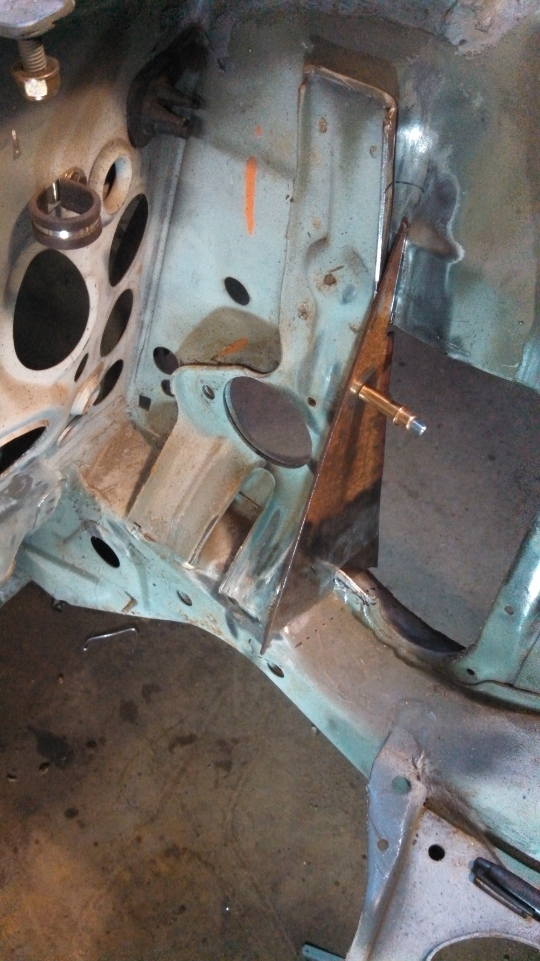

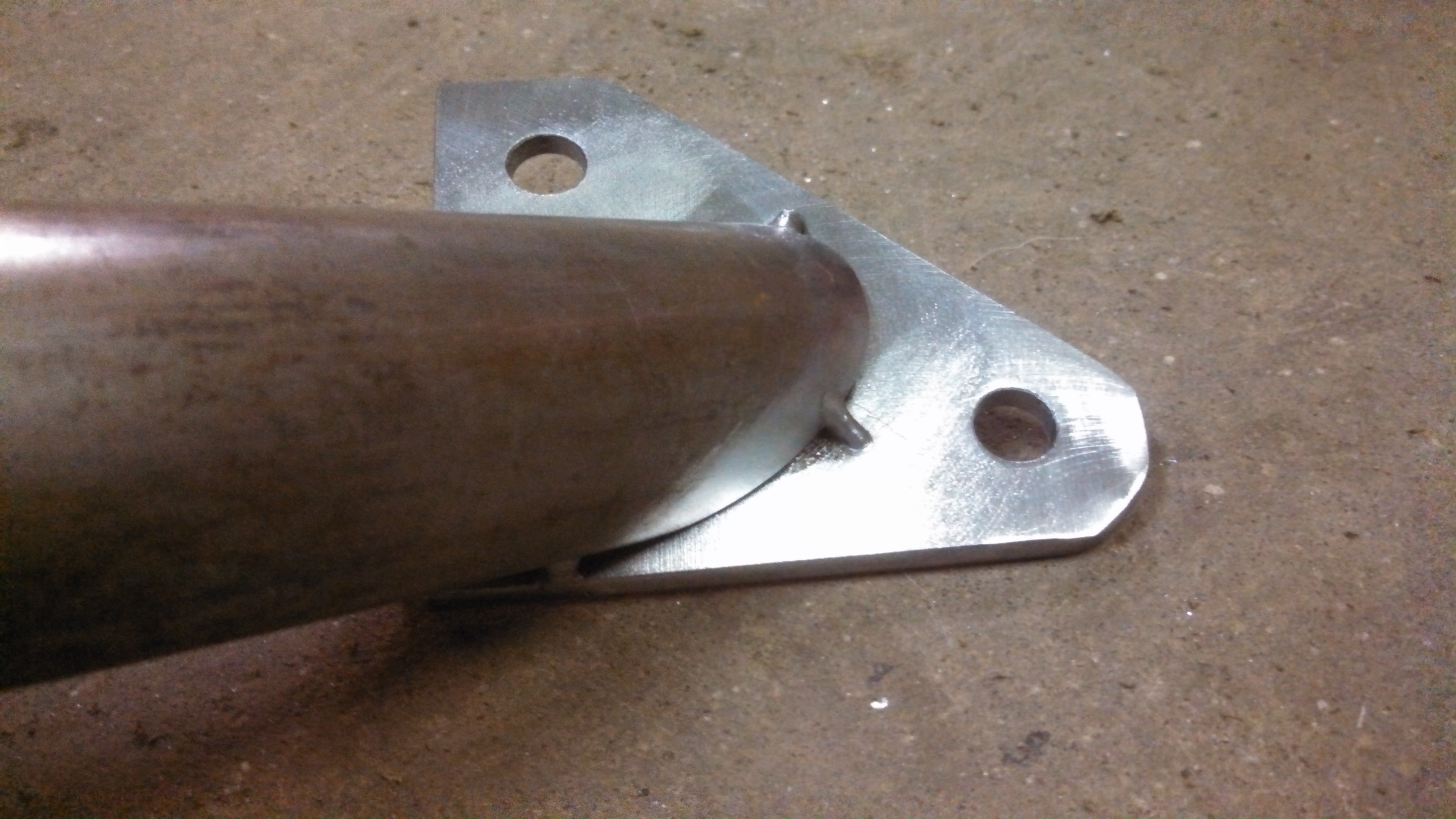

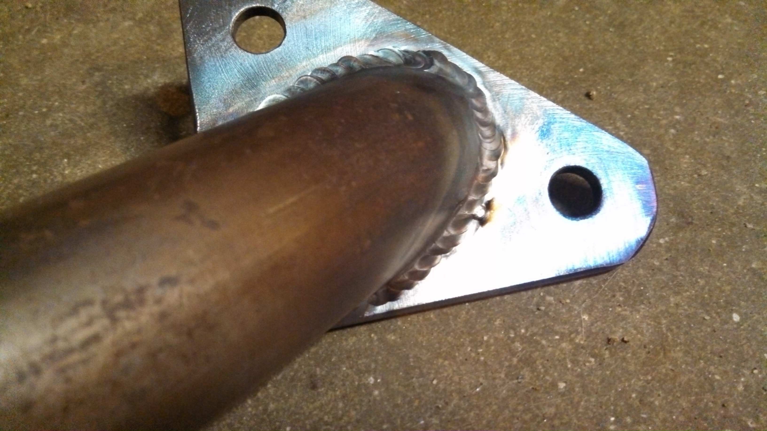

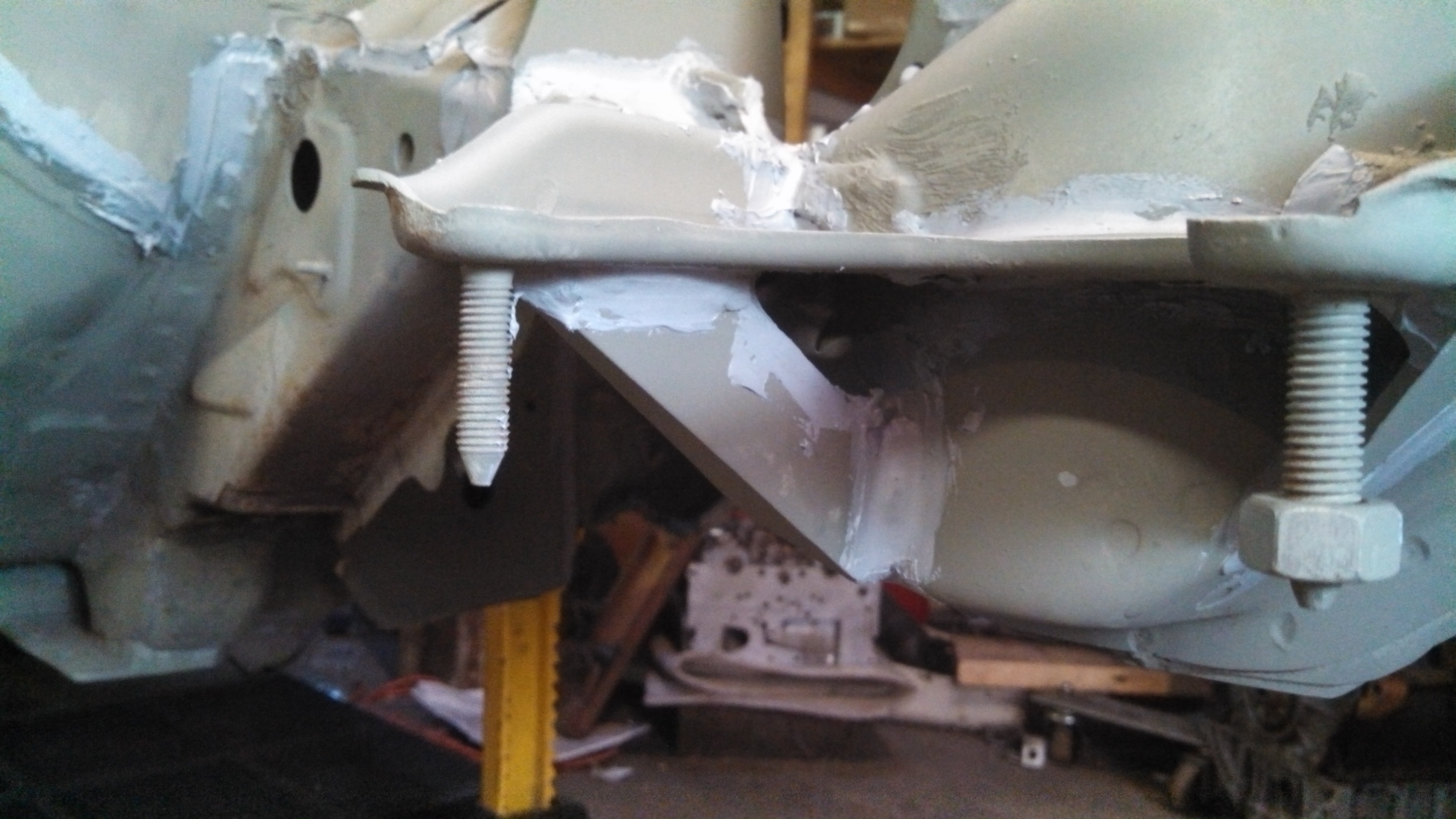

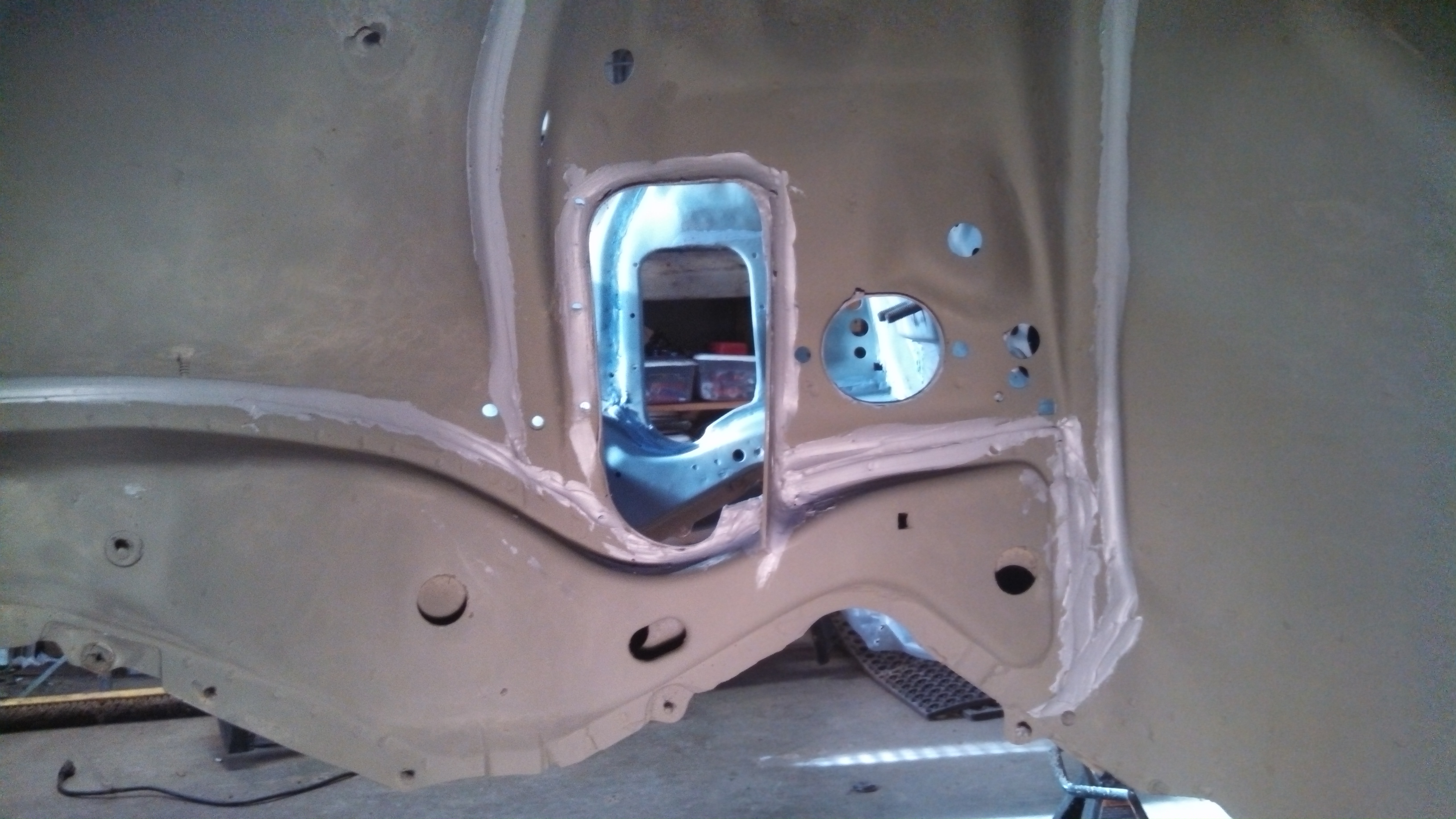

I added some reinforcement plates and angle to the chassis motor mount ears. No process pics, but here they are seam welded, etch primed, and seam seamled.
motor mount ear reinforcments welded and sealed.jpg (1.33 MiB) Viewed 47084 times
motor mount ear reinforcments welded and sealed2.jpg (1.33 MiB) Viewed 47084 times
motor mount ear reinforcments welded and sealed3.jpg (1.34 MiB) Viewed 47084 times

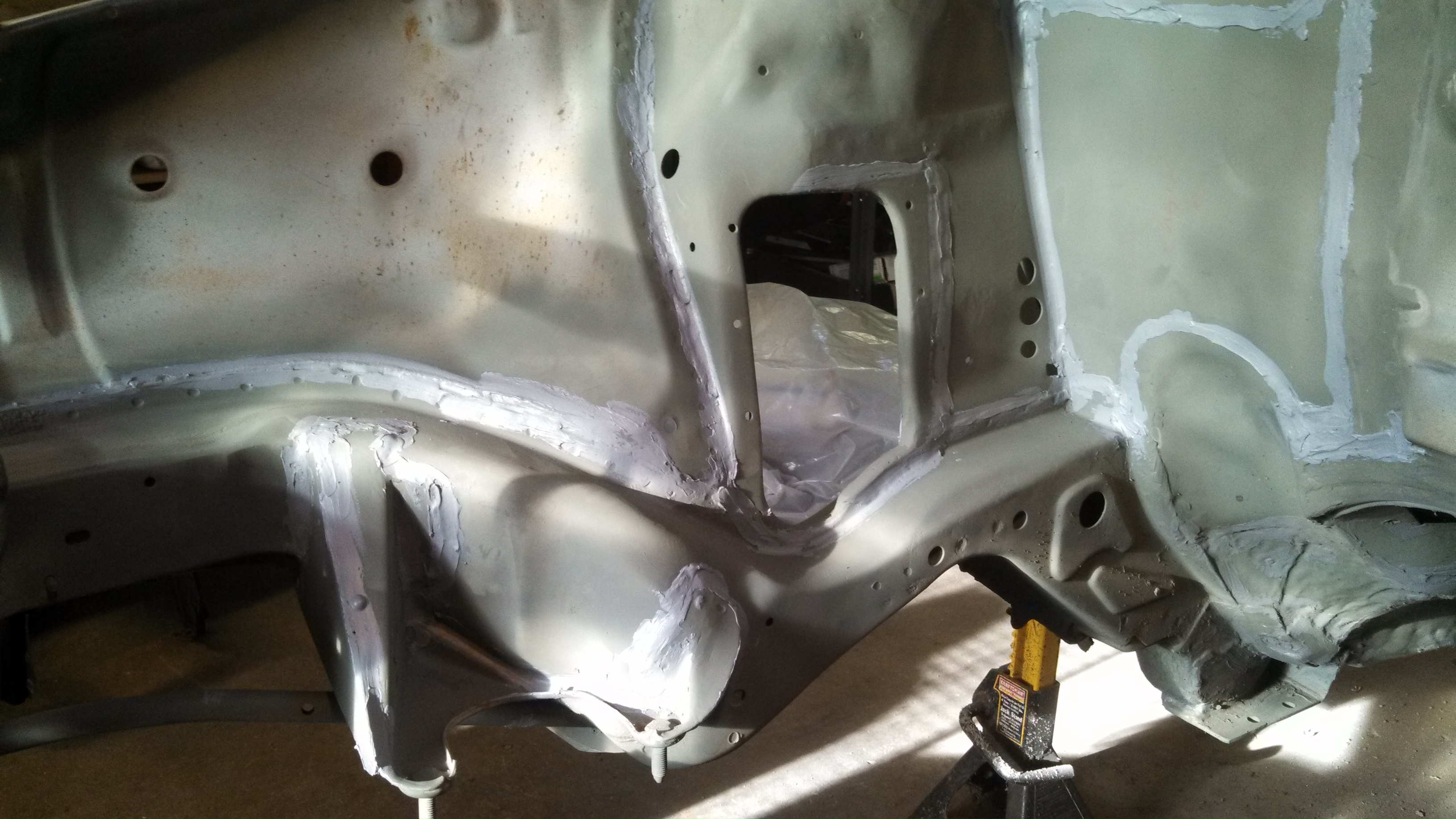

Fully seam sealed engine bay
seamsealed engine bay.jpg (1.41 MiB) Viewed 47084 times

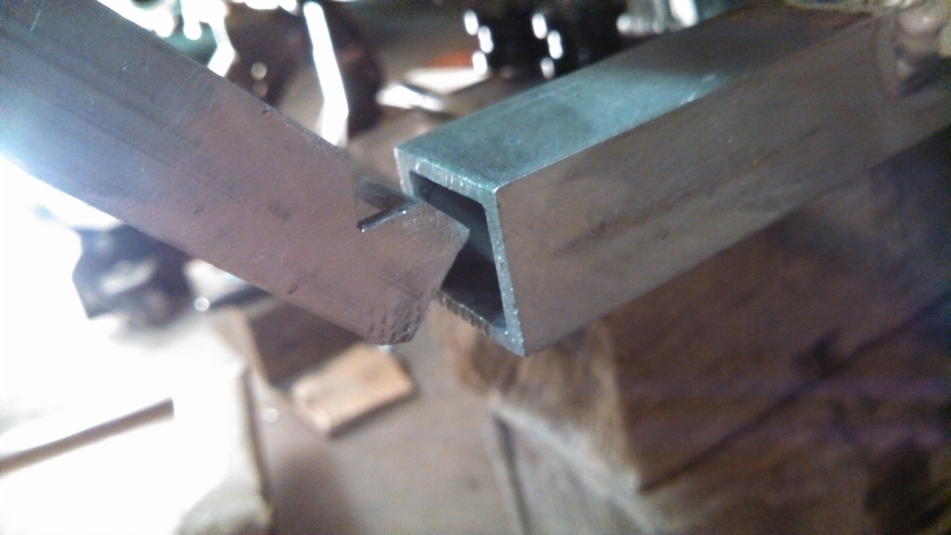

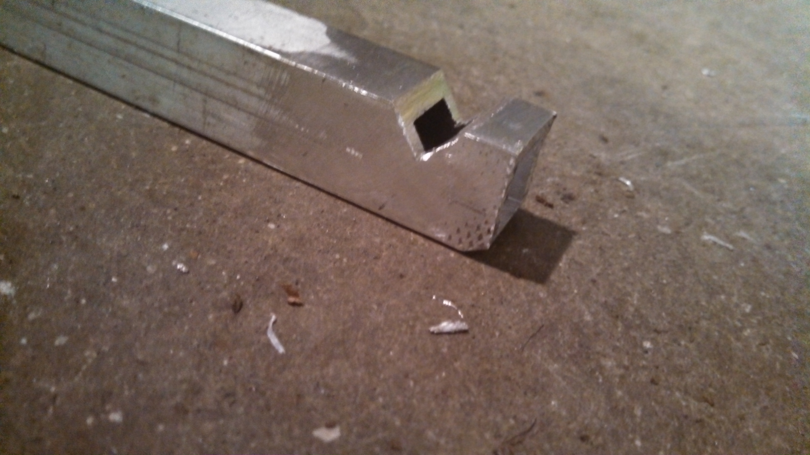

I had finished the front portion of the rad/ic support, but the lower bar still needed its vertical supports. Yes, there is room for the IC to slide in and out.
Here is the passenger side. The one piece of box tubing is relieved, and allowed to slide into the other like a puzzle piece. It is then seam welded around. See pics
front xmember support jigsaw detail.jpg (1.24 MiB) Viewed 47090 times
front xmember support jigsaw detail2.jpg (1.15 MiB) Viewed 47090 times
front xmember support jigsaw detail3.jpg (1.15 MiB) Viewed 47090 times

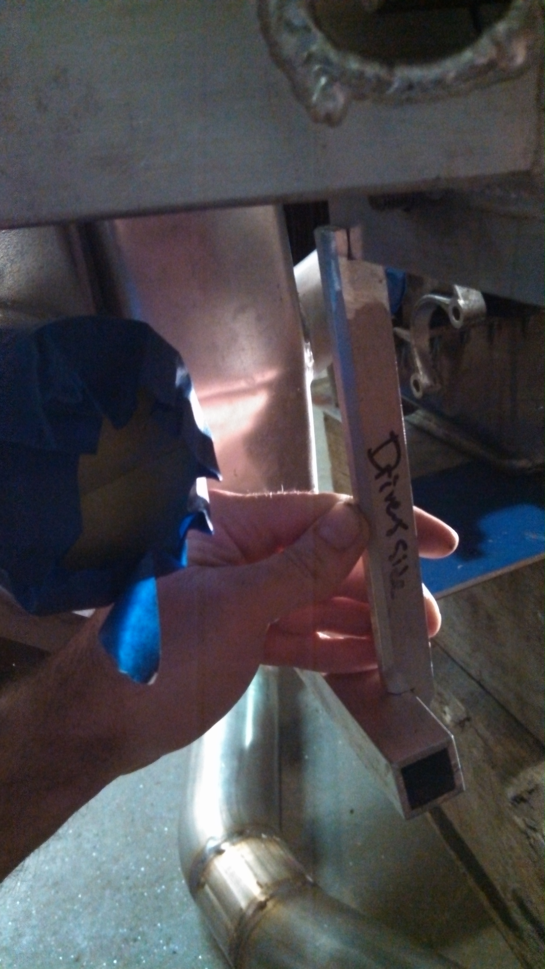

I also got some more time to work on the tubular sub-frames. Here are two more transverse pieces tacked together. The removable rear and the front of the front subframe where it goes under the t-reg oil pan.
subframe pieces tacked.jpg (1.49 MiB) Viewed 47089 times

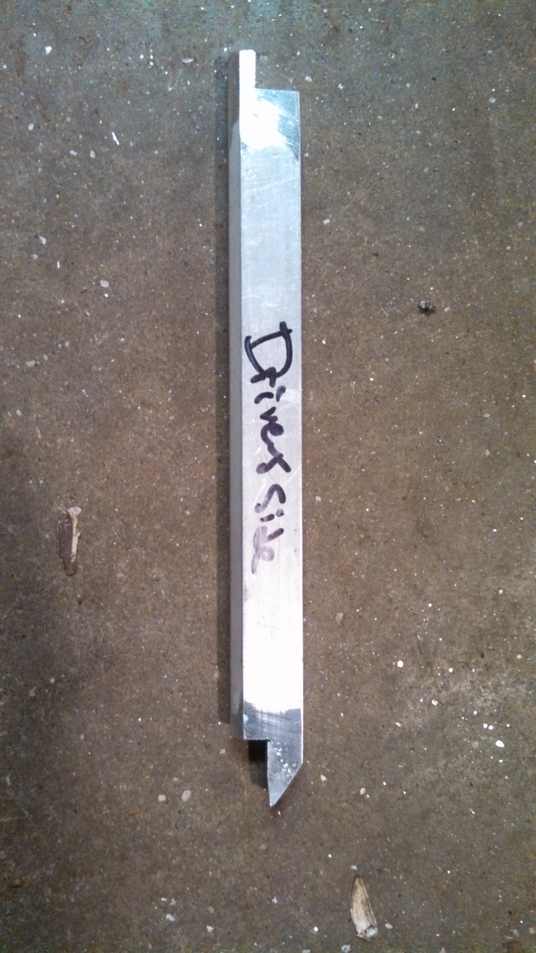

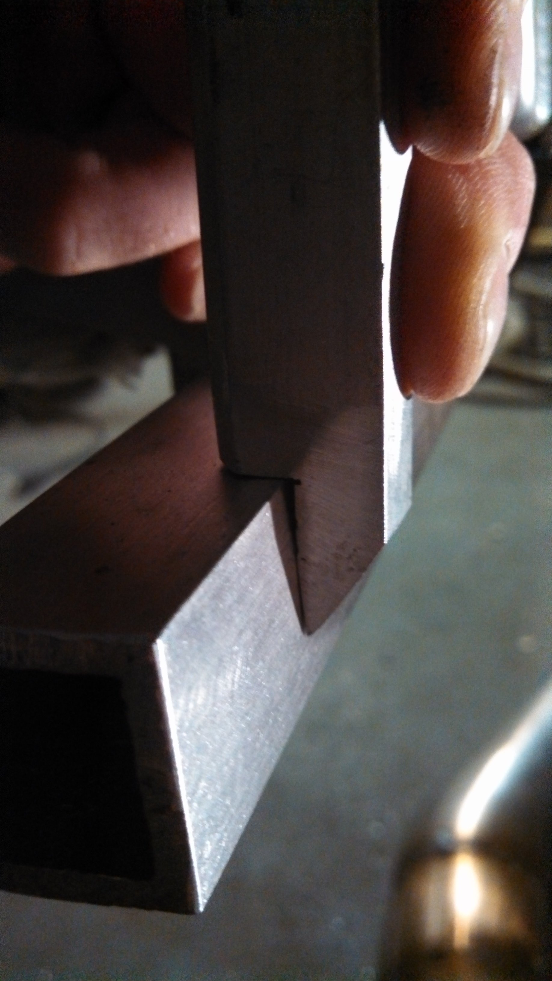

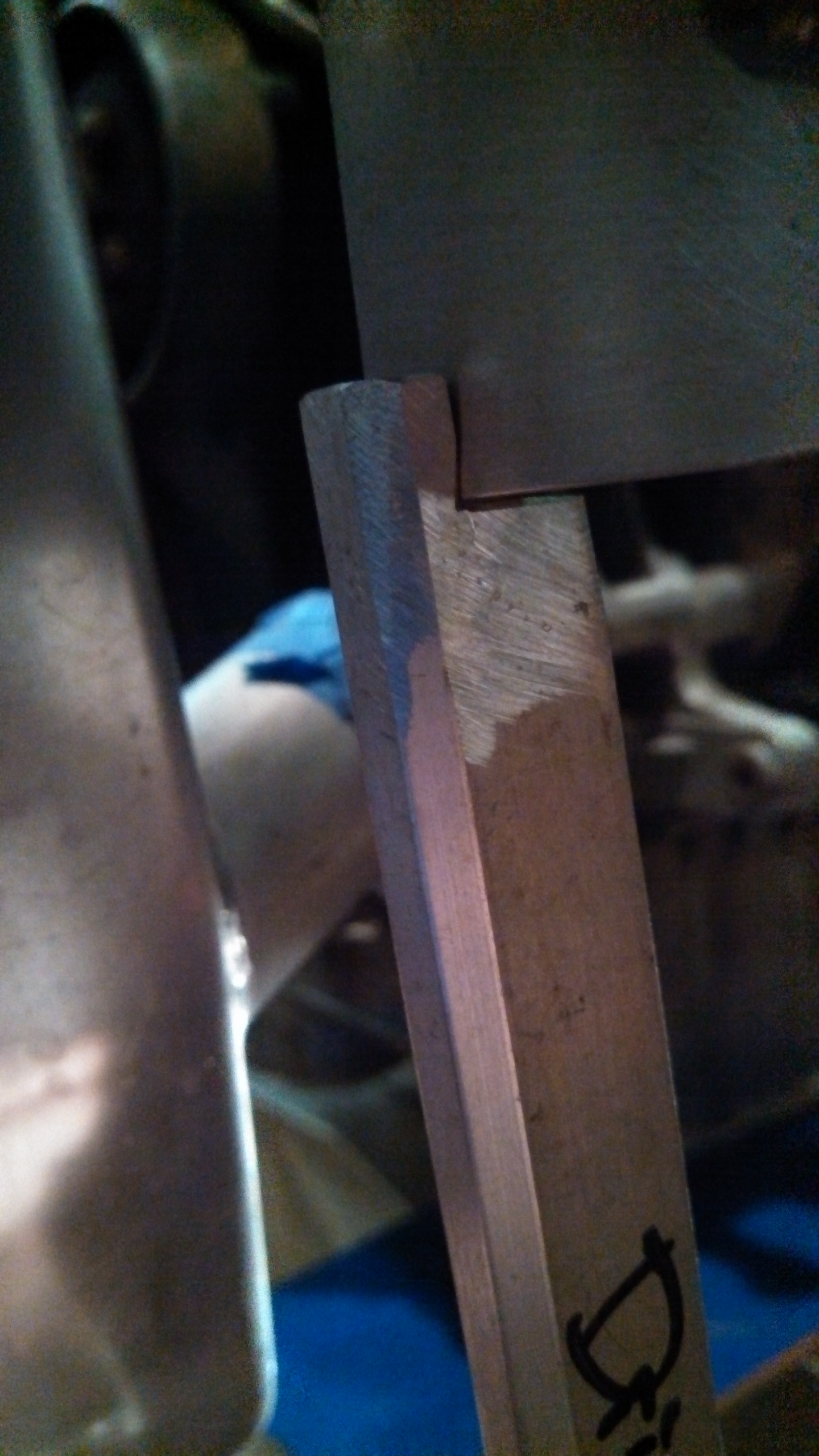

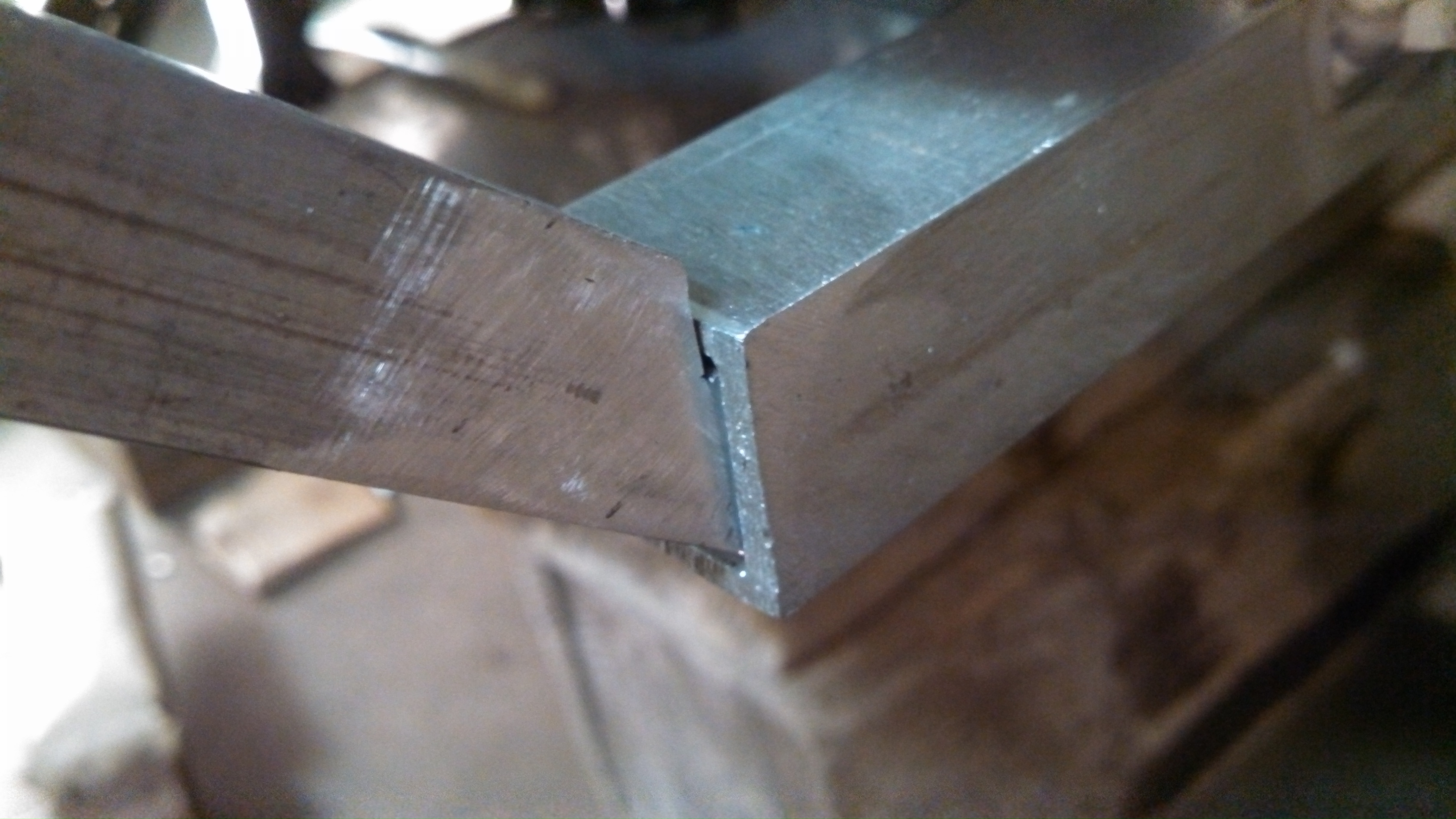

The rear subframe will not be open like an oem subframe but have a removable front crossmember. It is removable so I can switch differentials without dropping the subframe and still have a much stiffer stronger setup. Maybe overkill, buts its done now so I’ll run it.
Here they are tacked on
rear sf removable member ends tacked.jpg (1.26 MiB) Viewed 47089 times
rear sf removable member ends tacked2.jpg (1.29 MiB) Viewed 47089 times
Here they are welded up
rear sf removable member ends welded.jpg (1.44 MiB) Viewed 47089 times
rear sf removable member ends welded2.jpg (1.35 MiB) Viewed 47089 times

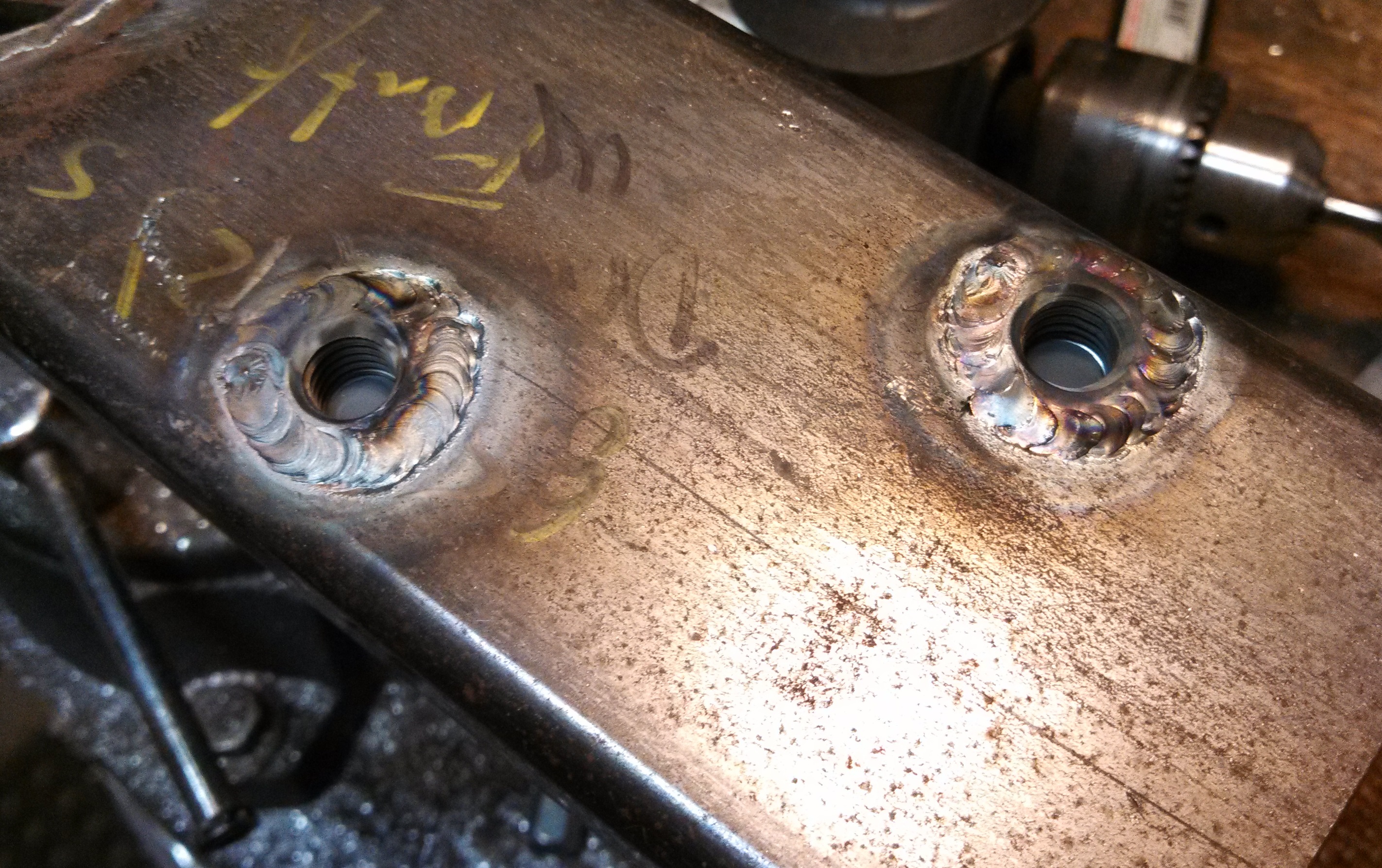

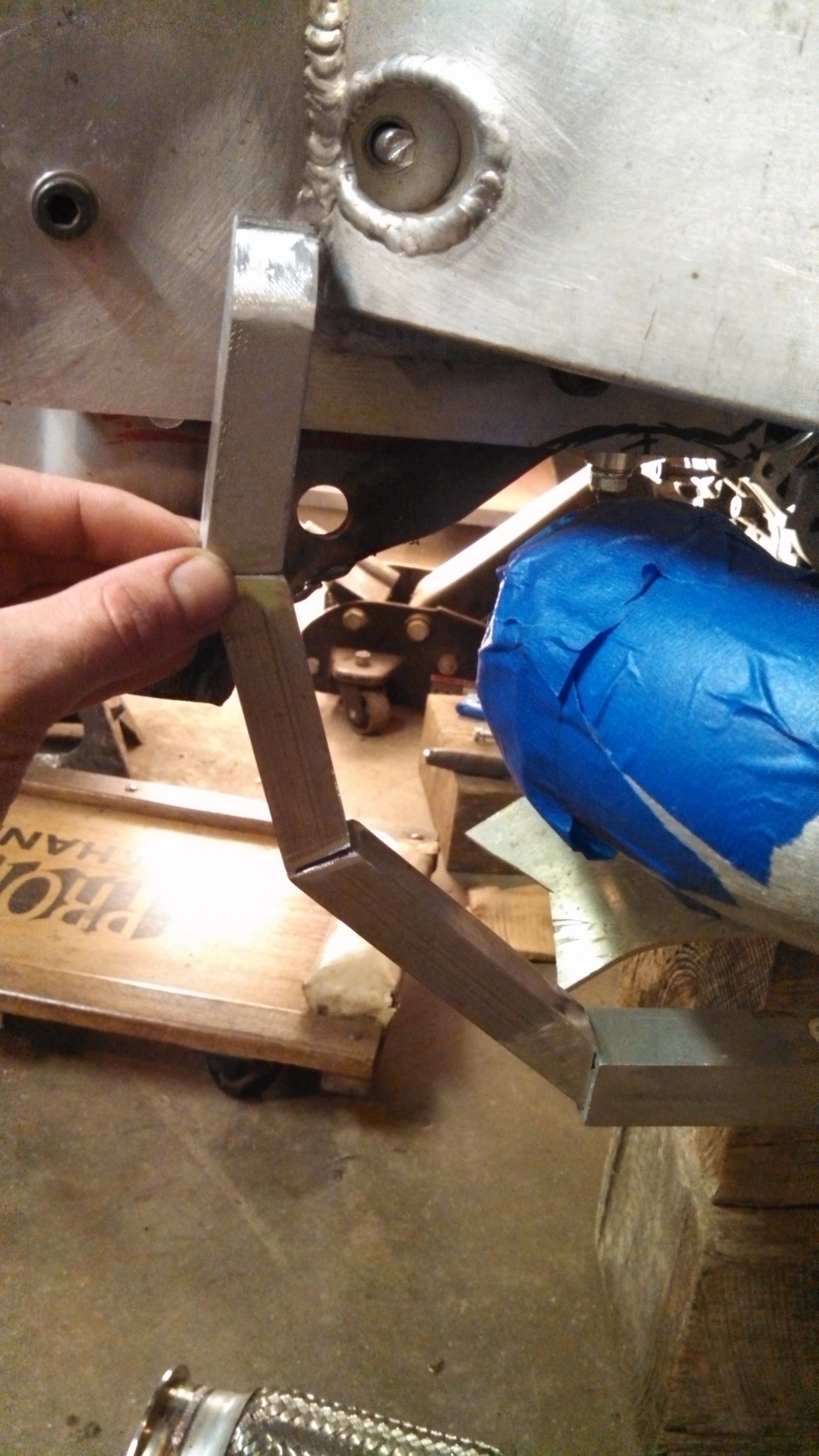

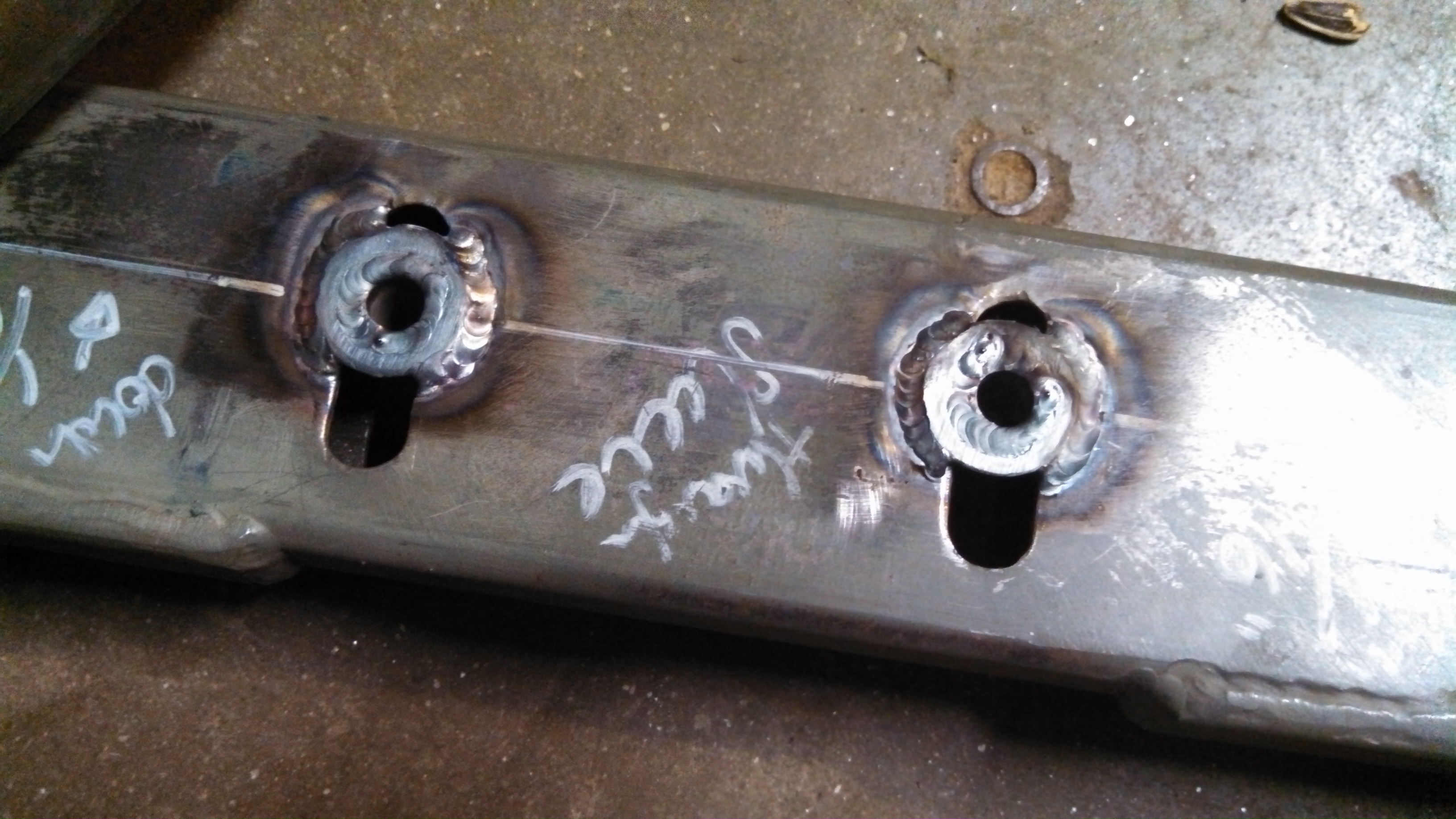

And here is the rear removable member again. Its attached via 2 m10’s. there is a m10 coupler nut welded in the 1x3” tube in compression. The mounting flange side is a 10.2mm hole for the coupler nut to butt up against and the backside is seam welded to the upper part of the 1x3” tube.
Pics!
rear sf removable member holes done.jpg (1.84 MiB) Viewed 47089 times
rear sf removable member holes done2.jpg (1.58 MiB) Viewed 47089 times

Tim, why do seam sealer? Just for cosmetics?
loxxrider,
on the parts I seamwelded, its mostly there to fill any small pits etc, prob overkill, but its the only sound deadening ill have ahah
for the rest, its really there to prevent water penetration, but I also use it,(like on the rear strut tops in-cabin) to keep random dust.grit.metal shavings etc out of there, as it seems to accumulate rapidly in the fab shop

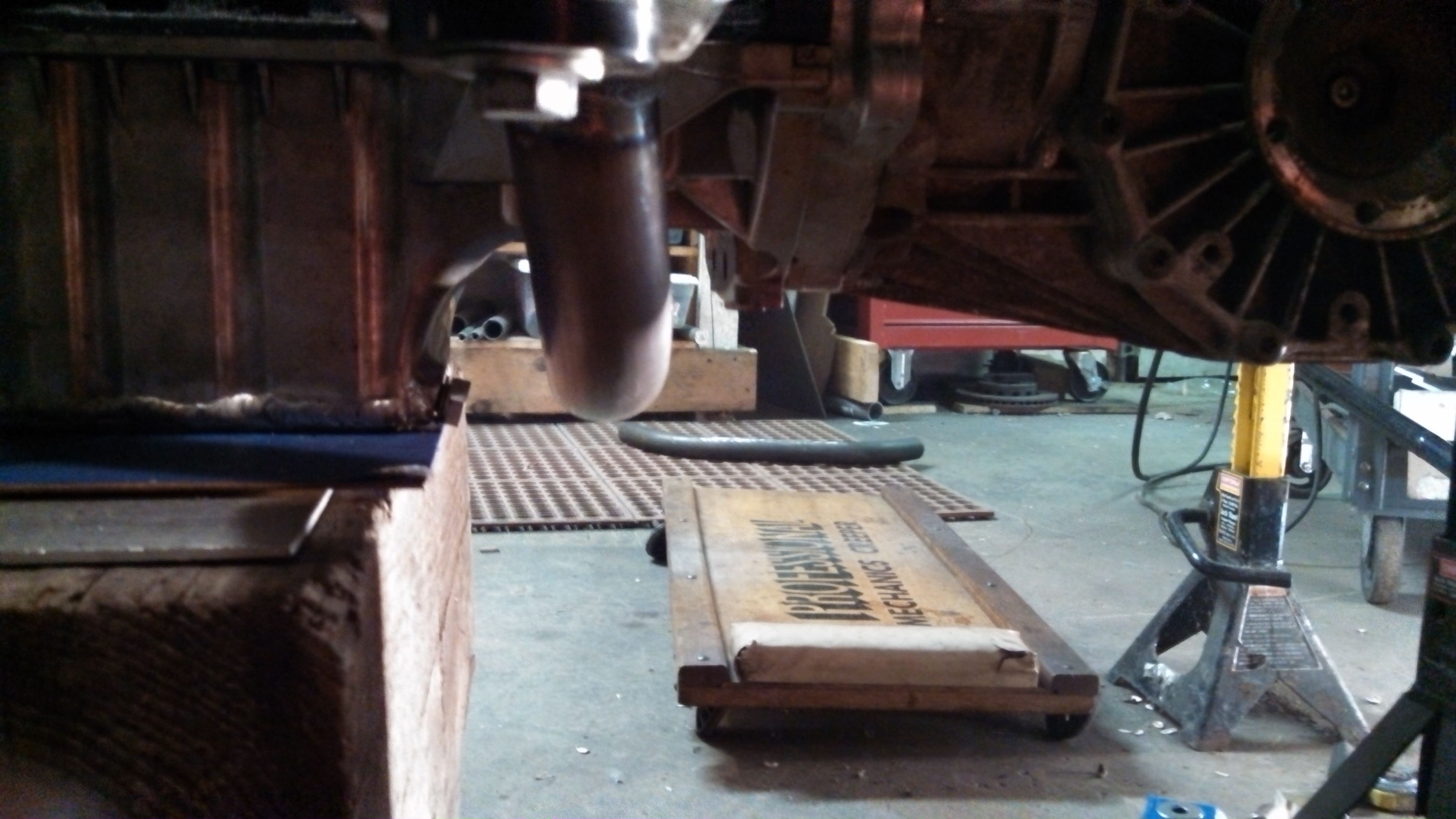

UPDATE!!!
Let’s get caught up. I’ve been working on the subframes and they are coming along nicely. The front is definitely more challenging to fabricate than the rear. The rear diff output cups are much more centered between the SF mounting points, so the c-arm mounts will be much easier to make. Then there is the front, with the engine/trans mounted lower and rearward. This puts the front output cups much further rearward and it’ll just be more difficult to make the front c-arm mounting tabs.
Here is the front transverse member of the front subframe, finished welded and reinstalled.
front sf front transverse member.jpg (1.2 MiB) Viewed 46985 times
front sf front transverse member2.jpg (1.19 MiB) Viewed 46985 times

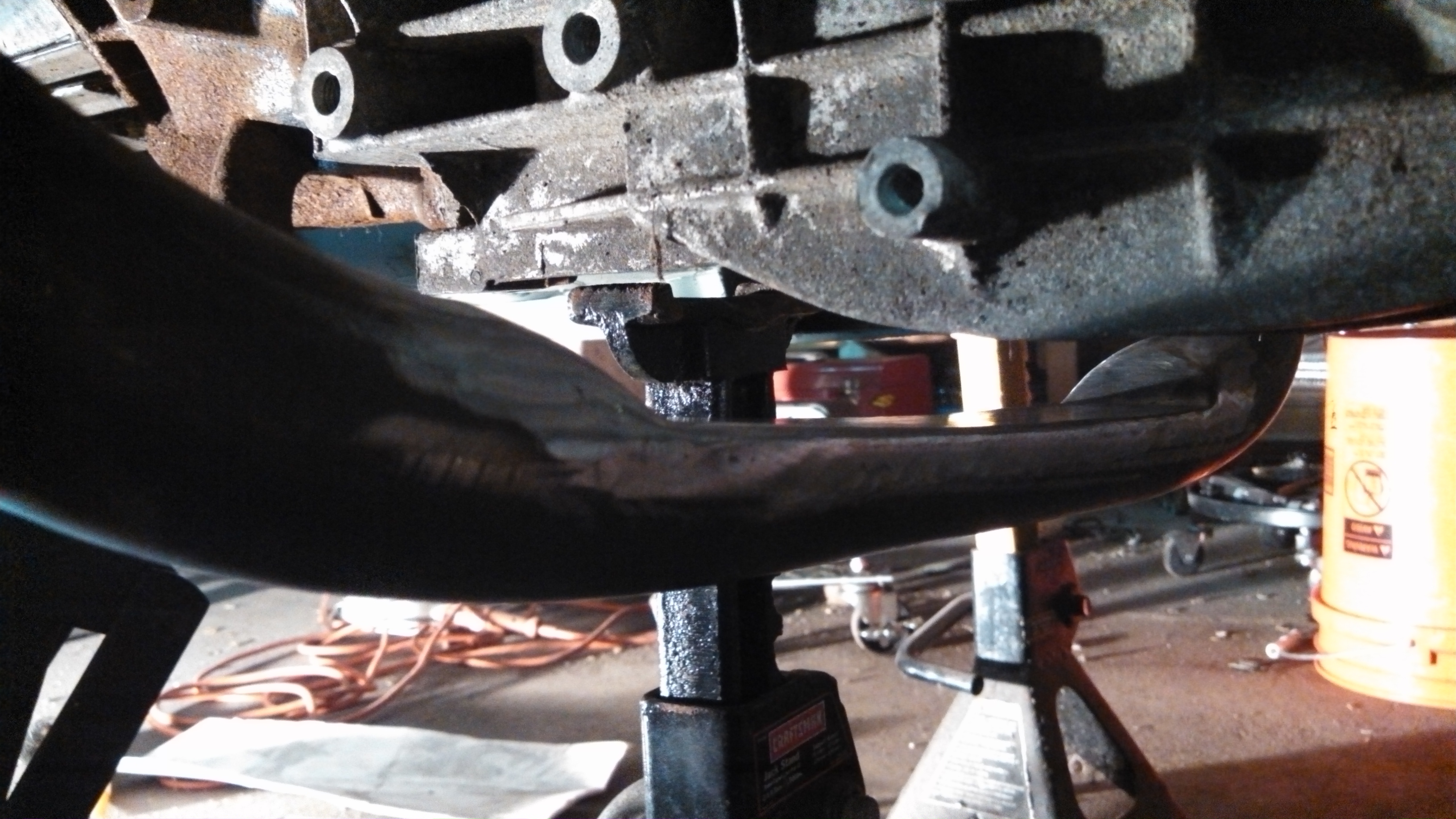

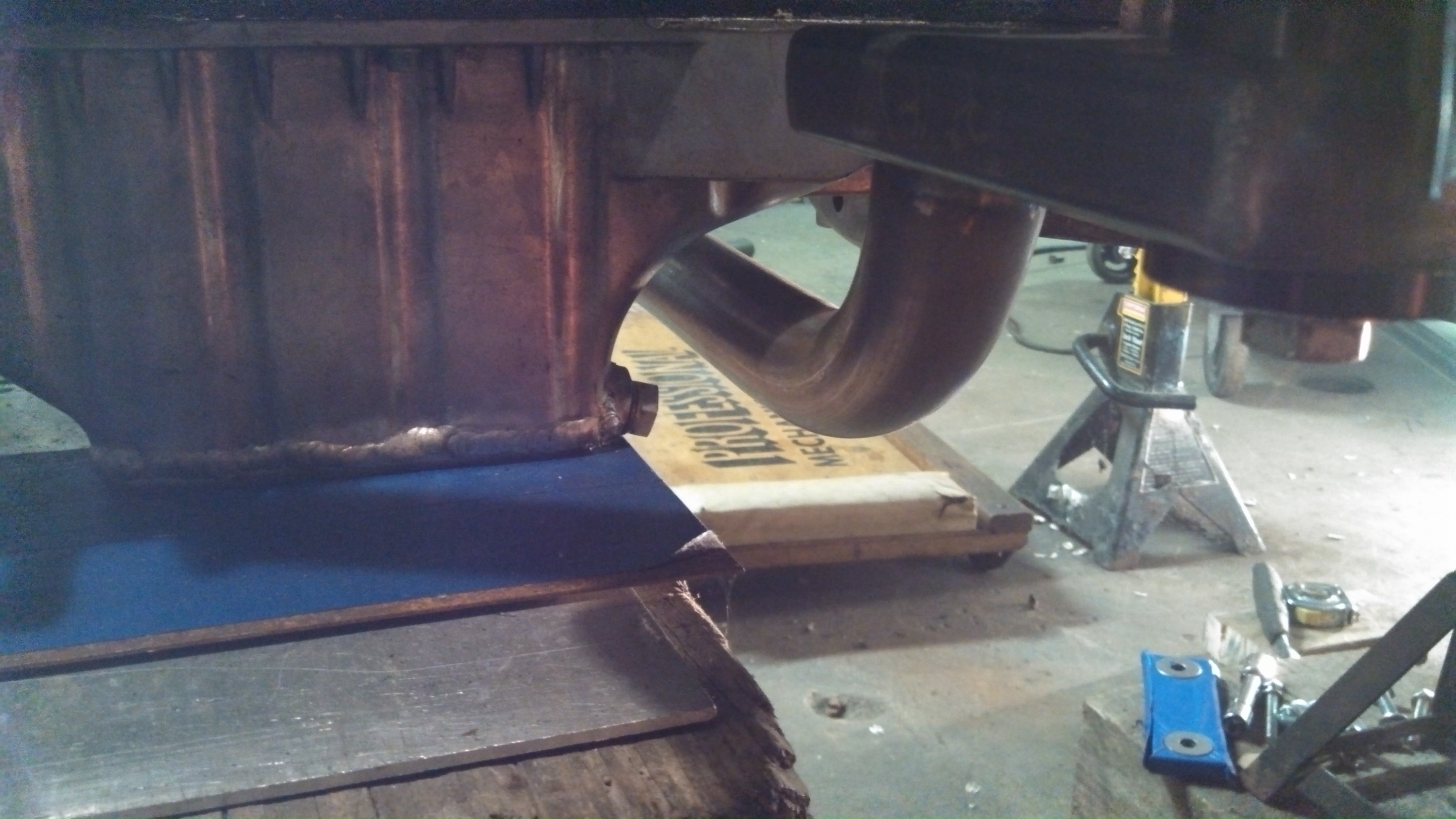

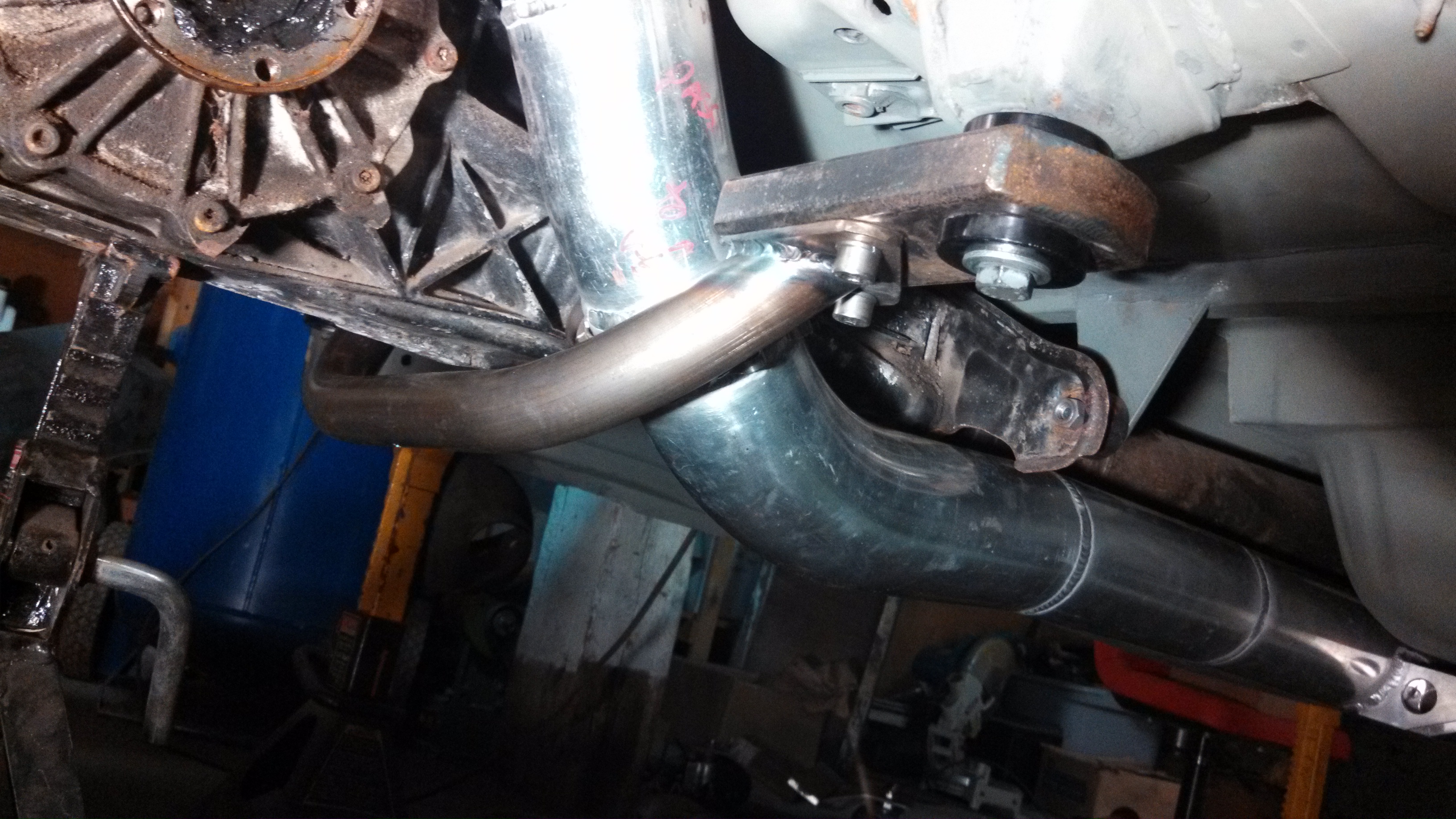

And here is the tranverse member that will go under the bellhousing. The trans is mounted pretty low, so I relieved the tubing and used a thick plate and some endcaps, welded it up and flappered it reasonably smooth. I’m just holding it in the pic, and might trim the bottom of the bellhousing fins down a bit.
front sf under trans relief.jpg (1.5 MiB) Viewed 46985 times
front sf under trans relief to be mounted.jpg (1.41 MiB) Viewed 46985 times
And lastly a pic of the top of the coupler nuts that were trimmed and welded into the rear subframe to mount the removable piece.
rear sf removable nuts welded.jpg (1.83 MiB) Viewed 46985 times
