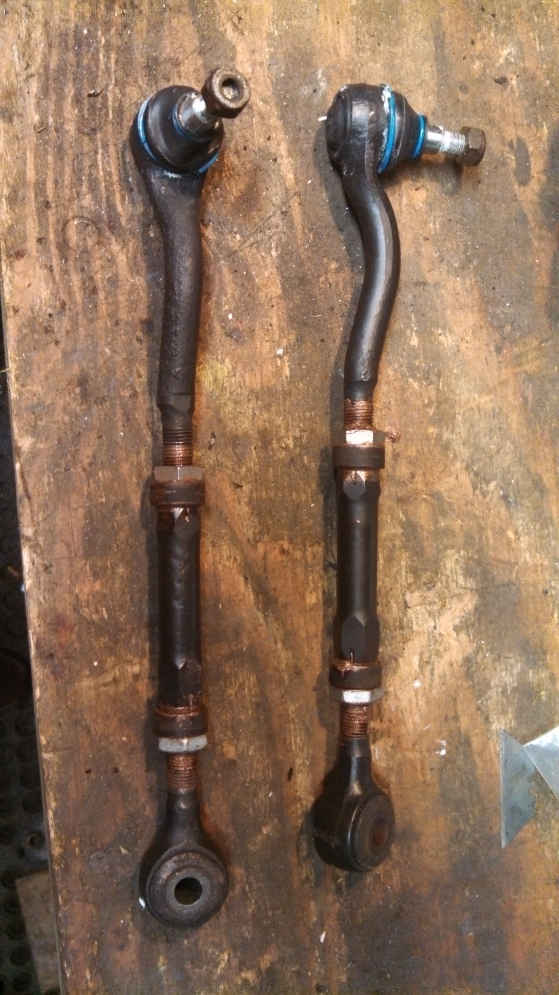

I also got my front tie rods rebuilt with new adjuster barrels and coated hardware, thanks Kev, (Bambridge) on S2 forum. And they look great, as well as being adjustable now ahhaha

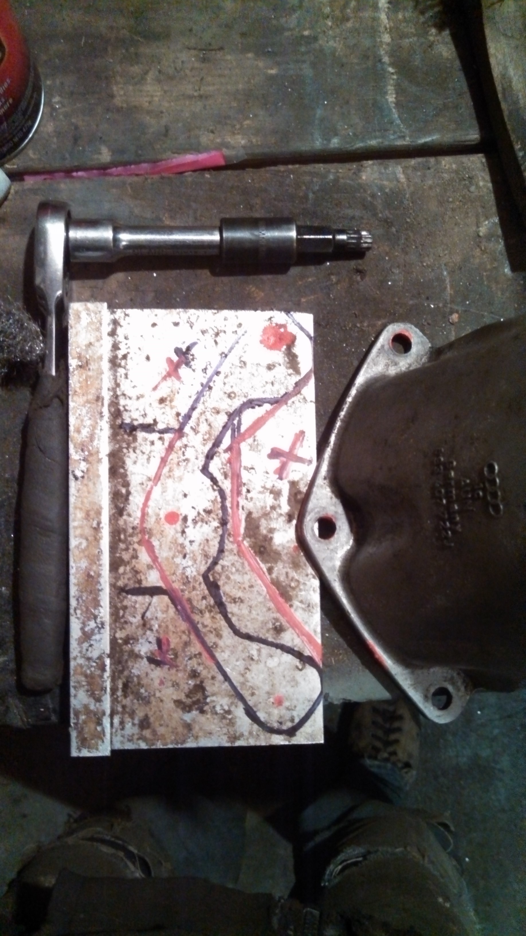

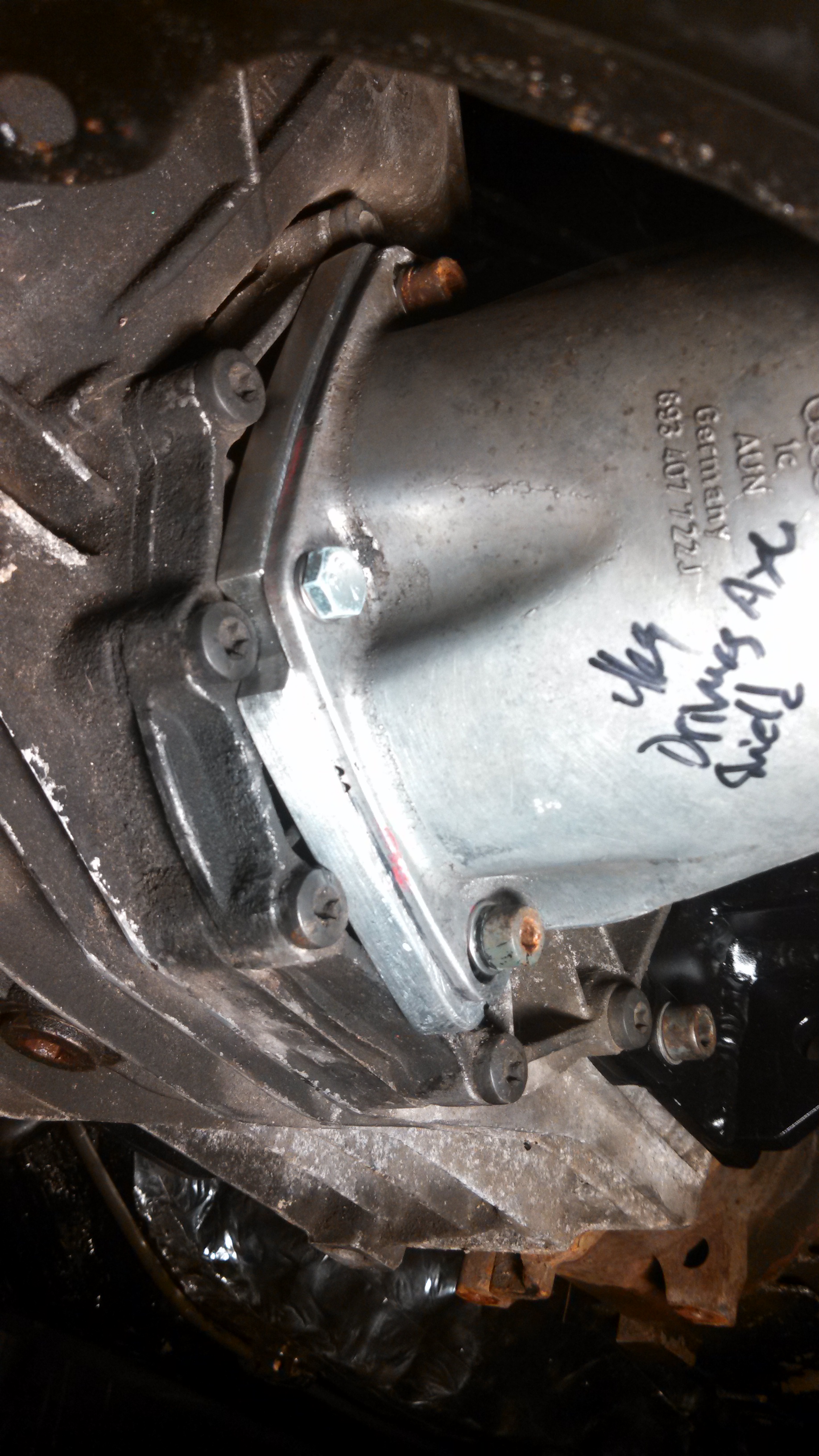

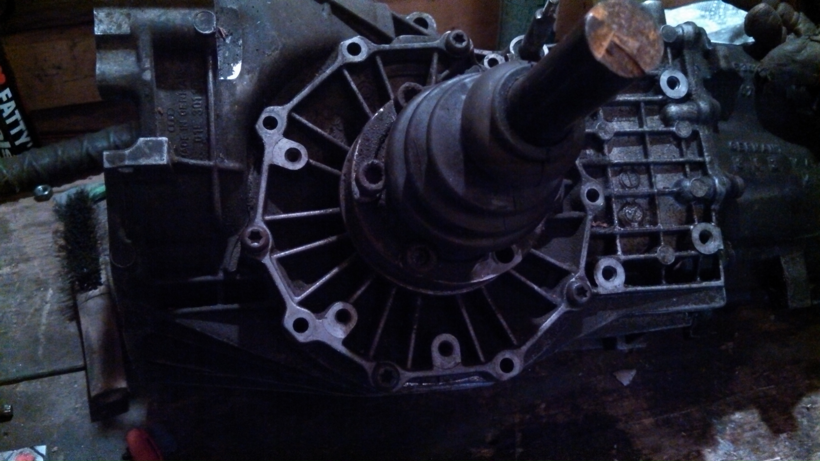

O1E time, fluids, seals, 4kq output cups and a custom center locker.
I got it up on the bench, drained the fluid, and popped the rear end cap to get the center diff out. Its actually a very easy swap, off with the back cover, center diff slides out, slide other center diff in and close er up. DONE
Custom center locker next to unmodded o1e center diff
It should have no problem staying “locked” after three passes with a 350A three phase mega-welder.
Also swapped out the 108mm output cups for the 100mm 4kq units. Also replaced the output cups seals 016 409 399A

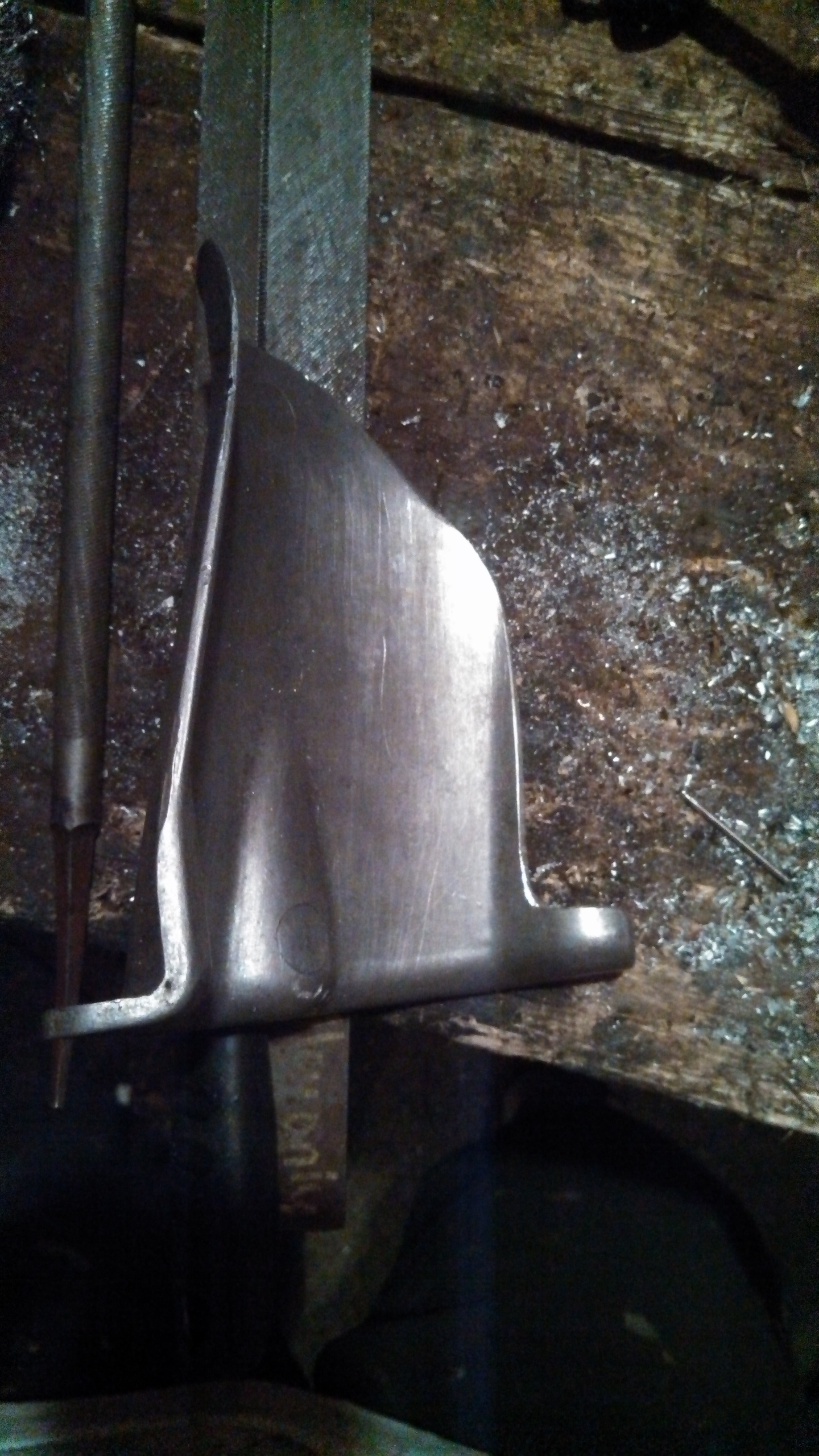

I’m going to be using qty 2, oem 4kq rad shroud flaps, going to mount them sideways on my front mount radiator shroud I made up. They should fit quite nicely.

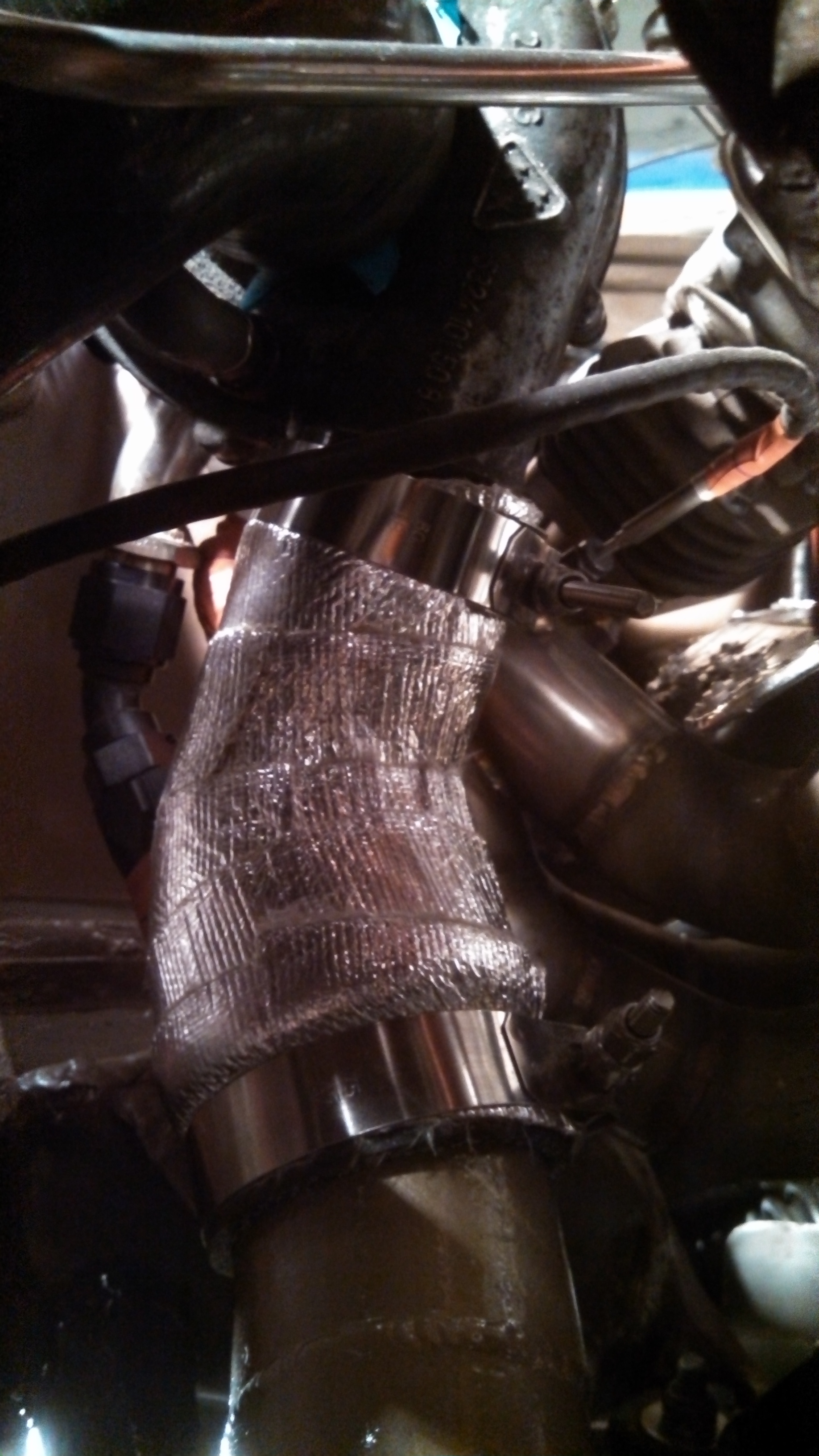

I decided that I should heat shield the passenger side engine mount as its pretty close to the exhaust manifold. I used alu/fiber backed tape all the way around and 2 small 1/8” rivets to hold it in place and keep it from peeling back.

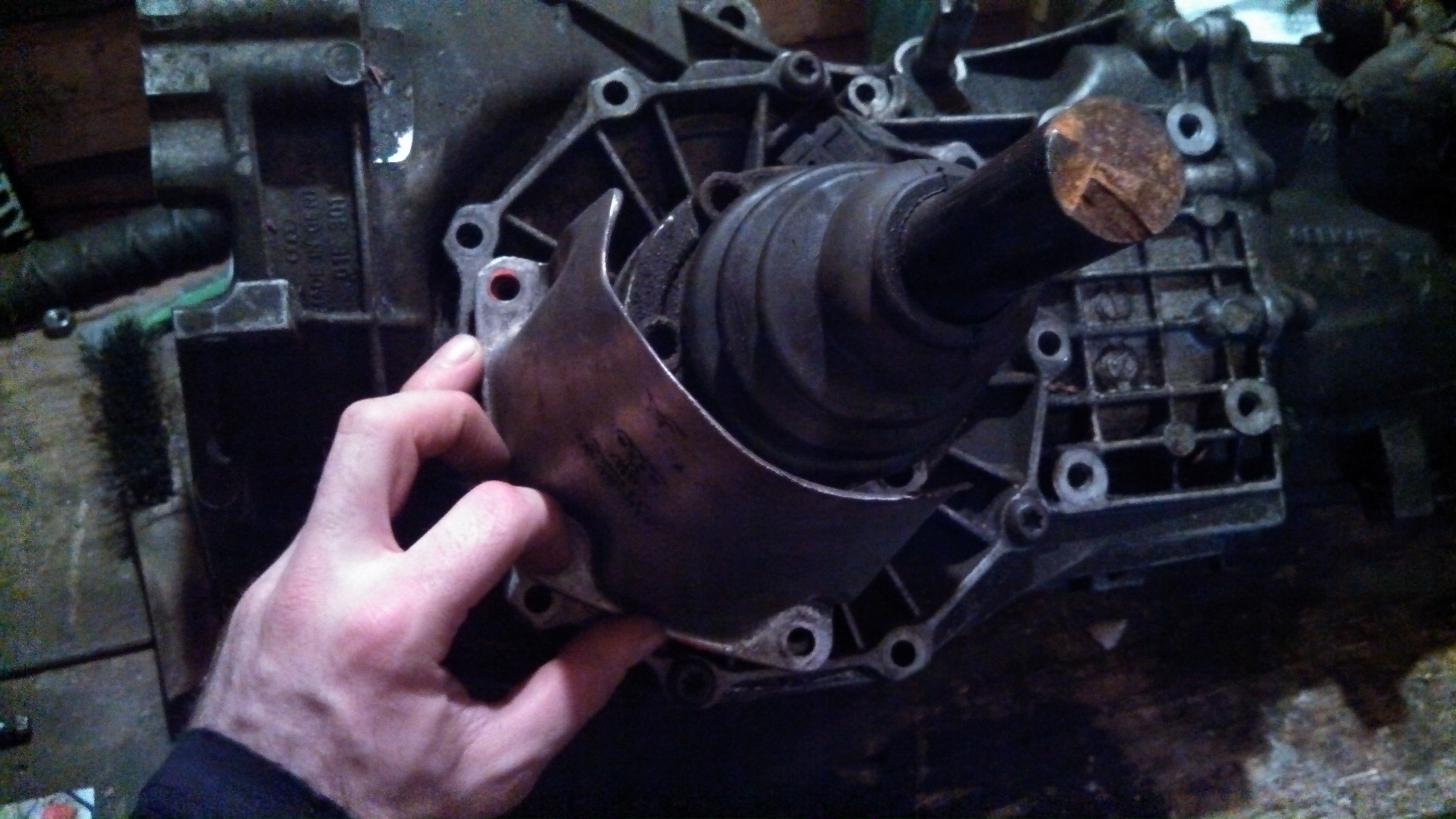

The clutch, pilot bearing, throw out bearing and bell housing shield all in place and mounted up.

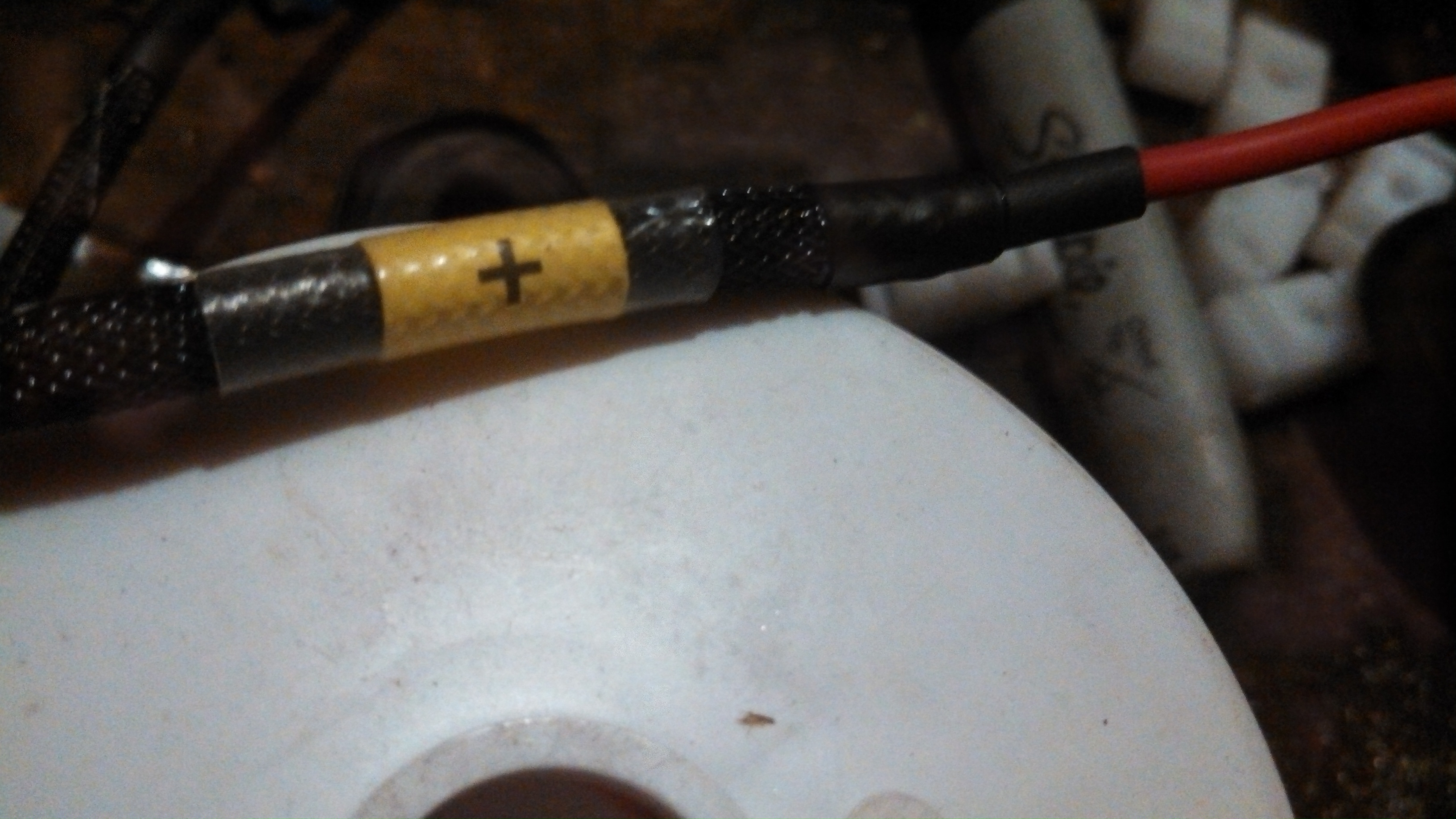

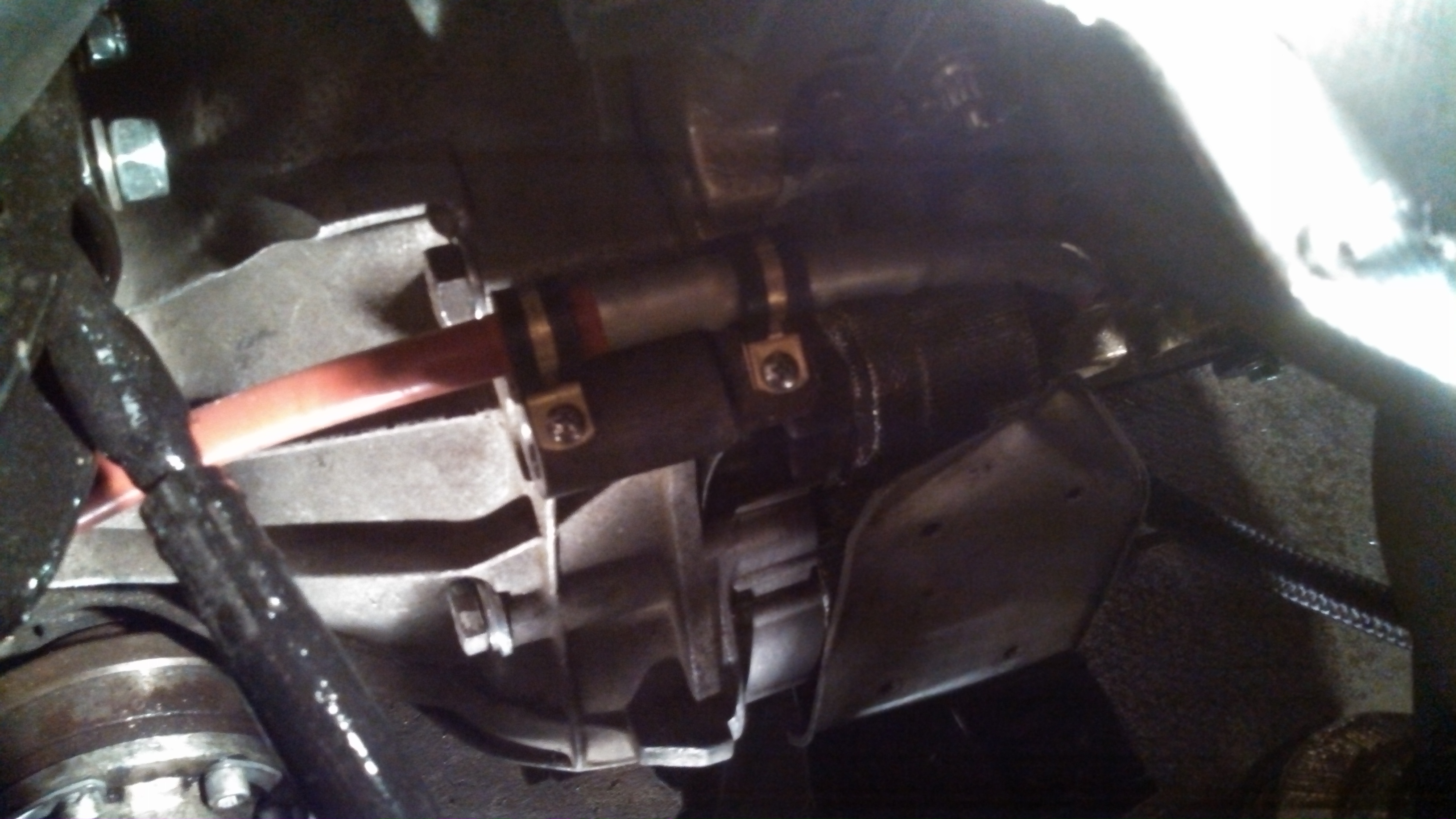

I wrapped up the starter in heat shielding, and got it mounted up to the trans and engine.

I also marked and cut out the holes for the shroud flappers, one side done, one to go.

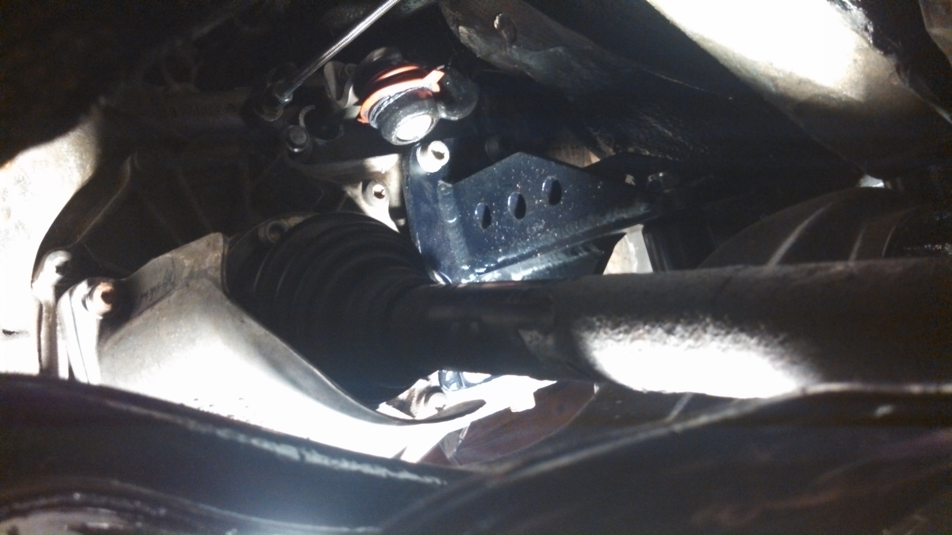

I also made up some very “new England” ABS sensor plugs to keep grime out until I utilize wheel speed / ecu functions. Made out of some hardwood dowel, with a pilot and set screw. All stainless hardware yay

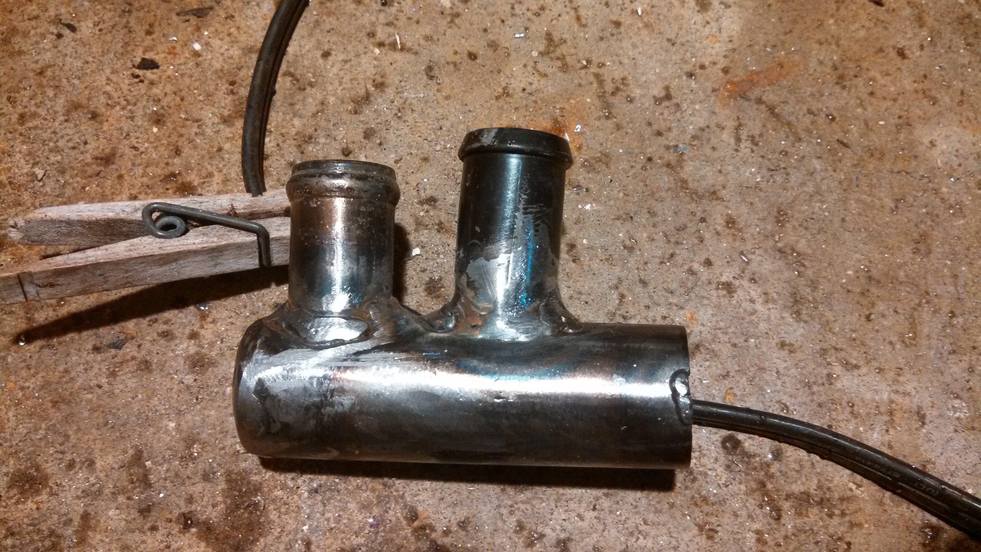

Im running a larger 2.7t aux water pump, the 16v/aba combo, longitudinally mounted etc. most of the coolant hoses needed to be modified for everything to fit well.

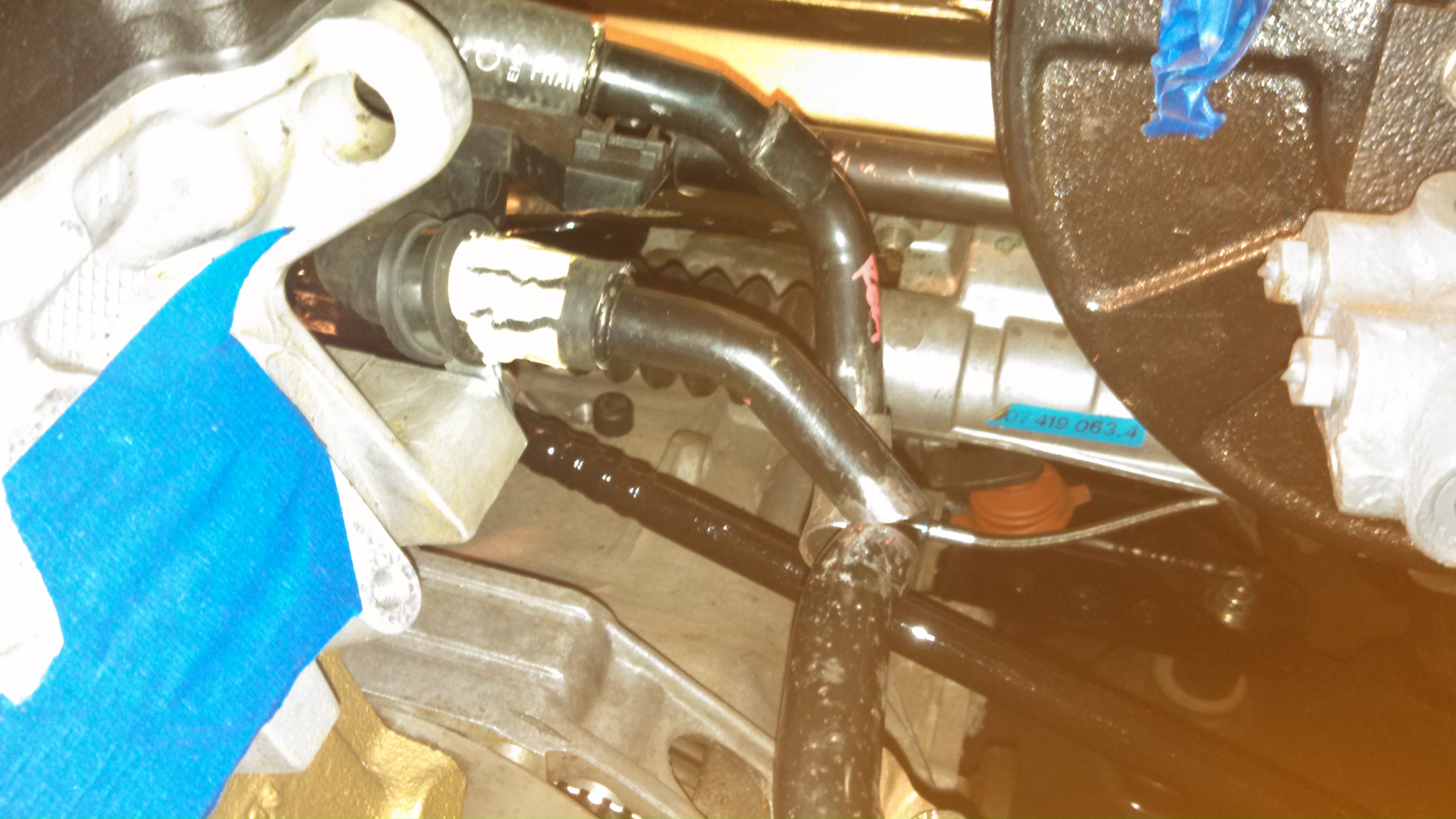

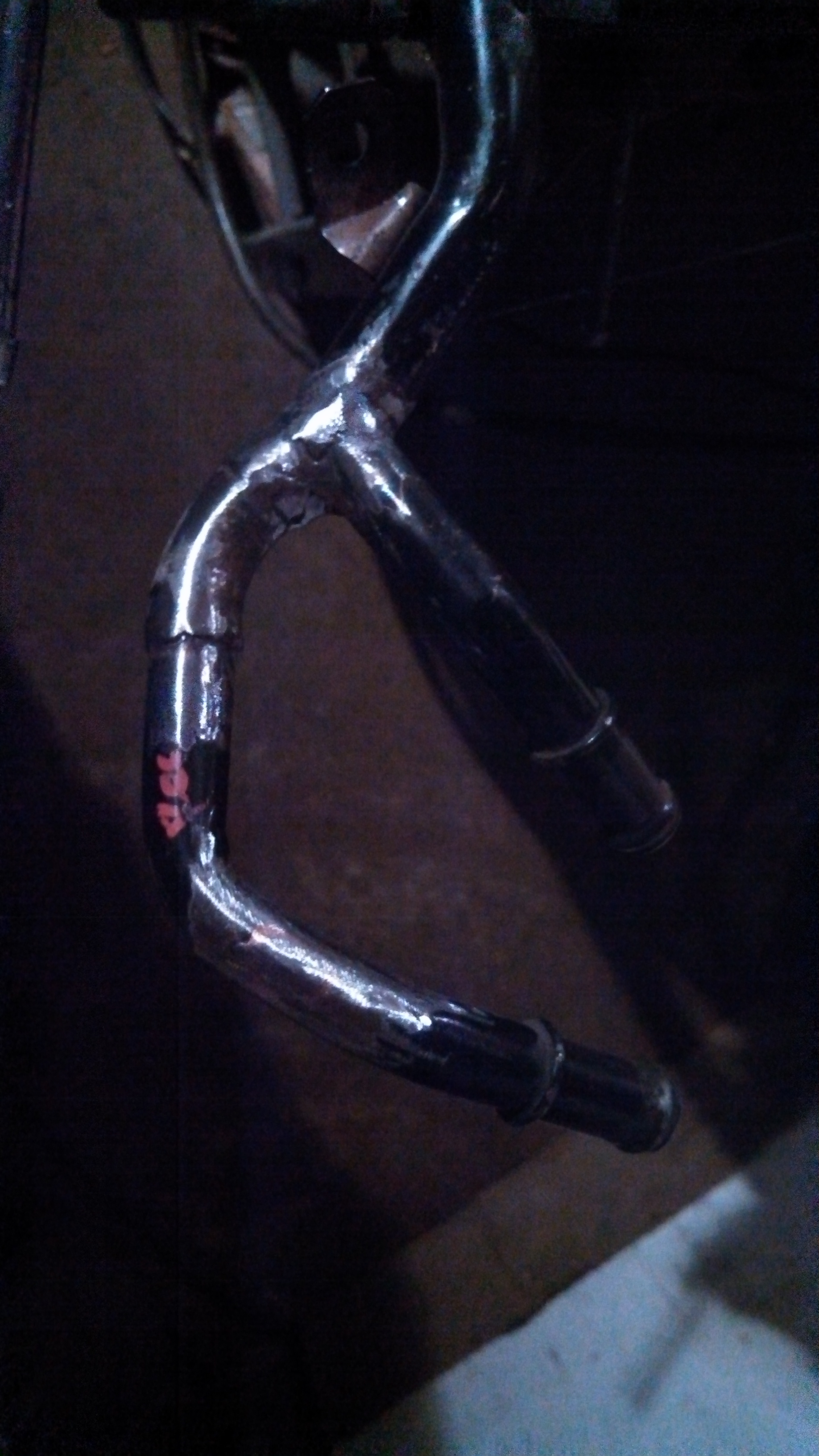

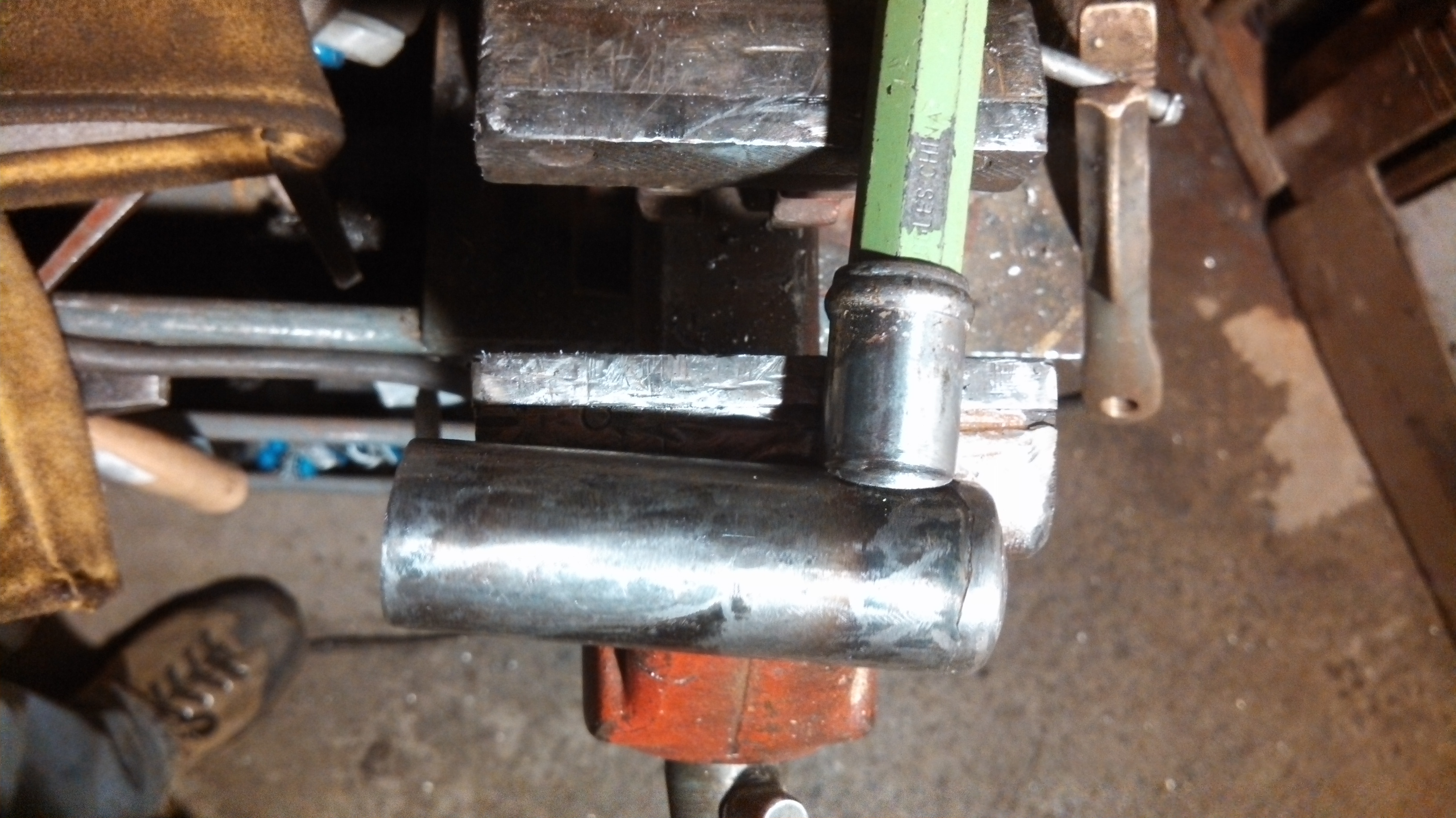

The small F hose out of the water pump was plastic oem shite, so I made one out of 16 ga. Steel and tached on a few small beads to help keep the hoses on.
F hose in progress.jpg (1.55 MiB) Viewed 36163 times
new F hose.jpg (1.71 MiB) Viewed 36163 times
The other larger coolant hose is an AEB unit modified to fit the 16v head outlet.
coolant hardline mockup.jpg (1.26 MiB) Viewed 36163 times
coolant hardline welded.jpg (1.09 MiB) Viewed 36163 times
coolant hardline welded, rear head.jpg (1.13 MiB) Viewed 36163 times

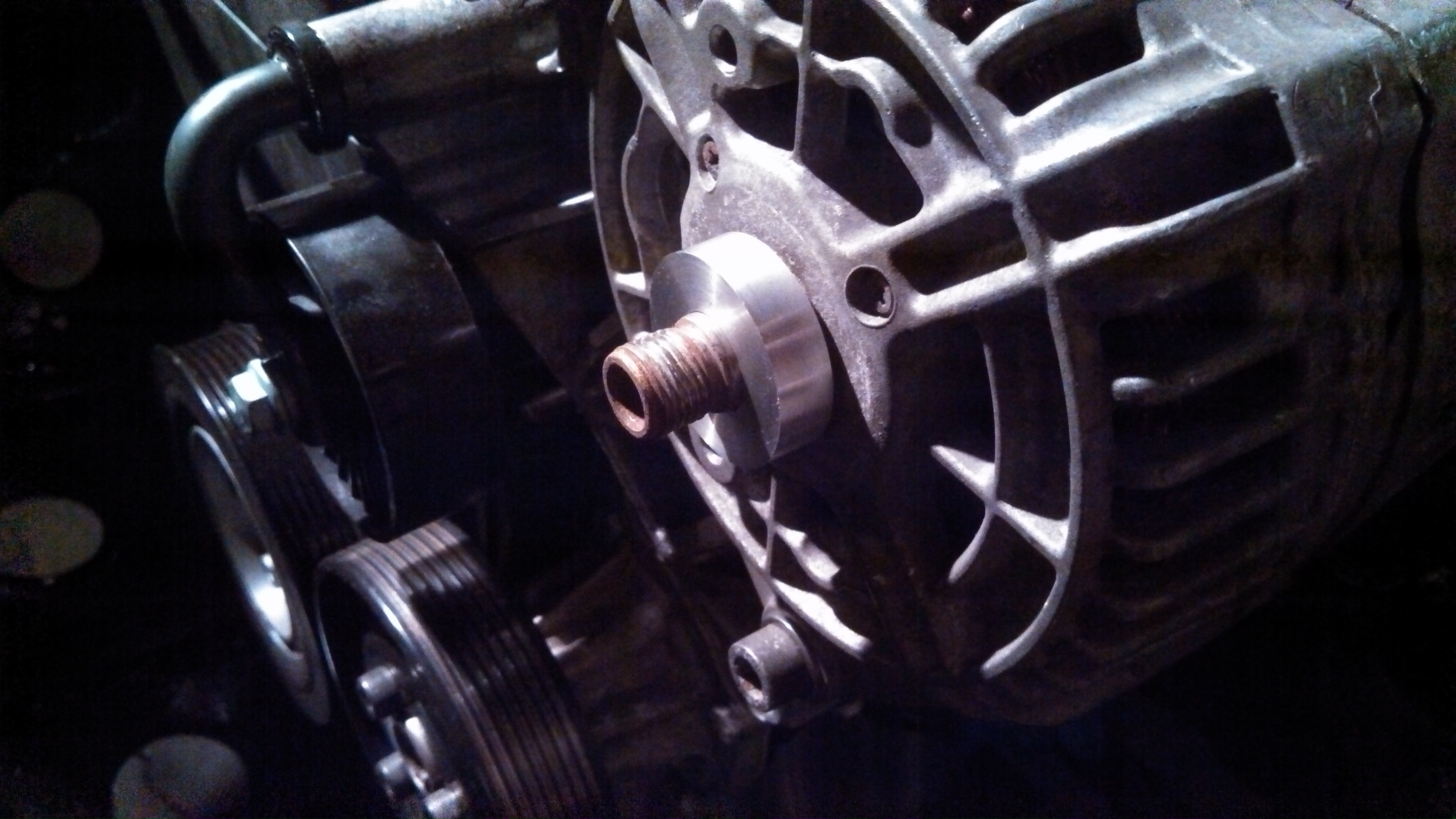

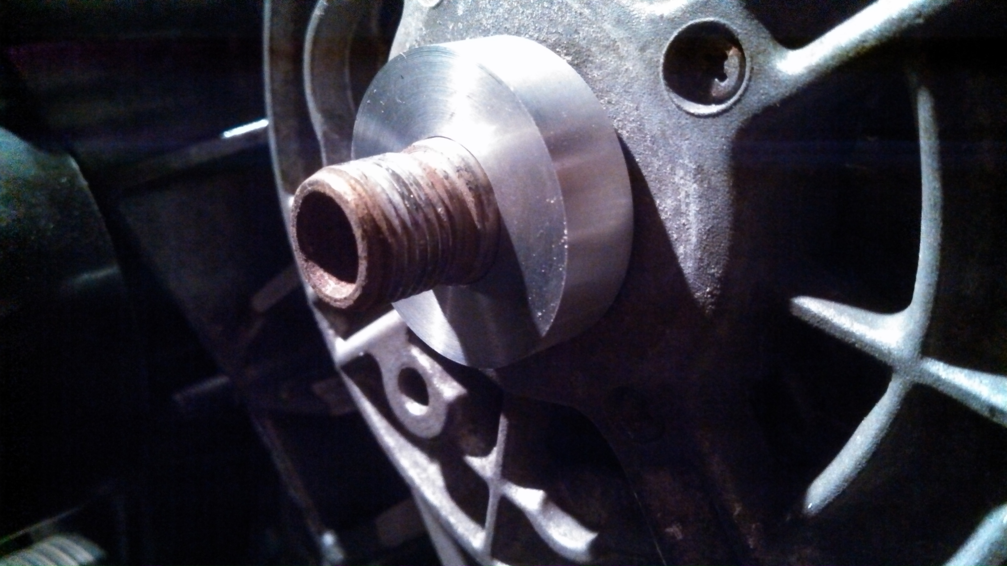

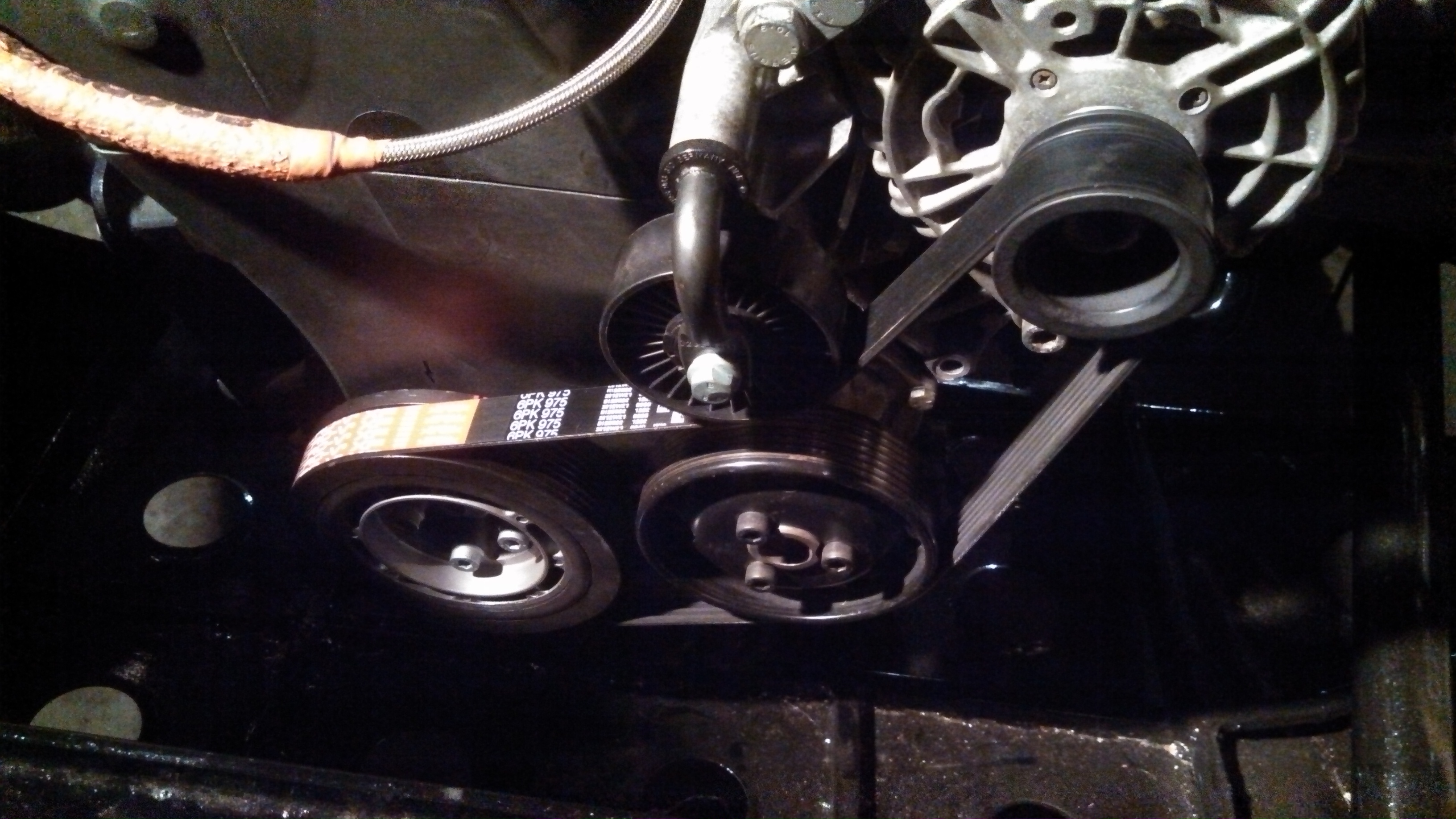

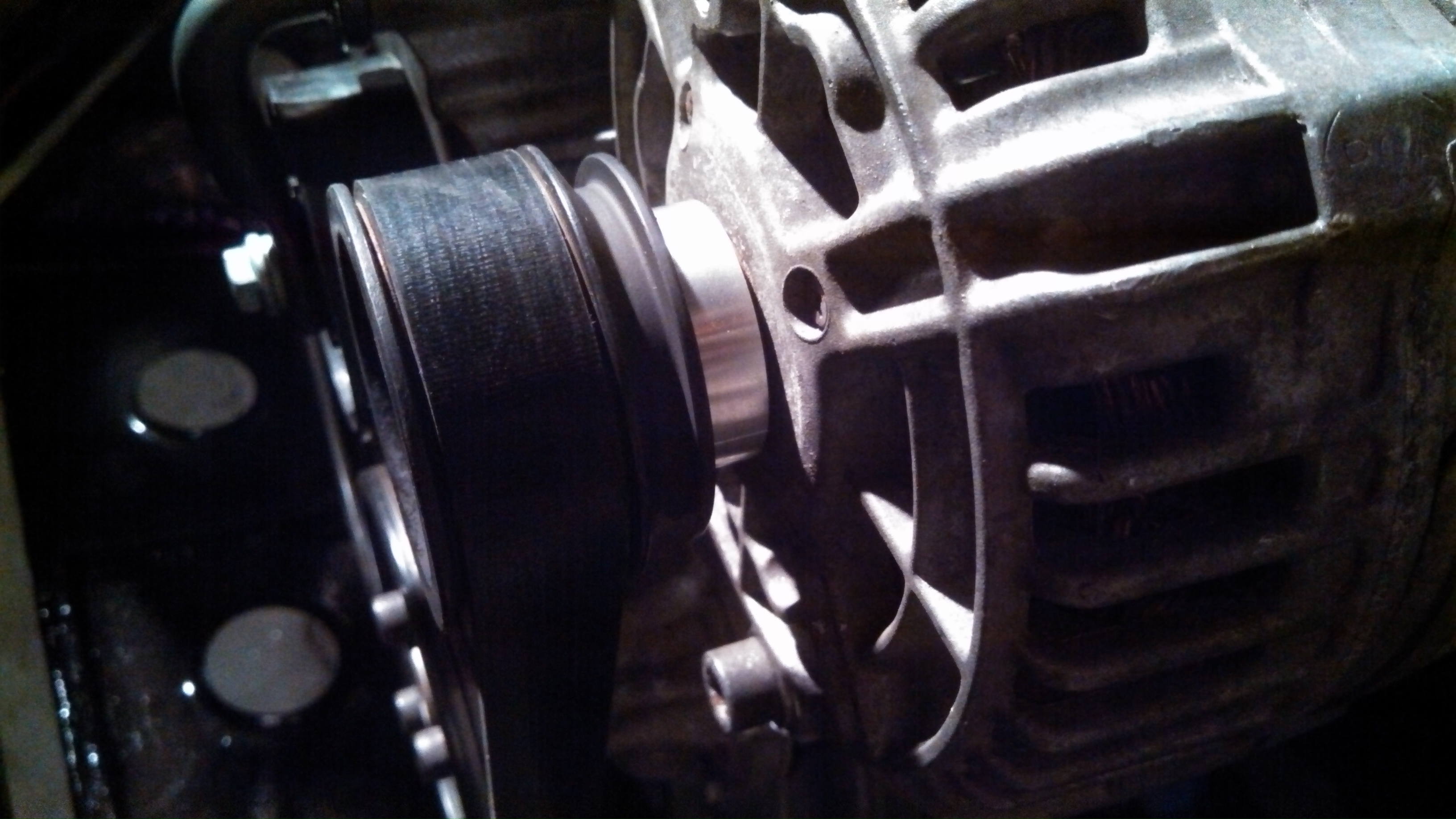

I also finally got around to making the spacer for the ABZ alternator mounted on the ABA oem bracket/tensioner. Its about 9mm thick and, 0.009” oversized vs the alt. shaft, so it fits pretty well.
Here it is
alt pulley spacer.jpg (1.22 MiB) Viewed 36164 times
alt pulley spacer upclose.jpg (1.19 MiB) Viewed 36164 times
And how ironically the 6 rib serp belt I need, 975mm is not available in the USA!!! WTF!!! It’s a basic length 6 rib!!! Im sure I could have found something a tad shorter or longer, but 975 is perfect, oh and its from a ABF haha lmao! A mk3, euro 16v talldeck hahaha
So here is the belt installed in its euro-only glory!
abf belt w spacer fits perfect.jpg (1.13 MiB) Viewed 36164 times
ABF serp belt installed.jpg (1.31 MiB) Viewed 36164 times

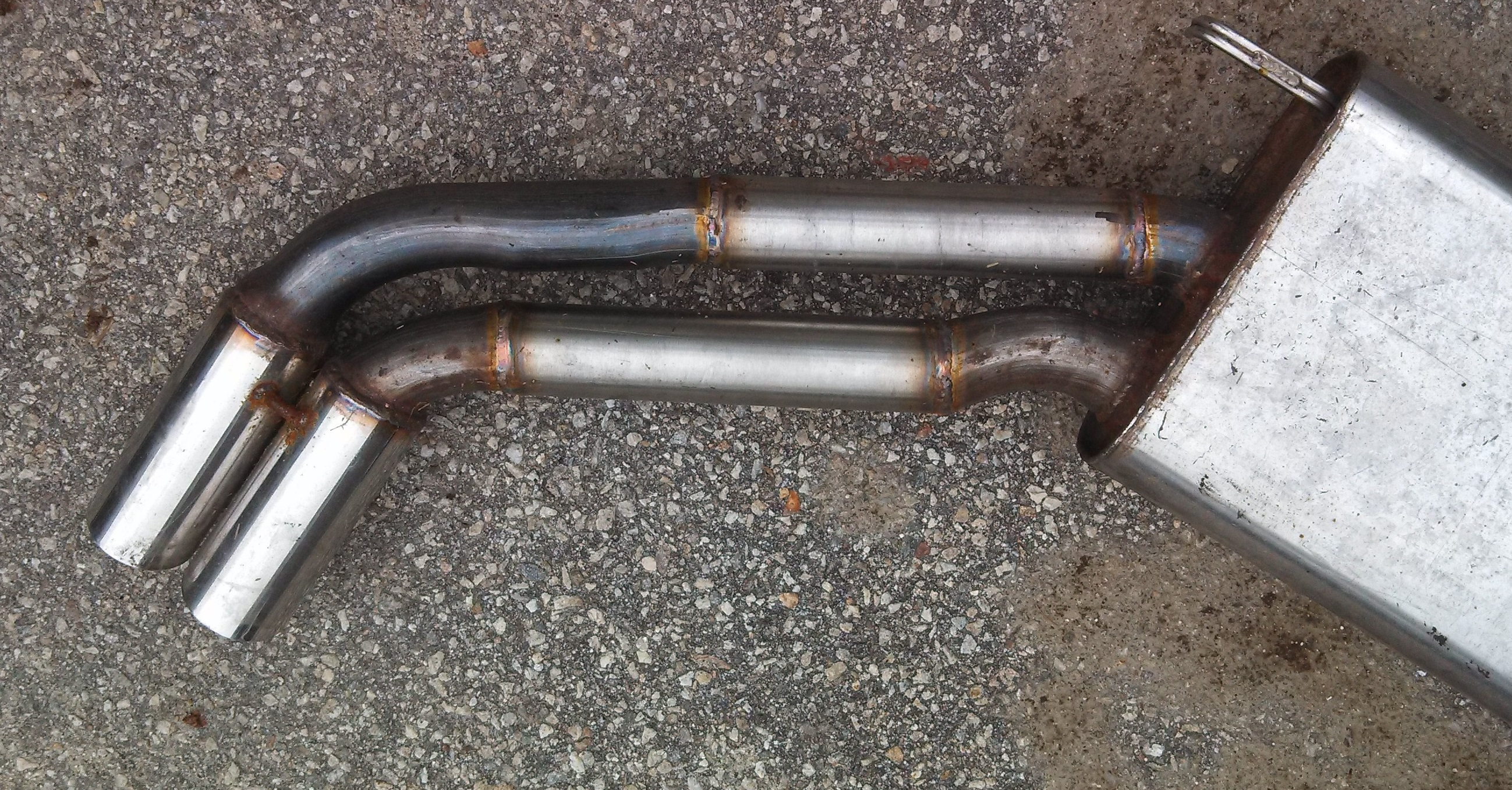

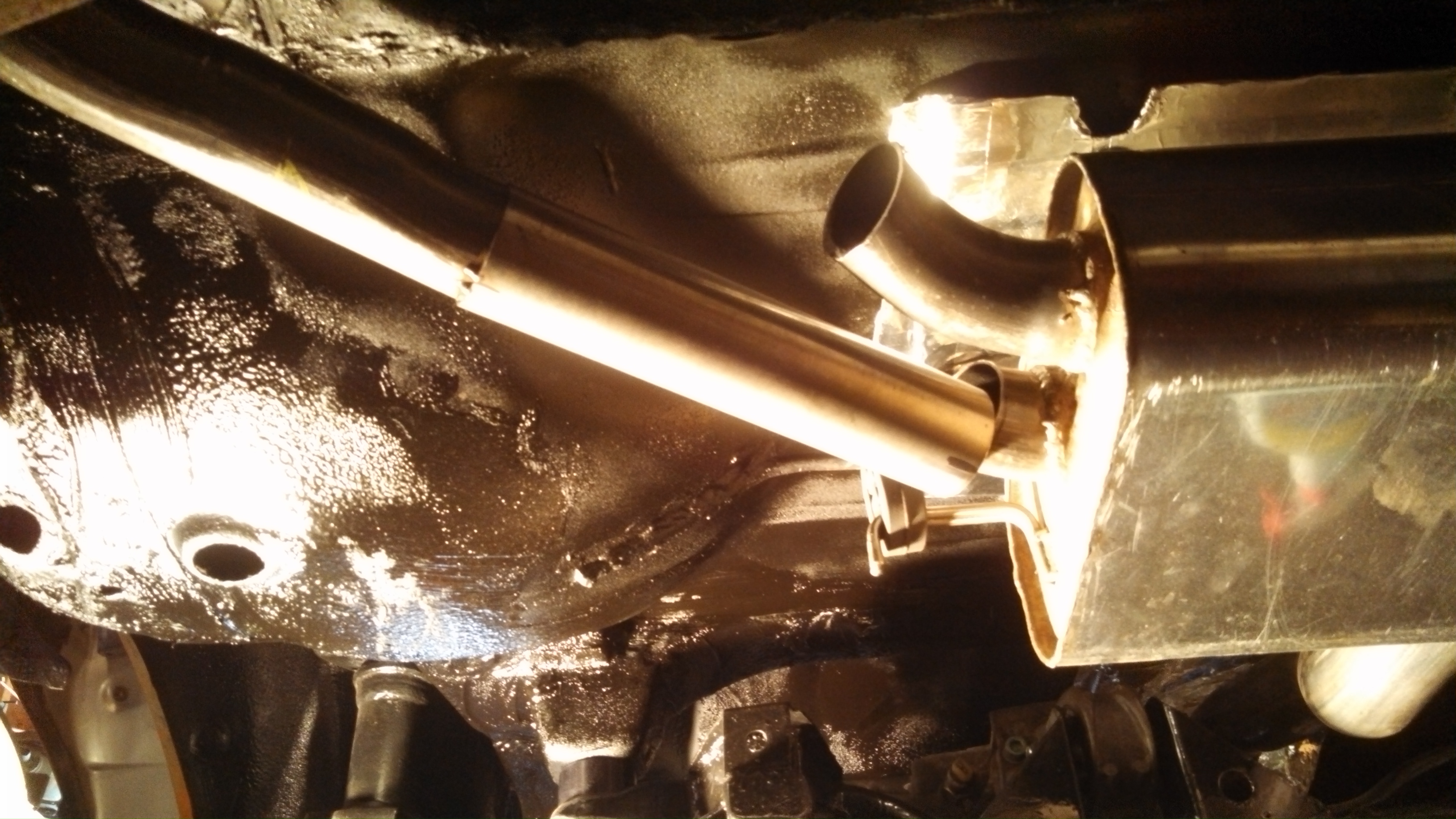

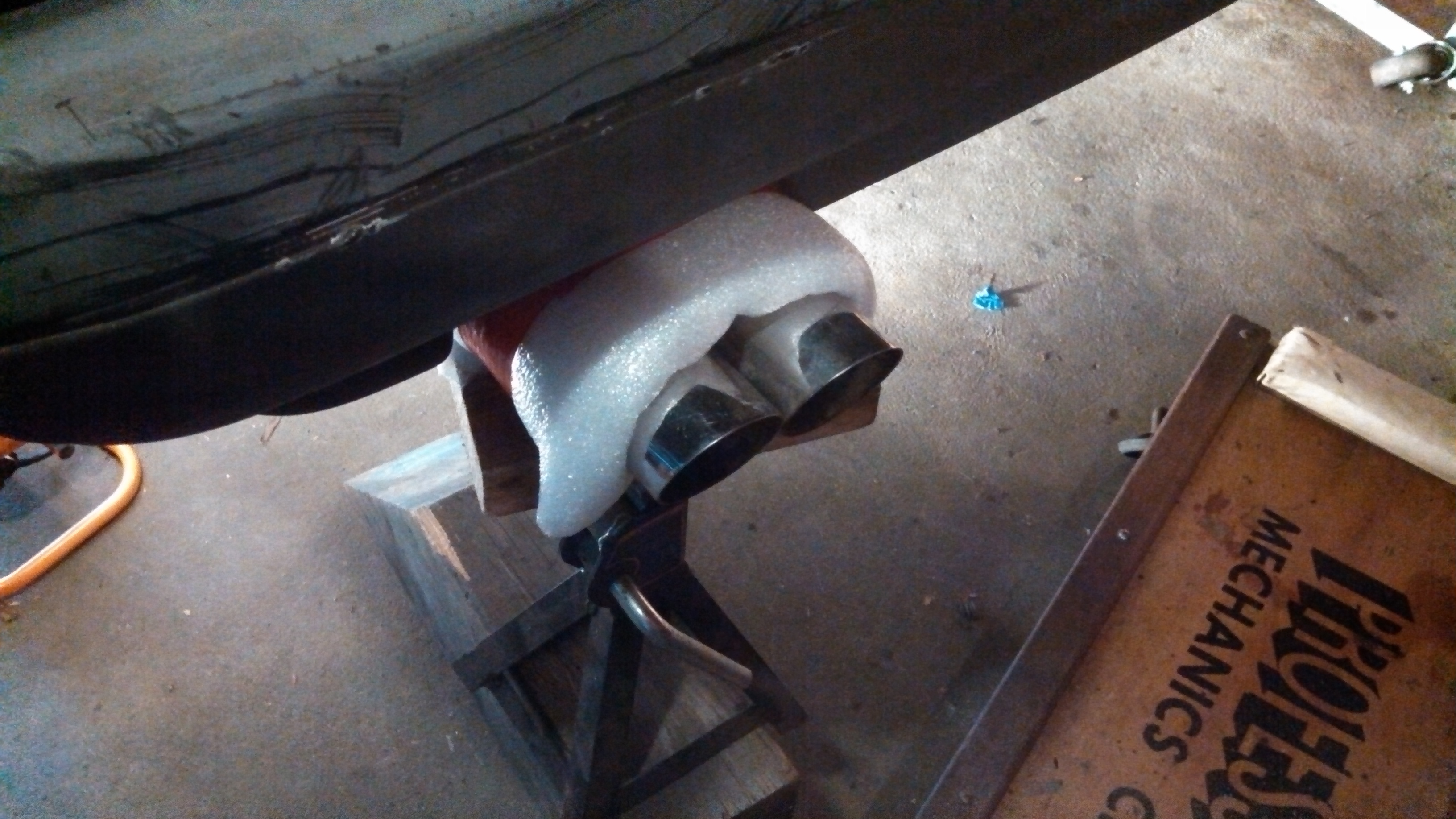

I’m running a Stebro rear muffler from a CQ. There is a small difference where it mates to the midsection, but as I was building it all from scratch that was a non-issue, well nothing a v-banding can’t fix
BUT! There was a larger issue at hand. The bumper cutout for the exhaust tip on a b3 is much more inboard compared to a b2 chassis car. So the muffler got some corrective surgery.
I welded the tips together, right where they attach to the exhaust tubing, out of site, inside the bumper. Above and below, with a short piece of 3/8” rod. This will help keep them aligned with each other as we extend the tips.
lining up exhaust tips.jpg (1.41 MiB) Viewed 36161 times
b3 to b2 exh tip relocation.jpg (1.42 MiB) Viewed 36161 times
And here is the tip extension all welded up
exh tip relocation welded up.jpg (1.7 MiB) Viewed 36161 times

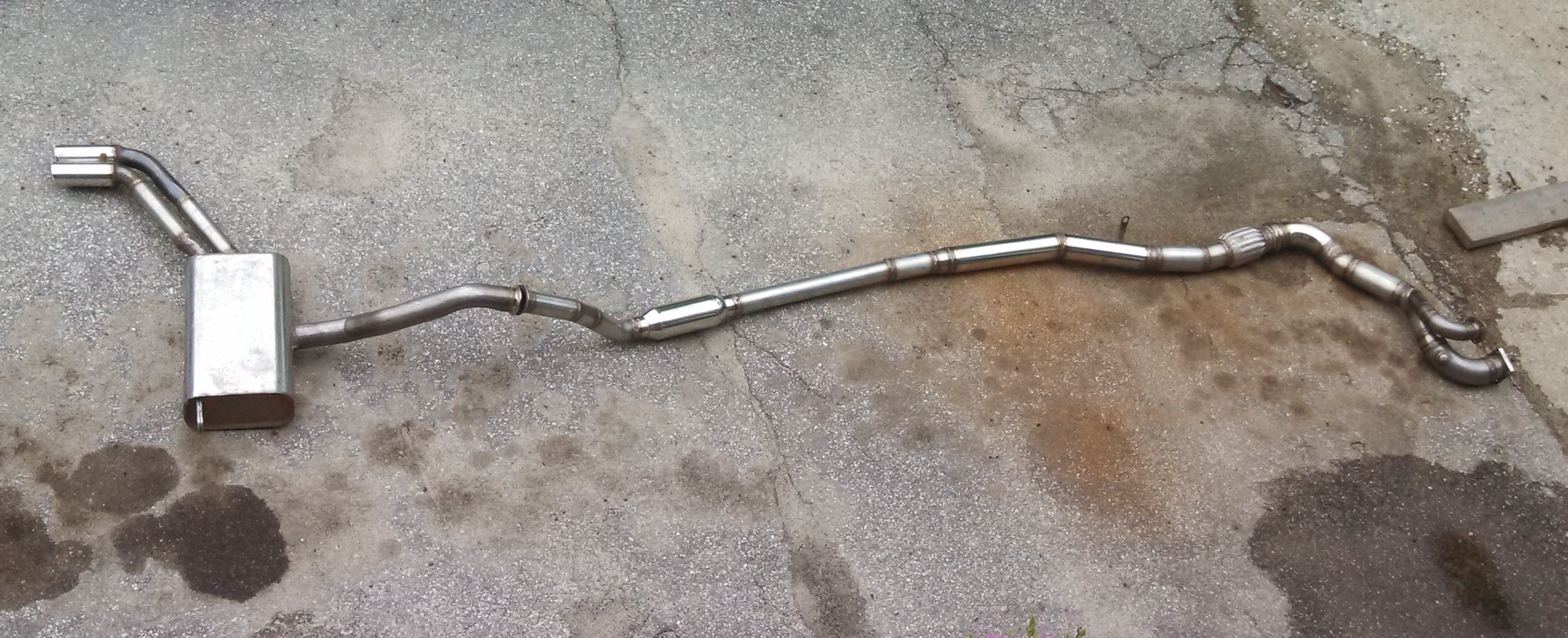

And the complete exhaust, FINISHED!!! Turbo to tips, well damn I need an o2 bung but that’s easy.
exh finished, turbo to tips.jpg (1.22 MiB) Viewed 36161 times

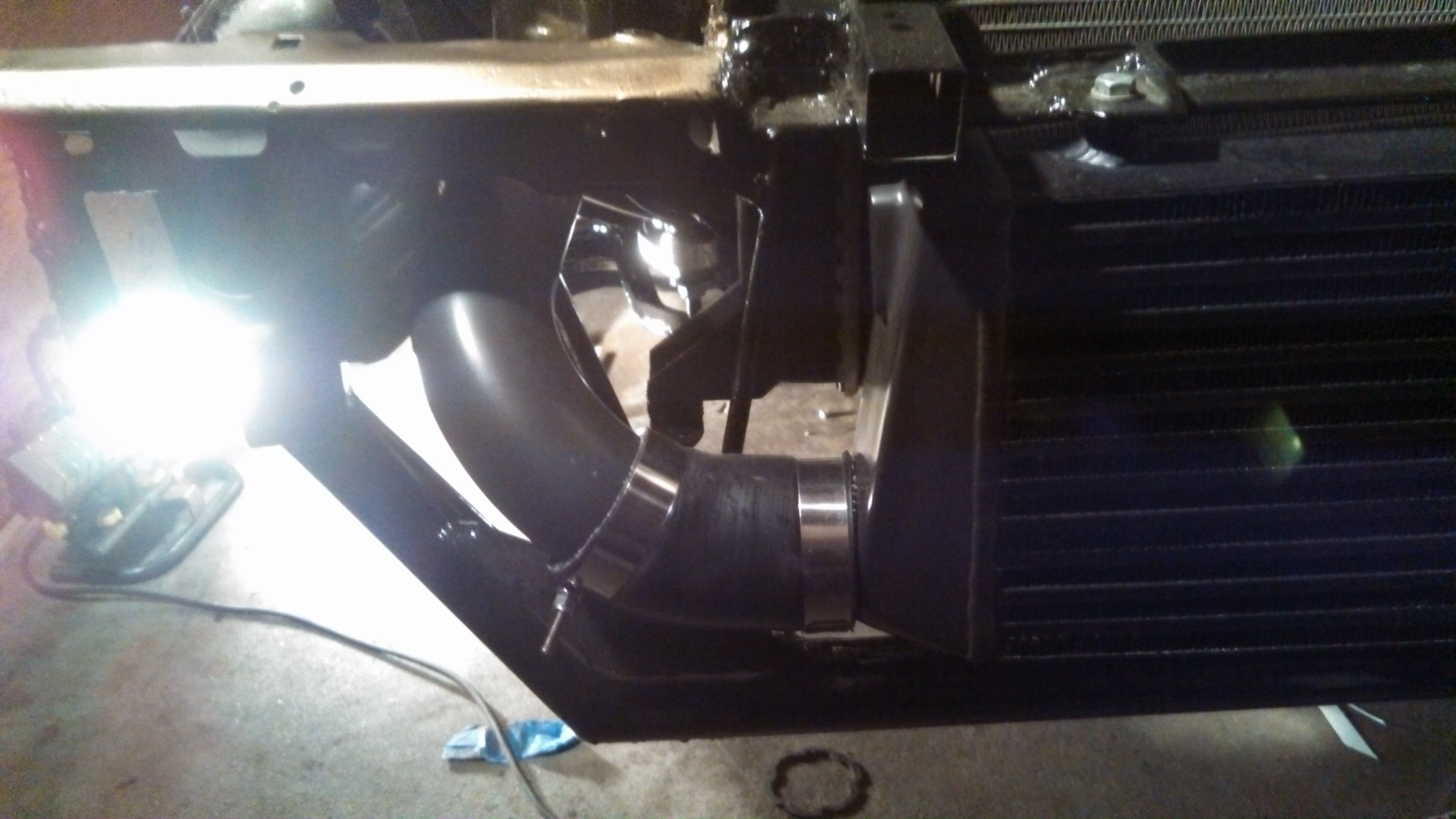

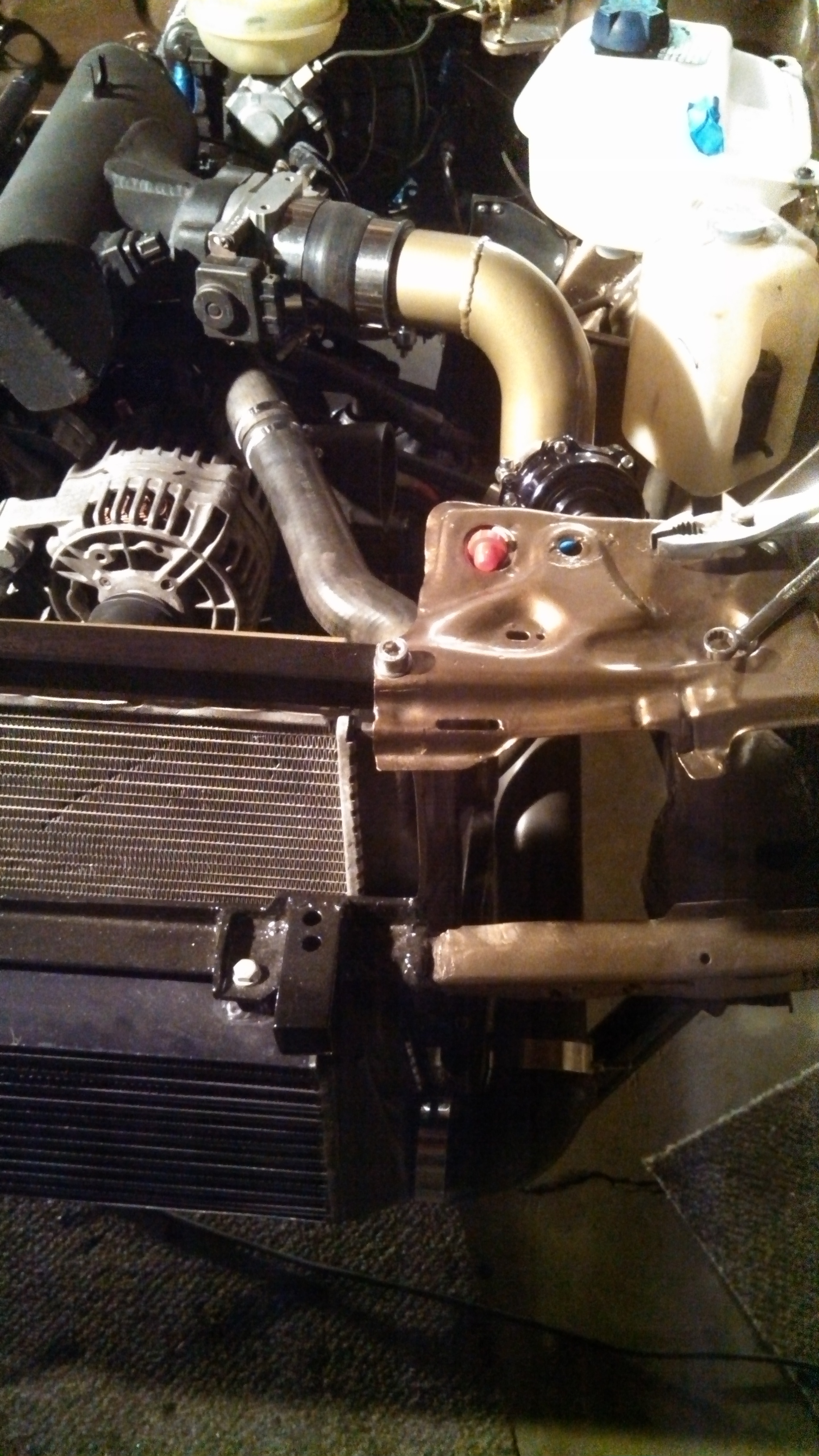

With the re-modified intake manifold I needed to change my post IC boost piping around a bit. I also got all the pipes bead rolled to keep the couplers on.
beadrolled boost piping installed.jpg (1.18 MiB) Viewed 36161 times
post IC piping and BOV installed.jpg (1.57 MiB) Viewed 36161 times

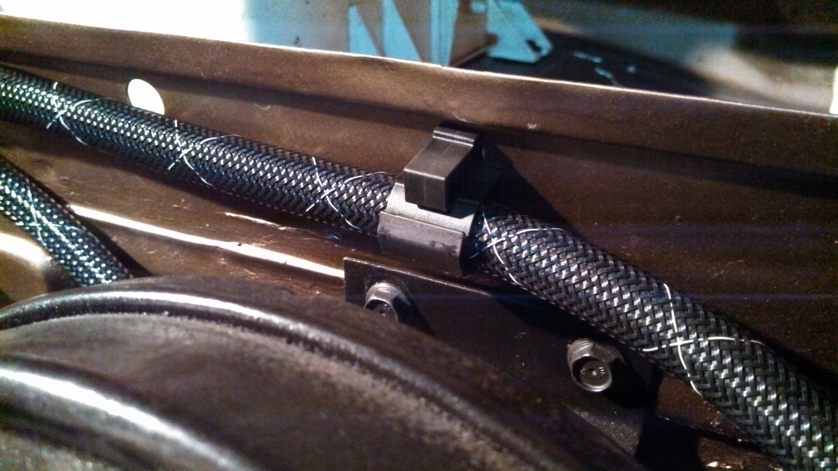

I also ran my starter lead and sleeved it in OEM fire sleeve. It’s also attached to the bell housing shield to keep it from moving around/chaffing etc.
starter cable mounted.jpg (1.11 MiB) Viewed 36161 times

Almost back up to date. So I am using a oem cv heat shield on the passenger front. It’s obviously on there to keep the boot from melting, but the added light impact/road grime protection is a nice addition. I wanted the same protection for my driver’s side.
I got ahold of another cv shield and set to mounting it up. The bolt hole provisions aren’t on the drivers side, well kinda. There are a few bolt holes. Some of the 6 speeds have the bolt holes as they have dual dp’s(2.7tt, 4.2, etc.) I’m running a five speed o1e from an urS4/6.

So I made an adapter plate to mount to the transmission and I will mount the cv shield to the adapter plate.

Here is the bracket and cv shield installed.

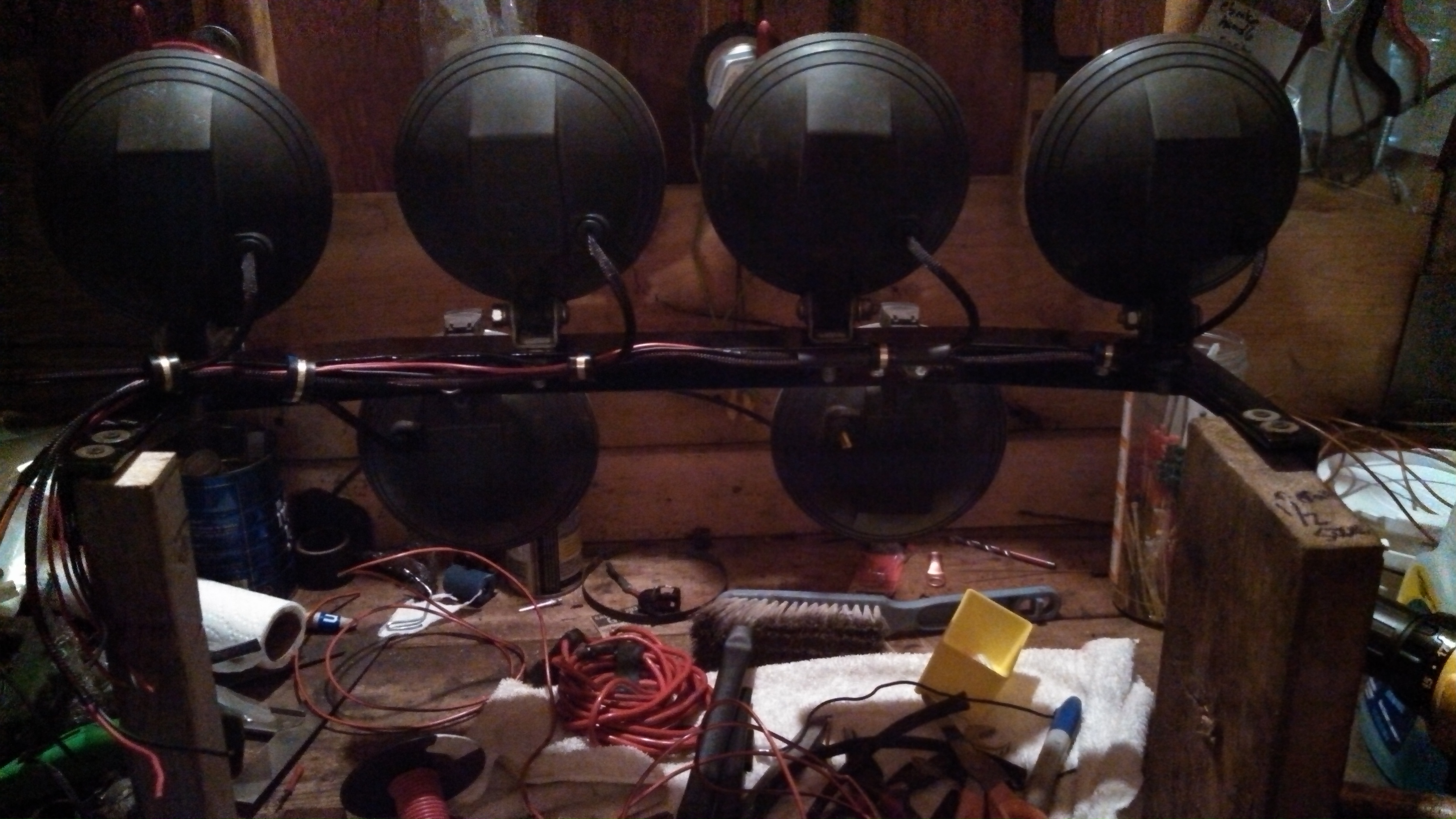

Earlier I built a rugged/removable mega fog light bar. I have 6 Hella 500 or 550’s. the lower two will have an “arm” switch on the dash and will be actuated by the high beam switch. The upper four will also have an “arm” switch and be actuated by a small push button switch on top of the shifter knob.
Having previously run several different fog light switch setups, I was always unhappy trying to find the switch on the dash mid-corner/oncoming cars etc. The switch placement on the shifter knob makes it soooo much easier to turn off/on, while maintaining “hands on” controls the whole time. This is a much better solution.
Mocking up the fog light harness.

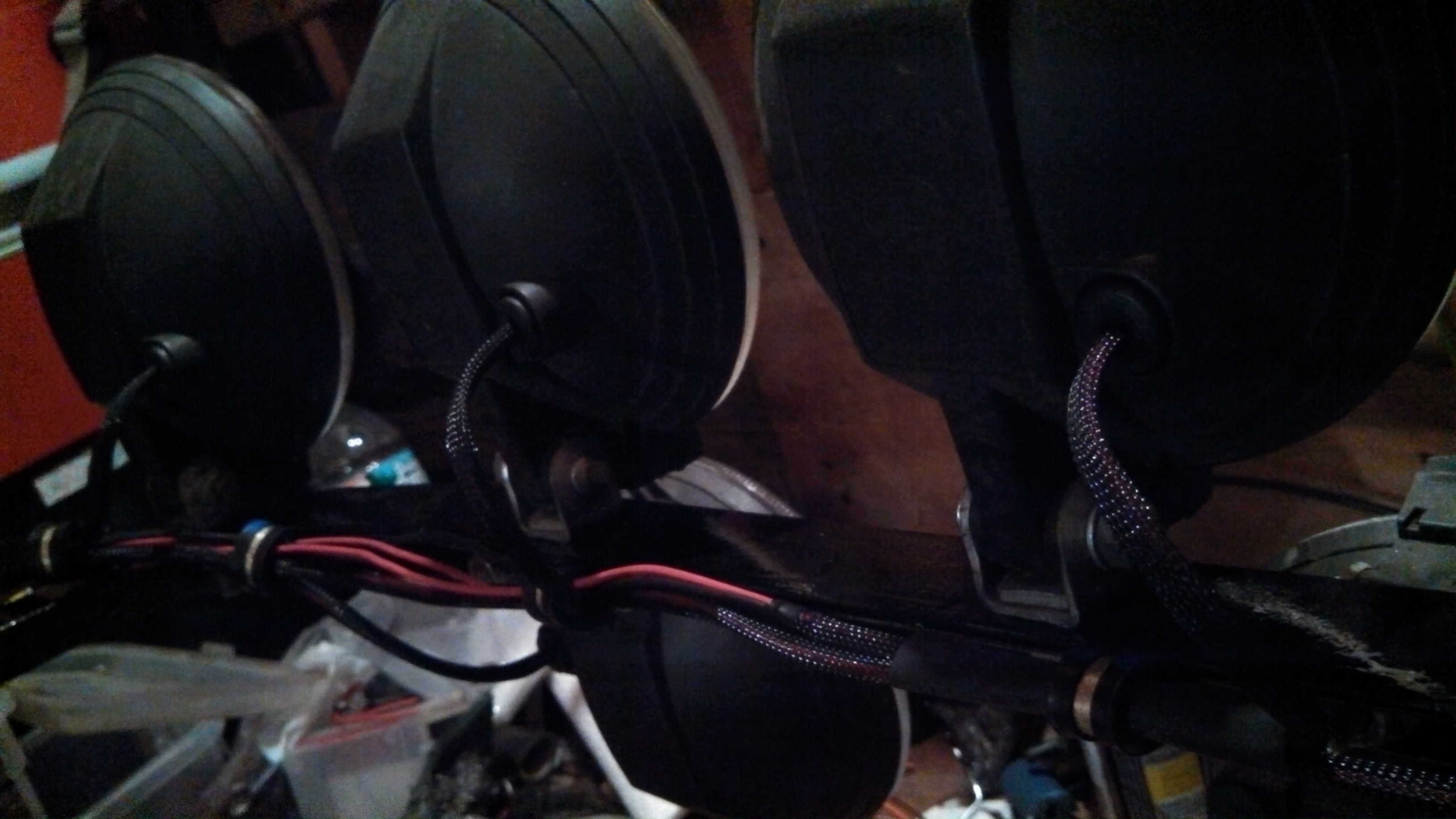

Here is the fog light harness finished on the bar. I just need to get the plug for the connections into the chassis harness and wire it in.

I made up some adapters to go from the k24 > AN fittings. They are some factory flare ends and bends, mostly from a 2.7t partout, tig’d together. Then sleeved with Earl’s Flameguard, and earl’s flameproof tape.
k24 oil and water adapters done and installed.jpg (1.87 MiB) Viewed 36116 times
I also ran the alternator cable and sleeved it in Tech-Flex. I had a few mk4 wire clips and fit nicely to hold the cable from moving around.
alt cable run.jpg (1.39 MiB) Viewed 36116 times
alt cable mounted on new mk4 clips.jpg (1.57 MiB) Viewed 36116 times
I also ran my new fuel pump wiring. I just need to put the terminals on and reinstall the fuel tray.
