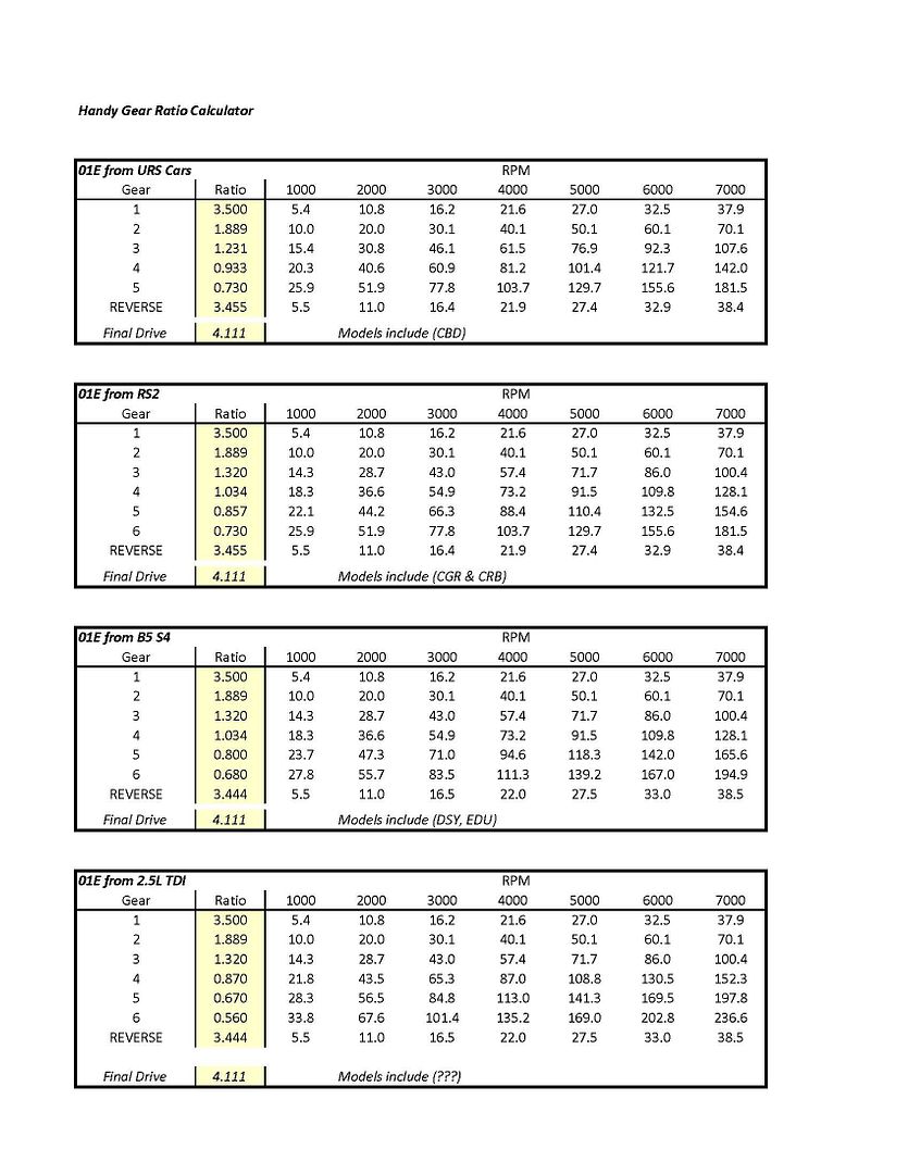

You might try the sedan 01a. If I remember correctly, 5th gear is taller in that. But let's be honest here, on the highway in my 80q, it still needs another gear.
Re: Ben's V8 Coupe Quattro - Videos!
I saw your ad for that and I didn't previously know there was a difference.

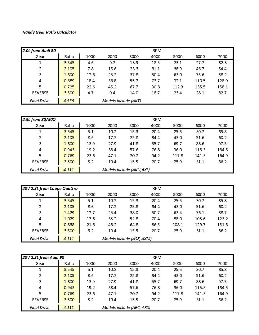

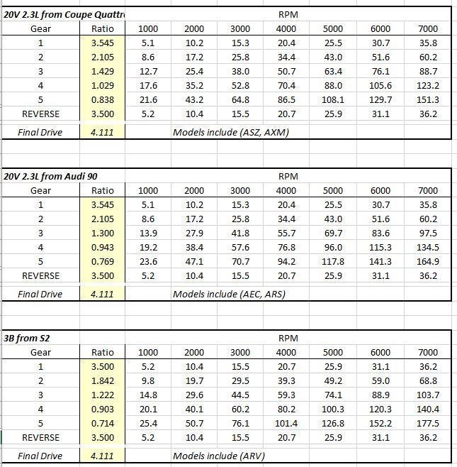

I since grabbed my Bentley and broke down all the 01A's from the manual...
and the 01E's too
Also had the 012's from when I did my Cabriolet Manual swap
Anyway, there is about a 6 MPH difference in 5th gear at 3000 RPM between the 01A's from the CQ and the sedan. You're going 64.8 in the CQ and 70.7 in the Sedan. That's a pretty big difference!
But, put yourself in 6th gear in the 01E from a B5 S4 and you're going 83.5 - or 101.4 in the TDI trans!
and the 01E's too

So it looks like the UrS 01E is actually has a slightly better 5th gear too. That's good, as I have one waiting for this 01A to die too.

I am running a 6 speed from an ABY S2 and 6th gear is still to low. I am having Hank put an tdi 6th gear in a later 01e.

I have the B5 S4 01e in my coupe. Overall I'm happy with it, but 1st is really short and 1-2 could stand to be farther apart. A taller 6th for freeway cruising would be nice too since its a street car. I have considered an 0a3 swap from a b6 S4 because (1) it has gear ratios for a V8 and (2) I love the way it shifts in my S4. Much nicer than the 01e in the coupe. Quite a bit more work to adapt though.

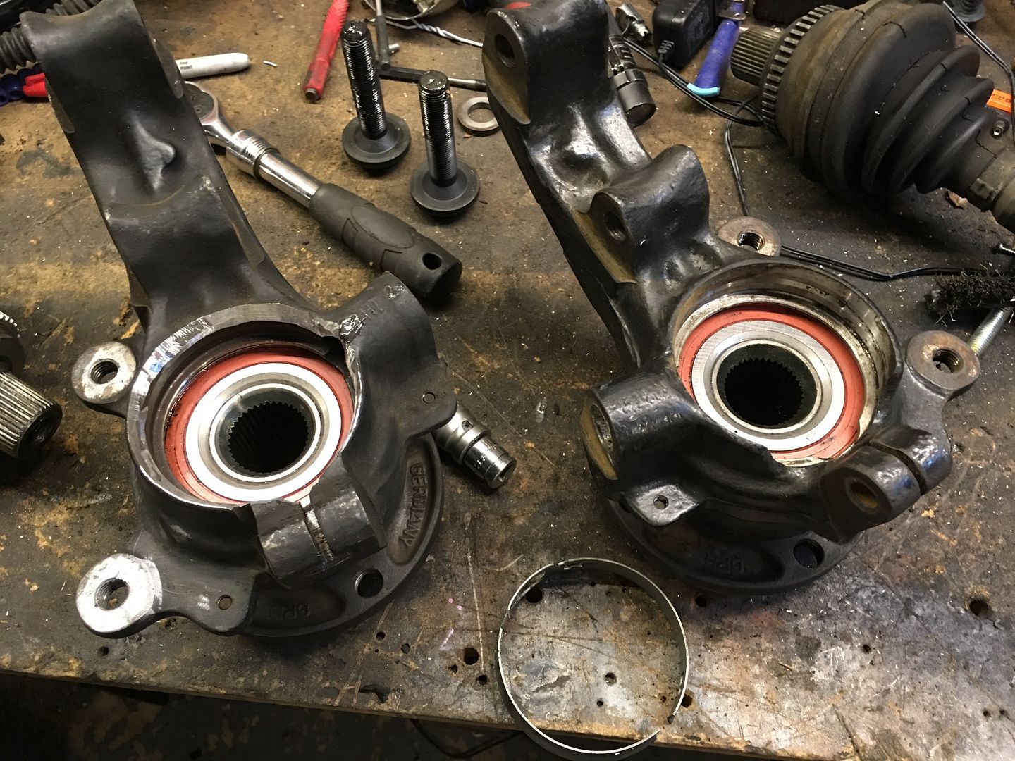

Huh, I had the exact same issue running A6 CV's in the 82mm housing.
They make a nice screeching sound when you try to move it huh?
I figured it out before I put everything back together thankfully. The little bit of grinding did the trick though!

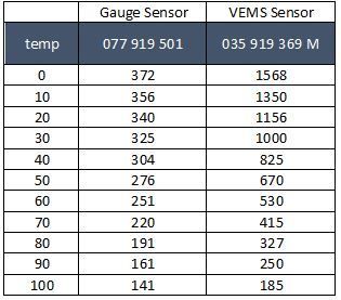

on your temperature quandry, the temperature curve of some of the v8 sensors seems to be different than others. I've seen 3 different curves so far.
your best bet is to calibrate it yourself using the 14pt curve. unthread the sensor (or use your spare) dunk it in some boiling water with the harness attached and set that point for 100c. similarly hang the sensor in open air and set the bin for the current outdoor temperature. lastly get some water to just above freezing and set that bin. then simply fill in the blanks inbetween to generate a somewhat linear curve.

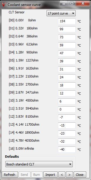

I've done a bunch of research on the temperature curves for the different sensors.
It looks like the sensor in the back side of the PS head is the same as a URS car. 035 919 369M is the part number. This is what goes to VEMS.
I've been using the bosch default curve for this. I just flashed the NTC 256/1900 patch into the box today but I don't really know what that does. Should I adjust the curve from the Bosch default?
What exactly does the patch do?
I've been chasing down what I think/thought are slight overheating issues but I may just have the wrong readings.
Next is the sensor for the gauge in the instrument cluster.

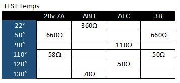

I have a bunch of different Bentley Manuals and looked up the test readings for each of them to see if any were the same. I originally had 077 919 501 in there which read way hot all the time. Now I have 035919369M (the same as the back of the head) which I know is wrong - and it's too cool
So to summarize, when the car is at operating temp - which I am calling the times where I am either on the highway or driving in the city without a bunch of traffic lights -
I see 92-93 on the VEMS readout from the proper ABH sensor marked 035919369M
From the proper ABH sensor 077919501 the CQ gauge is at the 110 degree mark
From another 035919369M - the CQ gauge is at the 80 degree mark.
Below is what the Bentleys say the sensor that feed that car's gauge should read...
I'm going to try the simplest route which should be using the CQ's MFTS to feed the CQ cluster. Hopefully it will fit in there!

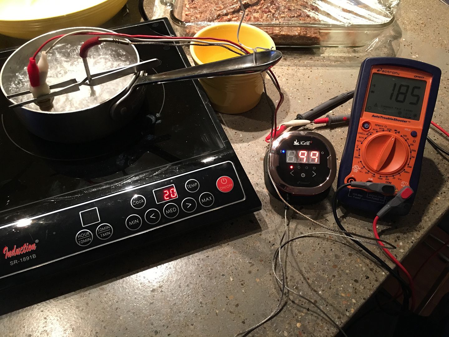

I did a little bit of science over the weekend!
decided to just make my own curve...
Did so for both the CLT sensor (035919369M) and the one for the gauge in the IC (077919501)

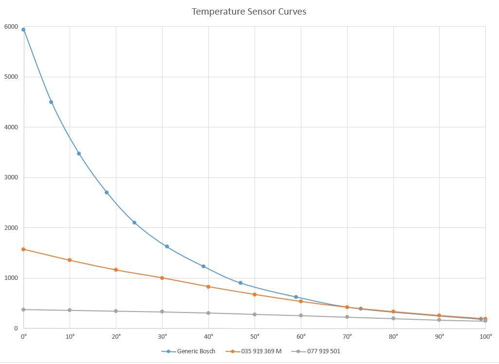

Then I compared them with the generic Bosch curve built into VEMS:
Clearly different curves but the vast majority of the difference is in the non-operating temp zone.
Here is a detail of just 70-100 degrees:
So I will likely change my CLT values in VEMS but I don't think it will change the readout at operating temp much if at all. The curves seems to intersect at 90*

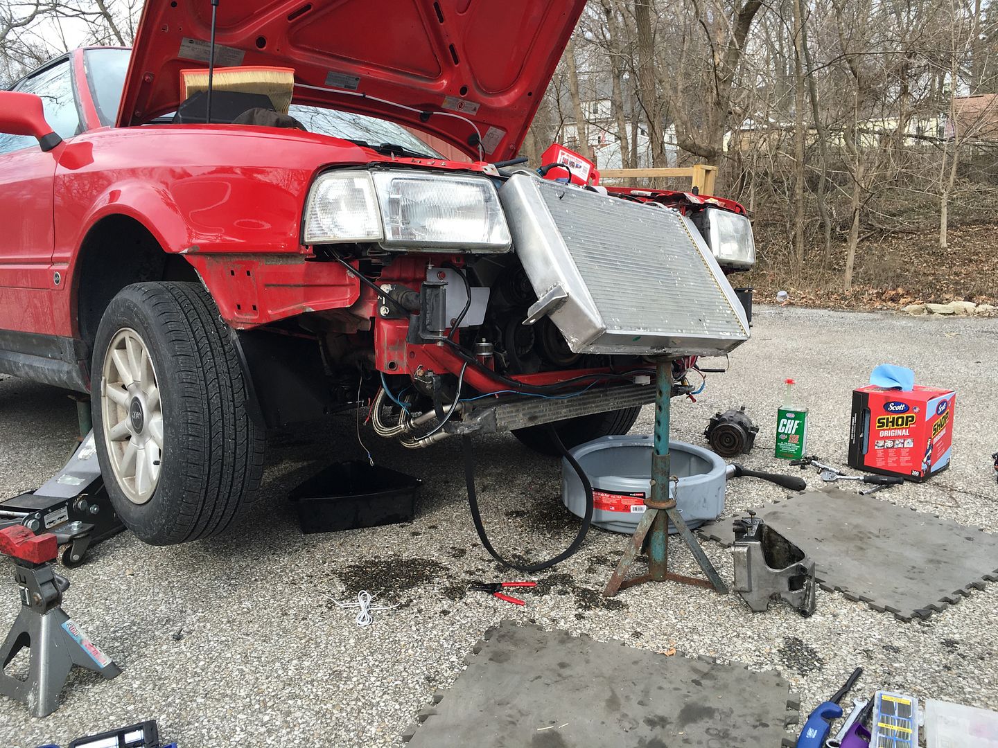

Re: Ben's V8 Coupe Quattro - Power steering pump issues
Trying to fix a few things today.
Did an oil change so I could replace a couple of the sensors on the car. The oil temp sensor was broken off so I wanted to replace it and also the 1.8 bar oil sensor.
Did that but needed to remove the alternator to get to the temp sensor. While I had that off, I decided to try and replace my power steering pump to solve a loud whiny steering problem.
I bought one from Force5 a few weeks ago and it showed up super rusty and dirty but I cleaned it up and got it ready for the surgery it would need. Since I have no brake bomb, I needed to disable that output port by removing the e center piston from the pump. When I did that, the spring from one side was already broken but since I don't need that output I just took it all out and reinstalled the pump.
When I got the car back together and teied to test the pum, all was good for a second as I turned the wheel from side to side. But a half mile into my test drive I have zero power steering.
Having never messed with one of these things before, is there something simple I could be missing?
On the bright side, I was able to take the serpentine belt off without draining the coolant...

I didn't know there was an 01A with better gear ratios.
Anyone ever use the S2 ARV transmission?
see ratios below for what I have now, the slightly better sedan B3 trans and the S2...
Seems WAY better for the V8 (and I know the 01E is better still)
There are a few for sale on the S2 forum
