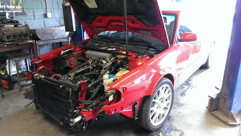

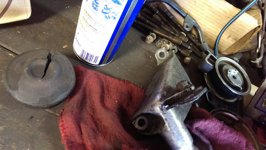

Re: A tale of Rubí... On lift w/PICS
Posted: Wed Jun 26, 2013 12:16 pm
by mushasho
Of course I'm looking for someone on the east coast that stocks a poly snub that can ship it out today...

OBI- If you want a free new reinforced Rubber snubber I ordered one for my 200 and when I went to put it in I realized I had a new one in already.
Free for you my friend - it's sitting in the 200's door pocket.

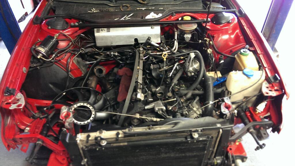

Posted: Wed Jun 26, 2013 6:33 pm
by EDIGREG

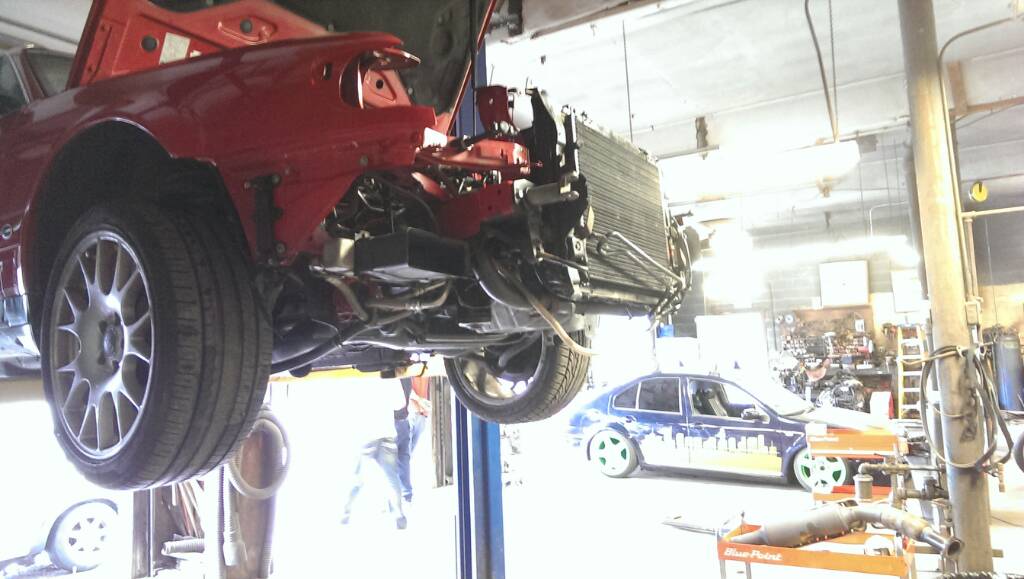

Dude, pull the radiator and AC condenser! Takes 10 minutes and makes things sooo much easier!

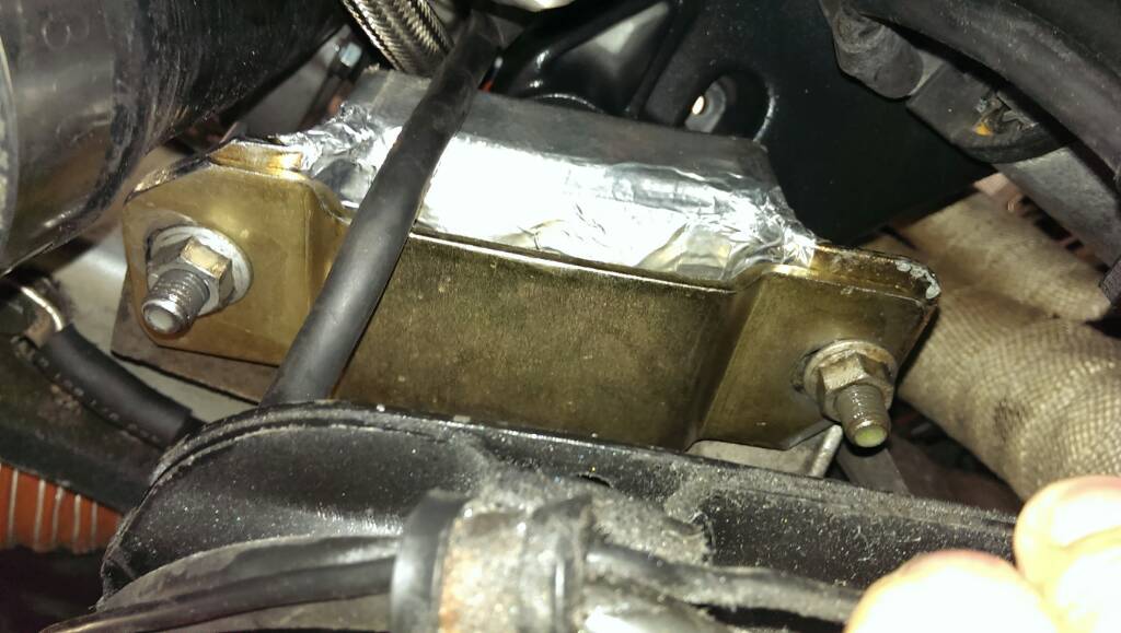

Posted: Fri Jun 28, 2013 2:32 pm
by mushasho

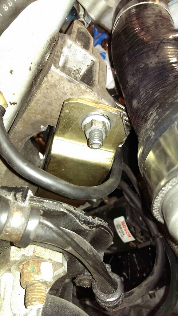

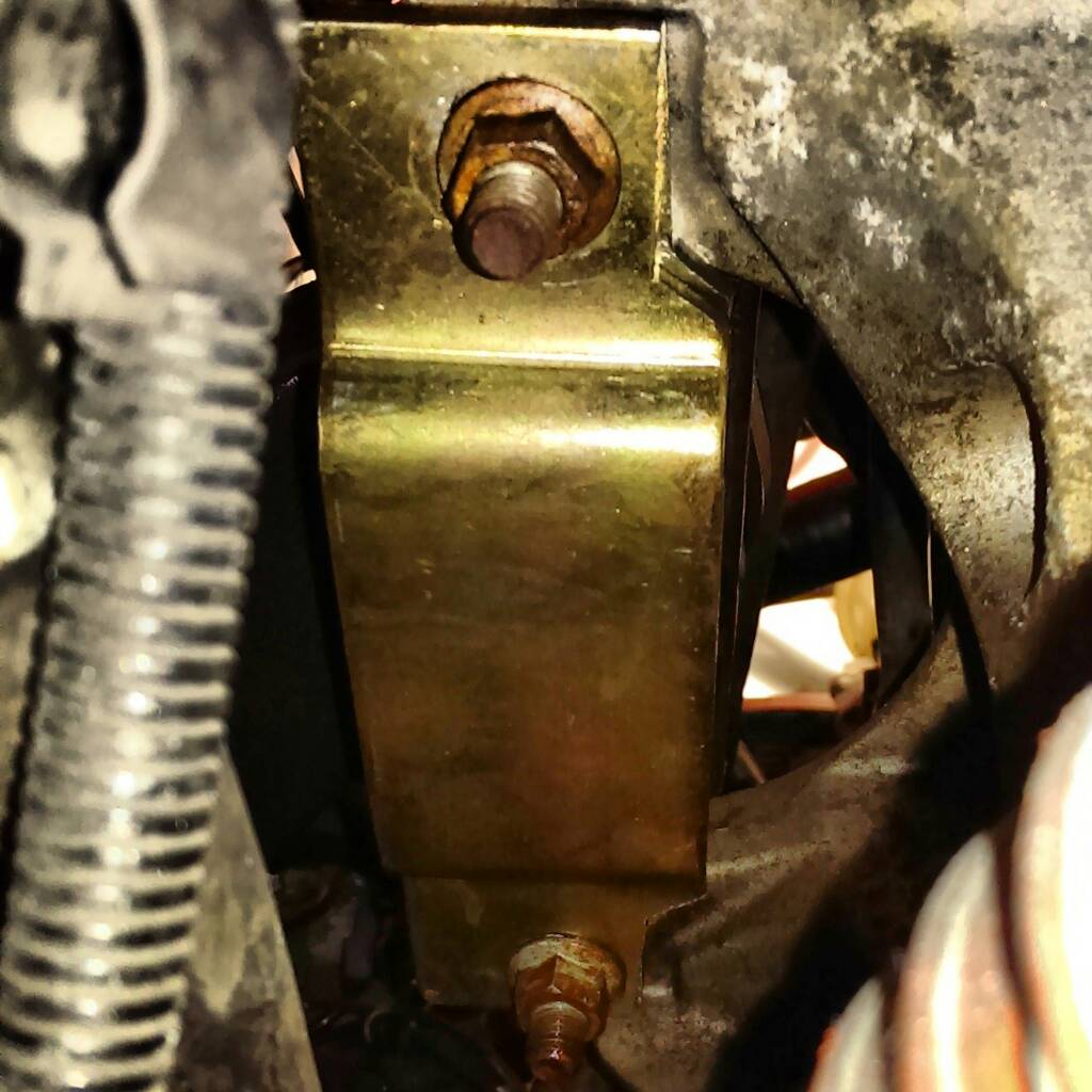

After 2 failed attempts to remove the used ones crack free... Had to pick this up.

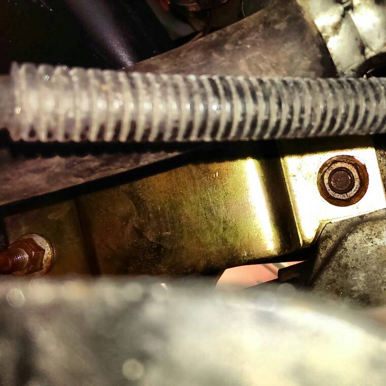

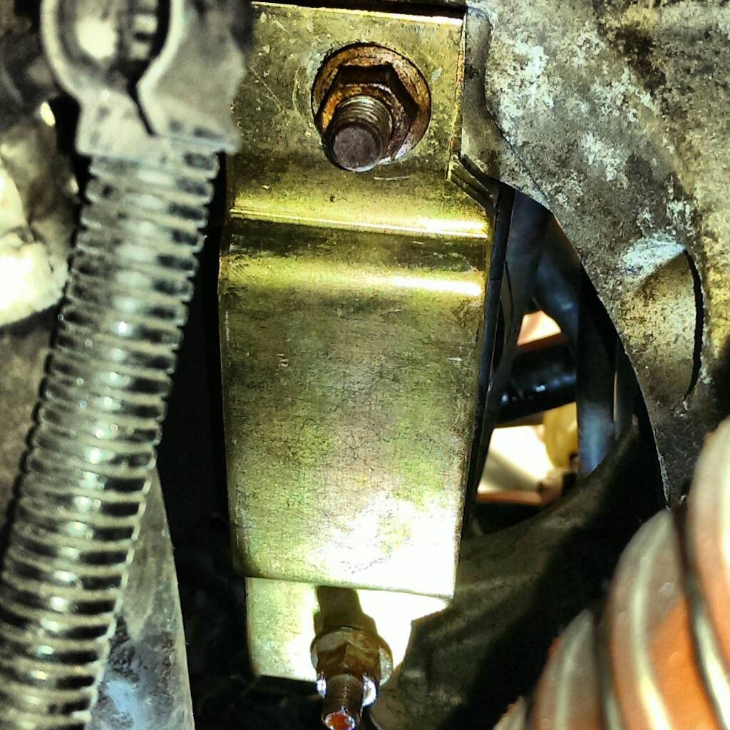

Edigreg here's the Driver side
Re: A tale of Rubí... New hardware w/PICS
Posted: Fri Jun 28, 2013 7:37 pm
by mushasho
And passenger side
Posted: Fri Jun 28, 2013 9:19 pm
by EDIGREG
The bottom bracket is installed wrong in the photos. It should point upwards to support the mount
Posted: Fri Jun 28, 2013 9:24 pm
by mushasho
EDIGREG wrote:The bottom bracket is installed wrong in the photos. It should point upwards to support the mount
Really? I actually had 2 people specifically point this out as the proper placement. I was under the same impression as I thought it should go in the notch... How'd you figure it the other way?
Posted: Fri Jun 28, 2013 11:29 pm
by EDIGREG
It's obvious. The plate provides no support to the mount if it is upside down.
Google photos of the mount if you don't trust me :)
Posted: Sat Jun 29, 2013 6:29 am
by glibobbo21
hmm...news to me, but easy enough to remedy. :hide:
