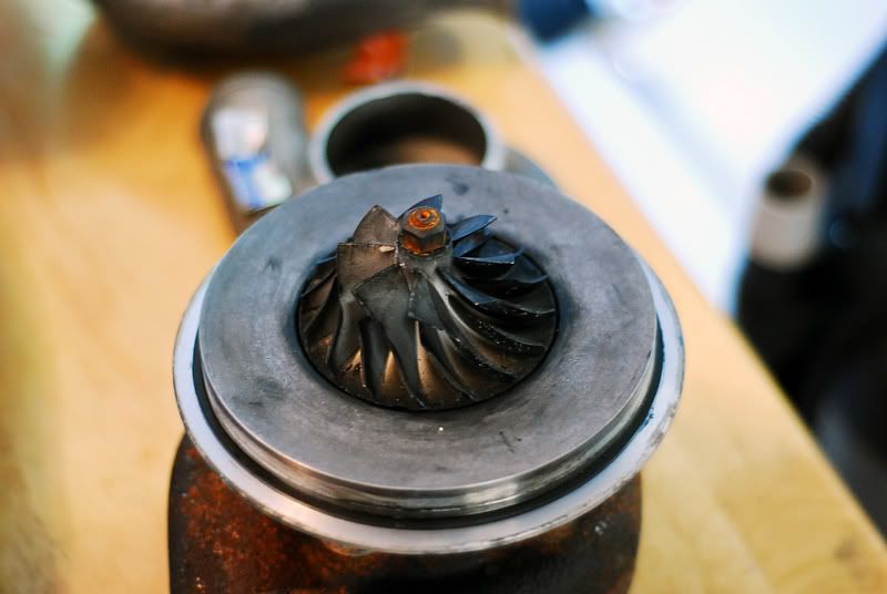

It has absolutely ZERO shaft play so I'm hoping that its good to go. The other one I have came off of a perfectly good running (and boosting) motor and doesn't have much shaft play, but its a lot compared to the one that just came in! There isn't even much residue on the new one. No oil on the turbine blades, so I suspect it doesn't have any issues with seals. If not, the worst thing that could happen is that it needs a $70 rebuild kit. I really doubt that though. The exhaust housing is rough, but I have the other one which is pretty nice. I also have another center section if needed.

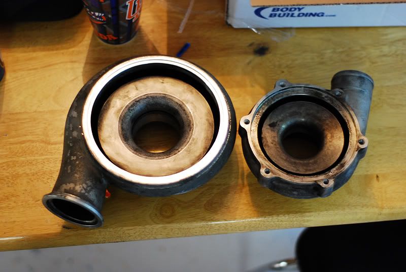

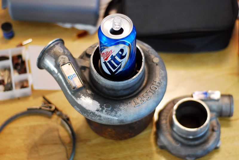

Anyway, on to the pics. I am satisfied now :D
I'm going to be polishing it in my spare time. Beer can is just for size reference...
next to the small housing lol

I started sanding down the comp housing with 80 grit sand paper on a dremel. I need to go get a respirator. I have been doing everything I can to keep away from the fumes from using a vacuum to putting a shirt over my mouth, etc...but its still scary. Don't want heavy metal poisoning. I have to get into all the nooks and crannies. Then I'm going to get a few more wheels for 320 grit, etc. and then some wet sand paper to go up from there by hand. I'm not really going for a mirror finish. Just want it kinda shiny and clean looking. I would have just taken it and sand blasted it, but the sand blaster I have access to sucks.
Oh and the damn turbine housing is clocked completely wrong (oil feed and return are basically sideways). So I will have to take that housing off. While its off I will probably just swap the other one's housing onto it because its in MUCH better shape.

i think you will be WAY happier with that turbo. Also keep in mind is that most all holsets have SOME shaft play until they have oil pressure. ETA when all this stuff is gona be on? I WANT VIDS!

derrish_vulf wrote:i think you will be WAY happier with that turbo. Also keep in mind is that most all holsets have SOME shaft play until they have oil pressure.
This is true of any turbo, at least any oil wedge turbo. The oil wedge fills in the gap. Also, the shaft expands when it heats up, and the bearing size takes that into account.
That turbo should work well. I don't know how it compares to the HX-35 on Mike's (now my) QSW turbo, but the HX-35 fills the cylinders quite well at 15 PSI and clearly is trying to push more when the engine has completely given up.
Yep, I do know that about journal turbos especially. Thats why I was never worried about the other one that does have a little. Somehow this one really has next to none though. I can't feel it at all. I had a brand new 50 trim (also journal of course) and it had much more than this does.
The turbo is almost exactly the same as an Hx-35, but will spool slower because it has a less efficient comp side I believe. I am expecting full boost around 4k...maybe more if the manifold just sucks that much lol
