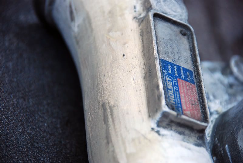

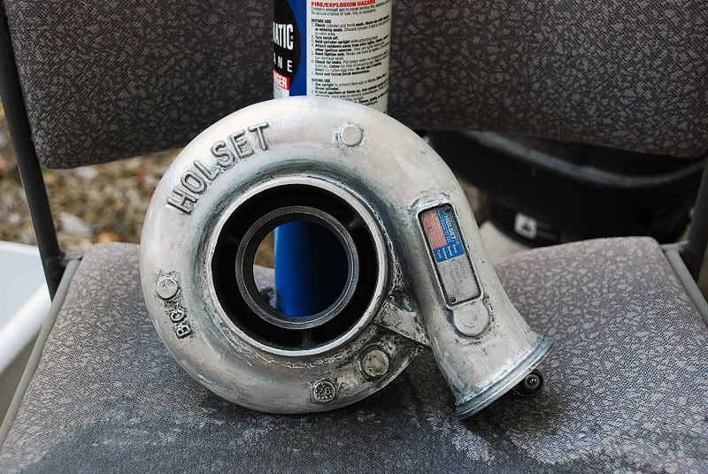

Basically I took the cast finish off with 80 grit and a dremel. It was really hard to get into all the crevices and stuff, so I still have to get at those a bit.
These pics were after it was rubbed down with 220.

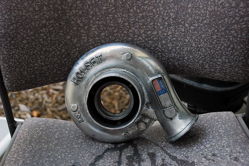

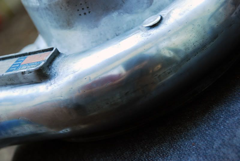

Then I just wanted to see some polish...so I did a pretty half-assed job and went up with 400, 800, and 1000 (again, half-assed) and hit it really quickly with a little compound.
Here is a before shot...
I'm not trying to get it perfect or anything. I just want it presentable. The letters are never going to look very nice because I just cant get anything small enough to sand in there, so I think I may paint them black or red when its all finished.

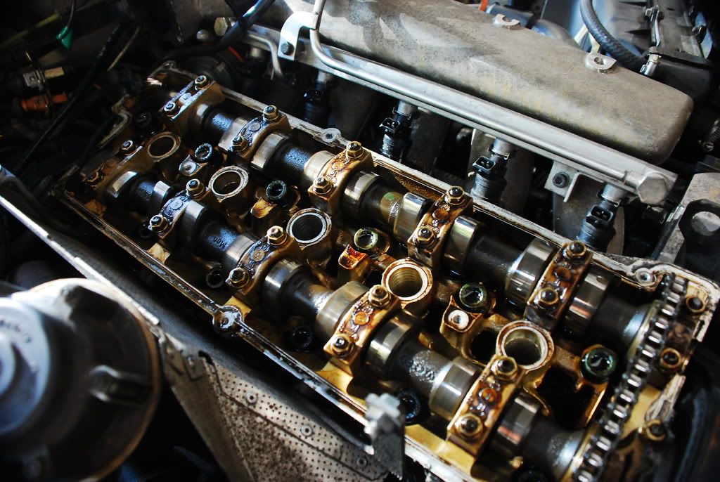

I was attempting to swap out my vc and vc gasket today and like 4 of the stupid bolts stripped even with a t-handle allen.
I tried almost everything and as a last resort I went to my neighbors house to see if he had any screw extractors. He did, and its been working great so far. I'm letting some penetrating lubricant sit in the remaining ones over night. The ones in the throttle body are even giving me a pain in the ass...and I dont think I can get the bolt extractor in there if I need to. UGH
