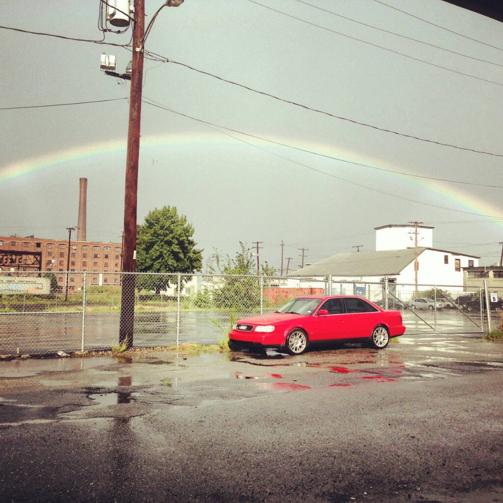

by mushasho
Love walking out to this car....
Re: A tale of Rubí... SouthBend STG4 Slippage w/VID
Posted: Mon Jul 29, 2013 7:08 pm
Sounds just as she looks...
GORGEOUS.
