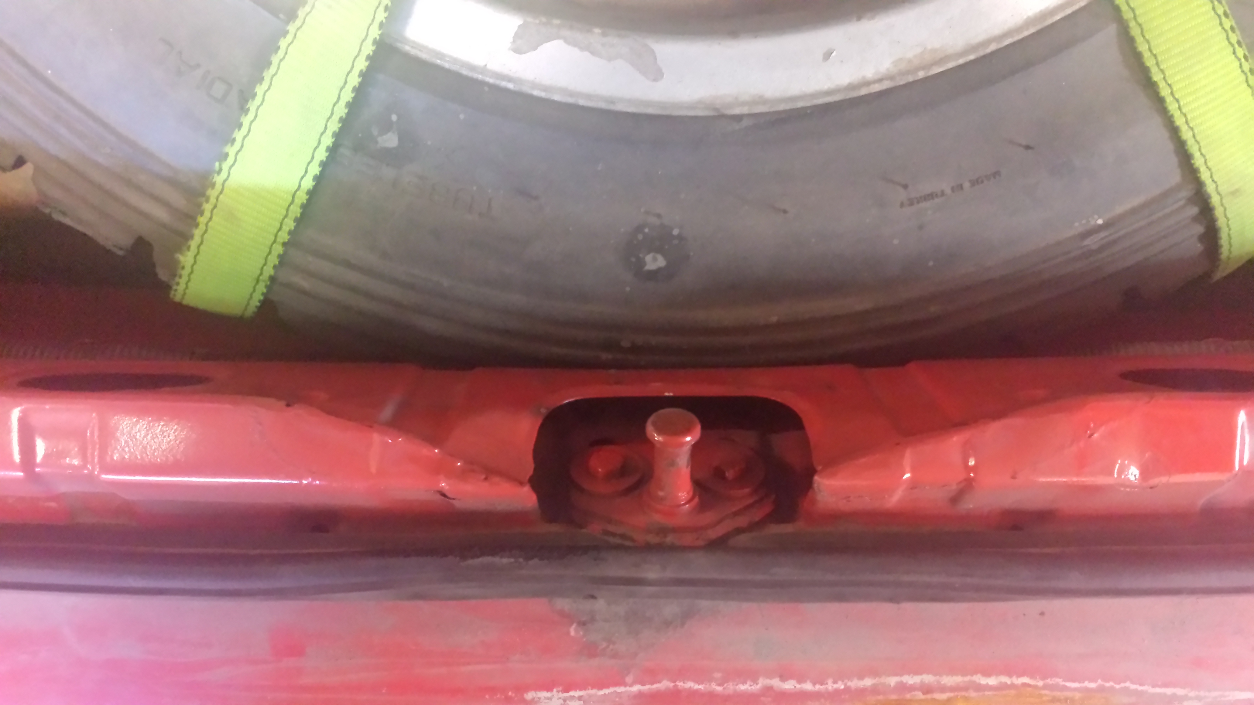

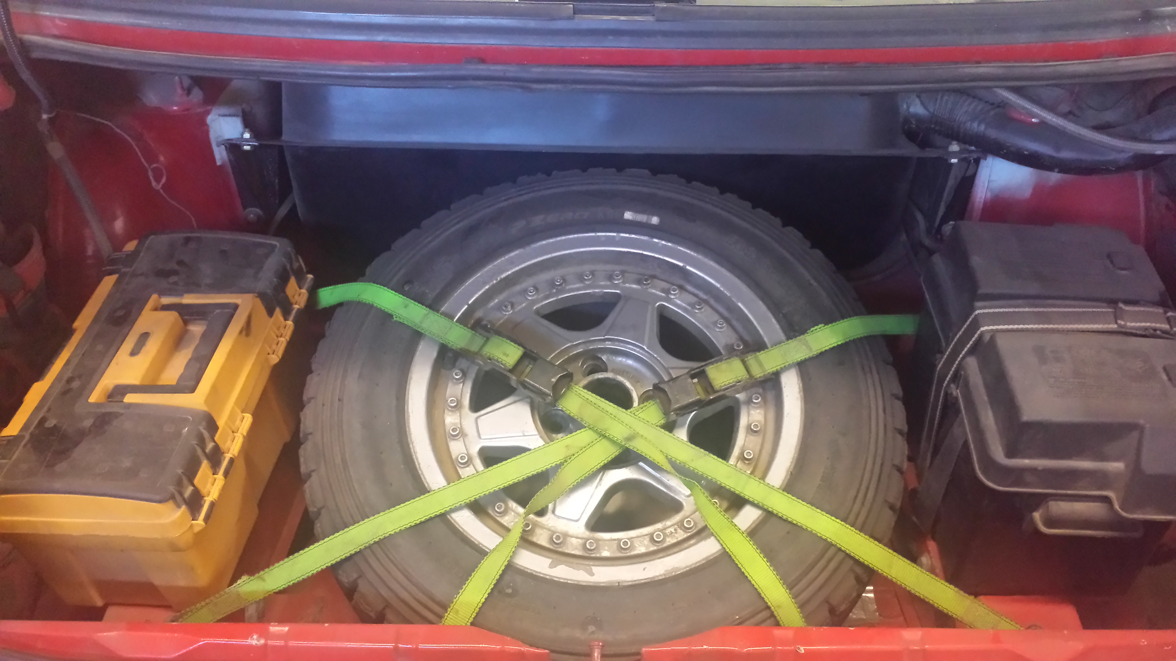

how are you fitting a spare tire in the trunk? The b3 is nearly a no go. I'm considering mounting on top of the trunk!
Re: 4kRR Audi 4000 Rally Rig
Posted: Mon Oct 05, 2015 7:29 am
by vbares
I'll take some pics tonight - its a tight squeeze and I cut some body material near the lock pin...

- 2015-10-08 12.10.42.jpg (1.54 MiB) Viewed 50443 times
- 2015-10-08 12.10.25.jpg (2.25 MiB) Viewed 50443 times
I just remembered that I moved the gas tank backwards by modifying the brackets (I'll look for those pics too) - plus you'll see that I cut the trunk a bit in a wide v-shape in order to facilitate in-out.
2 195/15 fit, but only 1 205/15 will fit

Eventually I'm going to have to modify my fuel line like yours, For now I took the factory pickup out of the bottom of the tank, flipped it around a bit and welded it back in. It comes out very close to where your box does. I would like to note that it doesn't like fuel sloshing around when towards the last gallon or two. your little box might be ideal as a kind of surge tank.
I'll have to see what sort of persuading I can do to the latch area. My tire sits in a much more upright position when in the trunk. No chance in hell of getting 2 195's in there.

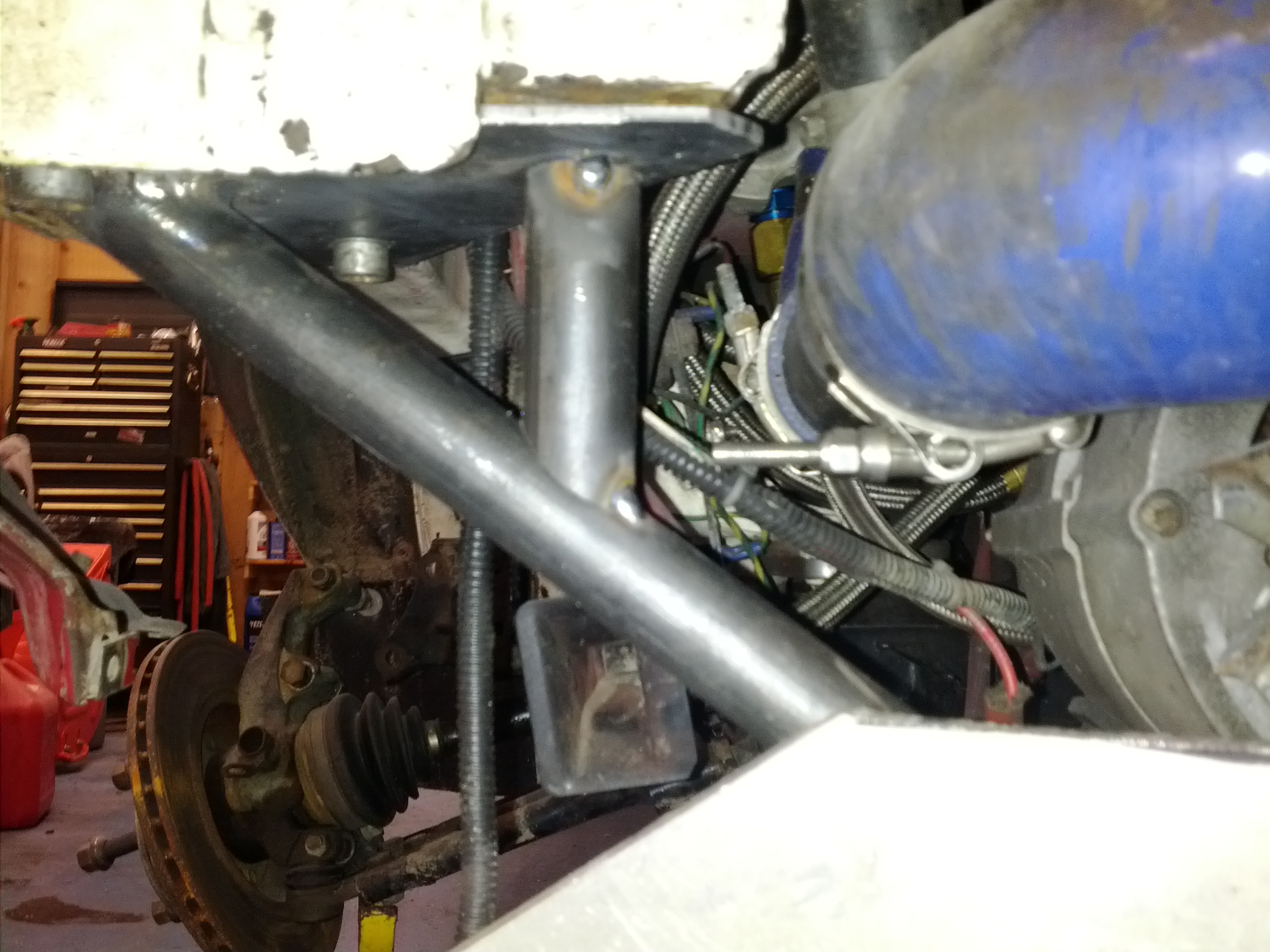

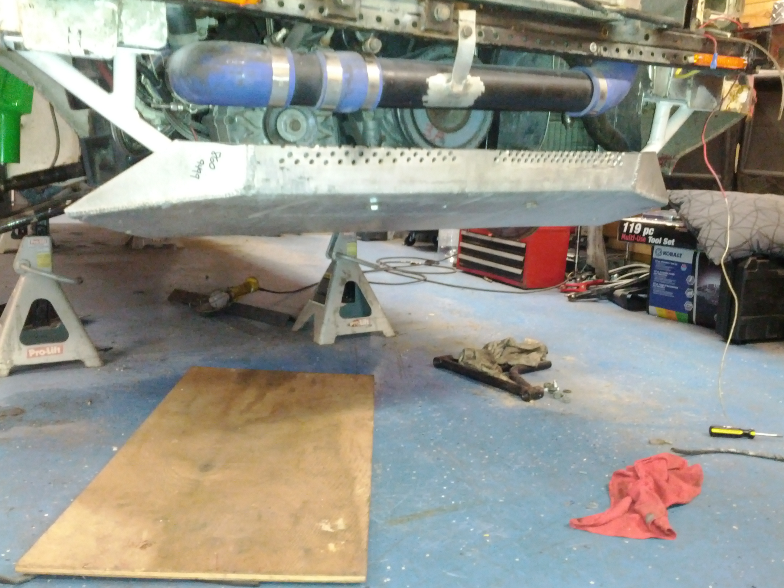

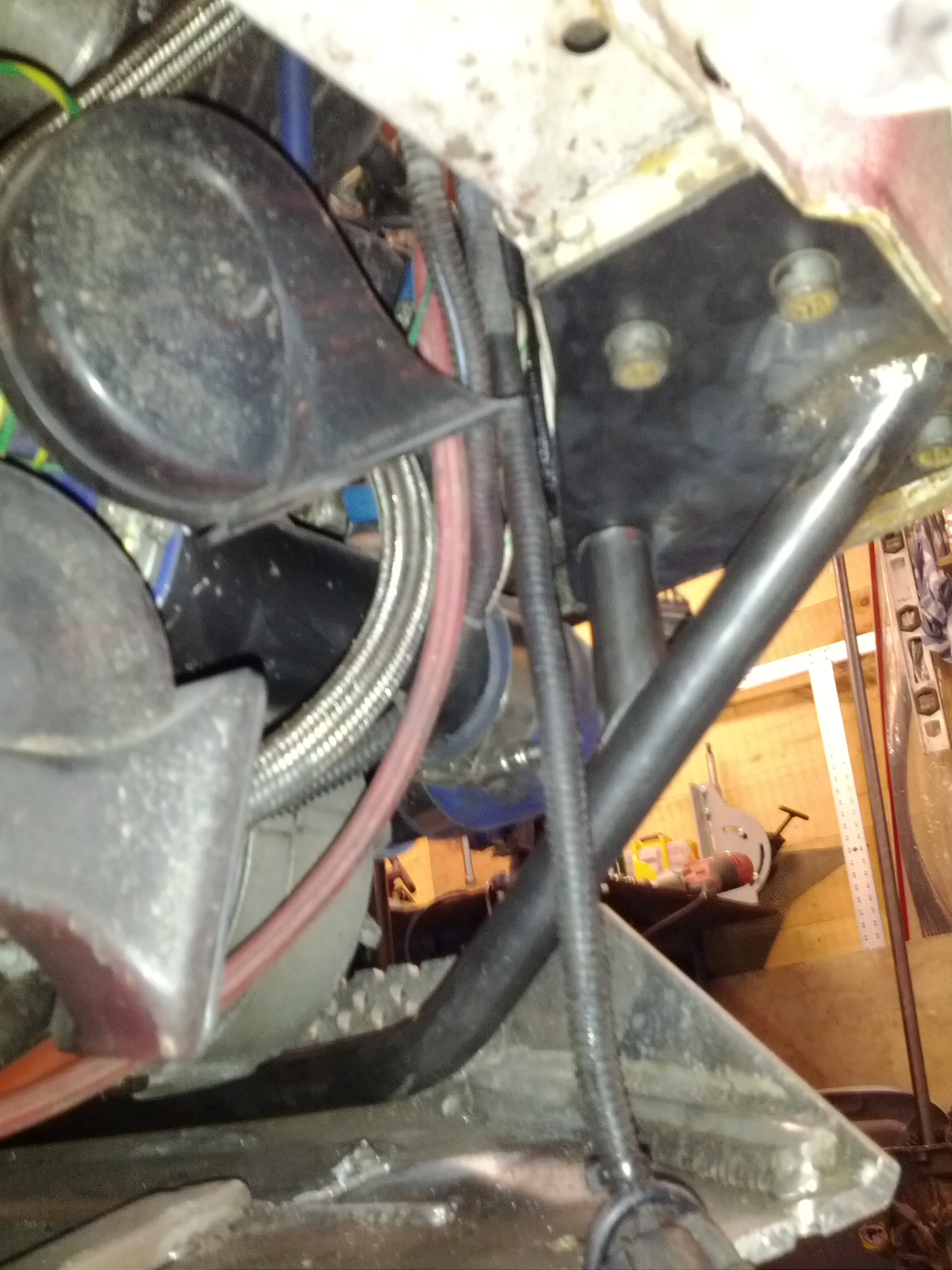

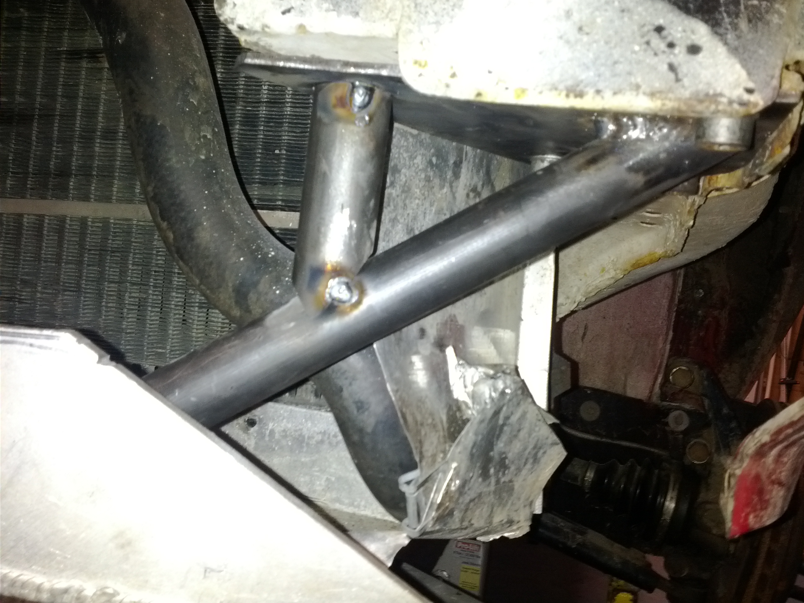

Posting pics of my skid plate setup as several folks have asked:
FIrst I built a support frame from 1" DOM.
- 2012-03-23 21.58.18.jpg (1.34 MiB) Viewed 50342 times
- 2012-03-23 22.51.12.jpg (1.3 MiB) Viewed 50342 times
- 2012-03-23 22.52.14.jpg (1.38 MiB) Viewed 50342 times

by vbares

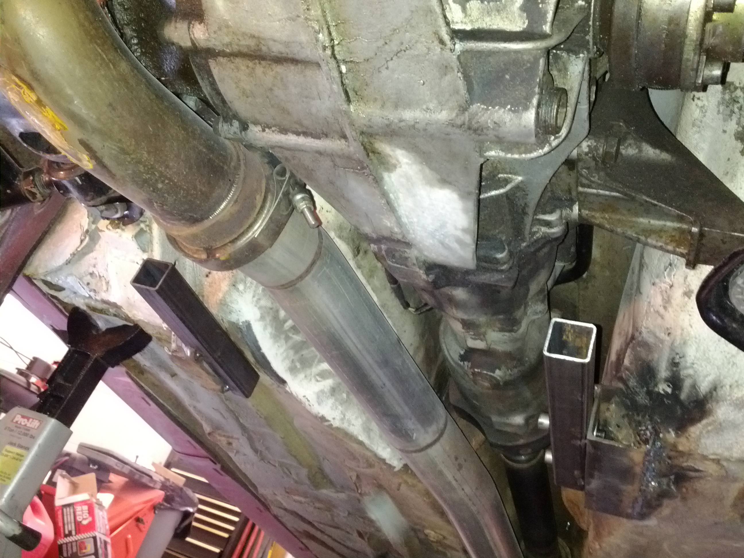

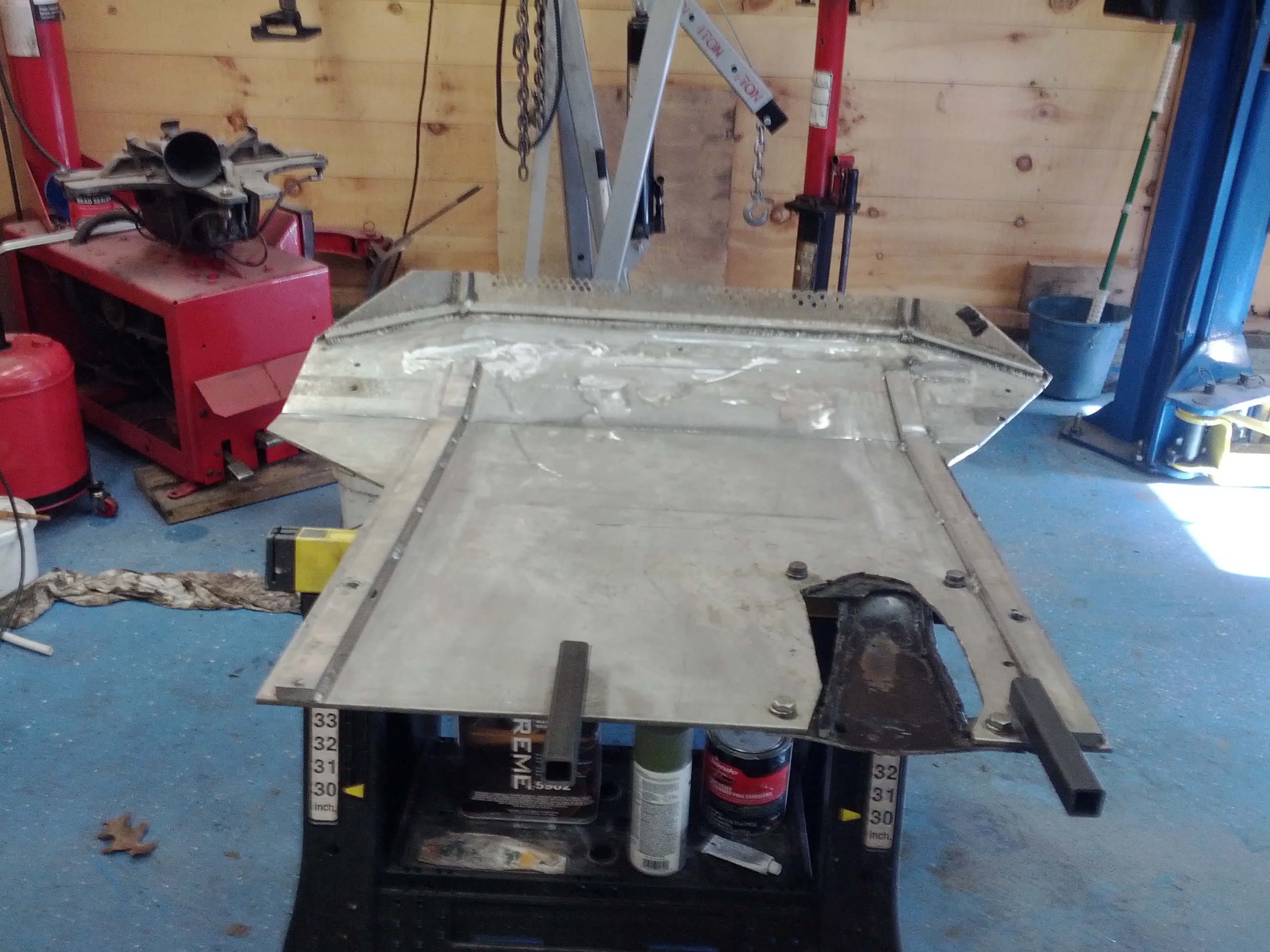

Square tube to the underbody
- 2012-04-06 16.42.39.jpg (1.59 MiB) Viewed 50339 times
Smaller square tube to the skid plate
- 2012-04-06 16.43.00.jpg (1.41 MiB) Viewed 50339 times
Slip square tubes into each other, 2 bolts - and you're good (I also have hitch pins that go through the square tube in case I do loose the front somehow)
- 2012-04-17 20.16.32.jpg (1.21 MiB) Viewed 50339 times

Skid plate is pretty weighty - but it still got bent by a rogue baby head in Saguenay - deflected enough to bend the bolts on the oil pan extension...but the car, with 1/2 tank of fuel and a spare tire came in at 3038#'s

Thanks for posting how you did your skid plate! That's pretty much the same thought I had for the front support. Im thinking of adding another bar across bolted to tabs too for mounting the radiator and IC. That way the upper tube core support is tied in as well, but removable for servicing the rad/IC up front. My cage stops at the fire wall and Ive found out that with out the front end tied together, it twists something fierce with the core support cut out. LOVE the idea for the square tubing in the rear! Can I steal your idea?

lol - I'm sure I stole it from somewhere...I recommend tying in the strut towers to your cage. My first rally 4k did not until I hit a big hole in a winter event that pushed one of the towers back about 2"...they're not that strong on their own...
