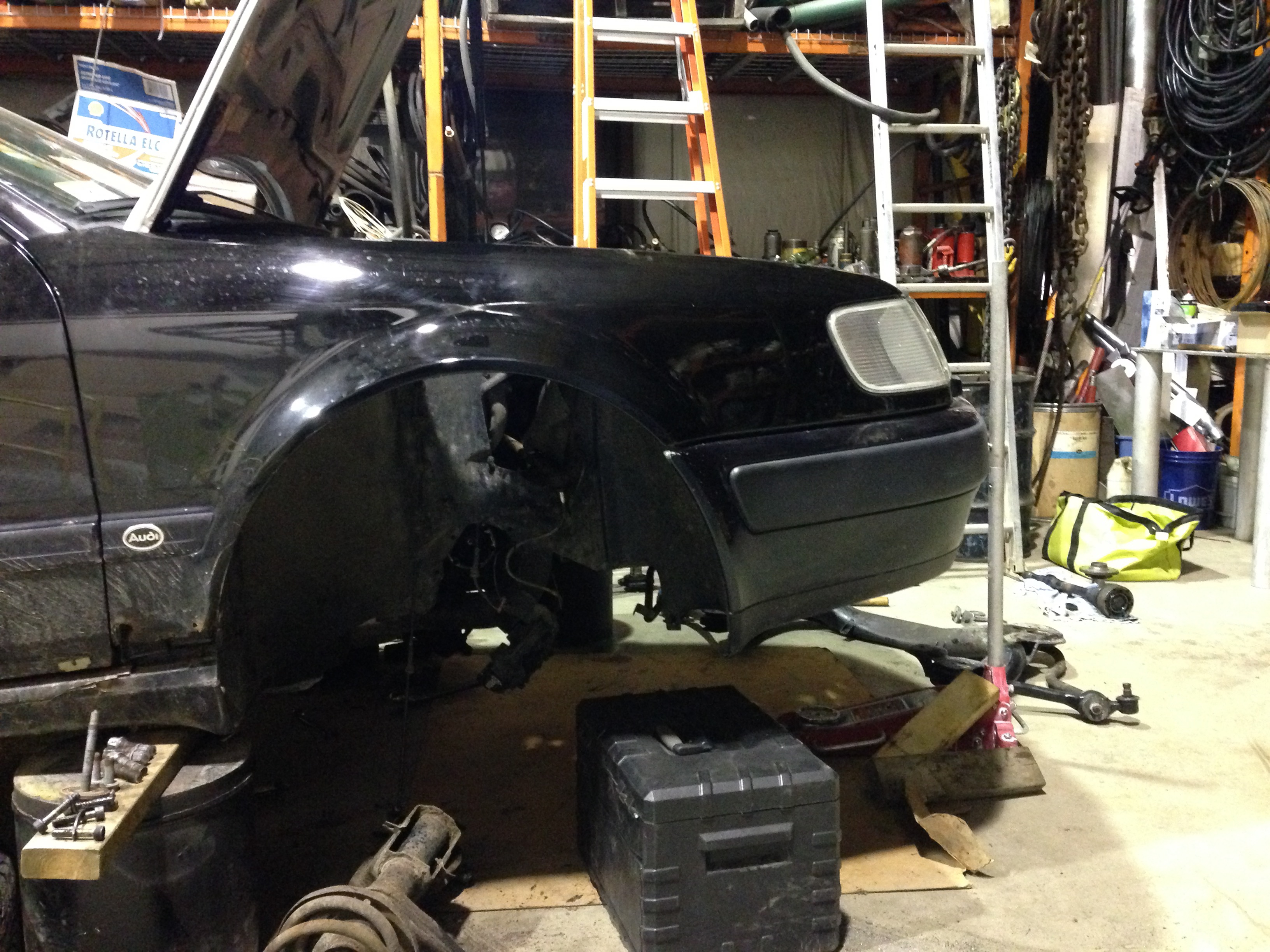

I began the teardown in earnest early Saturday. I got an excellent momentum going, as my boss' shop is akin to Dominic Toretto's shop in the original Fast and Furious. "If you can't find the right tool in this garage, you don't belong near a car..."
Her Last Photo, Pre-op...

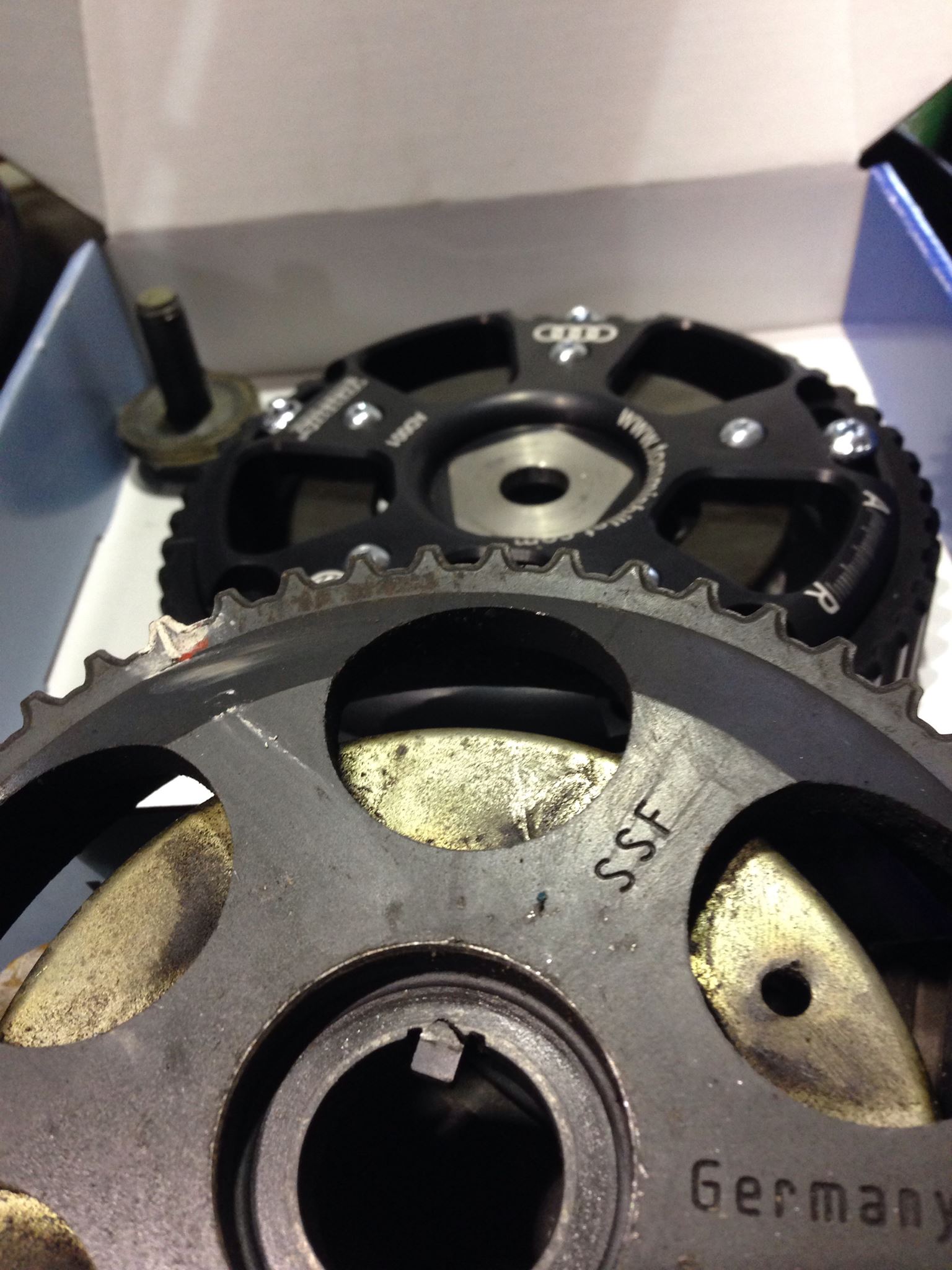

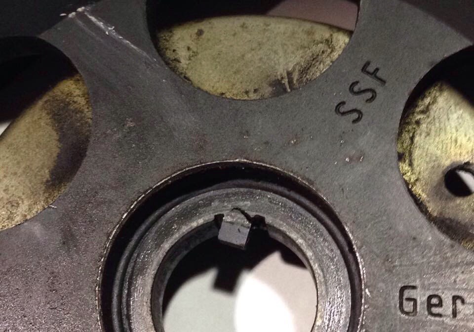

After the standard operating procedure of removing everything in the way, I popped off the hubs, pressed off that insidious outer wheel bearing race that apparently always takes a 1 way trip... and realized ECS ( :we: ) sent me the wrong wheel bearings labeled as "front", which I have already pressed into my new coilover converted uprights... :bangshead: I should have re-read the part number... "4B0" instead of "4A0"... but I guess when you have 20 boxes of parts in front of you, you start to glaze over... I ordered the correct part number kit from Europaparts, and carry on while licking my wounds... At that point, frustrated from this realization, I shift gears and dig into my engine to replace my failed cam sensor and preemptively replace my cam gear with Tommi's Billet (Got it on time thanks to Marc). I figured that with 265,000 miles, the cam gear is probably due to be replaced. My God was I right...
OHMYGODOHMYGODOHMYGOD
Old and busted, vs New Hotness
I touched the cracked keyway, and it fell off. I couldn't believe how close a call that was. I checked the camshaft for damage, and there was nothing but a little galling I corrected with an emery cloth. I replace the cam sensor and torque every little bolt down on the Tommi's gear, then set the final torque of the cam bolt to 48 ft-lbs. Happy with doing something right for a change... I head back under the beast. I get the inner CV bolts undone, and ready to be removed from the car for a thorough cleaning, inspection, and re-booting (Passenger's side was making a mean howling noise...) But before I dive into that can of worms, I decided to call it a night.

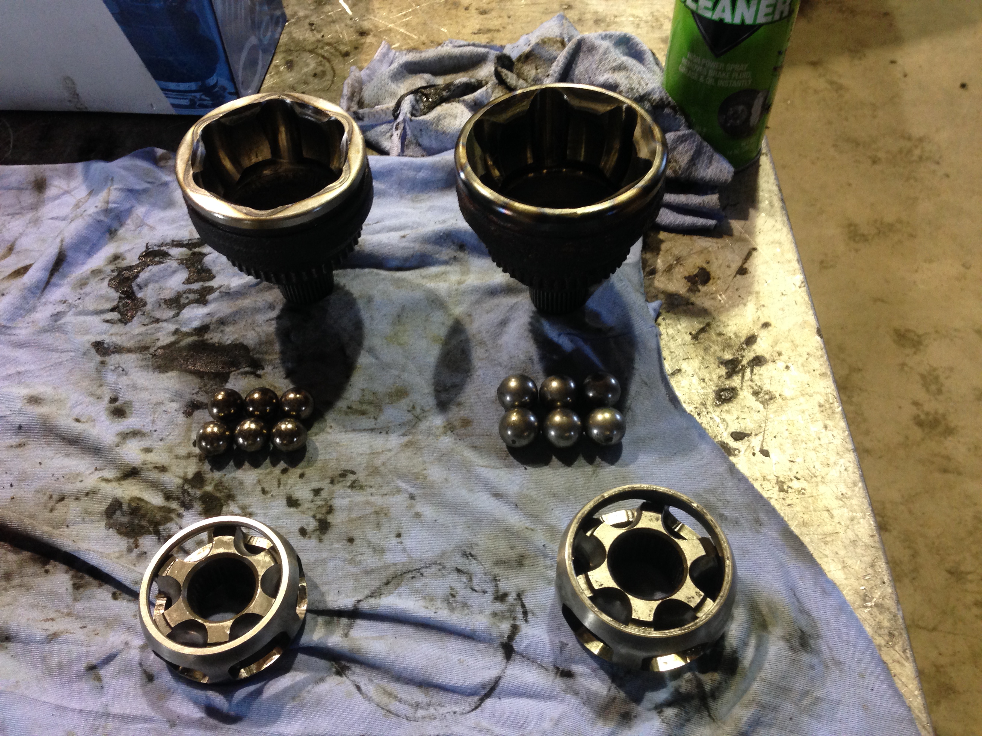

Does this look right to anybody?
I'll call him.... Mini-Me...
Again, frustrated and baffled, I leave that be for now and move on to something I know I can do...

Finally, how she sits today, waiting for correct parts to start trickling in...

Sounds like a solid weekend of repairs, however frustrating they may have been. Good save on the cam gear, although I wonder how you took it off (impact, no impact, cam lock, etc.) and if it may have just sheared then. The key isn't supposed to hold any torque; it is imply for indexing, so it may have been just fine as long as it was properly torqued onto the nose of the cam.
