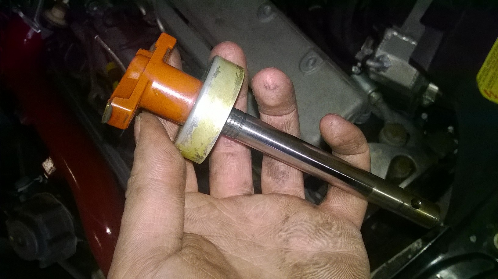

Next, remove the distributor.

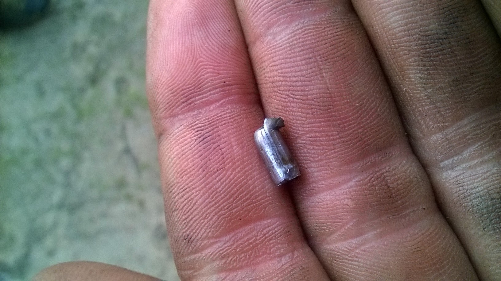

Got scared when the distributor axle ( or what would you call it.. ) came off whitout the distributor gear.
The pin was gone and all I found was this:
Gotta hope the rest of it is in the oilpan..
After I got the gear back in its place and everything ready to go, I bumped just a bit to the aftercooling waterpump and:
:bangshead:

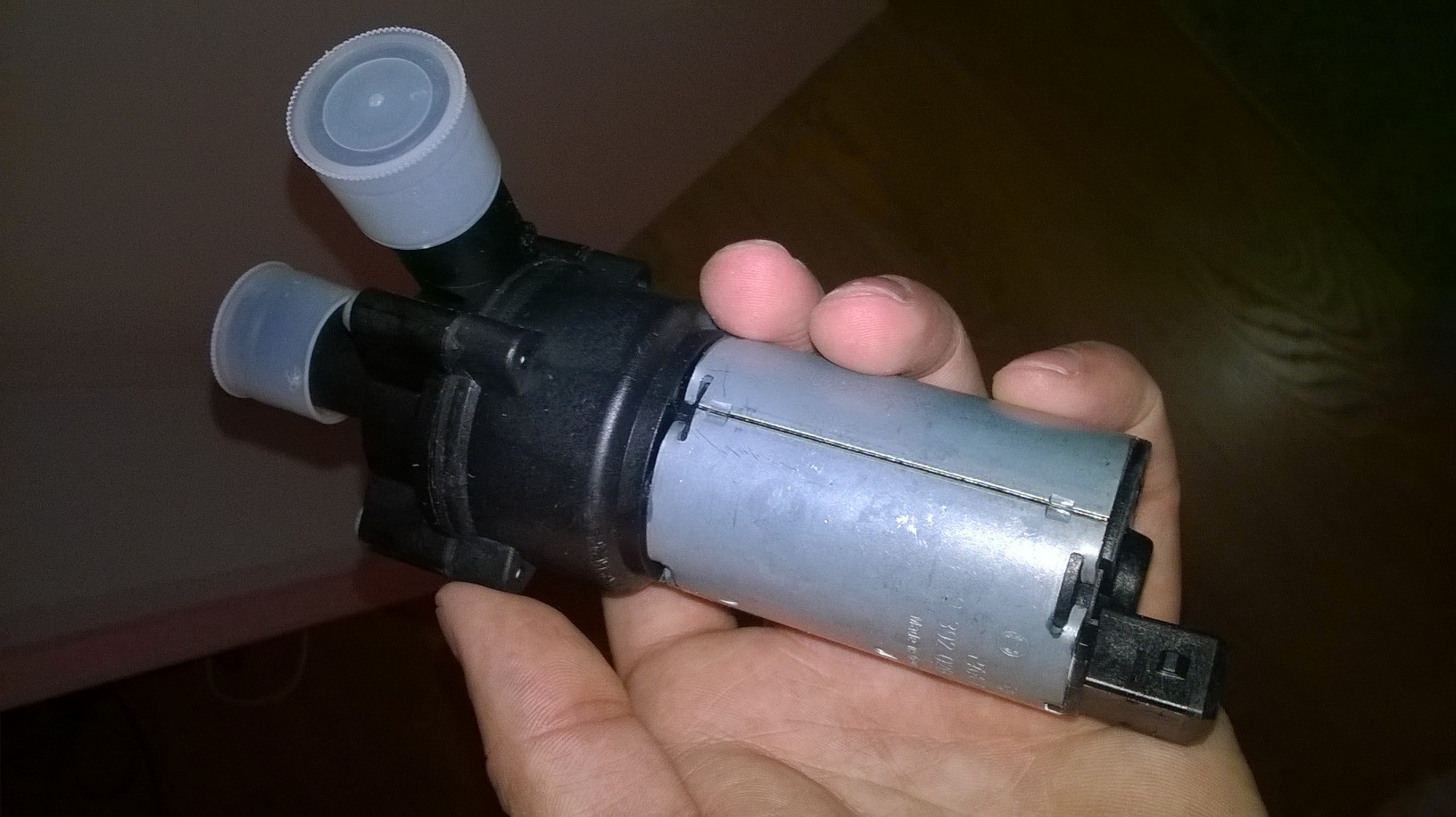

Also bought new after run pump which is a bit shorter than oem part, but fits nice and does the job. Replacement was also quite much cheaper, an Opel or Saab part I believe.. :roll:
Bosch part no: 0392020034
I haven't driven with this one a lot hence I needed a new daily after the 80 died, just maybe mere 500km in 5 weeks.

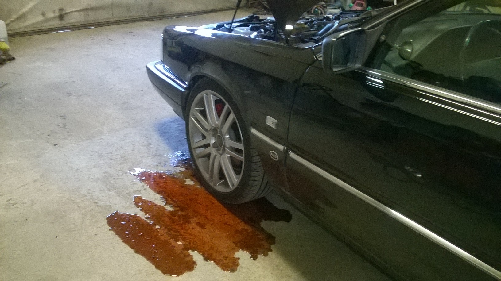

Or actually took it last week and found a coolant leak that caused foggy windows last fall.
Hose that connects from rear of the block to somekind of valve controlling coolant flow to heatercore had a hole in it.
Hose was NLA, but managed to craft one from simple 90 degree bend. That'll do for now.

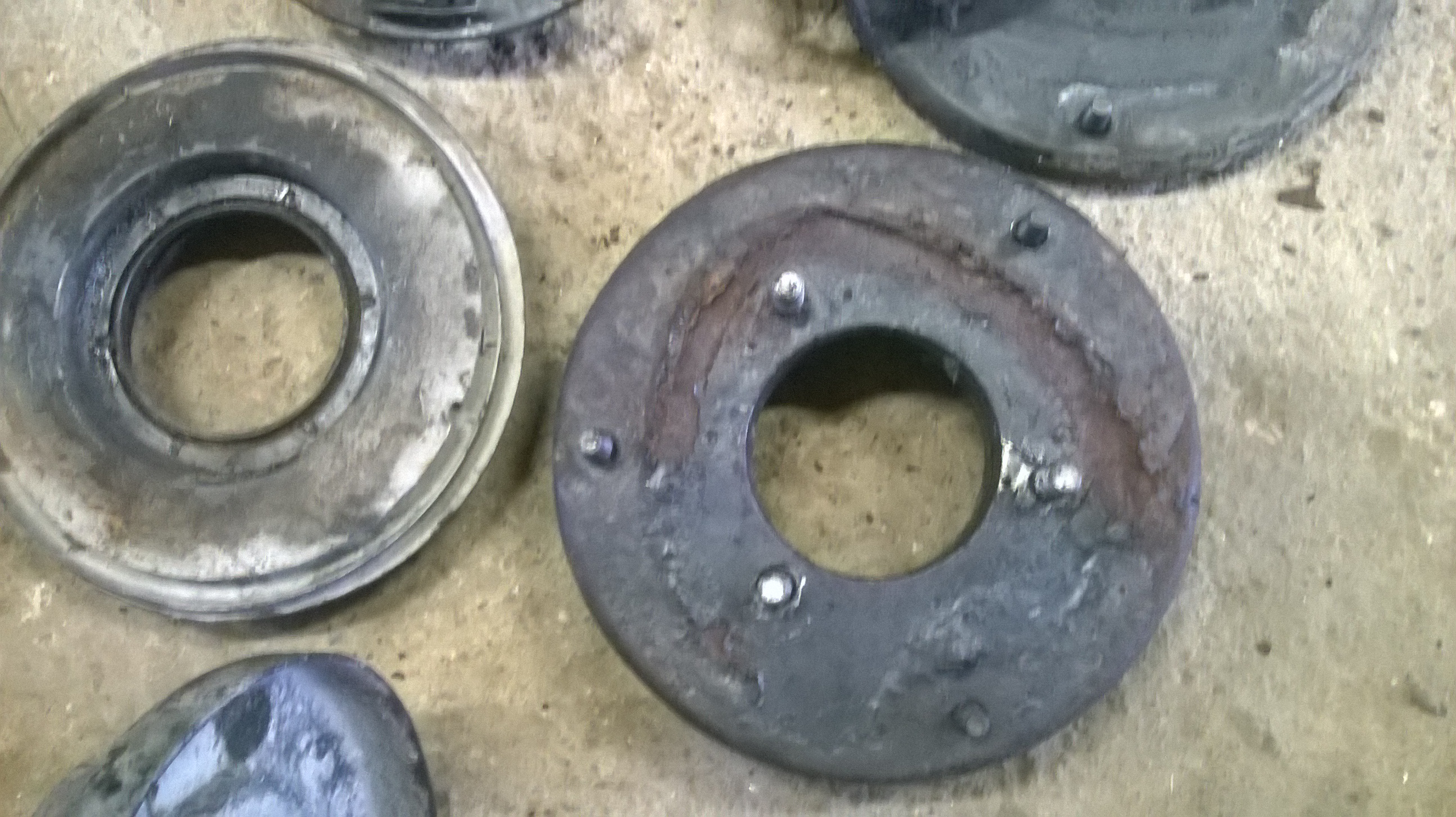

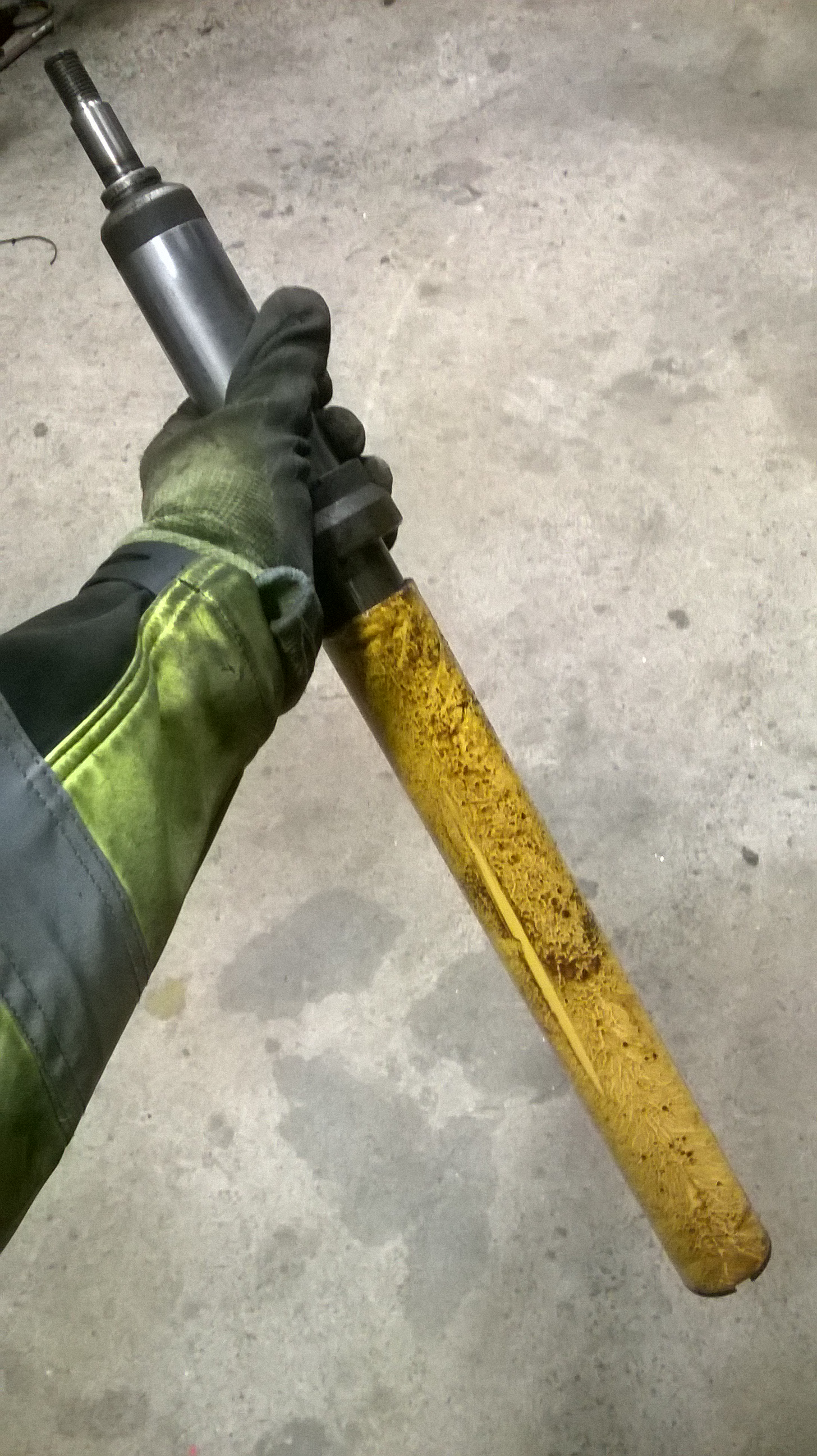

Seems it was about time to change the shocks.
old shock.jpg (1.51 MiB) Viewed 54658 times

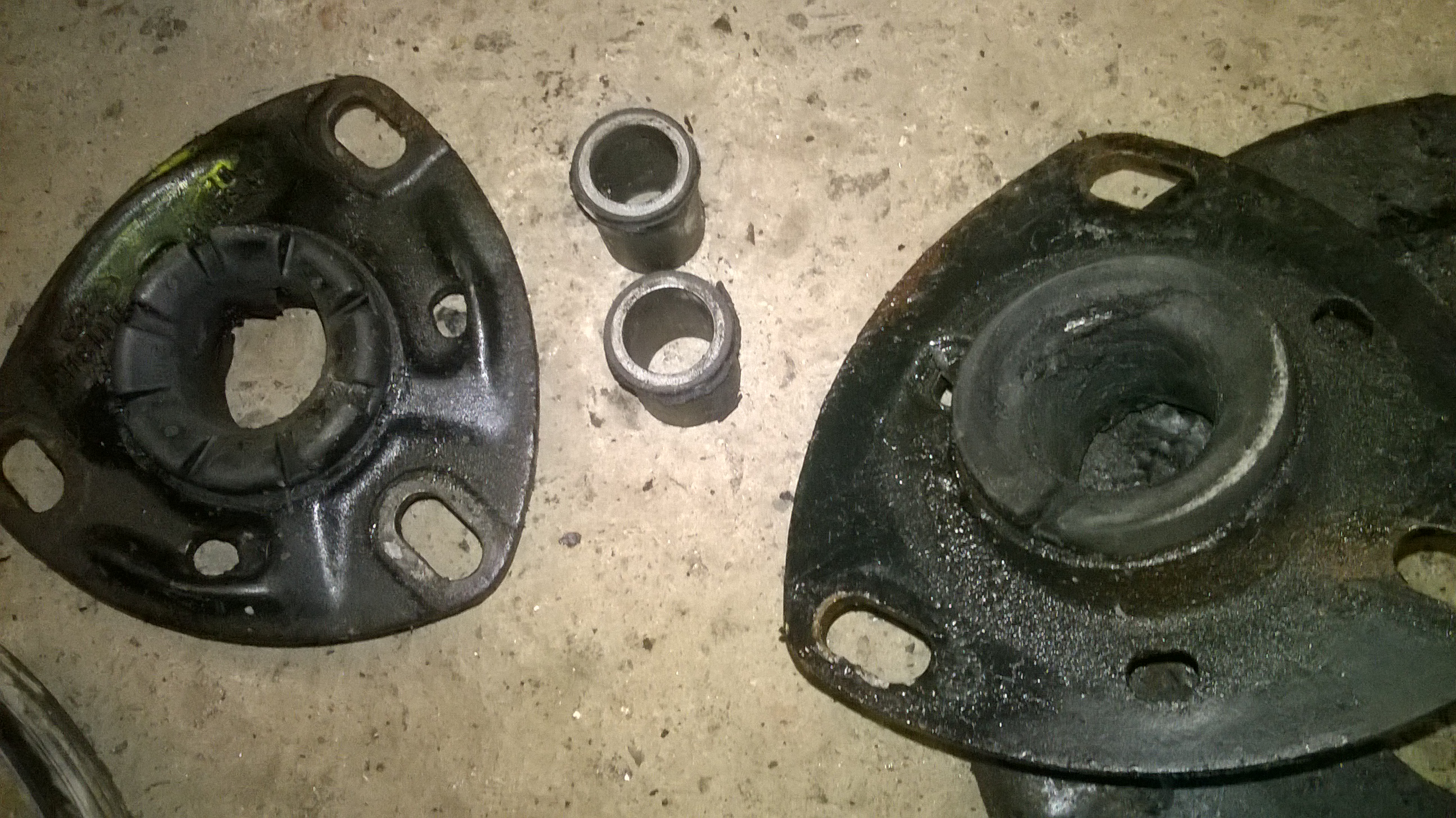

The upper mounts were also in grade a shape..
top notch top mounts 2.jpg (1.47 MiB) Viewed 54658 times
top notch top mounts.jpg (1.56 MiB) Viewed 54658 times
As well as every other bushing. No wonderthe car was interesting to drive around. :roll:
Should have done this a long time ago..

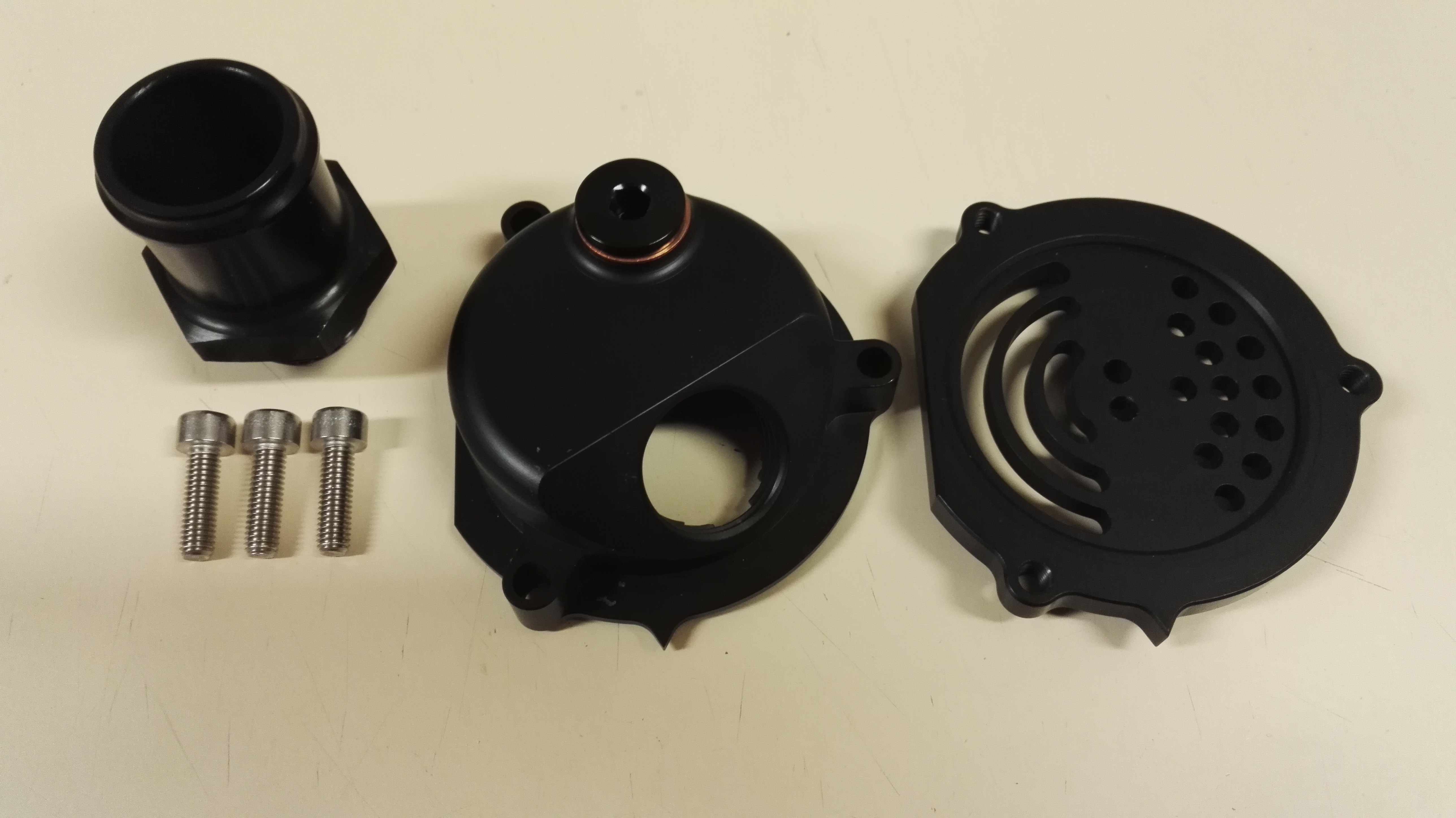

Already got some goodies from iABED Industries through S2forum group buy, the crankcase breather :
Big thanks to Issam for these, gotta love some billet goodies.
