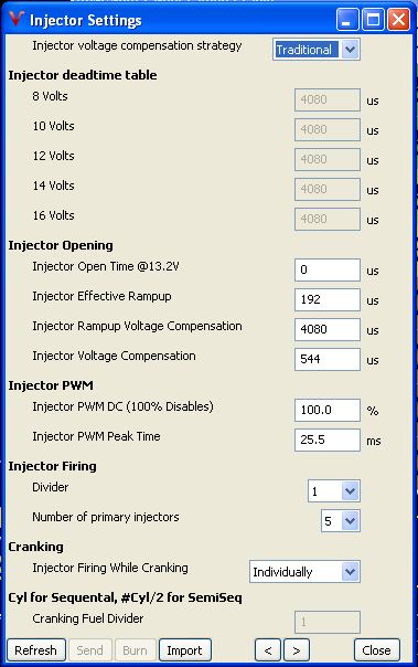

What tupe of injector settings are you guys running? The simplified or traditional? I've been trying to get my VE close enough to where I dont need to retune it when I change Lambda targets and I think the fact that I am running the Traditional style strat is screwing it up. Thoughts?

DuBistS4 wrote:What tupe of injector settings are you guys running? The simplified or traditional? I've been trying to get my VE close enough to where I dont need to retune it when I change Lambda targets and I think the fact that I am running the Traditional style strat is screwing it up. Thoughts?

My best MPG in the 200 was 29.8 on the way to Carlisle at an average speed of 70mph through the hilly terrain of NY and PA. Target for cruise is 1.02-1.03. On the way home from H2O, four people and a full trunk I got 27mpg. I am astounded at how well the 200 does on fuel. That was on 93oct pump fuel. E85 my best was 19mpg up to Burlington, VT to visit Casey (so there was a bit of spirited driving involved while up there).

What type of injector settings are you running Nick? Traditional or Simplified?

DuBistS4 wrote:What type of injector settings are you running Nick? Traditional or Simplified?
This is how it came from Marc. I have made no changes to them and have not had any issue.
