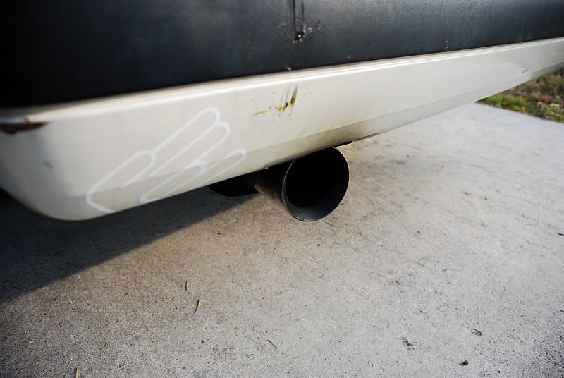

pretty good day for the audi today.
I got my adapters in the mail!!! I was so excited. The rears fit perfectly. They poke just a tiny bit. It will look great slammed. I think the next thing to do is definitely get it a little lower just to set off the look.
Only problem was that the front UFO setup is preventing me from fitting the front adapters. The little UFO-shaped part is not allowing them to sit on a flat surface. So the wheels have to wait until the brakes go on before I can run 'em. Funny because the wheels need to be on before the brakes can go on lol.
Then after that I went to my good friend Tom Sewell's shop to make my exhaust. It was awesome...we only needed like one 8 ft straight pipe and 2 bends to make the whole thing from the downpipe back. We cut off part of my custom downpipe, then cut the dump tube for the wg off so it was angled at the ground. Then a flex pipe after the dp, and a v-band right there. From the v-band, it is a straight pipe back to two bends into some mystery muffler (3" straight thru) which happens to sound AMAZING! It makes the idle almost sound lumpy and its super deep...and relatively QUIET too!!!!! I'll get pics this week when its back on the lift for brakes...and I'll try and get a vid soon too.
The best part...grand total came to $200. That includes a 3" stainless v-band ($42 his cost), 8ft of pipe, the muffler, and our labor. :woowoo: I threw him an extra 50 bux just cuz I appreciate his help so much. If you are ever in Florida, or ever need any tuning done call Tom Sewell up. Some of the best work/tuning/prices you will find on the planet

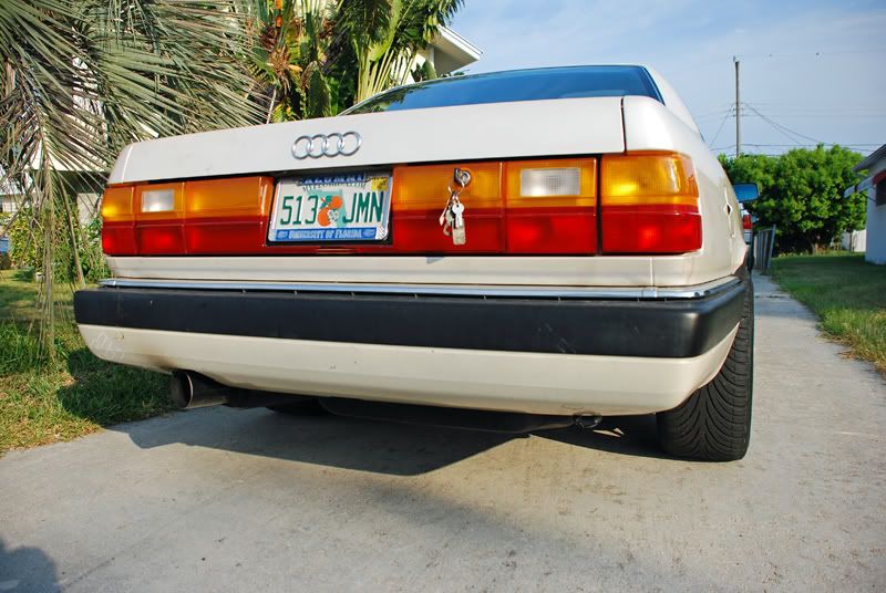

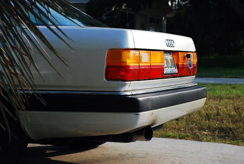

got dat booty on duty!
car is durty as a mofo and don't mind the damage to the rear bumper from the PO! It has character
pics dont do the fat-assness justice. It looks soooo meaty in person!
I'll get better pics later. Oh yeah...only the rears are on lol. Rotating diameter of stock wheels and tires is virtually the same as these wheels and tires.
oh and they rub when i go over bumps lol...I need to do something about those rear fender liners on thursday. Recommendations are welcome. They poke a bit, but it will look nice when low.

thanks

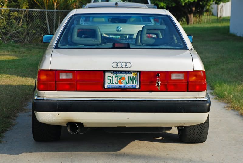

few more pics
again, dont mind rear bumper damage! lol
and so you can see the poke
I will take side shots when the front wheels are on. It looks good...but slightly out of place without being low
also I think I have decided that this car needs all red tails...end of story. Whatcha think?

derrish_vulf
thanks
looks even beefier in person...I look at it from the back and I just cant stop staring lol
they are 255 23 18 in the back
Maybe I'll just paint/tint the current tails red
